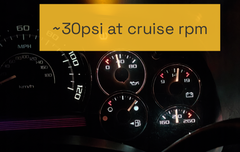

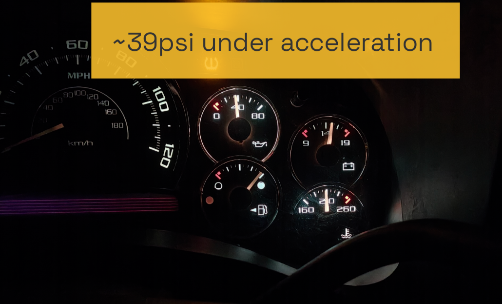

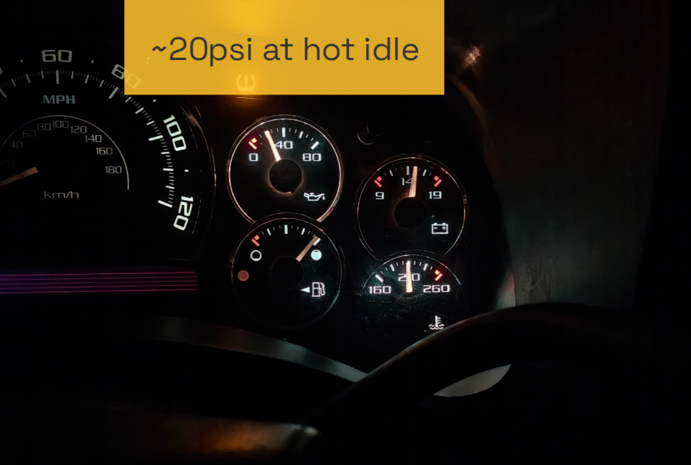

I had a sudden change in oil pressure, and I'm debating if I should put a new oil pump in.
The truck was running at about 35-42 psi until about a month ago when it dropped to about 25-35.
When completely up to temperature, It cruises at about 30-35 psi, under acceleration it jumps almost to 40 psi, and if you let it idle for a while it will come down to 20psi.
The truck is a 2005 Escalade EXT with about 320,000 miles on it. I have another 2004 Escalade and its oil pressure is always about 35-42 psi (like this one was).
I just put a new oil pressure sensor in it this summer, and don't mind doing an oil pump job (I did one last spring in my wife's 2011 Escalade and it was pretty easy).
Thoughts on the oil pressure? Did the pickup tube o ring fail? Something else?

I'd be more concerned about the 'sudden' drop in your average oil pressures. Your average oil pressures are a bit low, but not troublesome. A hot idle oil pressure below 20 psi becomes an issue.
I suggest that you perform the test for the bad O-ring in the oil pickup tube, as that could well be the cause of the 'sudden' drop in oil pressure.

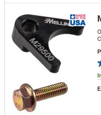

Replace the oil pickup tube O-ring and install an aftermarket fastener (Summit Racing) that improves the 'sturdiness' of the connection of the pickup tube to the block, by actually using 2 bolts to connect, while you are in there.
FYI - I had the O ring replaced and attempted to install the Summit bracket. The mechanic said the bracket would not fit so just replaced the O-ring. Oil pressure resolved. I'm curious if anyone else got the "bracket" to fit.
Interesting. I wasn’t aware there were any problems with how the pickup tube mounts to the block. And if I remember correctly my pickup tube already had two bolts that mounts it to the block and pump. I bolted the new tube to the block the same way the original one was mounted and hasn’t had any issues since.
