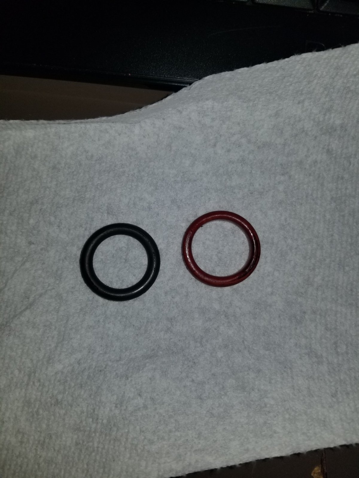

wow i am sure glade i did not pull the diff I did start and ran the truck yesterday 10 pounds more oil pressure on cold start , I Have not seen that much oil pressure in a while. and no ticking, I will post a follow up next week when i am done with the other work and drive it.
The O Ring was very loose compared to the new almost got a face full of pick up tube.
Post pics of the old o-ring too if you have them.

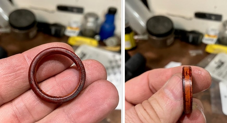

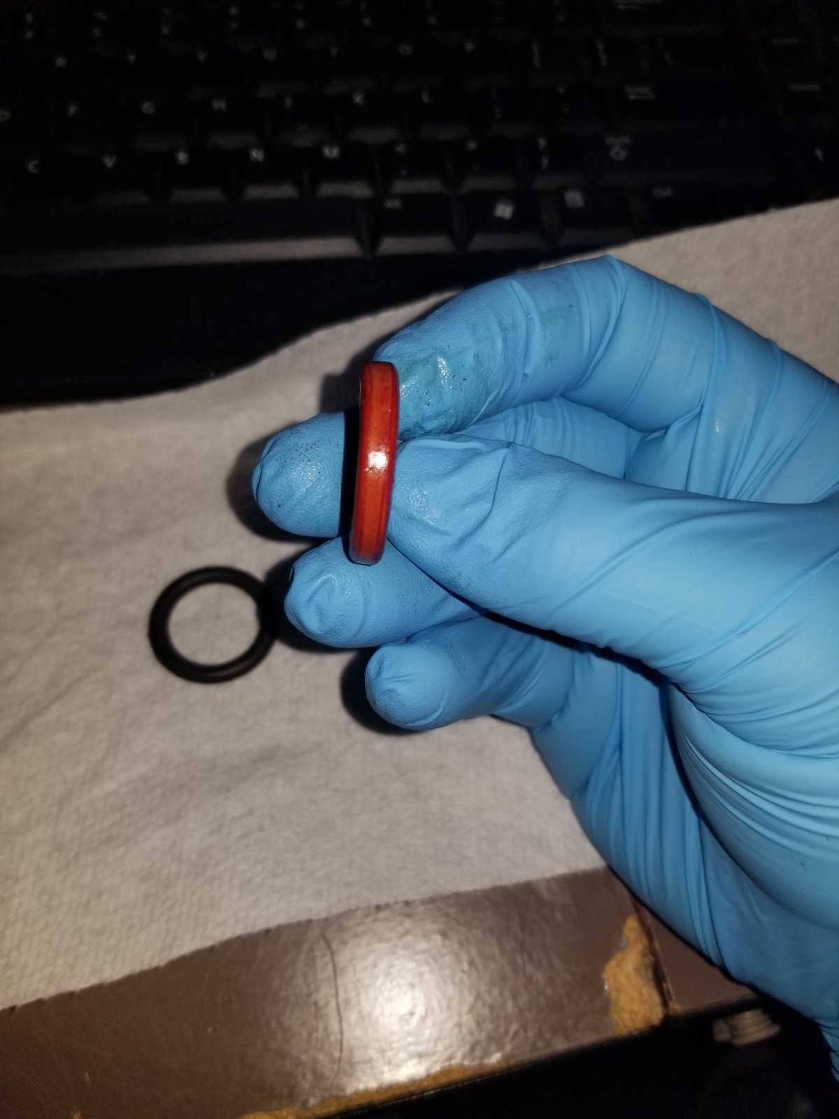

Here is a picture of my old o ring, definitely pretty flat.
There was some concern online about the felpro replacement I bought being too big for the tube, but side by side the old and new look almost identical.
Also read that the felpro is made for the recessed design, which is what I have.

I don't know if it states on package, but I would think the materiel O-ring is made from is important. Looks like they should be made from Fluorocarbon (Viton).

Was reading online, it's indeed made of Viton!

That’s what the best valve seals are made of. I used Viton seals on both my trucks when I did cams and dual valve springs.

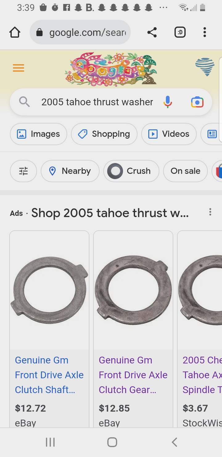

So I'm putting the axle seal in and I accidently bent the 2 washers that are below the snap ring? I found one of them, the one with the 2 grooves, but the other one I'm having a hard time finding.
Anyone know what the other one called?

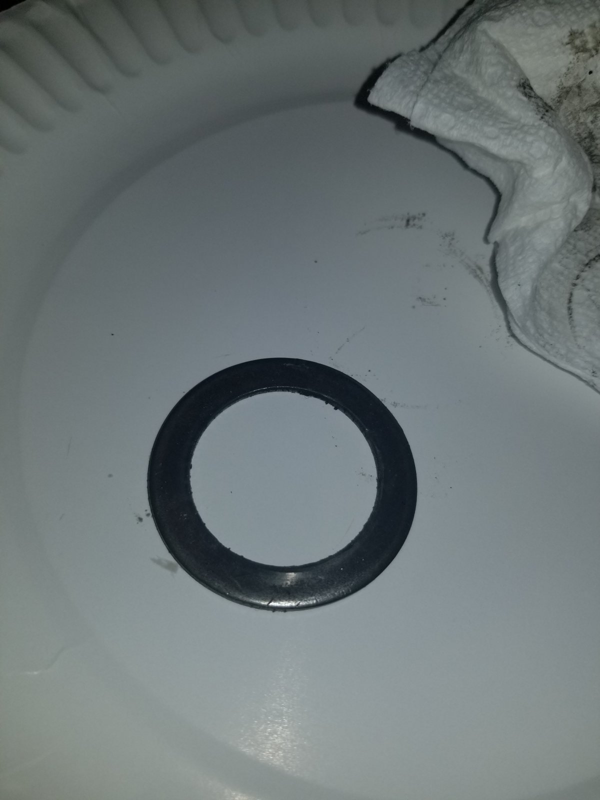

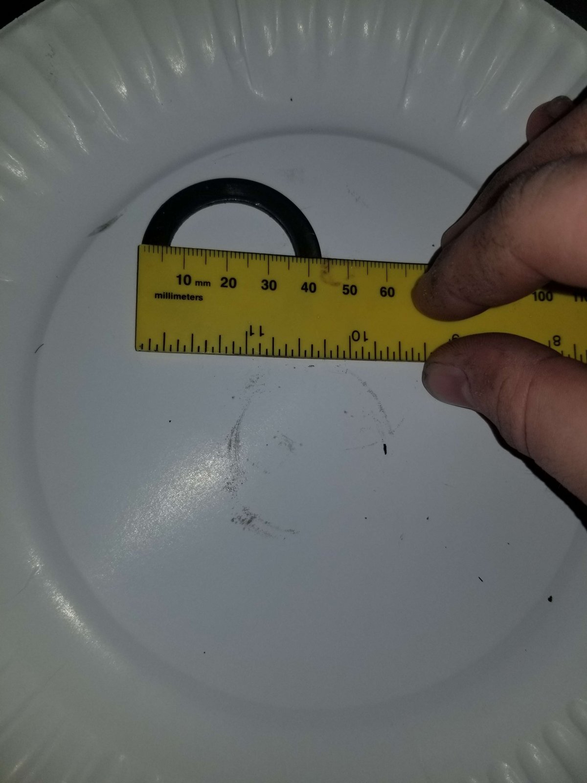

Heres the one I cant find.
JPVortex
JPVortex
Jan 13, 2022
494
357
Need to replace them because I didnt realize there was a lock ring and I bent them.

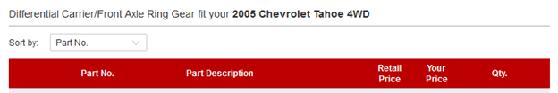

@Rocket Man beat me to it, but FWIW:
Not sure if these are correct.
Active picture links here:
https://www.gmpartsgiant.com/parts-...ifferential_carrier_front_axle_ring_gear.html
52,949
Looks like the 26066838 in that parts list but I can’t be sure. I’d probably order all of the possibilities myself, they’re pretty inexpensive.
