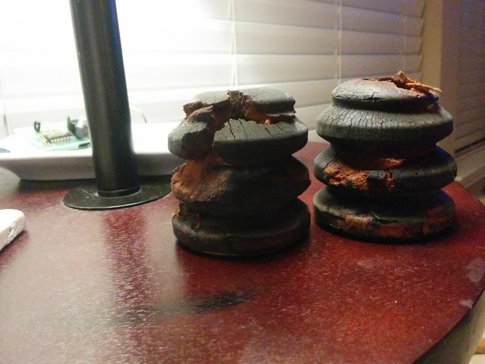

Did you take the centerlink/relay rod off when doing any suspension work?
Also, check your jounce bumpers. They could be disintegrated. New ones need to just touch the LCA's.

Make sure the centerlink is oriented properly. Mine and several others weren't and produced very weird steering issues because the tie-rods weren't aligned. Here's a pic, but the whole thread is worth a read: https://www.tahoeyukonforum.com/thr...g-at-near-full-lock.86256/page-2#post-1040842
Jounce bumpers/bump stops, yes, folks use those terms interchangeably. 15153958 is the GM part number. Here's mine, a Texas truck after 13 years.

Front. And like Fless said, should be in contact with the LCA.
Thank you. It appears I need to replace them in the front. They don't look deteriorated, but it's clear they are no longer touching the LCA, and there are wear marks on the side of the jounce bumper that seems to indicate it's collapsing way too much.
I'll report back after I've had a chance to replace them and evaluate. Thanks to everyone for your responses.
I replaced the front and rear jounce/bump stops. No change. I'll update again once I determine next steps.
