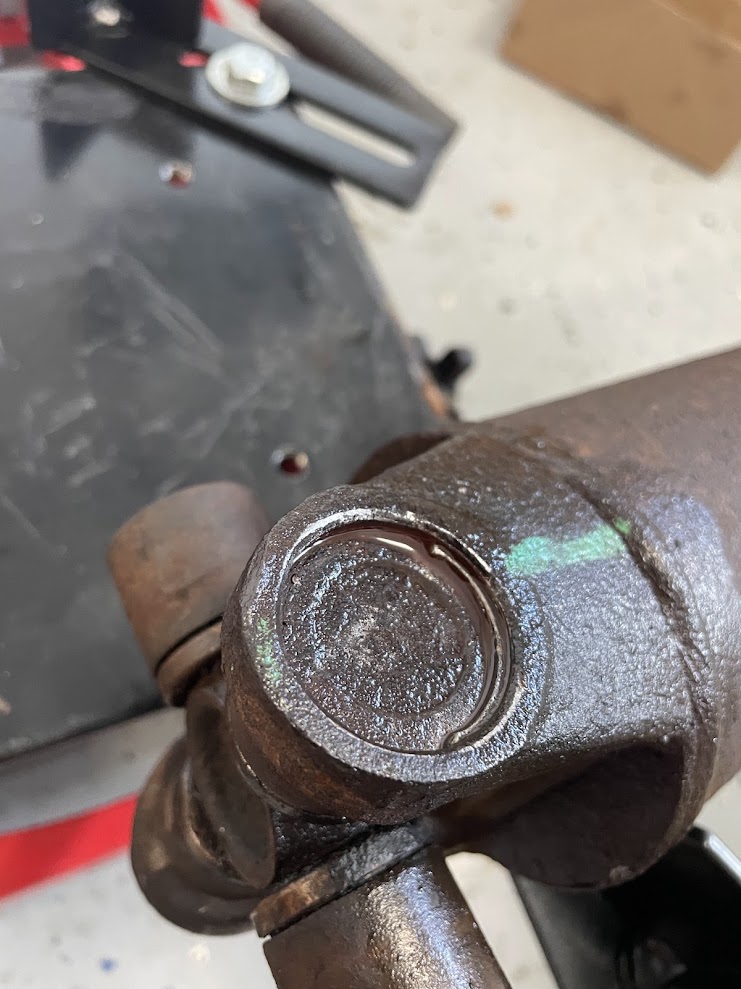

One of these days a repair job will go as planned with no issues. Today was not that day.
Project ujoint commenced and as I anticipated, the snap rings broke off and the remainders are rusted into the driveshaft. I haven't even tried the slip yoke end because I'm 0 for 2 on the tail. I heated, soaked with 50/50 acetone and transmission fluid, scraped, you name it but no luck. I decided to call it a day and picked up $50 worth of picks, cold chisels, and couple of pliers from Hobo Freight to start again tomorrow and not further destroy my screw drivers and punches that were too soft.
I'd love to hear from any of you guys that have fought and won similar battles if you found a particular technique that works.

Besides heat, perhaps use a smaller diameter cup/socket and press that side away from the broken snap ring.

I did try tapping each side with a small ball peen hammer head hoping it would break the snap rings loose. Unfortunately the rings are broken on each side and still retaining the ujoint.
The idea of using the tool to press the ujoint away from the broken snap ring was to relieve some pressure, break the rust bond, etc. If anything, let the penetrant sit in the area to creep in.

Get a big hammer and a punch and smack that end cap. You want to drive it in a little bit. Once you get the end cap in a minute amount the snap ring will come right out.
Then do the same thing on the other side except drive it till the other end cap comes out. Then smack it back the other way till both end caps are out.

Got it. I want to make sure I don't do anything to damage the ring groove on the opposite side since it also has a partial ring in place. Any risk of this so that you have to watch how much force? I assume a small punch or socket isn't going to have the ooomf to drive the cap much and you only need to create a small gap to free up the ring.
