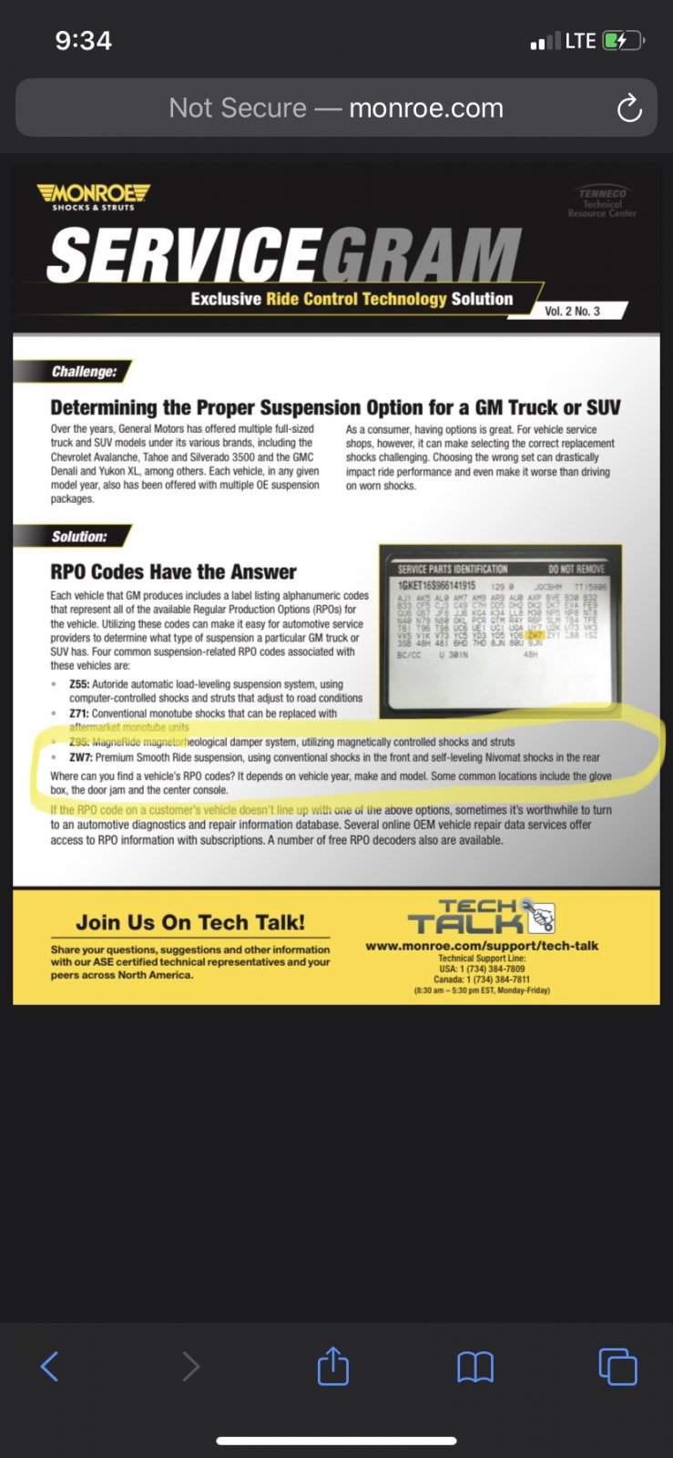

Your Hoe shipped with the "Premium Smooth Ride" suspension (RPO code ZW7). The rear shocks are self-leveling using Nivomat technology and, for the smooth ride the rear springs are softer than Z71 springs. (EDIT: the parts catalogs sometimes call this Self Leveling Suspension and may not mention the ZW7 RPO code.)
Although you said you replaced the struts, I think you mean the shocks. If you have the O'Reilly part numbers, tell us what they are.
The rear shocks should be pretty huge in comparison to a regular shock if they're still the Nivomats, but would have cost a lot more than the $50 you quoted. If the rear springs are original and the shocks are NOT Nivomats, then your truck will not ride correctly. The shocks and springs are a technology "set" and are designed to be used together.

To be clear, one can convert from the Nivomat system on the rears if a combo like Rock Auto shows is used. Springs must be replaced with firmer ones at the same time as the shocks in order to maintain stability.
You can go either way, though. Get the Nivomat shocks or replace the springs and keep your shocks. Just so the technology is matched. Can't go wrong with Bilstein, but there are other choices. You could get the Z71 springs from a junkyard or UPull.
It seems I may have really stepped in it when I changed those shocks. Not knowing any better, I trashed the OE shocks. I guess I was just throwing mud at the wall and hoping some of it would stick. Just look at me now! Lol
