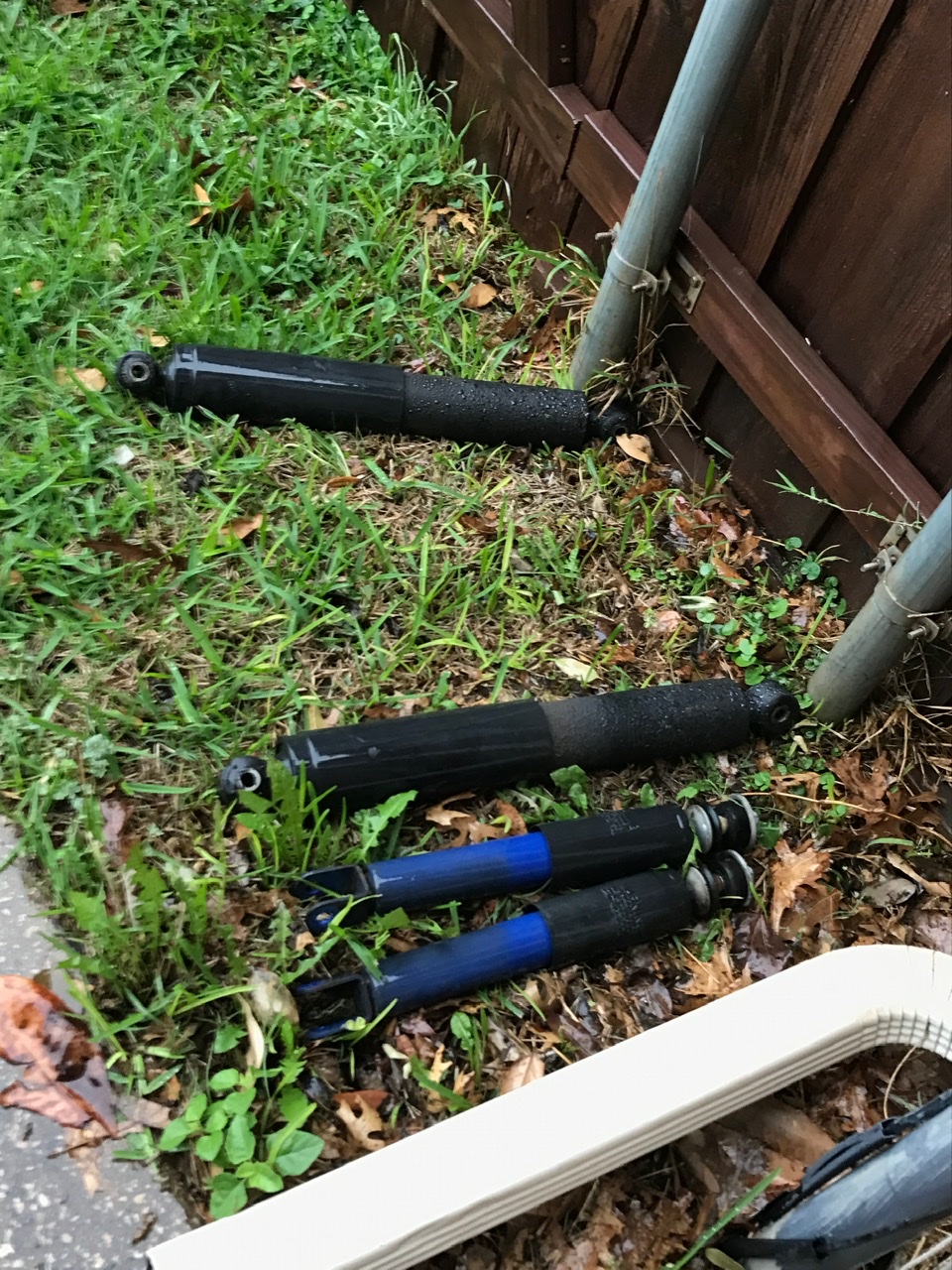

We both have G65, not G69, and I sure as shit have Nivomats on my Tahoe. If you remember, were the rears you pulled off much, much thicker than the fronts? If so, those are likely Nivomats and will need new springs if going with a traditional shock.
Same with mine. ZW7, G65 = Nivomats on the rear.
Here is a pic. Do the black ones look like nivomats?

Thanks for confirming these are Nivomats. I'm assuming my next step is to buy this MOOG spring set, and four of these MOOG coil spring insulators. Installing these should make my rear suspension more stable, yes?
If anyone disagrees with installing the MOOG springs, please let me know.
Well, they look right, certainly larger than those other two. I think the Nivomats are larger in diameter than standard rear shocks. Do you know their diameter?

They do look like the Nivomats. On my '04 they're all black, the top shell is plastic (about 3-1/8" diameter, hard to measure because it's a bit flexible), and the solid bottom tube measures about 2-3/4" or 2-7/8".

Unfortunately not - the picture I posted was taken around 3 years ago when I changed them out - they've long since been disposed of. I can tell you that, looking at the picture, the rears seem substantially larger in diameter compared to the Bilsteins that replaced them. I think, for $65, I should buy the MOOG springs and install them. I can't imagine what else would be causing my issue since the front end seems to be tight, and the shocks are all (relatively) new. I got 12 years out of the factory shocks, the Bilsteins have only been on for 3...
