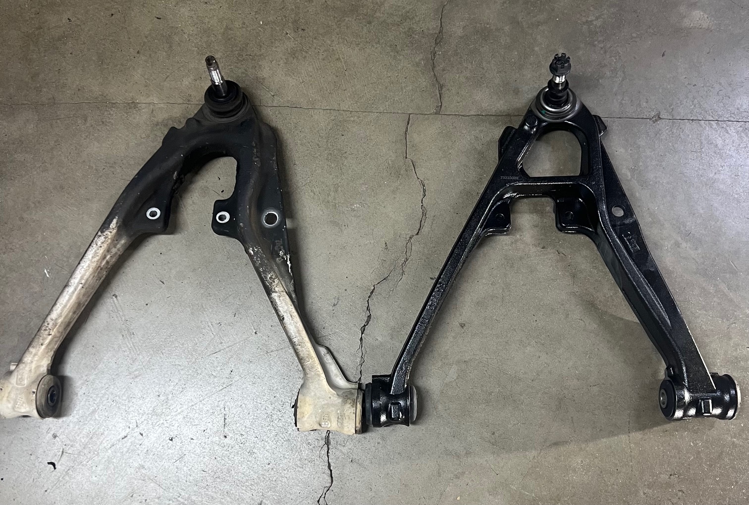

Only had about a 1/2 day to work today, made some progress, the new control arm is in now, got both front CV axle shaft boots replaced and ran out of time. Still need to install the outer and inner tie rods on both sides and button it up to go to the alignment shop.
Installing new CV boots is not hard but wastes time as everything has to be cleaned up before the new grease and boots go on. The forged steel ( Police Duty, Moog ). Control Arm replaced the aluminum and appears to be a perfect fit. It does weigh at least 10 pounds more than the aluminum version. The delivery box was completely destroyed and had been taped back together for delivery. I expected problems but all parts were in the repaired box and all was good, no damage. Got lucky.
Wondering if you could tell if the original control arm was bent, or if they were pretty much the same?

I could not detect a bend in the old control arm, it may have been fine. Once I pull the inner and outer tie rods I may find a bend there. The steering wheel is no longer centered so something moved in the suspension. I studied the upper control arm adjustments and they do not appear to have moved at all and the upper arms are forged steel so I don’t think they bent. Won’t be able to get back on this till tonight or maybe tomorrow.

The new arm is Forged Steel, much stronger than cast or stamped. Specified for police duty
Should have also said, only one Moog sells that is still made in the USA.
Got the alignment done this afternoon. The Tech did not adjust the upper control arms at all. Set the Toe and told me all is perfect. I could have set the toe at home but wanted to make sure the camber and caster were correct also so it went to the shop.
