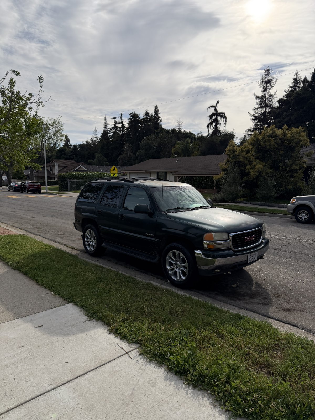

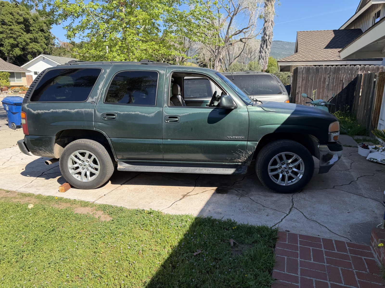

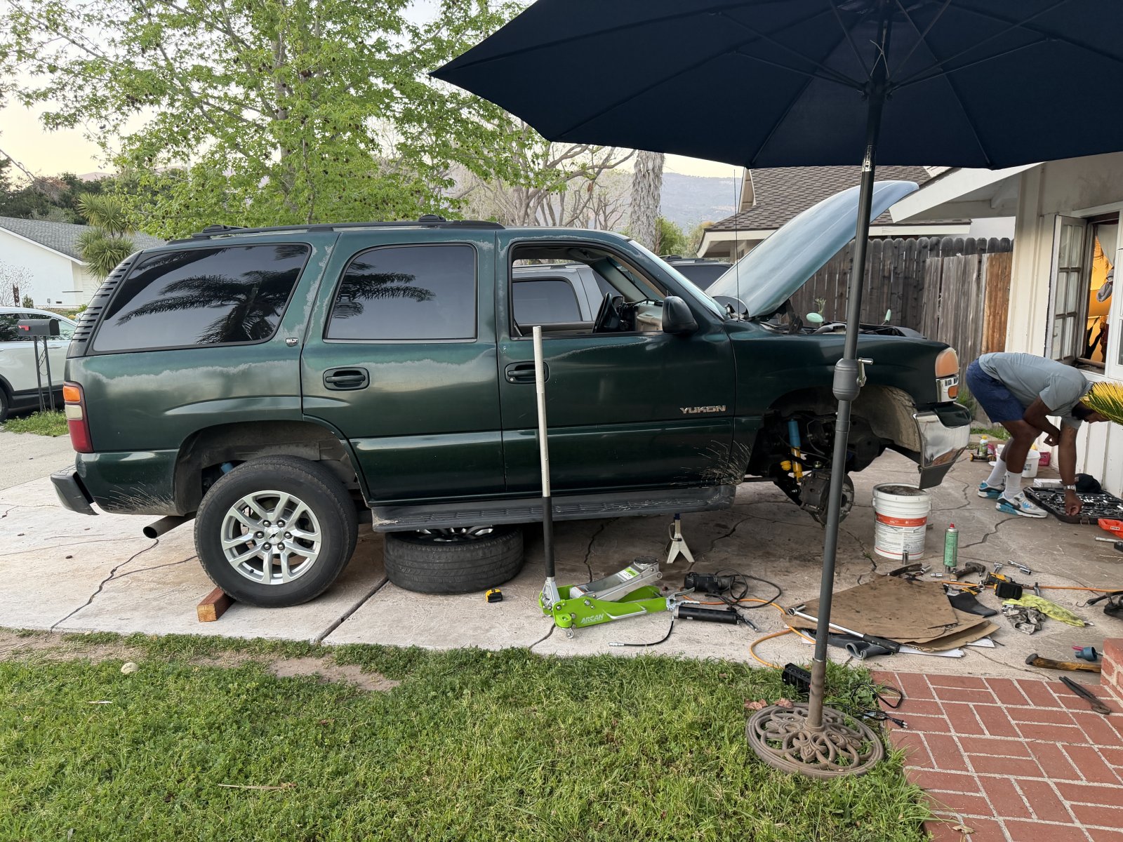

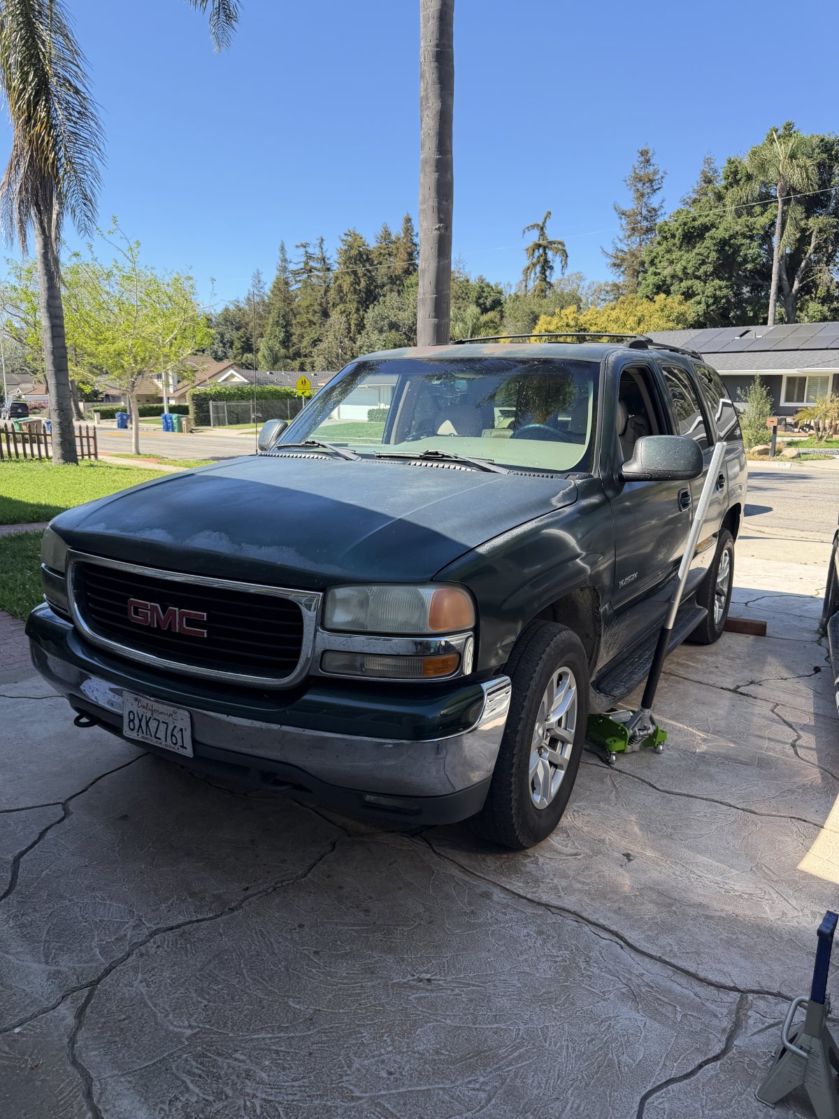

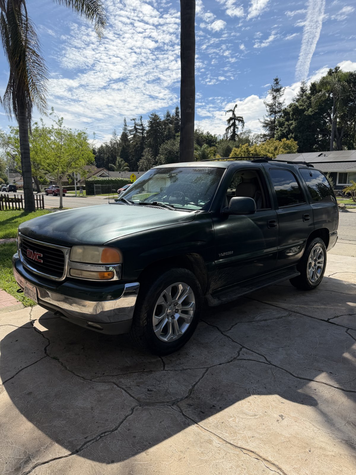

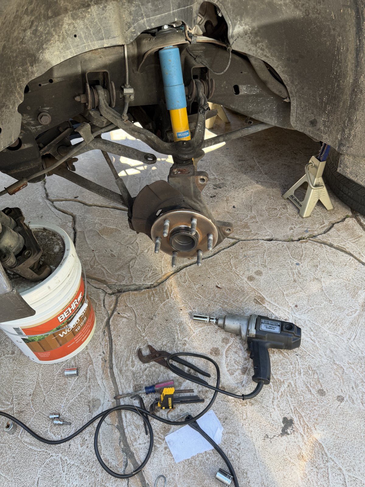

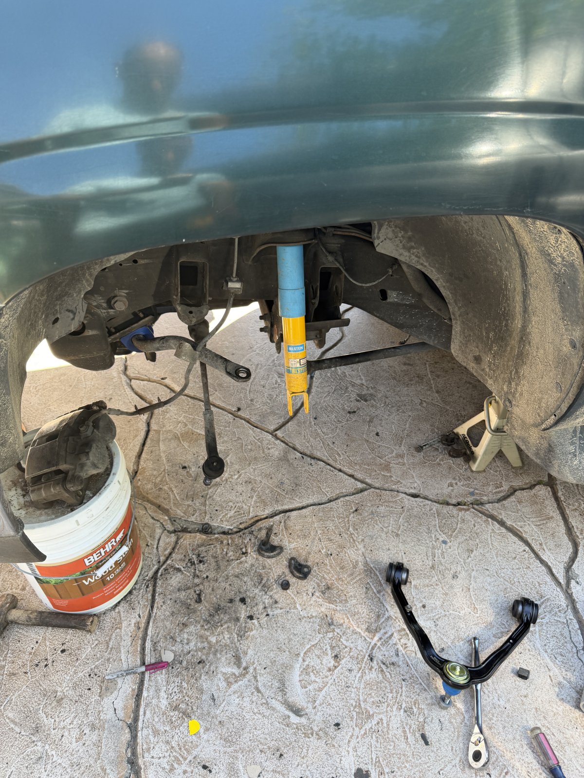

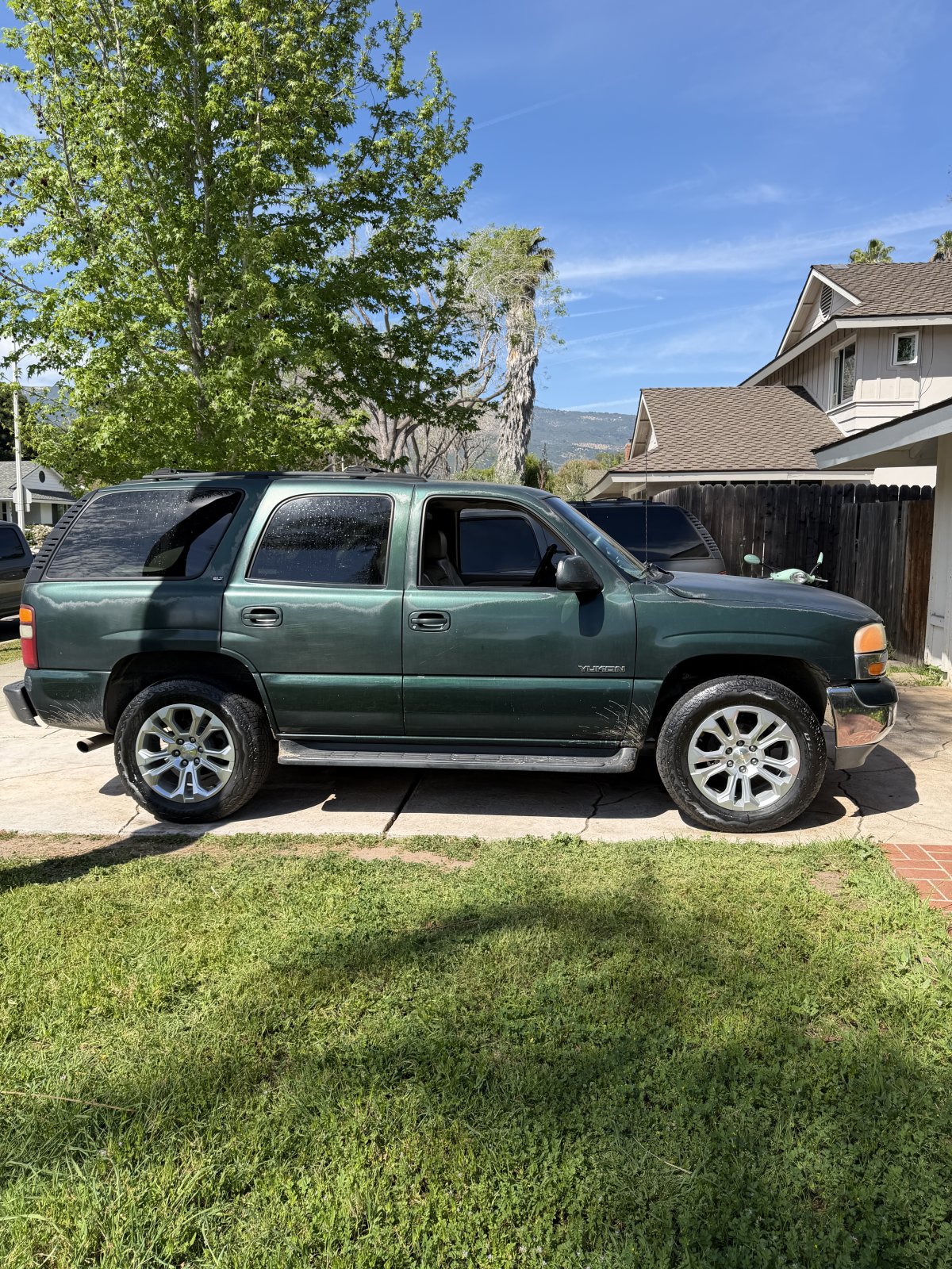

I refreshed the front end on my 2001 Yukon and went from 2021 Silverado 18’s to 2022 Silverado LTZ 20’s with 33’s on them.
I intended to do upper control arms, lower control arms inner and outer tie rods, pitman arm, and idler/bracket but upon further inspection inner and outer were fine looked like they had been replaced at some point and idler and pitman had very little movement so passed on them too.
I went with all ac delco parts, I even got ac delco uppers with 2 additional degrees because I intended on turning the torsion keys to get a level ride height and wanted to do it right and were relatively cheap compared to other options.
Just got it aligned and couldn't be happier with the result.

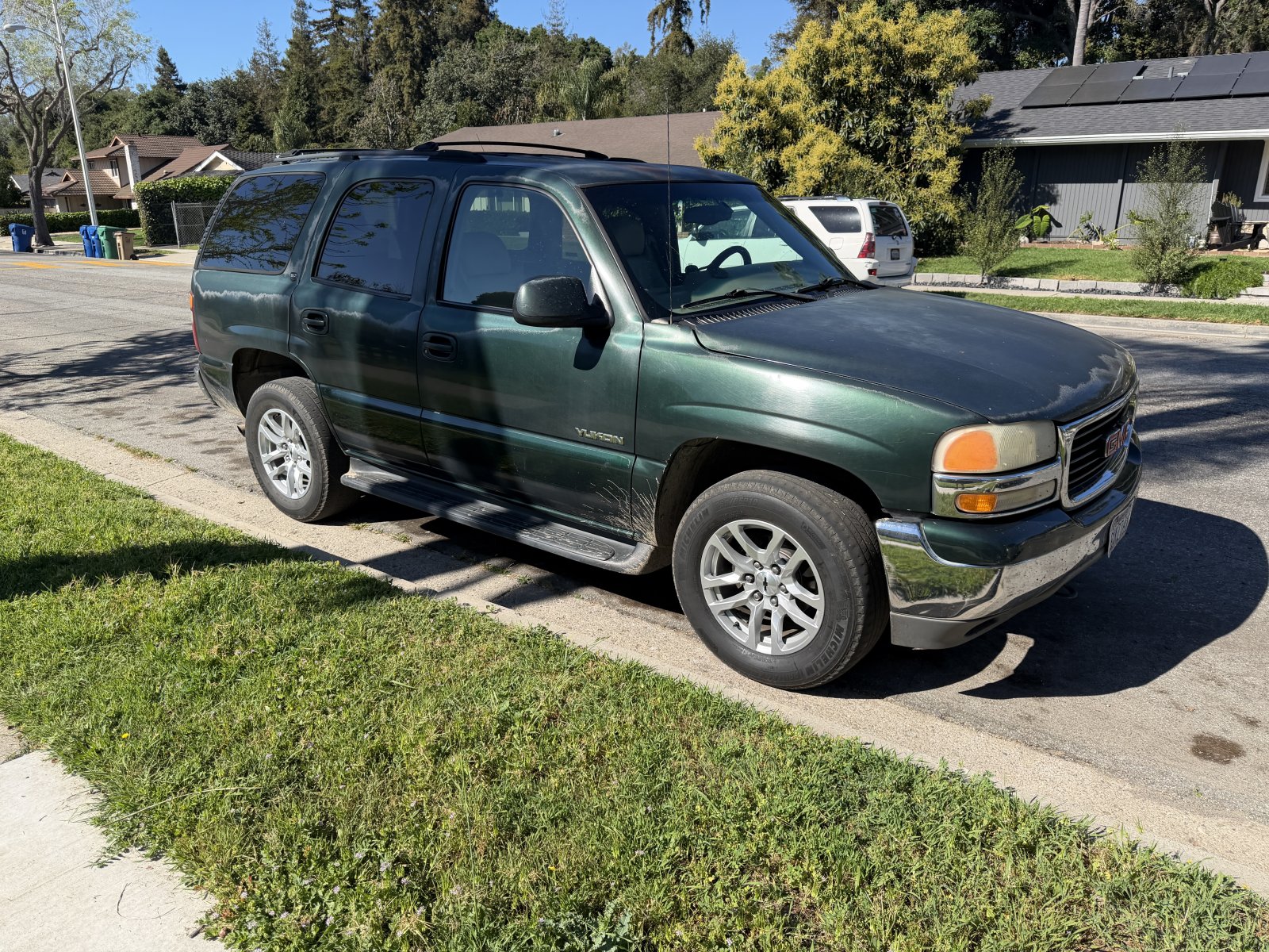

Heres some pics, those 20’s tho really bigger than 18’s! I did 4 full turns on the keys. Ride is def smoother less play overall especially when breaking, little stiffness with the suspension since more torsion on bars but feels good and solid, planted and more fun to drive. No rubbing at all.
