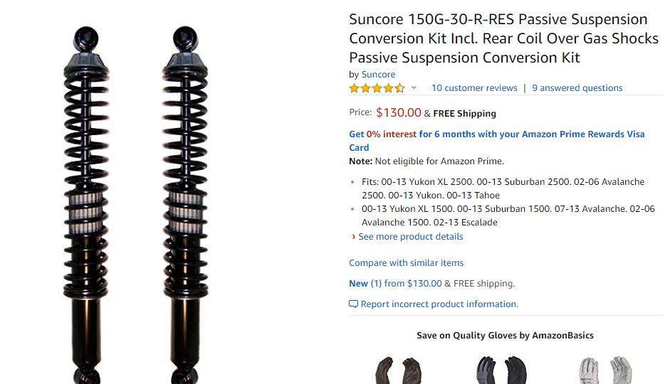

Found another source for the coilovers and it seems that they are designed to replace the air shock system, which I believe uses a standard strength coil instead of the weaker ones with the ZW7...
"Rear New Electronic to Passive Conversion Kit (150G-30-R-RES) by Suncore®. Quantity: Sold as a Kit. With Rear Heavy Duty Gas Shock Absorbers. This is a Low Cost Alternative to OEM active electronic Shocks. This kit will convert your vehicle from Active Electronic Air Shocks to Passive Coil Over Gas Shocks. Replacing your Air Shocks with Passive Coil over Shocks will eliminate the need for the Air Shocks and Compressor. This kit will keep the car at factory height while providing a smooth car ride. How to disable the air suspension light is provided in the instructions.
Catalog more details on - https://www.carid.com/suncore/passive-suspension-conversion-kit-mpn-150g-30-r-res.html#reviews"
So confused... These coilovers are only $90 a pair on CaRiD and would be the cheapest and easiest route to go... If they will maintain the proper ride height...

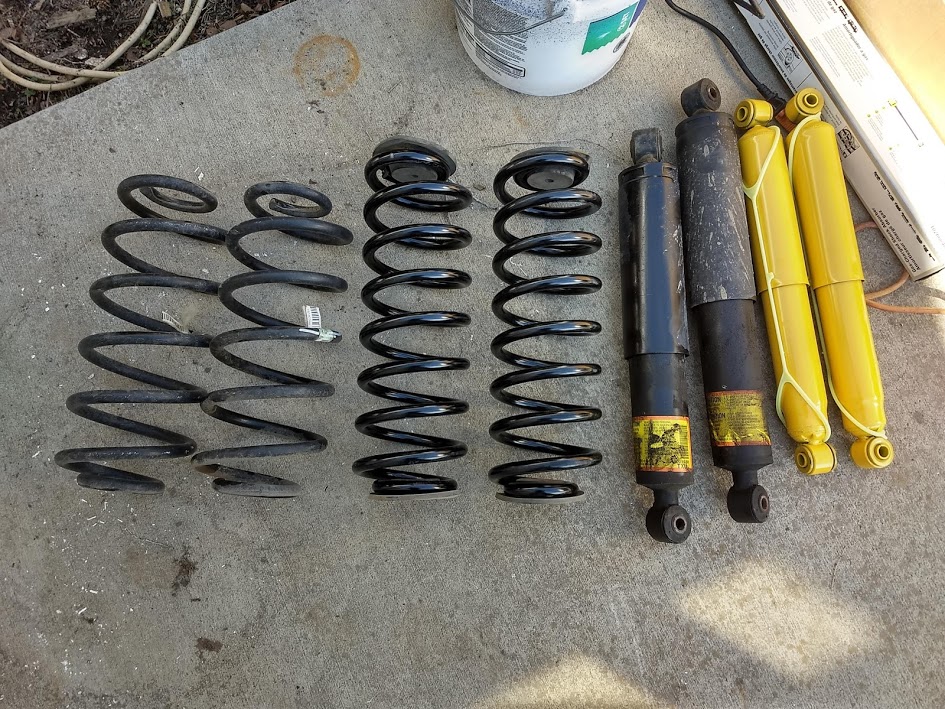

Got in all the parts and the snow finally melted off my lower driveway so had time to do the install today.
Local shop bid the job at $338 for labor only.
Took me just over two hours.
Very non-technical job. Hardest part was getting the rig in the air high enough and safe enough. My floor jack went bad, so had to use a Hi-Lift and a bottle jack. Sketchy, but I lived.
Before install, wheel well opening was just over 36"...
After, it was over 38"...
Was told about an inch of lift with the Z71 springs, so was surprised at the 2". Will likely settle after I drive it a bit.
Old shocks were just toast with fluid leaking everywhere and could just be moved up and down by hand easily.
Front was previously lifted 1.5" by cranking the torsion bars and was a little higher than the back. Now, it is back to factory stance, but hopefully it will settle. No road test yet, but will do that in an hour or so.
