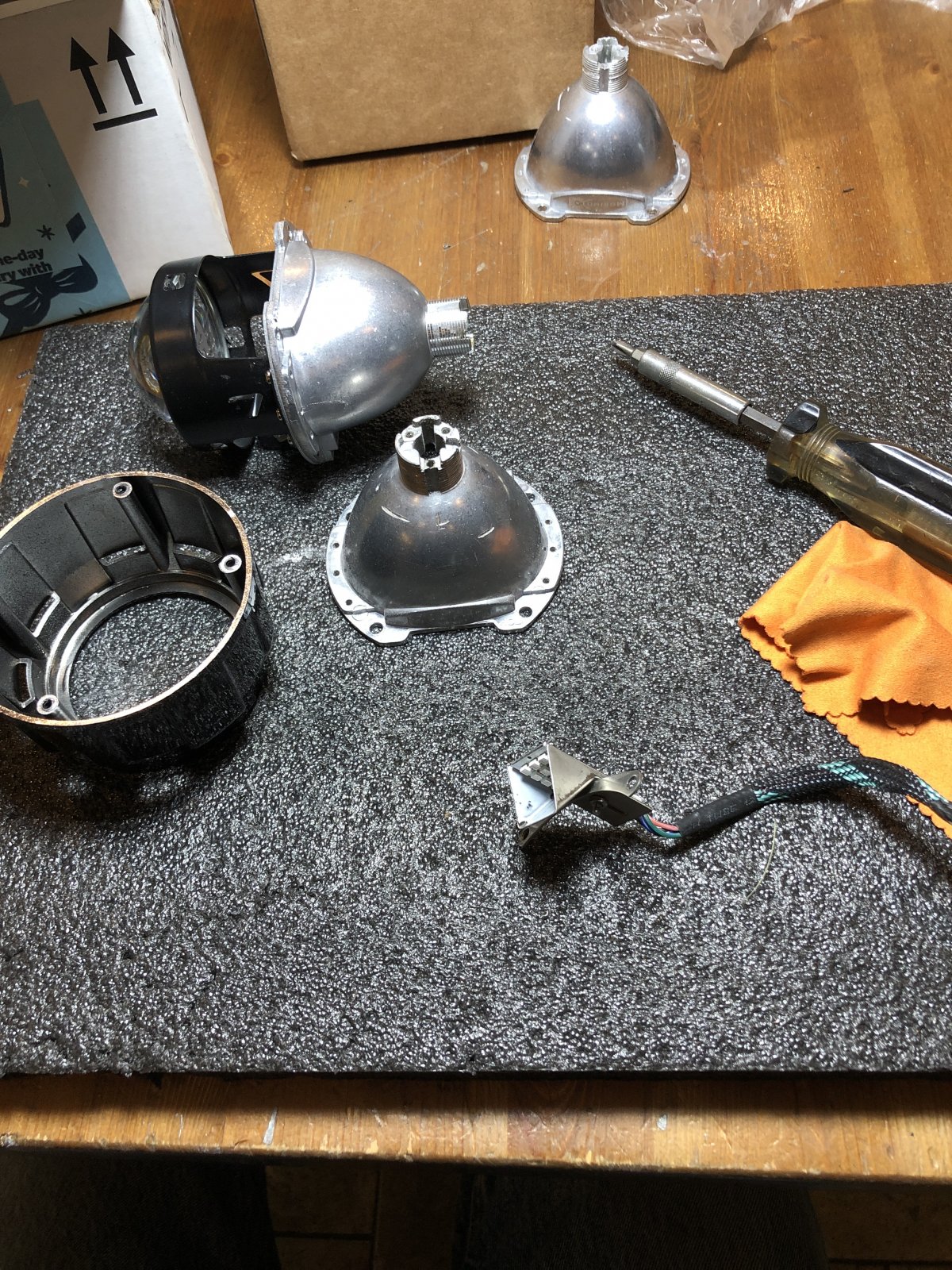

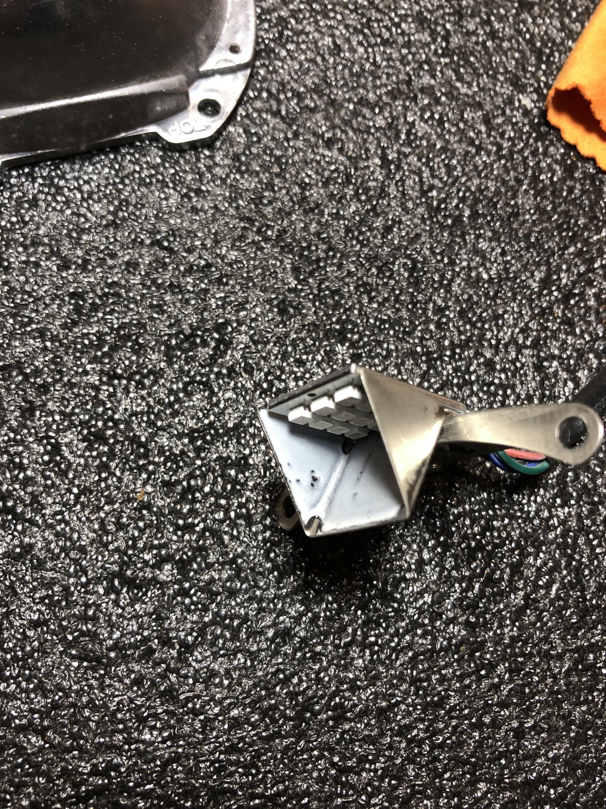

One of these little demon eyes failing caused me to totally rebuild my headlights.

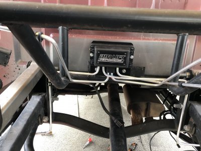

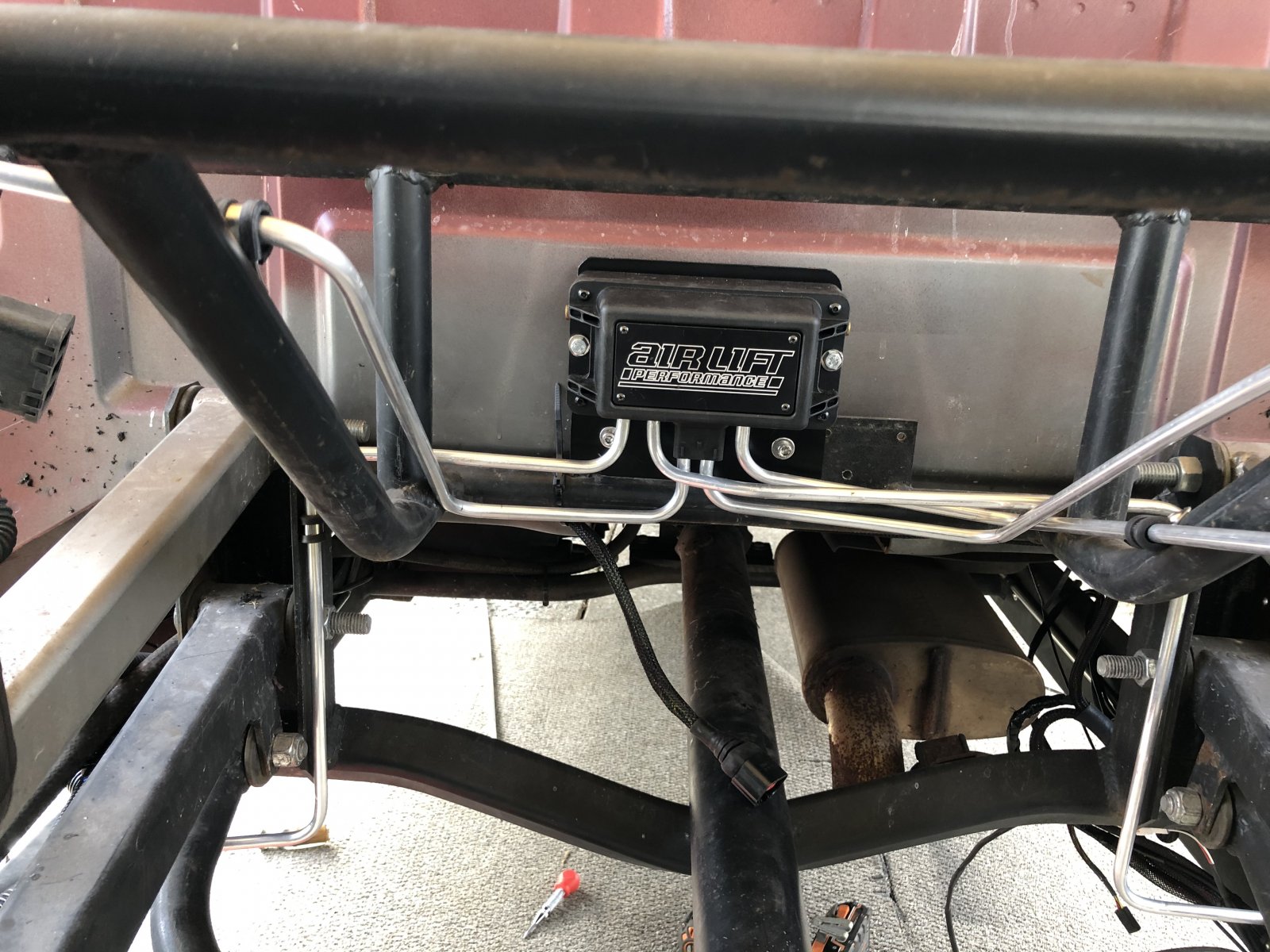

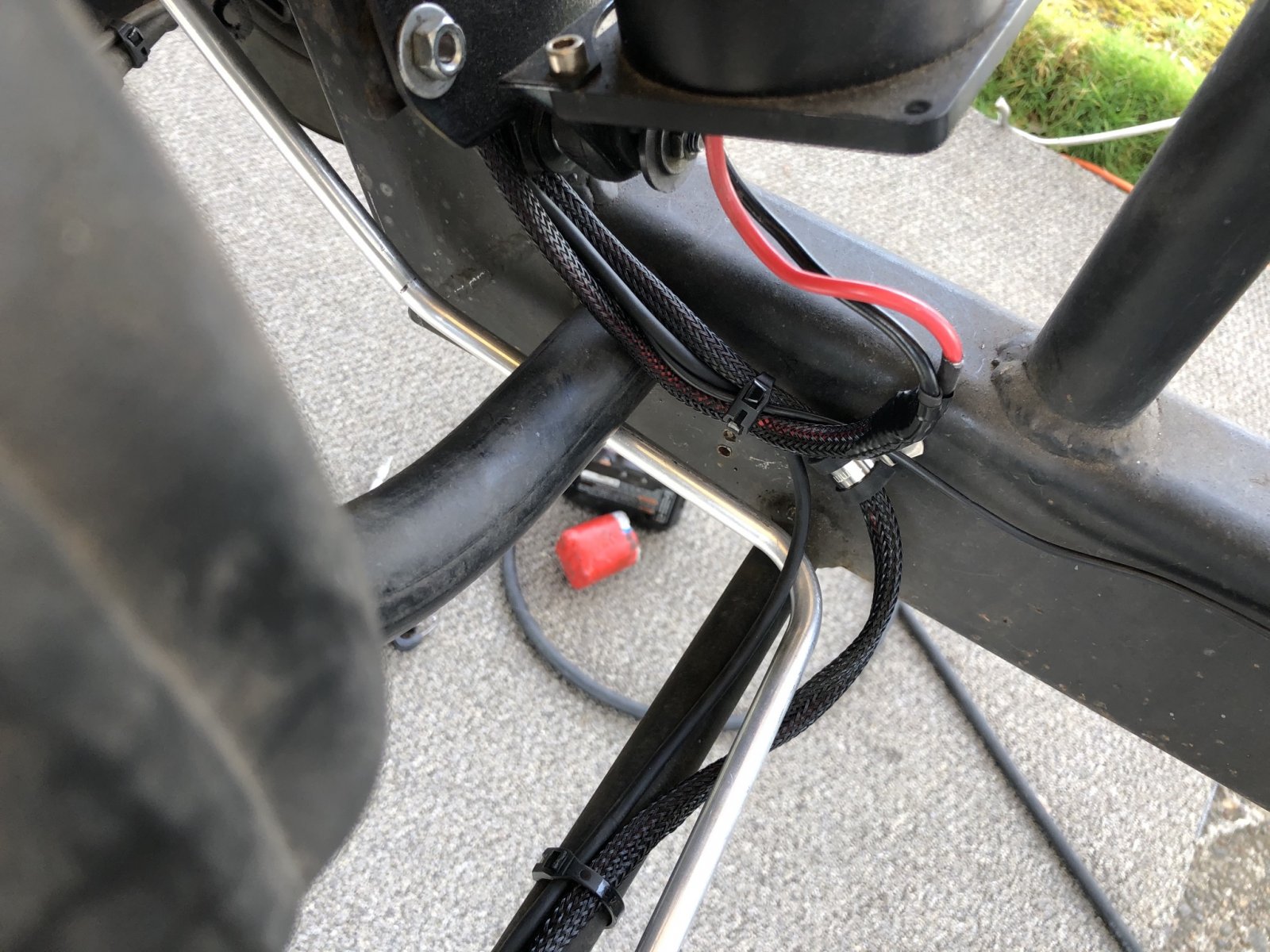

Trying to keep everything as clean as possible. There’s a lot of stuff between wiring, relays, air lines, filter, etc. I am shortening or lengthening the harnesses as needed using soldering and heat shrink so there isn’t a bunch of extra wire anywhere.

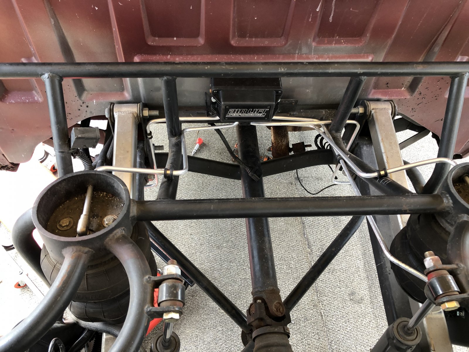

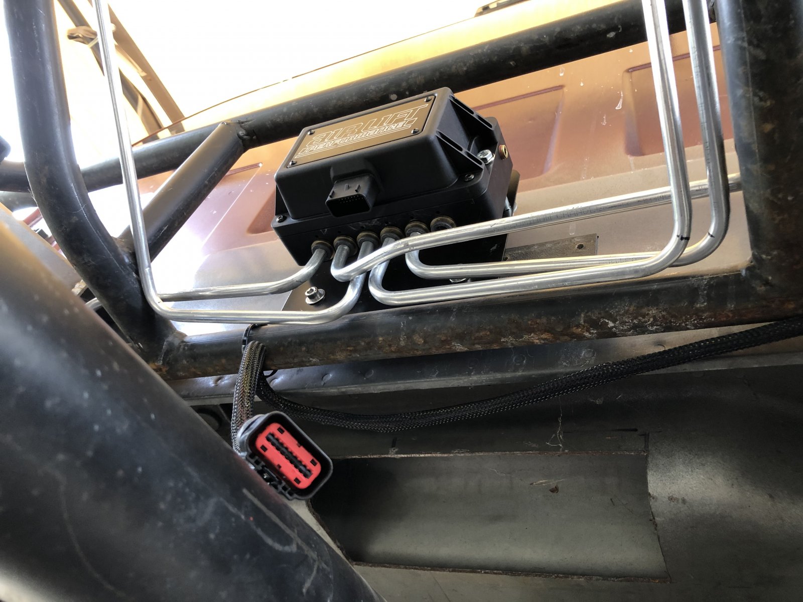

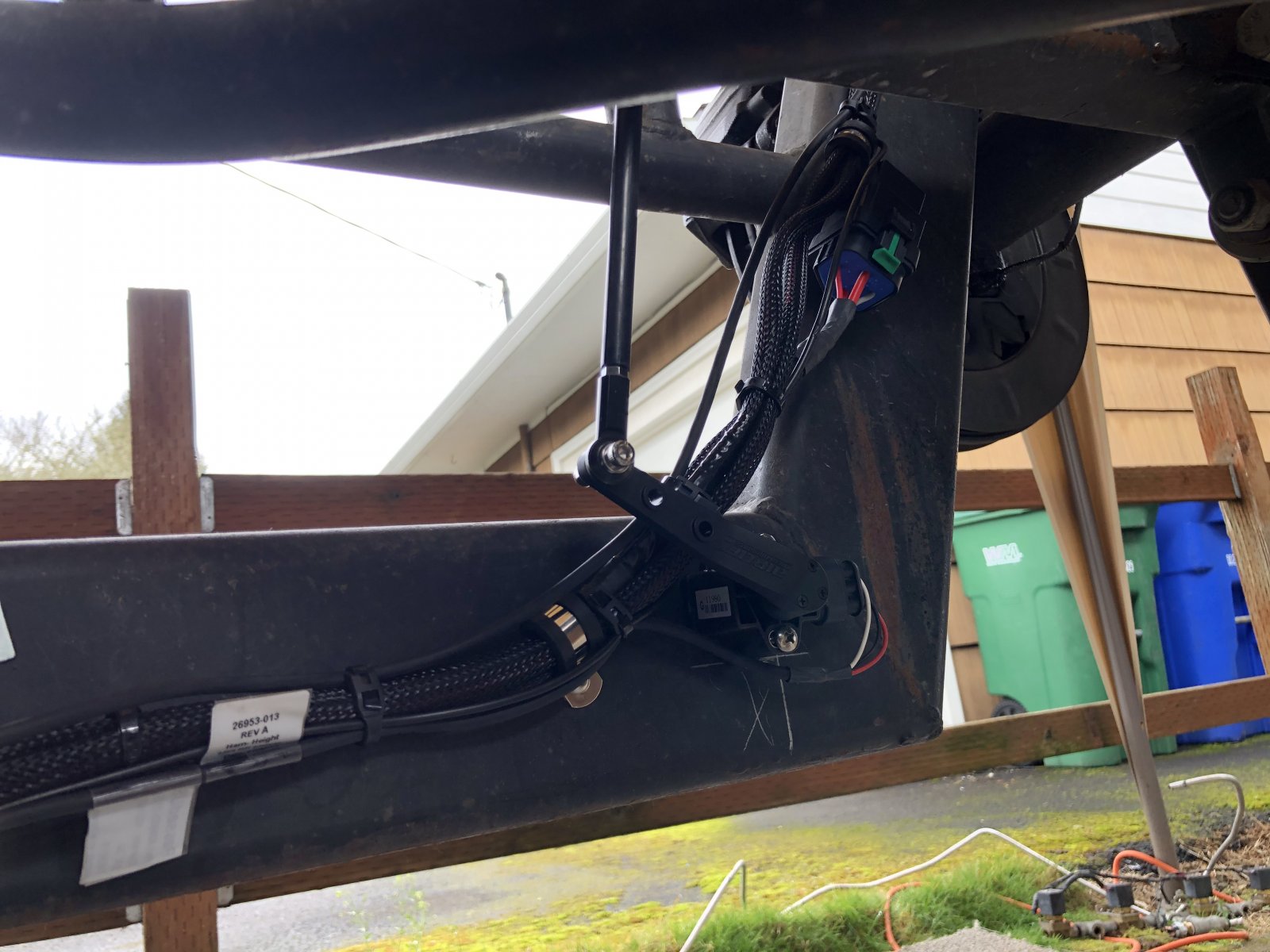

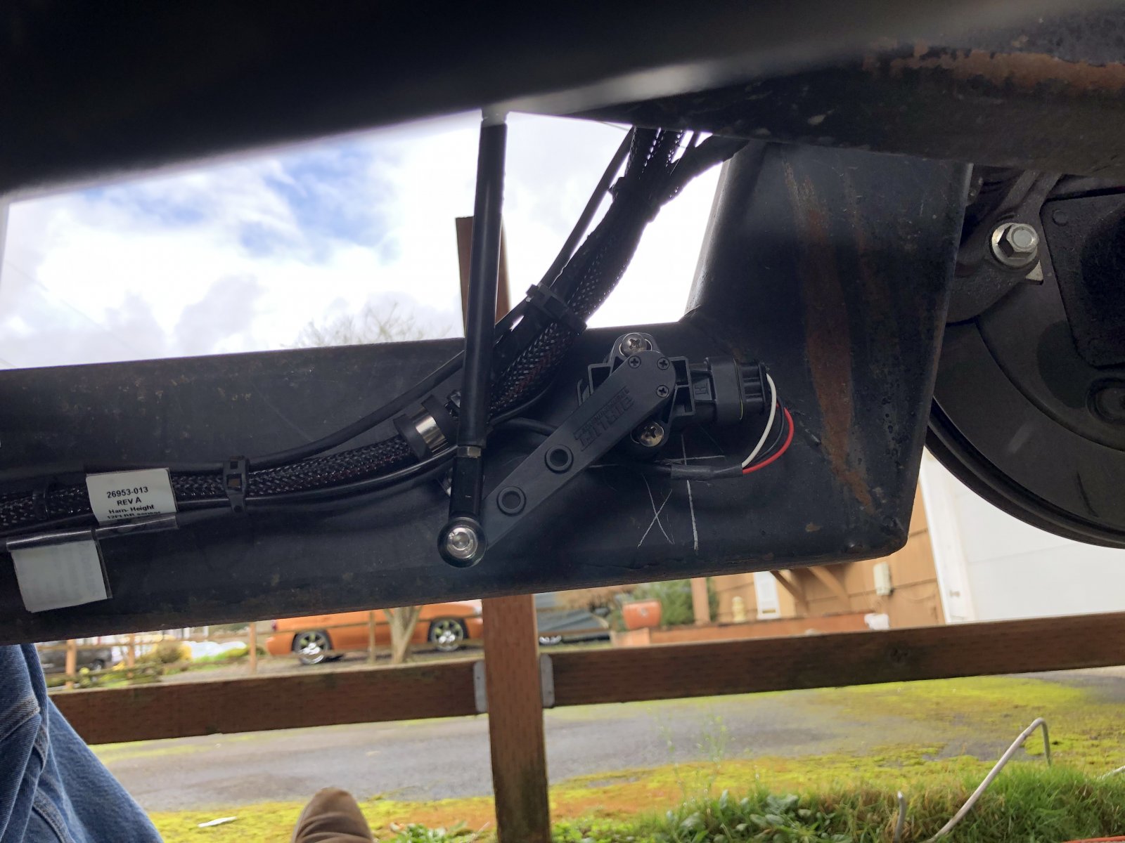

The rear is complete- hard lines, sensors, harnesses, compressors, filter, etc. Here’s the rear height sensors with the suspension fully aired out and fully aired up. The arms look close to the bottom of the frame in the one pic but that’s when it’s aired all the way up ( which I only do when jacking it up) so the frame is way off the ground at that point, and when it’s laid out and the frame is on the ground, the arms are at the upper position.

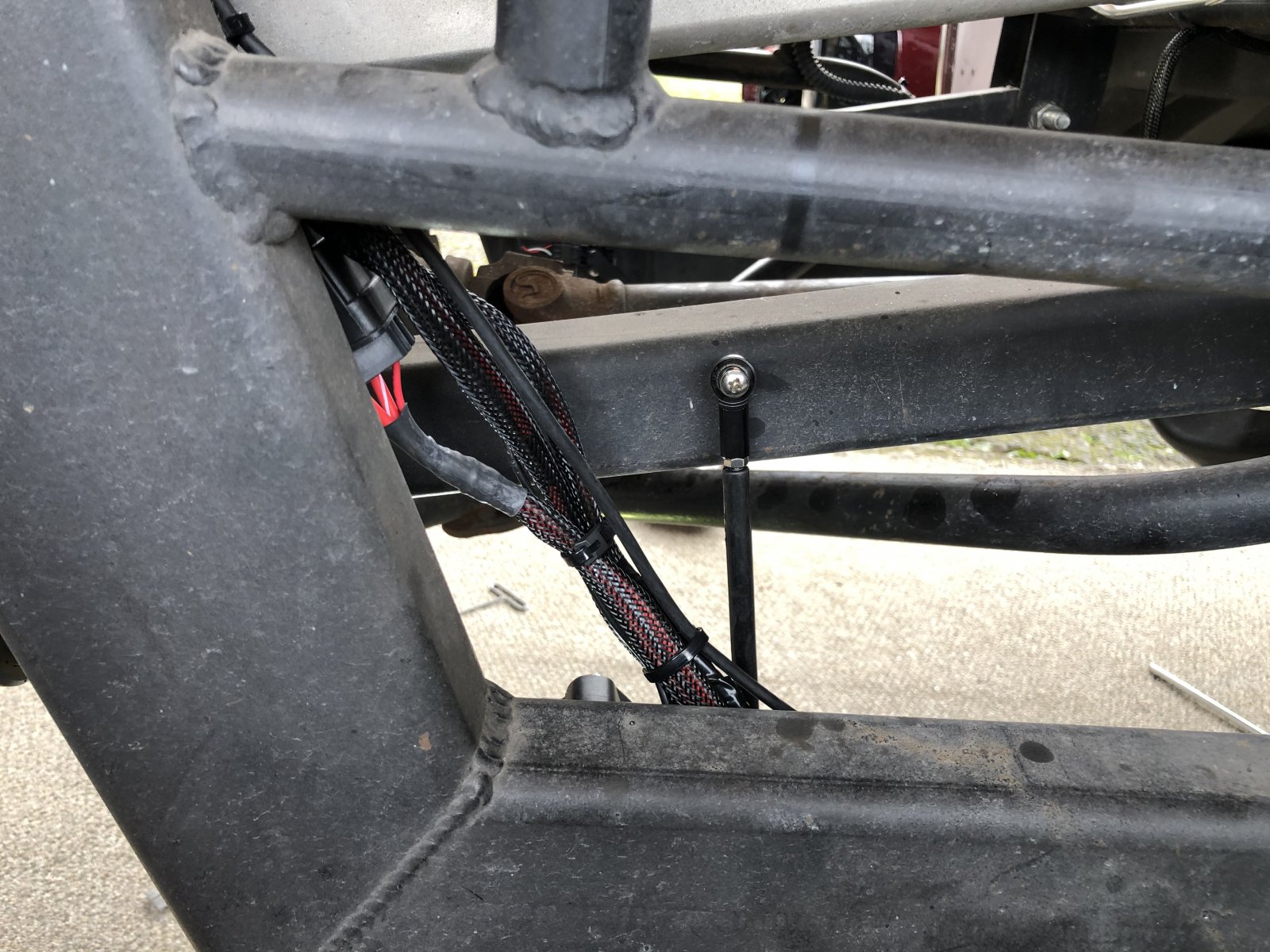

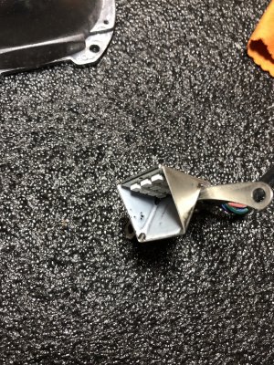

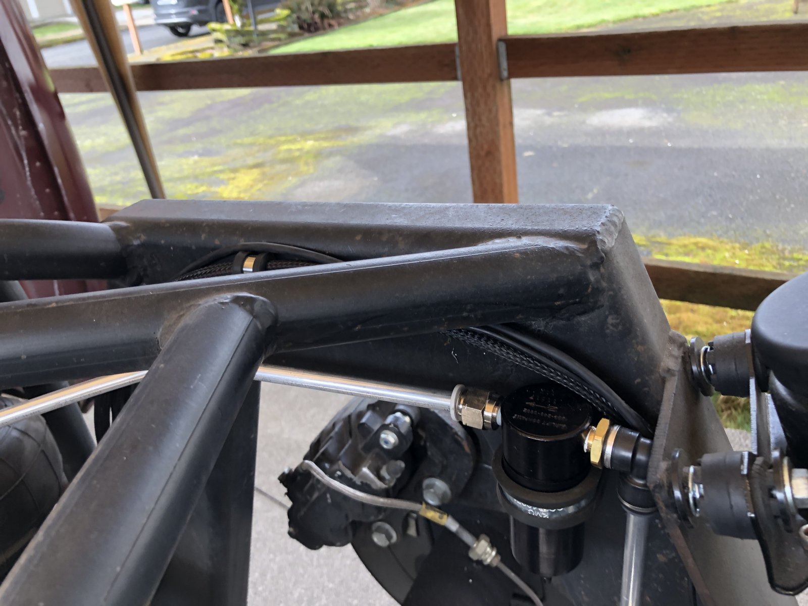

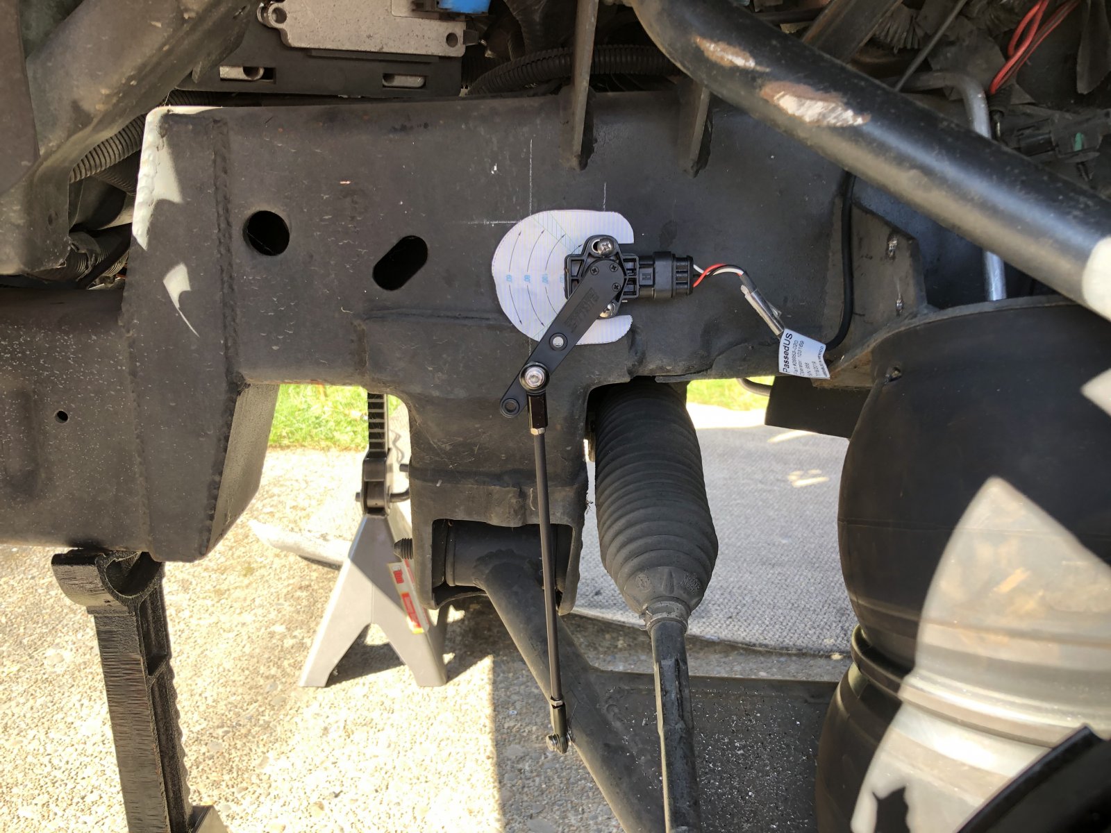

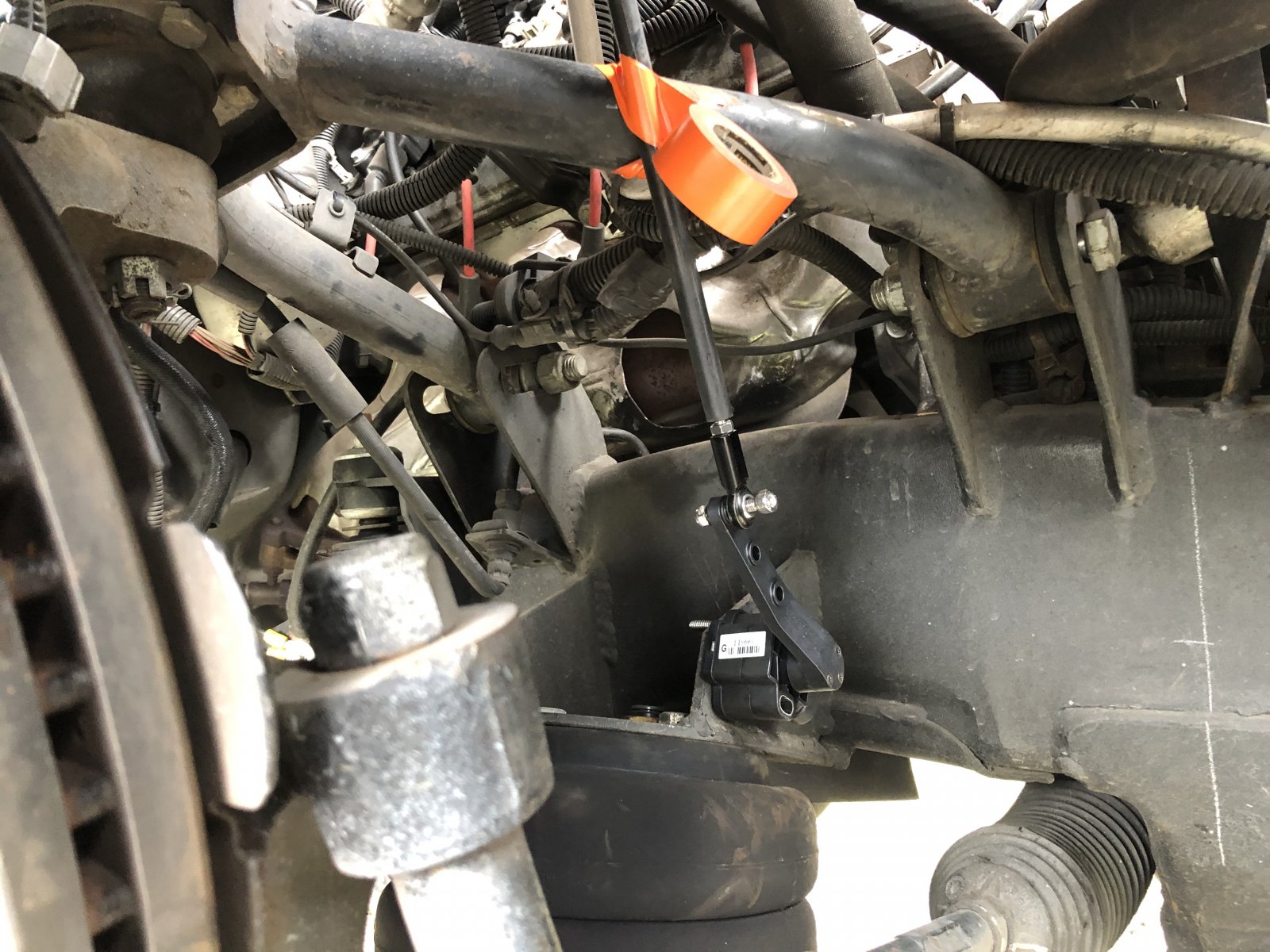

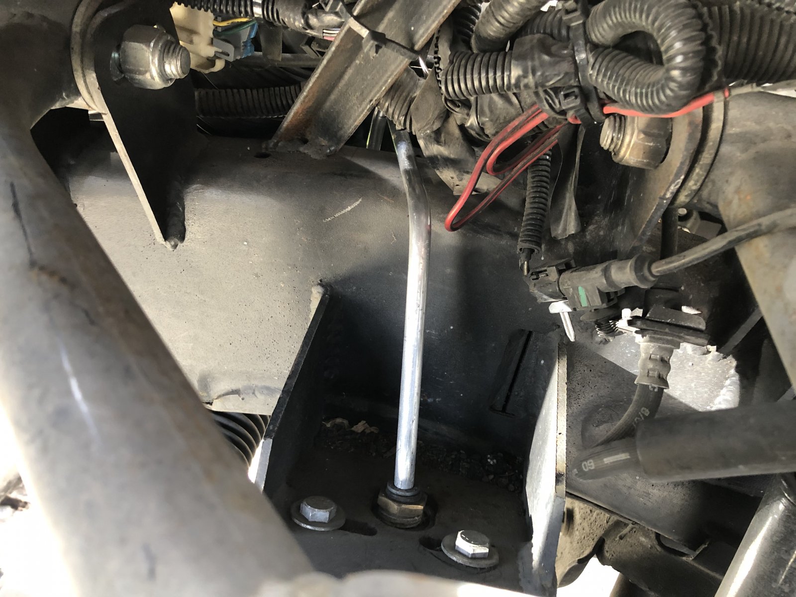

Front sensor mockup. I worked quite awhile before I came up with a location that didn’t interfere with the steering or bags and was outboard far enough that there was enough travel to be accurate. This is the spot. I ordered some clamps that will go around the control arms that I can mount the rod to, Amazon will deliver them tomorrow. I’m gonna sleep on it tonight just in case I’m forgetting something before final mounting and adjusting tomorrow.

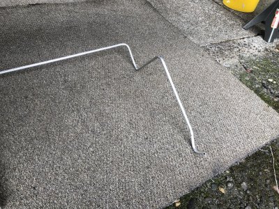

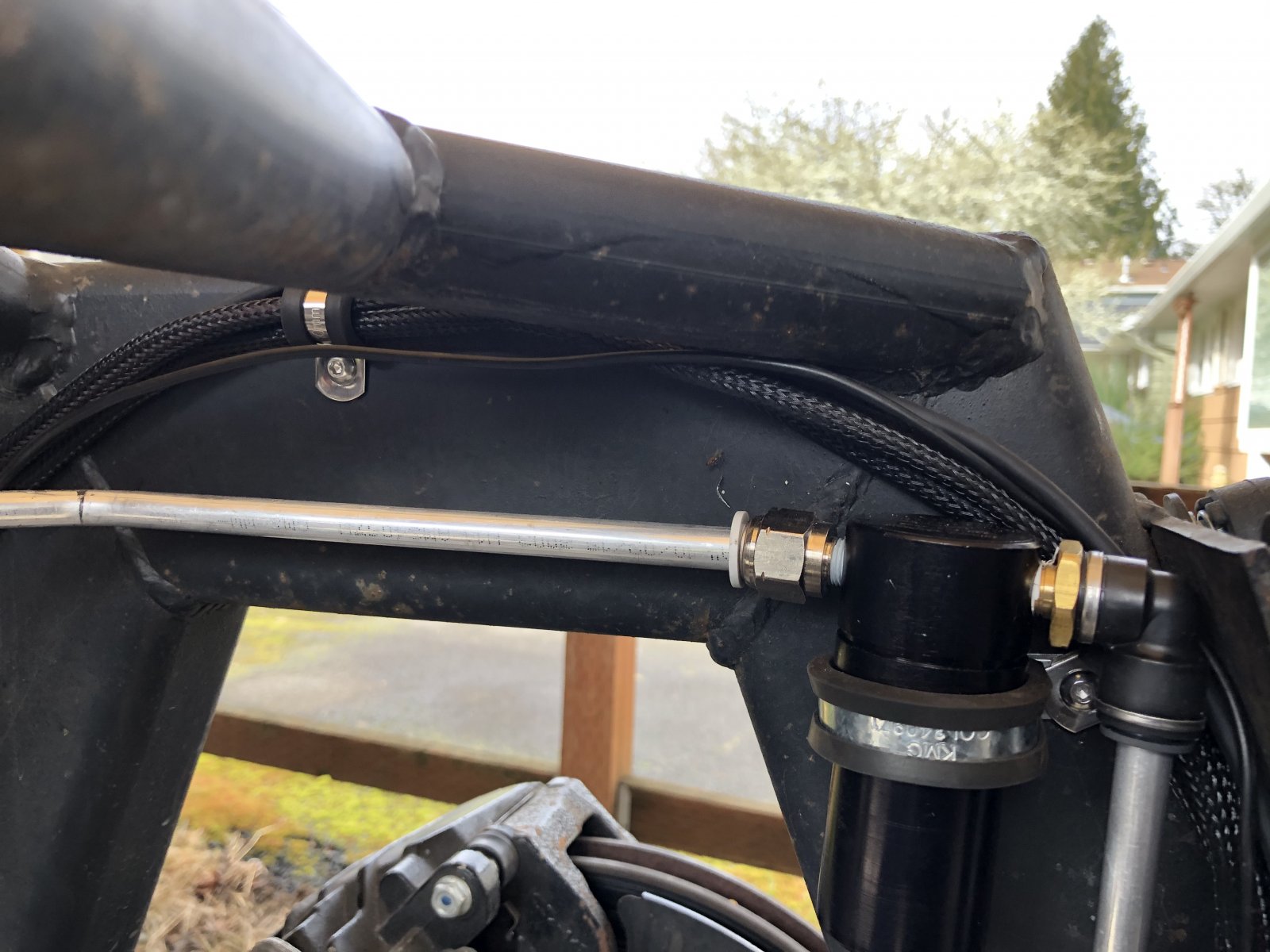

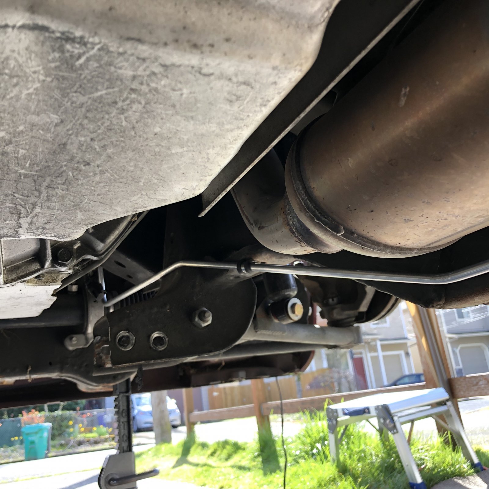

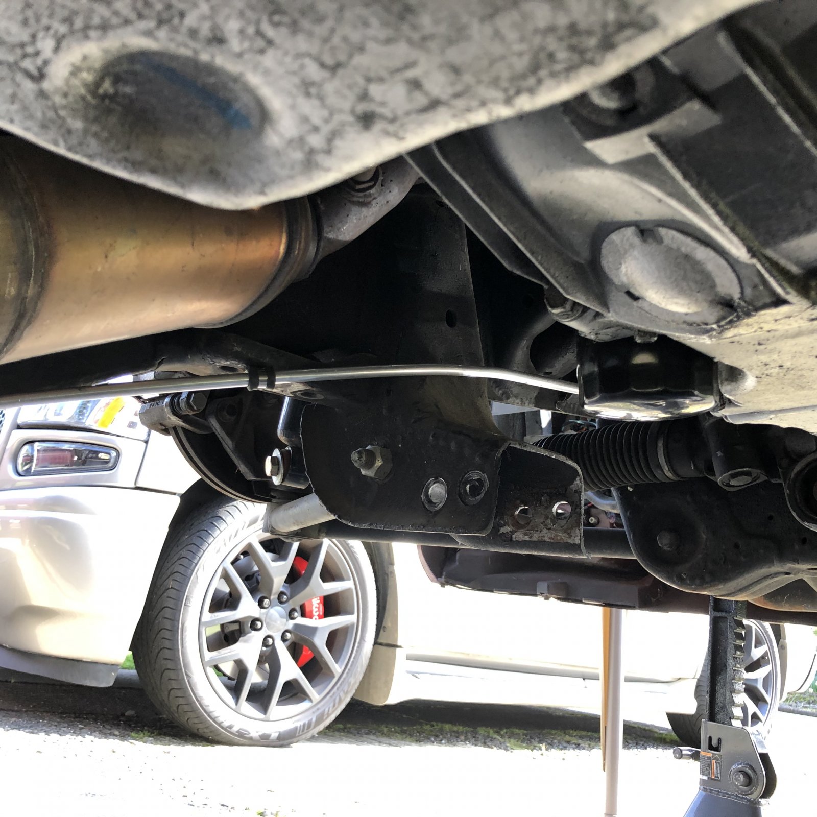

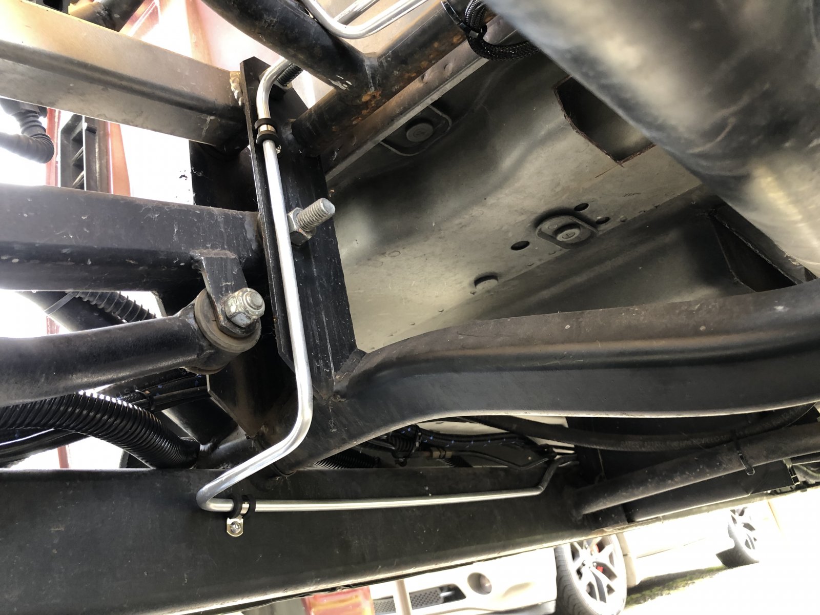

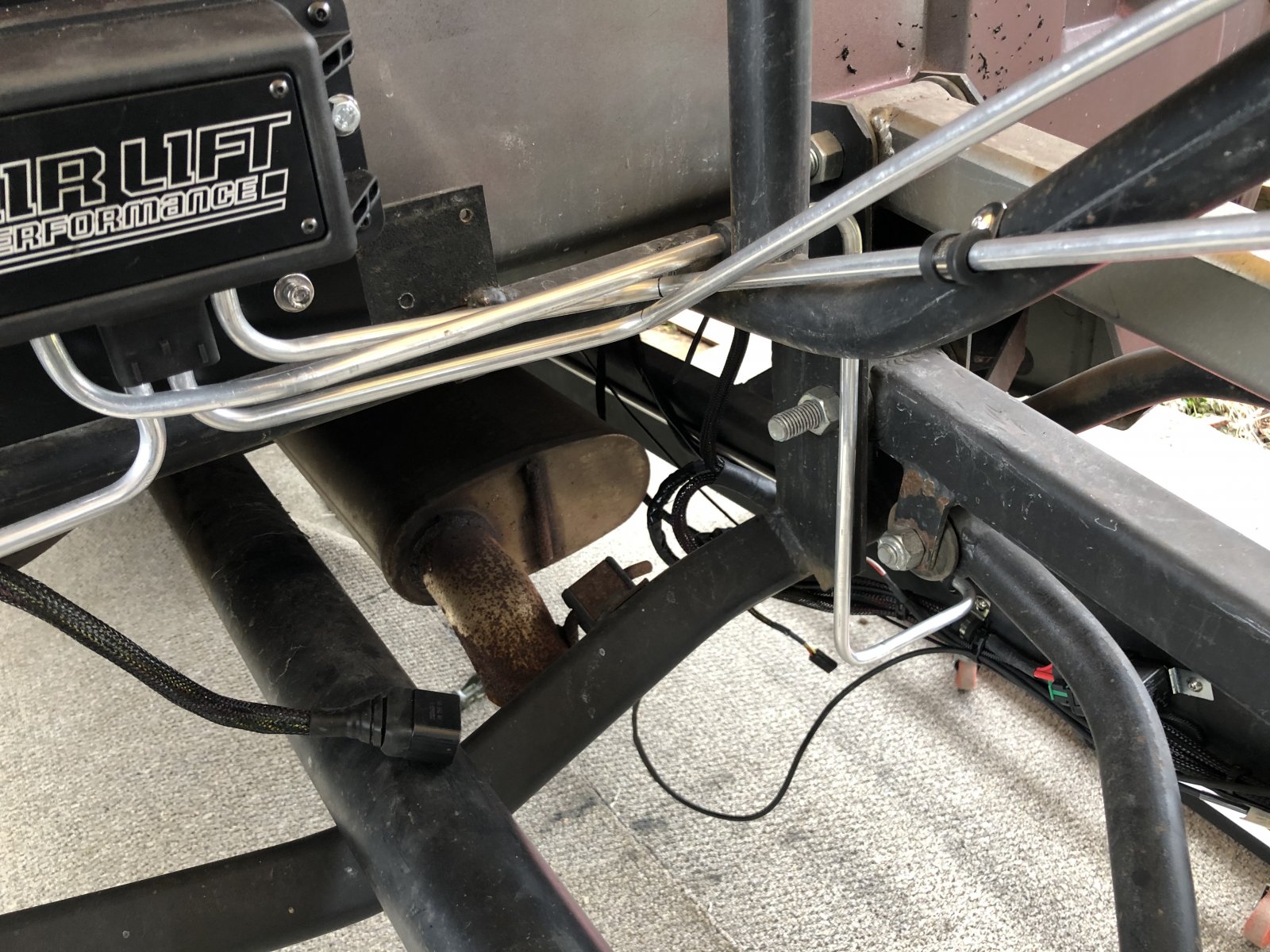

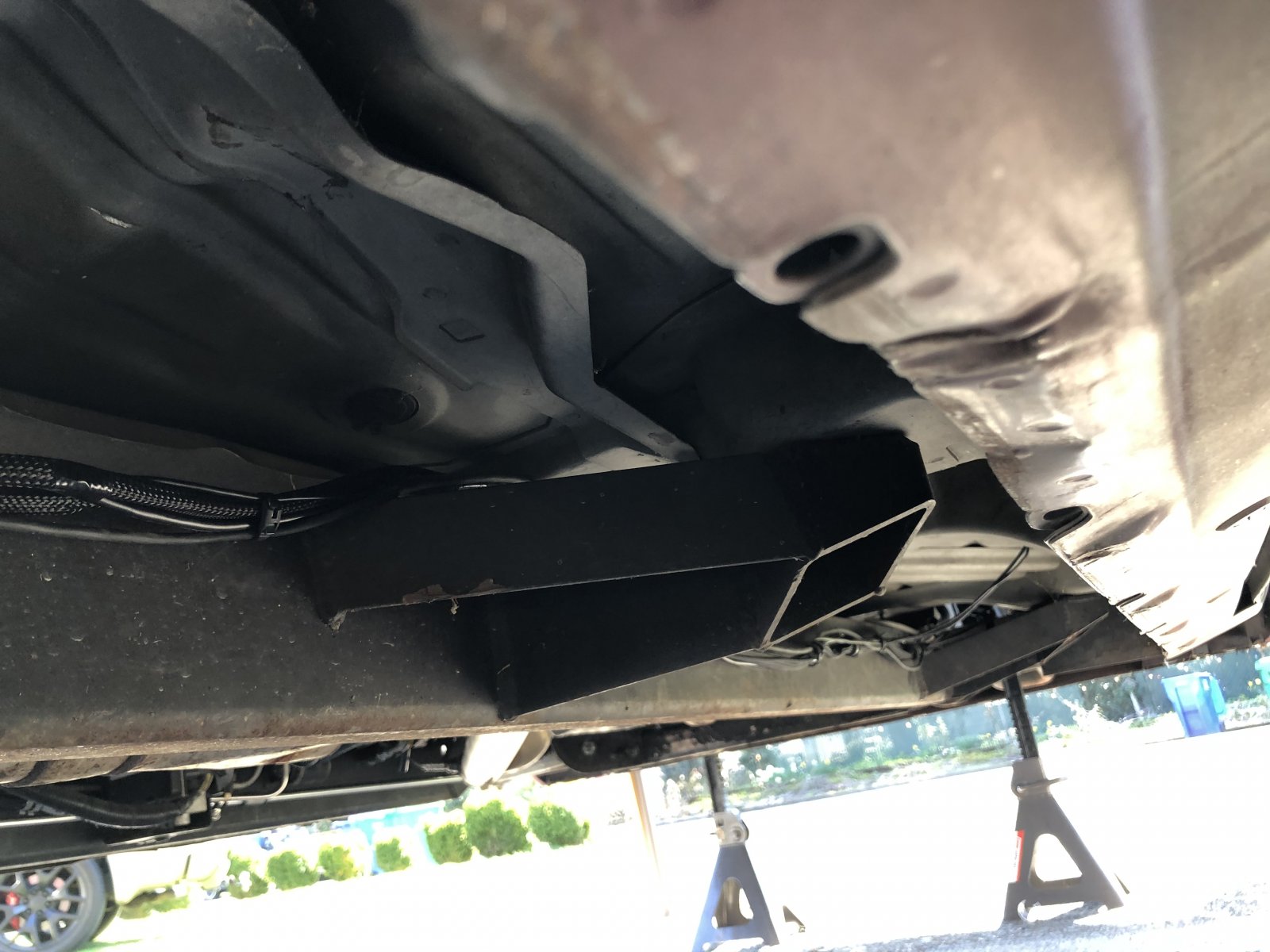

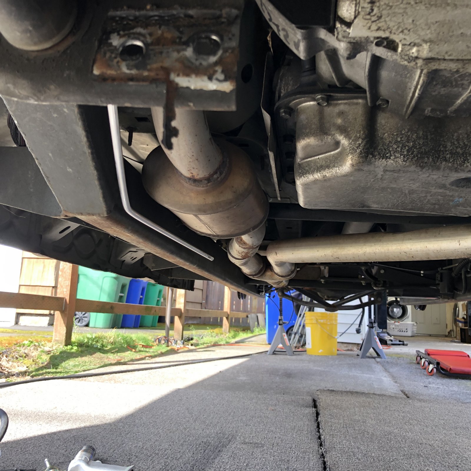

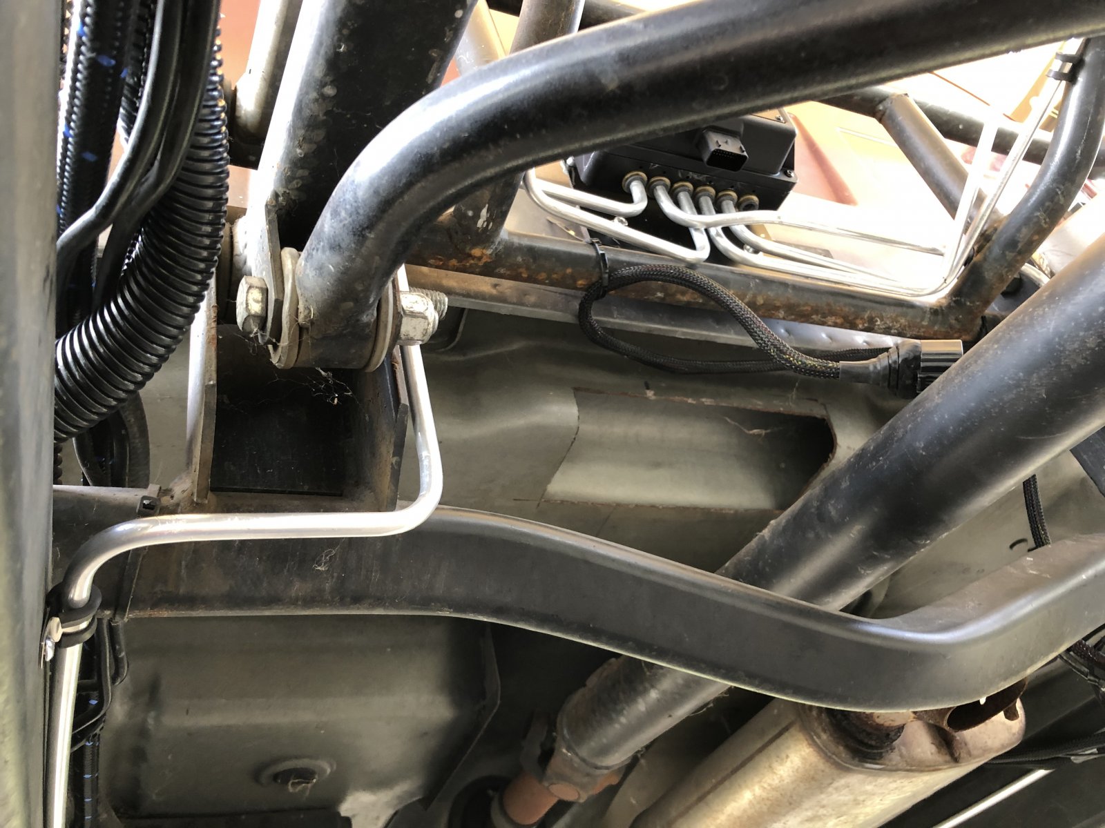

The one on the driver side was definitely the hardest yet. It had to go around the charcoal canister but the worst part was just getting it into place after I got it bent into shape.
View attachment 241999 View attachment 242000 View attachment 242001 View attachment 242002 View attachment 242003
Looking good!
Reminds me of the time I had to replace the brake line that ran to the rear on my 1976 Impala in the parking lot at college. Bought a number of lengths of pre-flared brake line and a cheap tune bender.
52,954

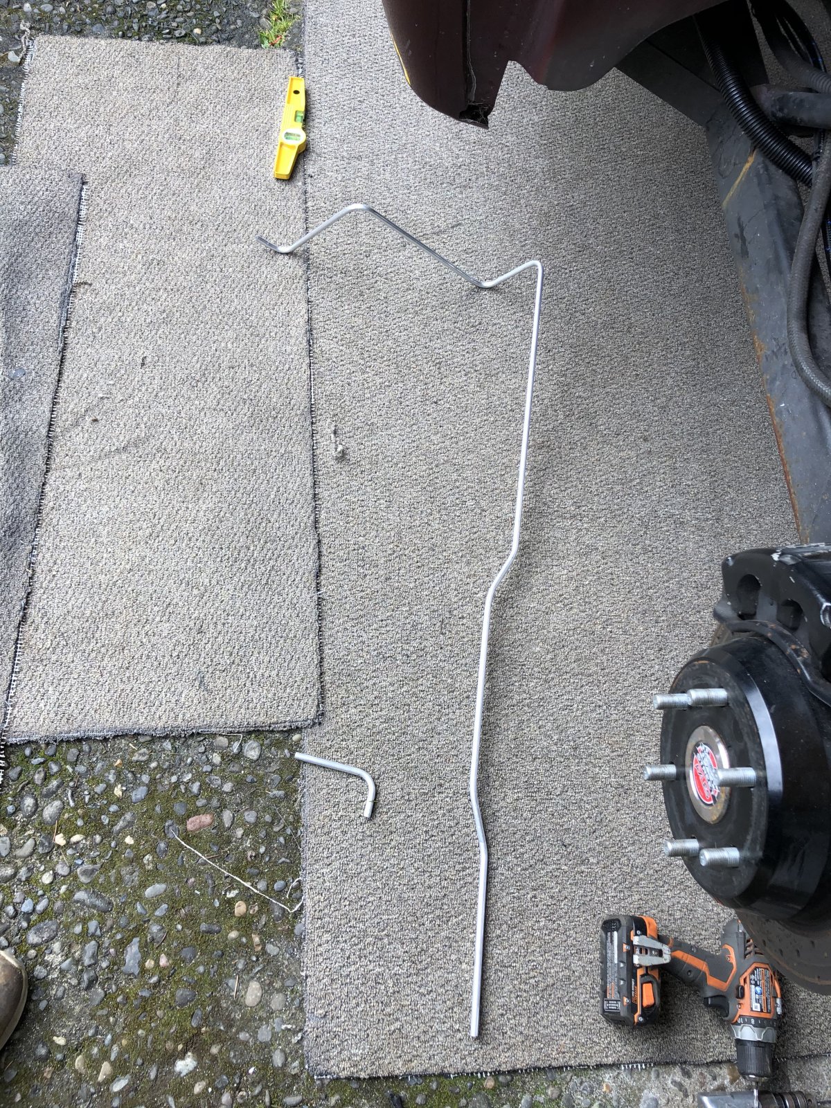

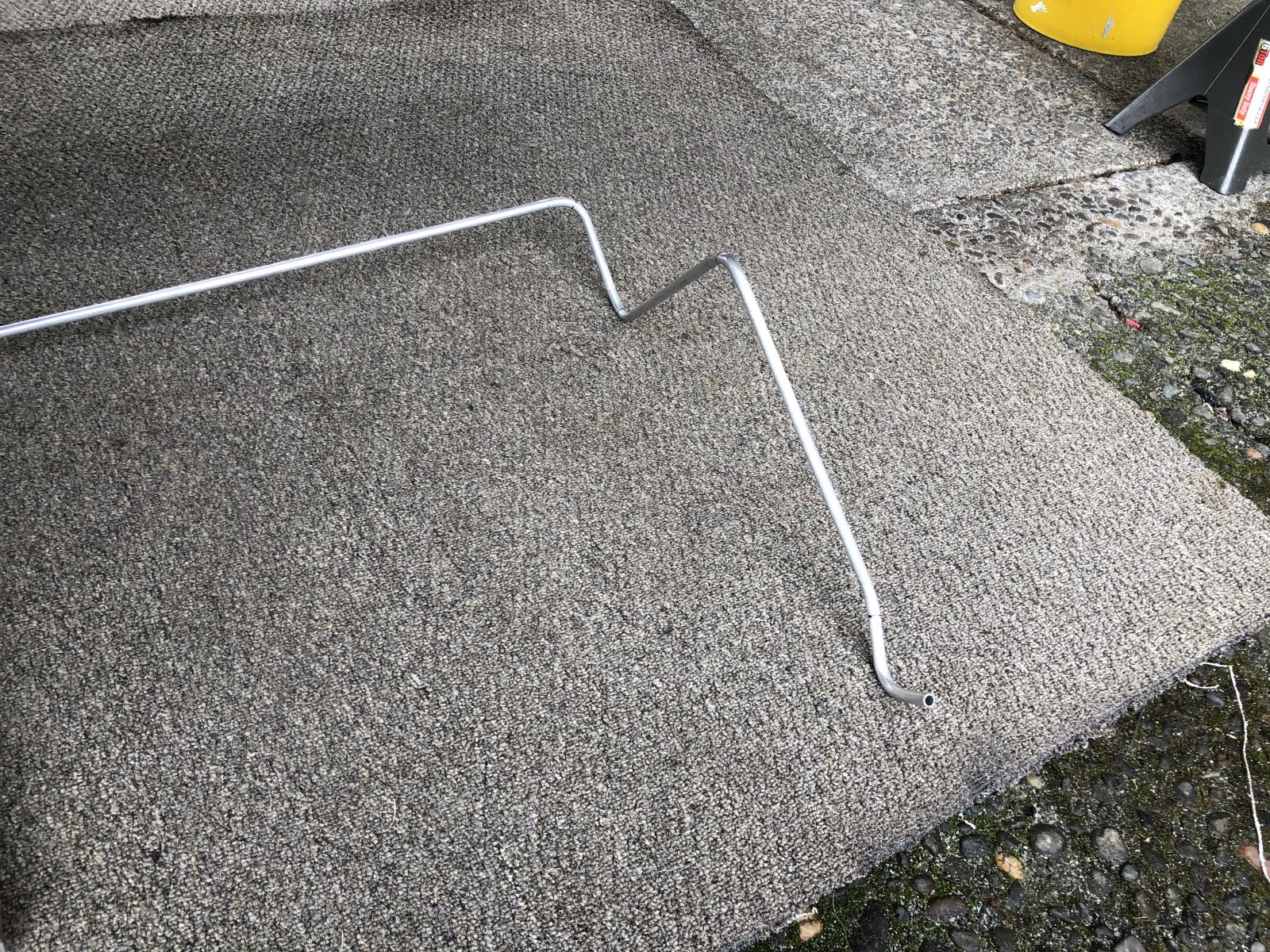

Thanks guys. I won’t lie- the front sections were a challenge too. The way they had to wrap up over the frame and then follow the angles underneath made it difficult to route and bend, and then getting them in place was almost impossible. And now all I have is the middle sections which I found out I needed since (2) 6’ pieces on each side wasn’t quite enough. Those are simple pieces which I can’t do today because I ran out of tube. If I hadn’t made a couple mistakes I would have had enough. I already have it set for will call tomorrow morning. I will still have less connections than originally.

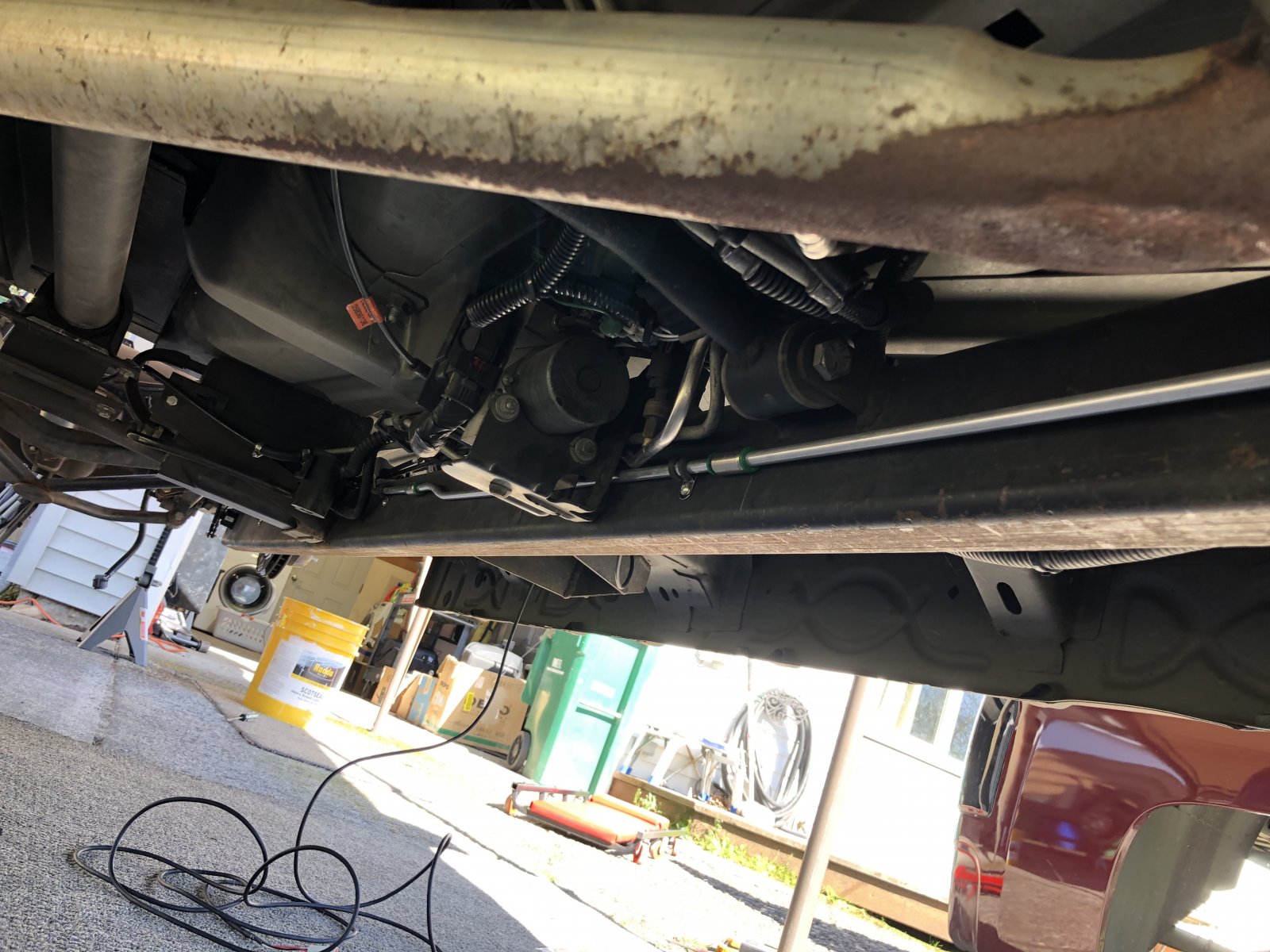

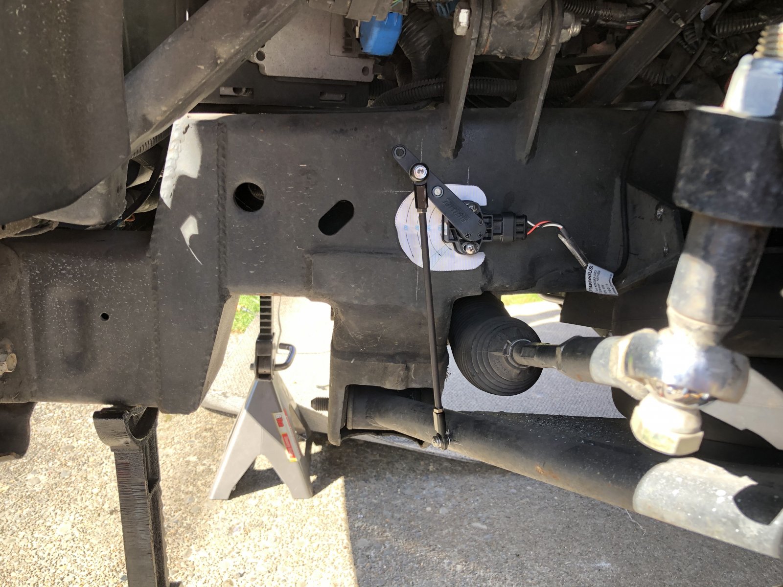

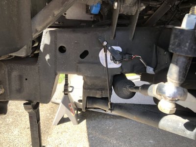

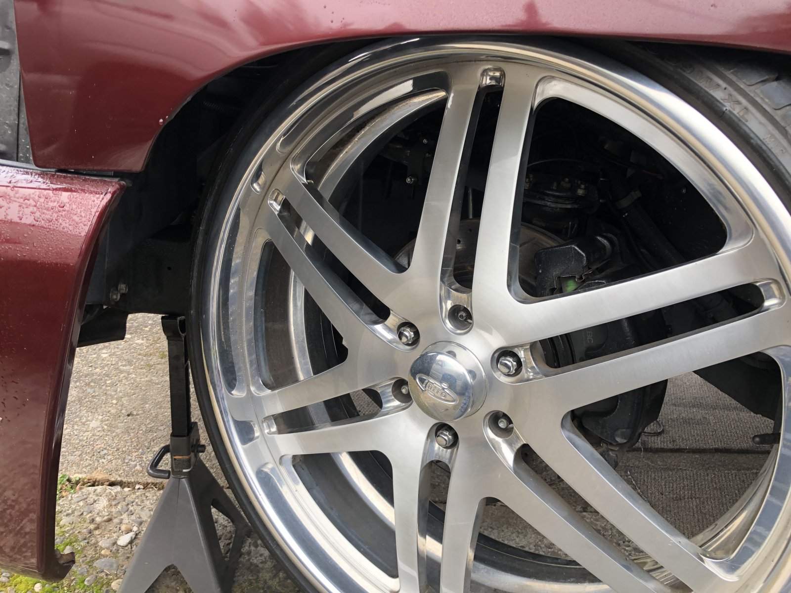

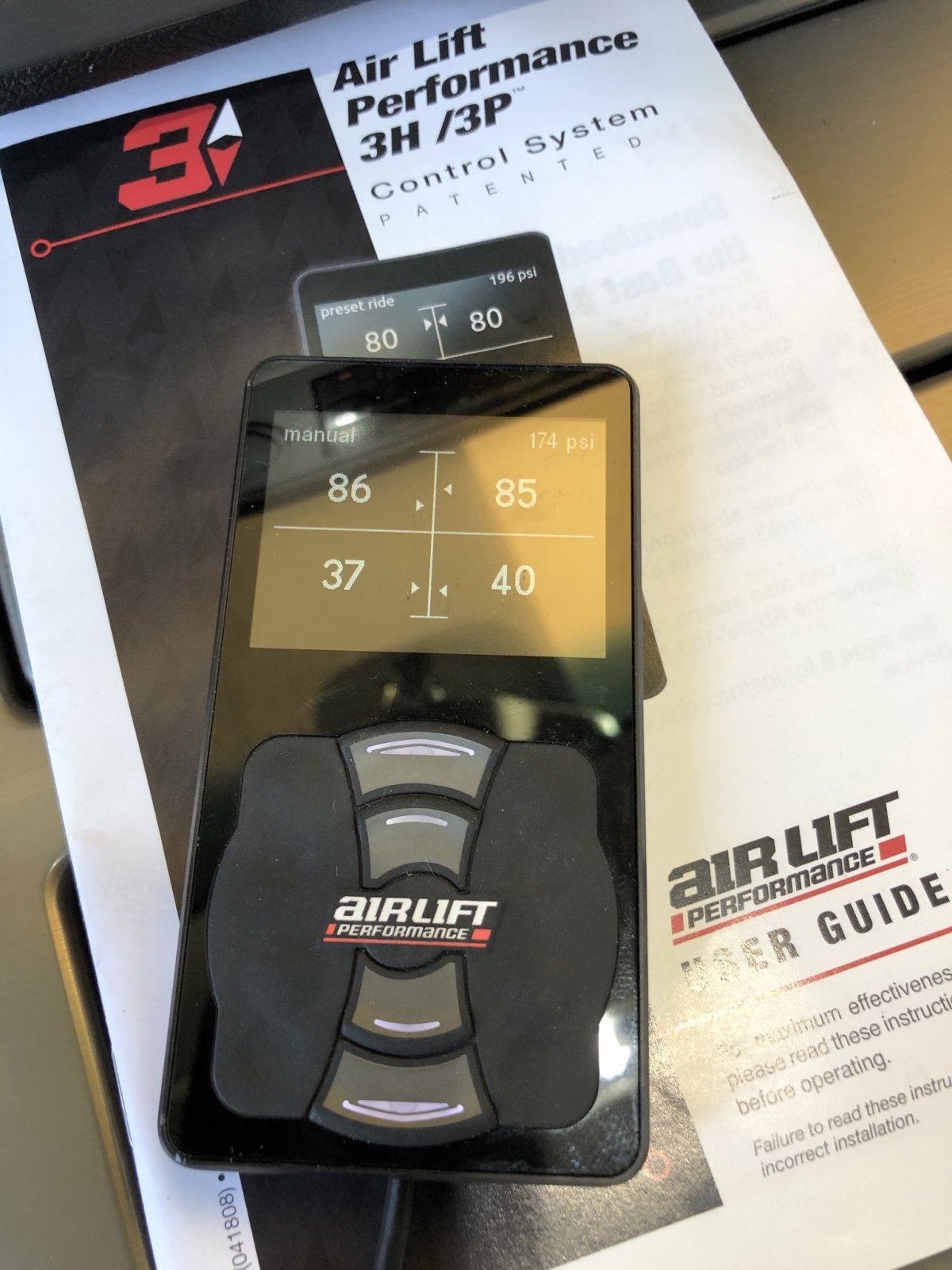

I finished the front hard lines today and mounted the height sensors. Then I finalized the install of the front right or so I thought. I decided to hook the system up and check for leaks and things got complicated and went a bit sideways. First, the system wouldn’t fire up. I thought my add-a-circuit in the fuse box was defective because I had it connected to the fuel pump fuse and I knew that fuse worked because I pulled it to work on the fuel line and it shut off the pump. But I checked for power on the lead going to the manifold and nothing. So I cut that thing off and used the copper thing that wraps around a leg of the fuse and tried again- nothing. Then I checked for power at the fuel pump fuse and....no power. WTF? I’m thinking it fuses the ground circuit? Anyway I hooked to the ECU switched fuse and bam. Then I started calibration of the system and the LR bag wouldn’t hold air. I swapped out the line for a plastic one and started calibration. Twice the compressors quit working, error message said they “froze” wtf. Anyway I downloaded a firmware update and re calibrated and while it was looking for leaks on the front I checked the bags for clearance to the sensors while they had 160 lbs in them and that’s when I noticed the control arms had moved waaaaay farther than I had anticipated and the sensor was so far out of range I’m surprised it wasn’t broken. Seems the diff makes the rear hand at the limit of travel but the fronts had nothing hanging from them and even though I had pulled down on them it wasn’t enough to simulate full travel. Hopefully I can find some allthread in the right thread pitch ( probably metric) and also didn’t mess up the sensor. I will redo those. I reinstalled the LR hard line, it needed a slight bend where it entered the bag in order to slide in right. I did get the system calibrated without height sensors so that’s a plus and the compressors seem to be working right so some good some not so good.

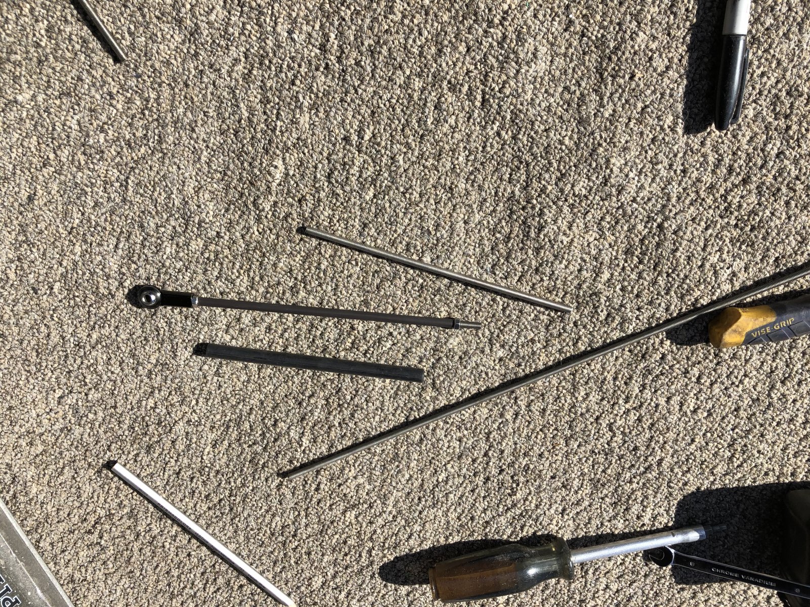

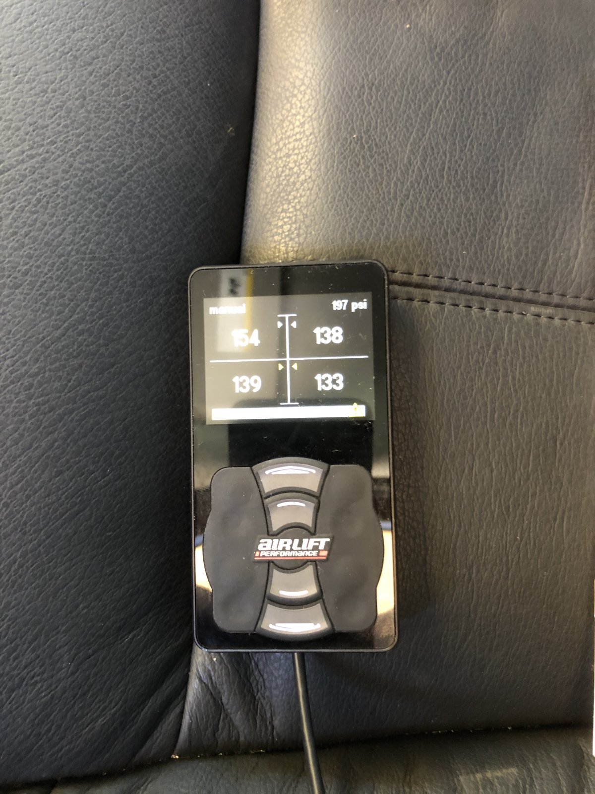

Well well. Today I got everything finalized for the most part. I reinstalled the front sensors where I was pretty sure they would work now that I could inflate the bags and fully cycle the suspension. Then I put the wheels on, dropped it on the ground, and discovered the LR line was leaking bad at the manifold instead of the bag this time. I was hell bent on checking the height sensors so I just let it leak while the system performed checks which took forever since it kept waiting for the pressure to build in the tank. I had to cut some of the linkages and lengthen others by adjusting the all thread in the end pieces. ( I did find stainless all thread this morning) I did finally get them all within range at full up and laid out. I used a piece of plastic tubing after that instead of the hard line and it looks like I need to re bend a line. Then I spent a couple hours messing with setting the system up. Here’s a video of the first attempt at setting a ride height preset. I’m using the height sensors to do this right now. The thing seems possessed but it does settle into my preset after a minute. I will have to adjust the front up another inch but it was cool getting this far. This is using my phone for a controller. After it settles I am messing with front up/ down and rear up/down. I like having control of all 4 corners and seeing the tank pressure.
