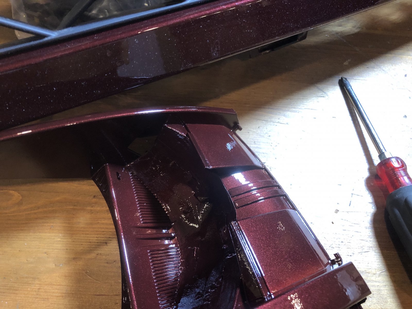

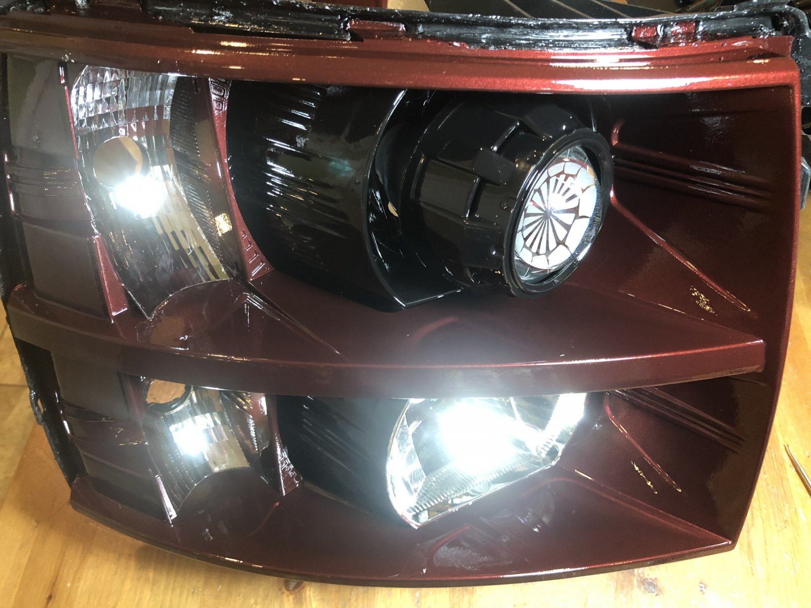

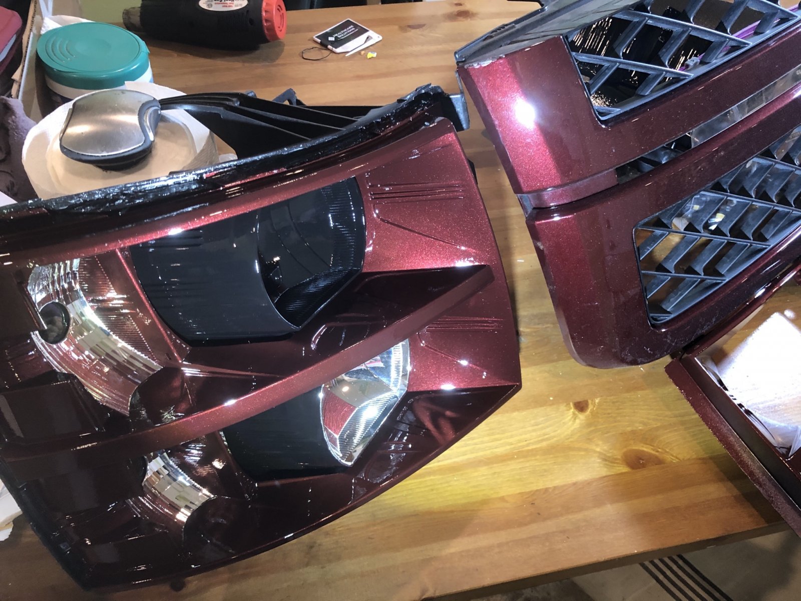

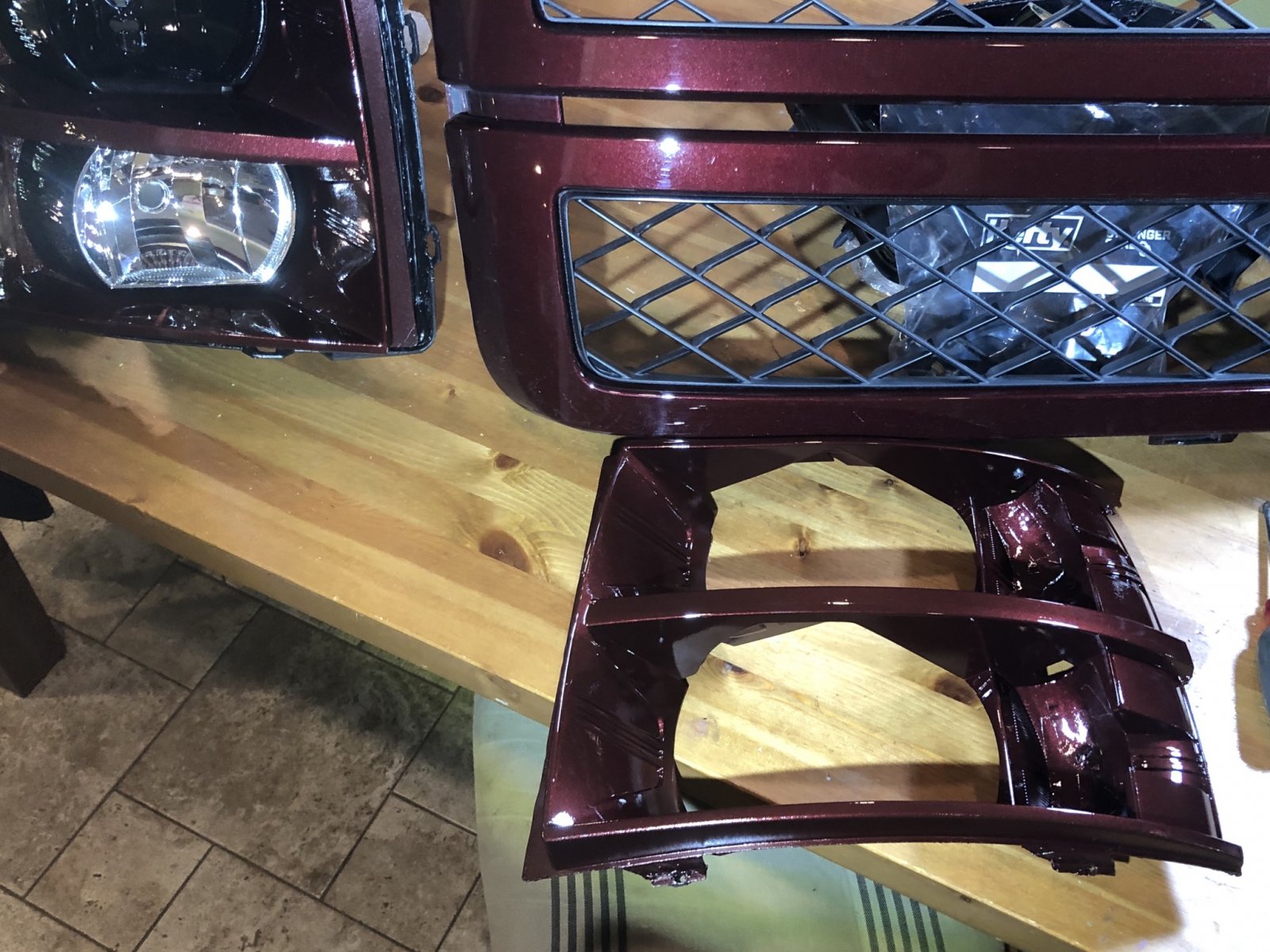

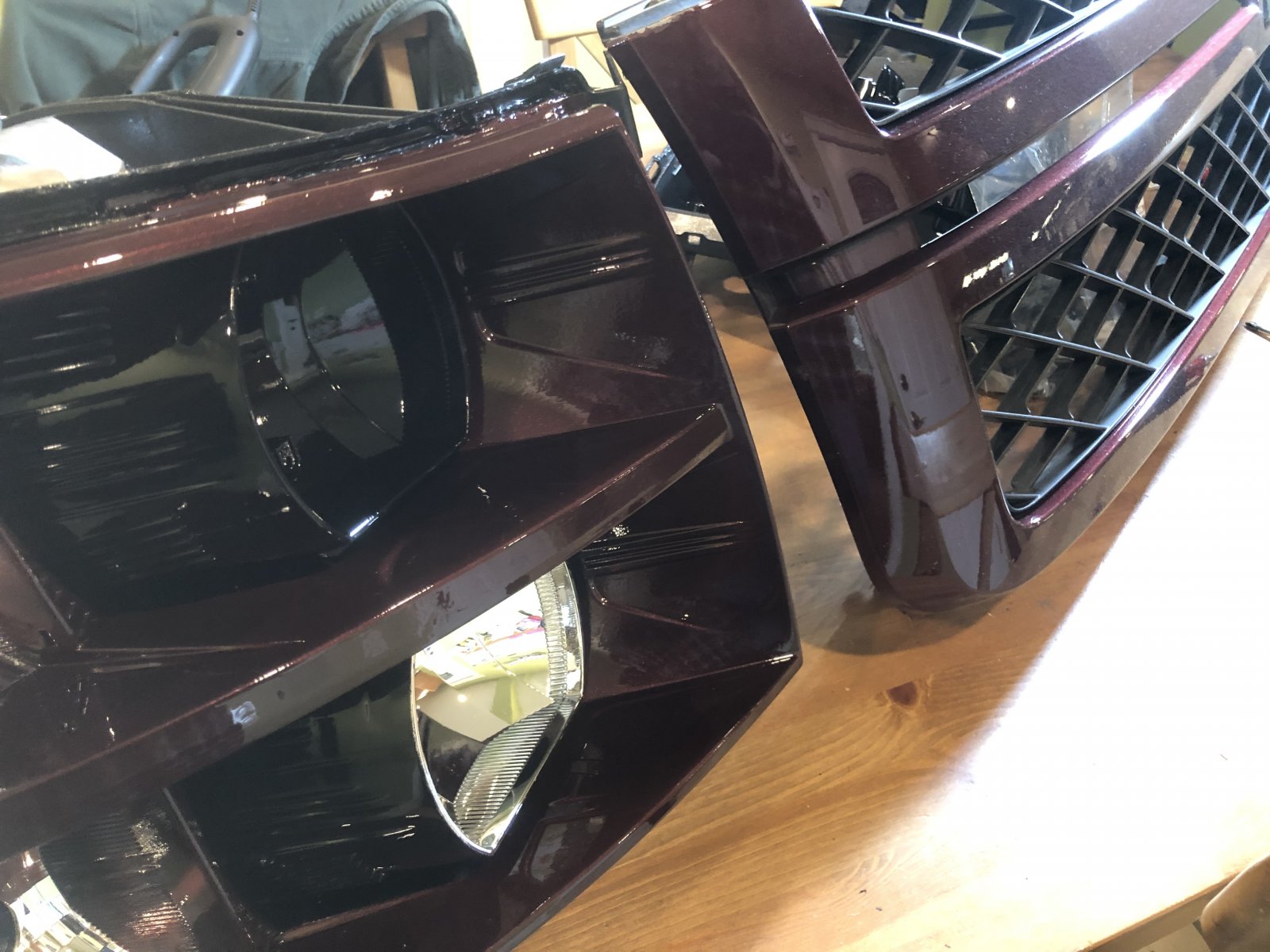

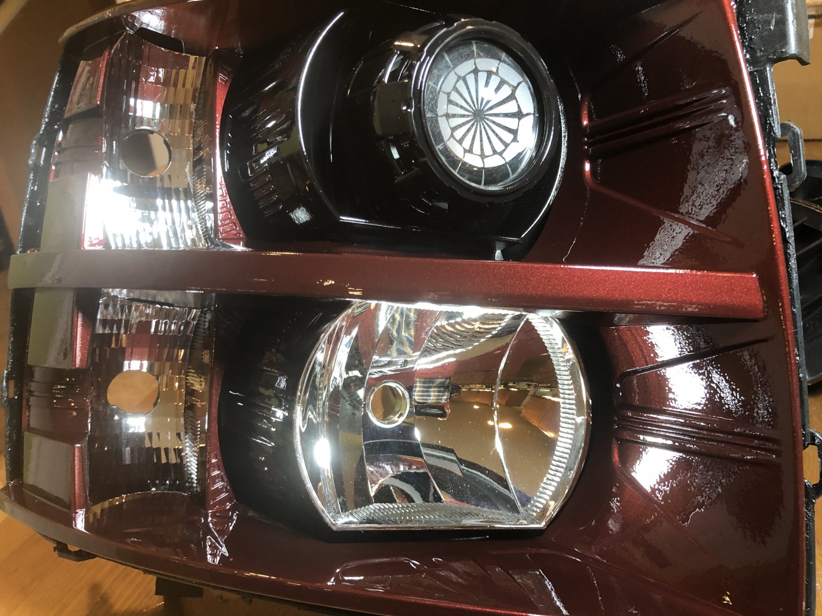

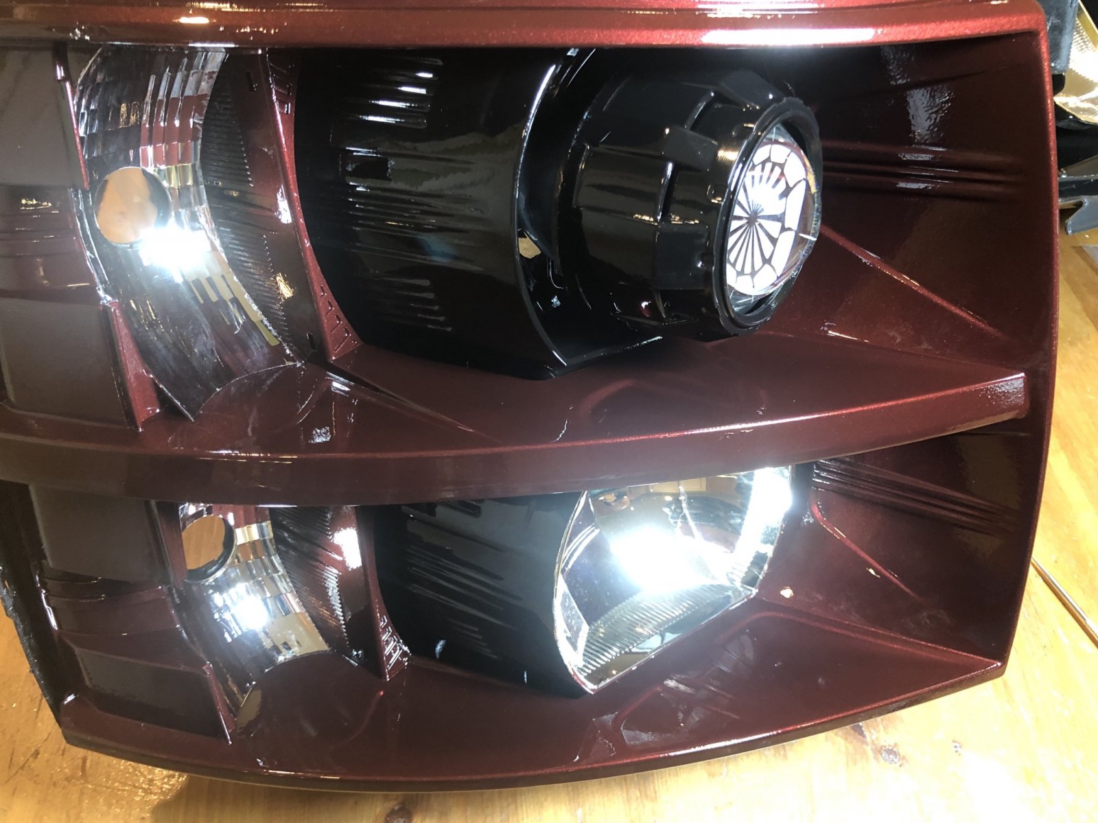

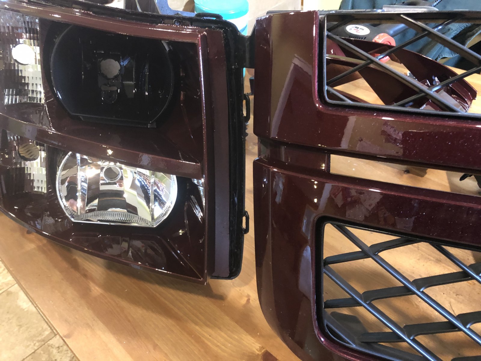

Headlights are coming along nicely. The SprayMax 2K clear is the bomb. Paint match is perfect, the grill looks the same but now I’ll probably have to repaint the black on it and clear coat it too so the black matches exactly too. It was done in Fusion satin black just like the headlights but I’ll repaint it before I clear coat it.
52,954
I didn’t set the projector in it while sitting it next to the grill because I can’t install the nut on the back and didn’t want to take a chance on the projector falling onto the floor and breaking. The new parts will be here in a few days and I can install those and do the horizontal aiming before installing the lenses. I think these will look badass when they’re installed. The other ones didn’t match good due to the ****** clear I used and the chrome was not my style.
52,954

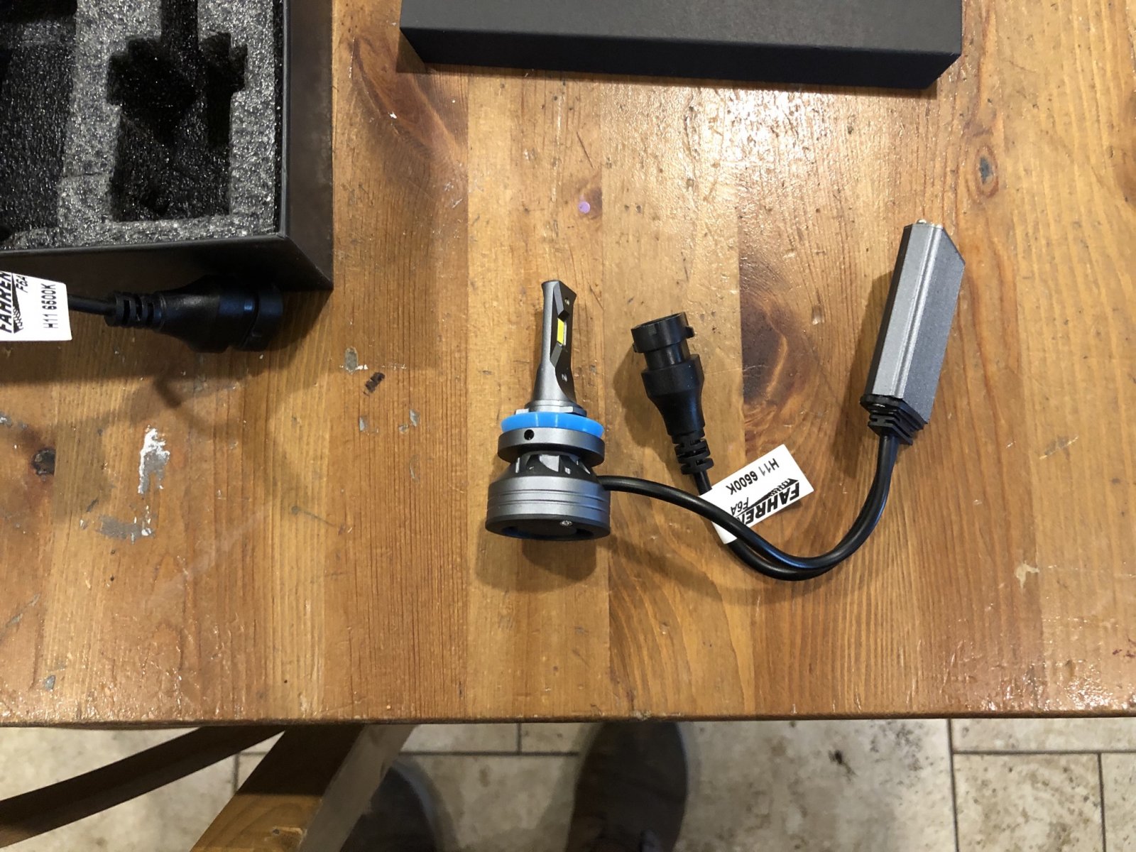

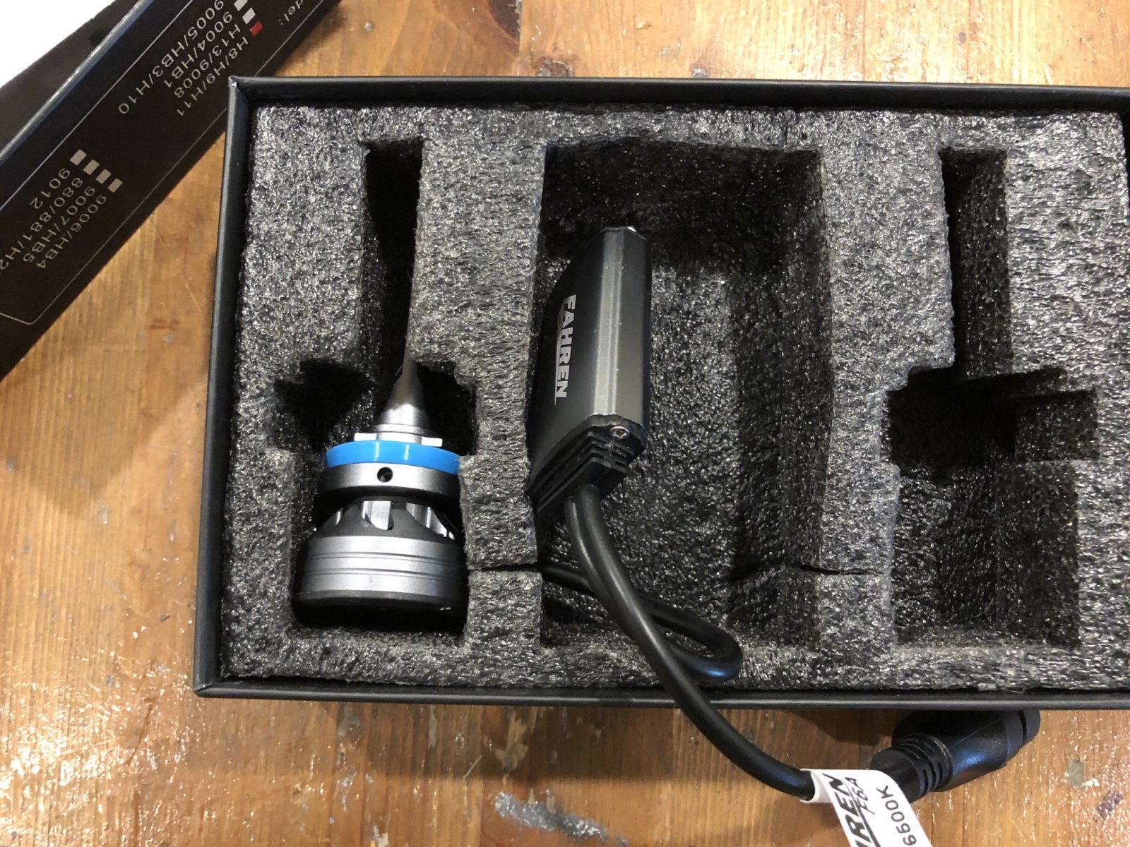

Decided to go with LED's in the high beams this time. These had great reviews on Amazon, plus they will fit in the space behind my headlights with room to spare. I just couldn't have regular halogen bulbs in there anymore. These also will adjust rotationally so you can get them in the proper orientation if they don't sit in your headlights correct, and they look cool to boot. :cool:

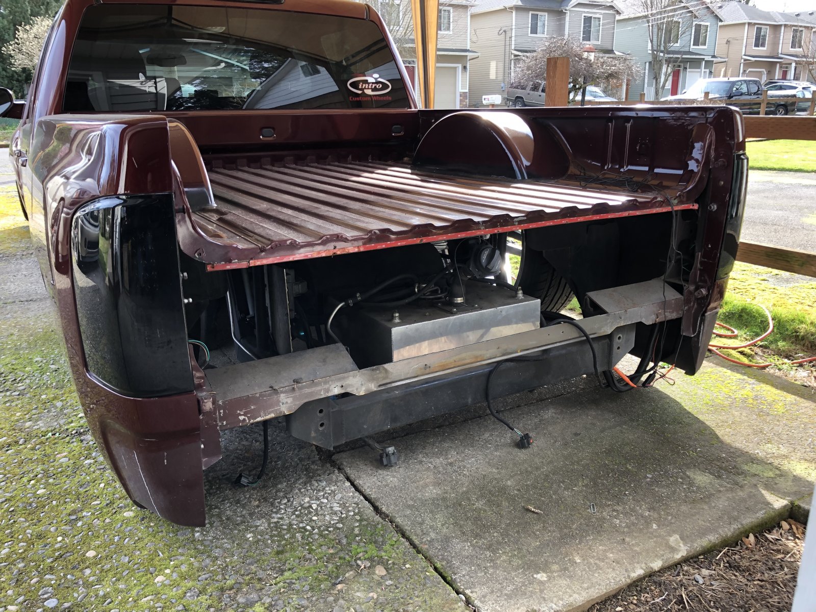

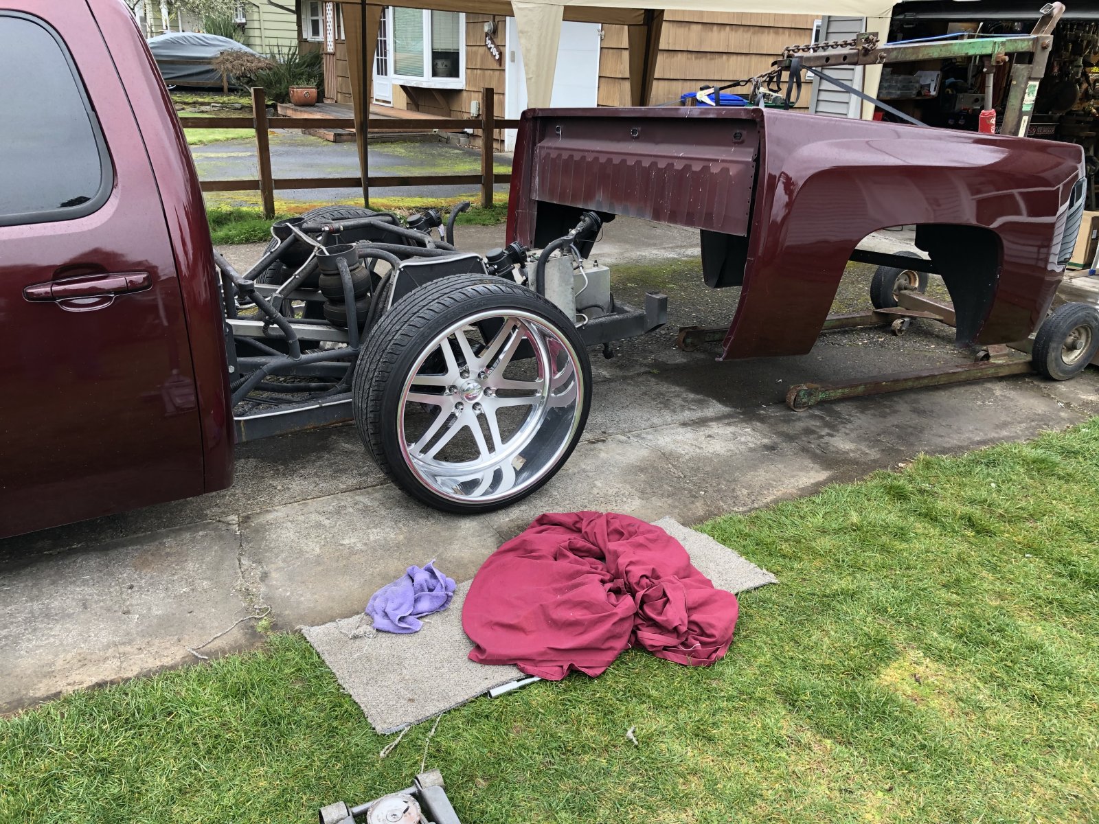

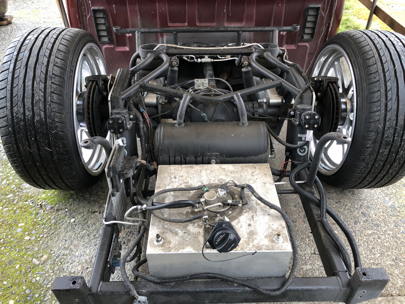

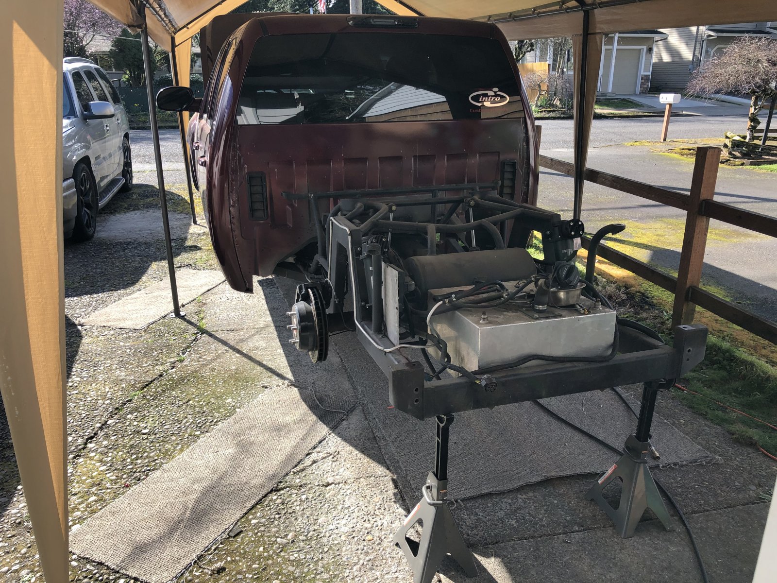

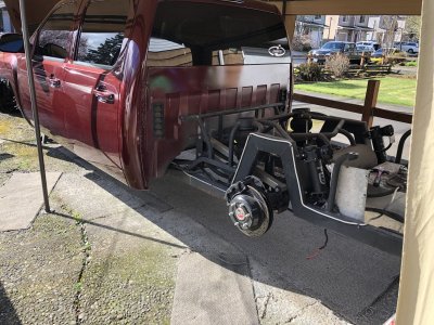

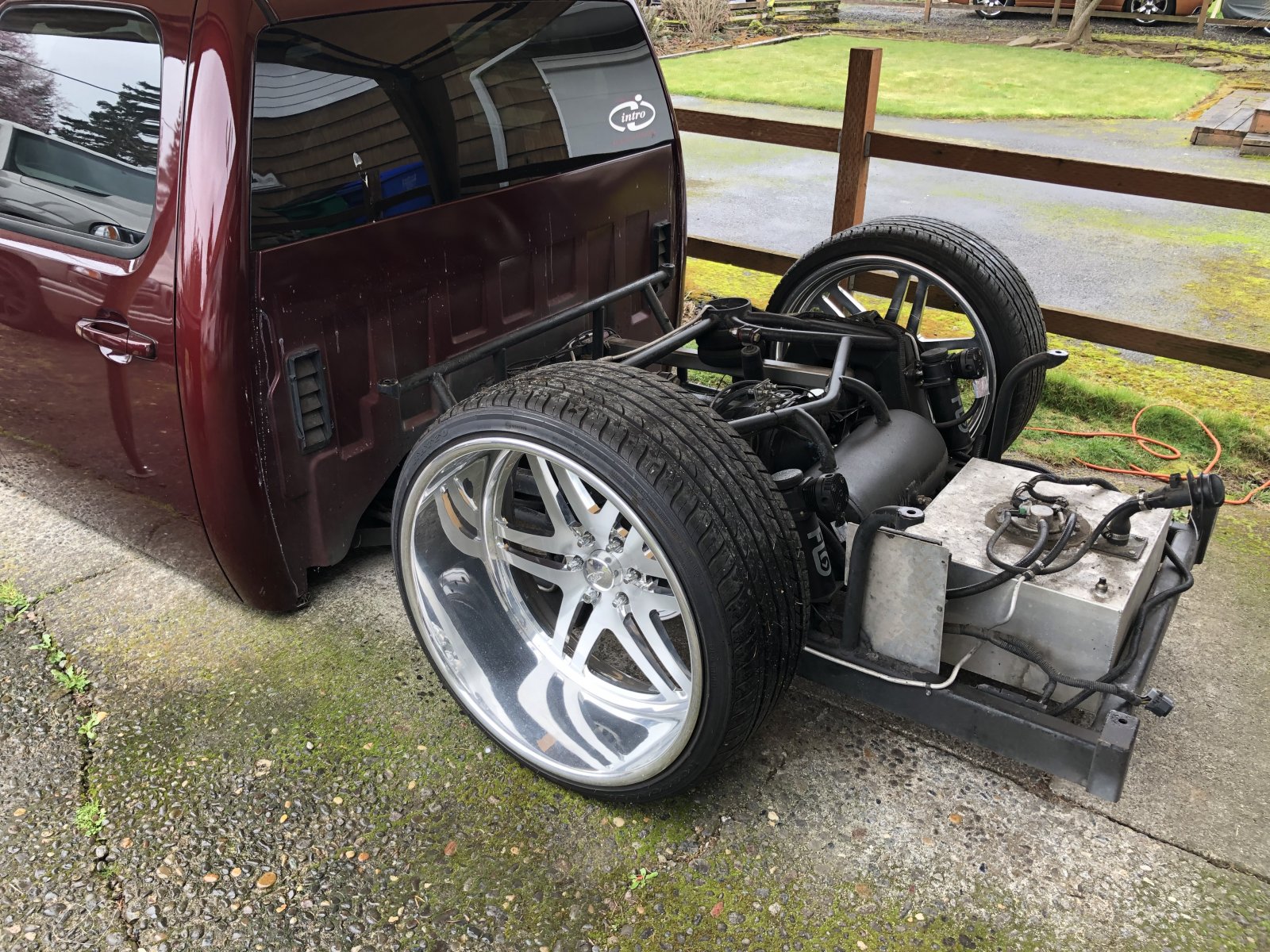

I got the bed off today, it turned out to be a bit harder than I thought mostly because I didn’t take into account the wheels being in the way. I had to pull them off, roll the hoist and bed back, reinstall them and then drive the truck forward.

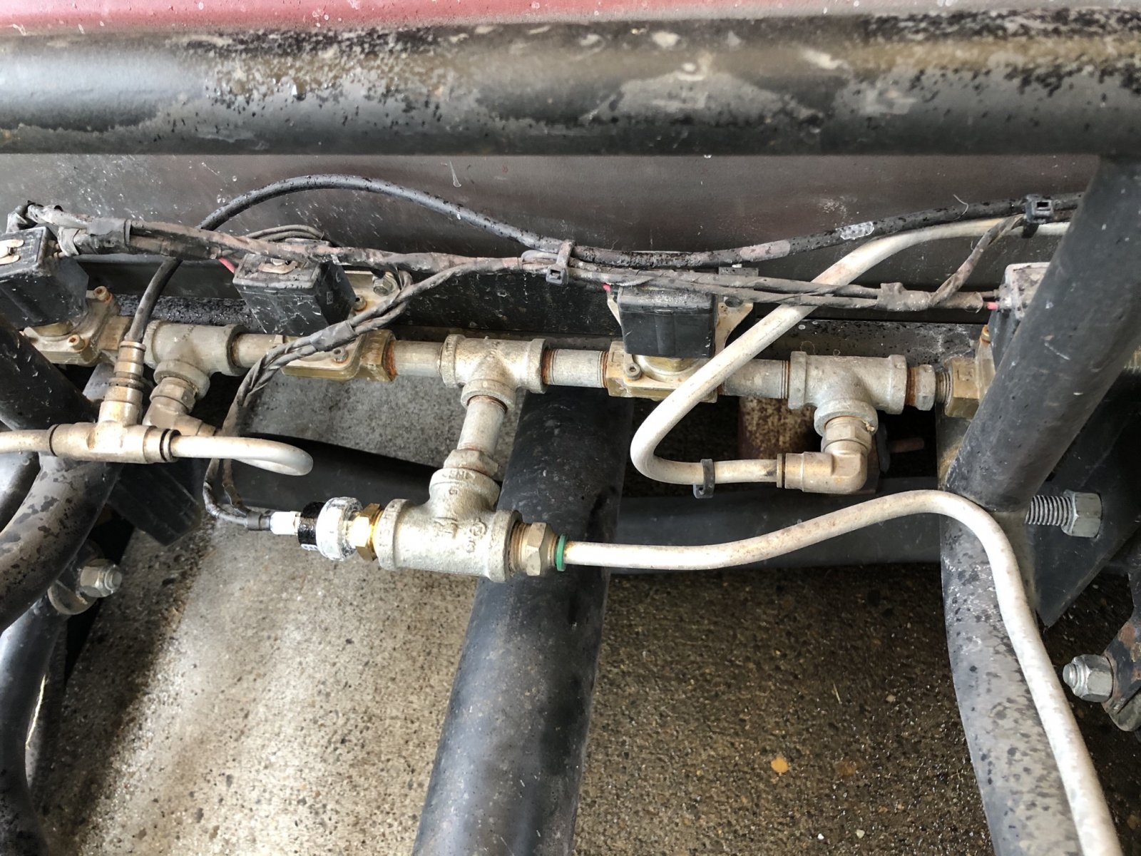

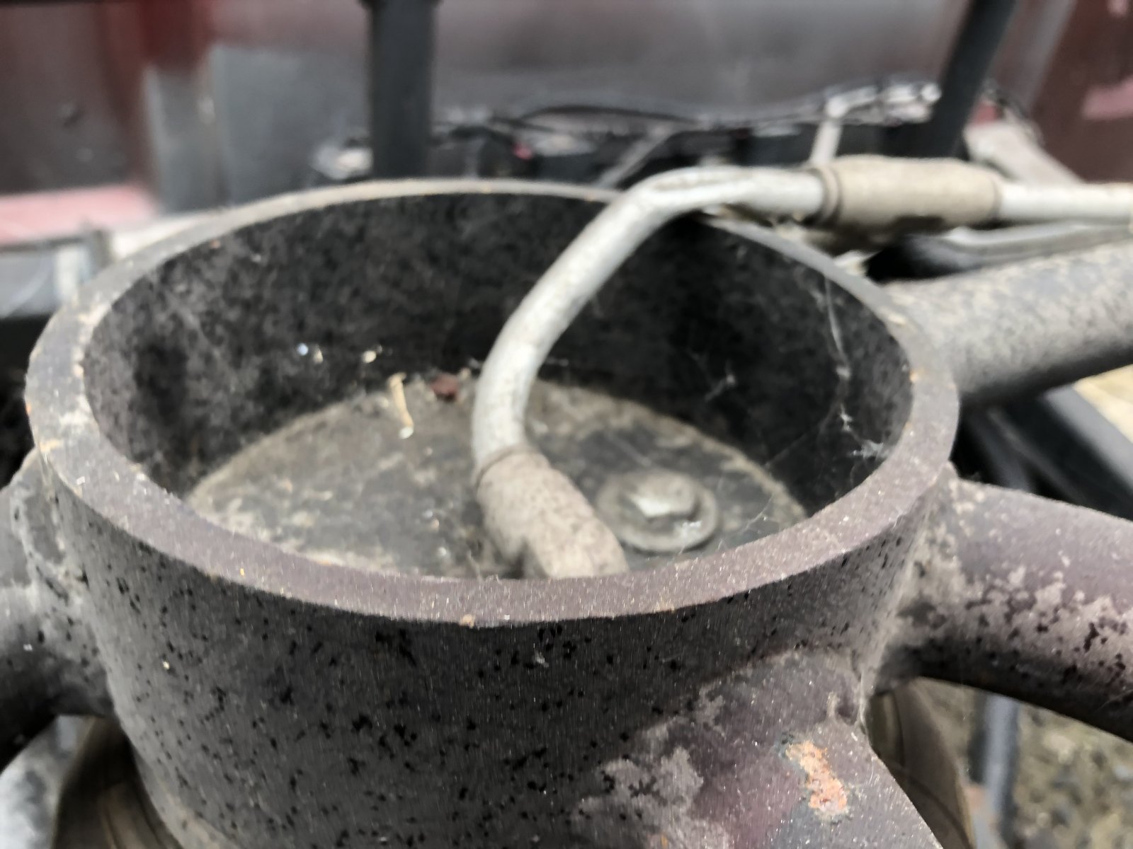

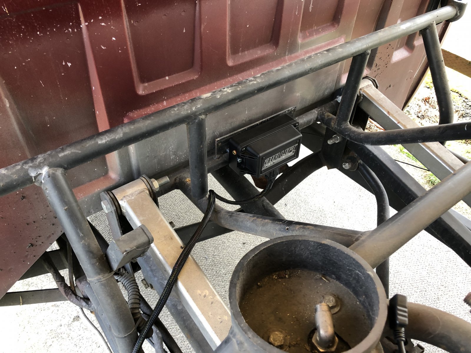

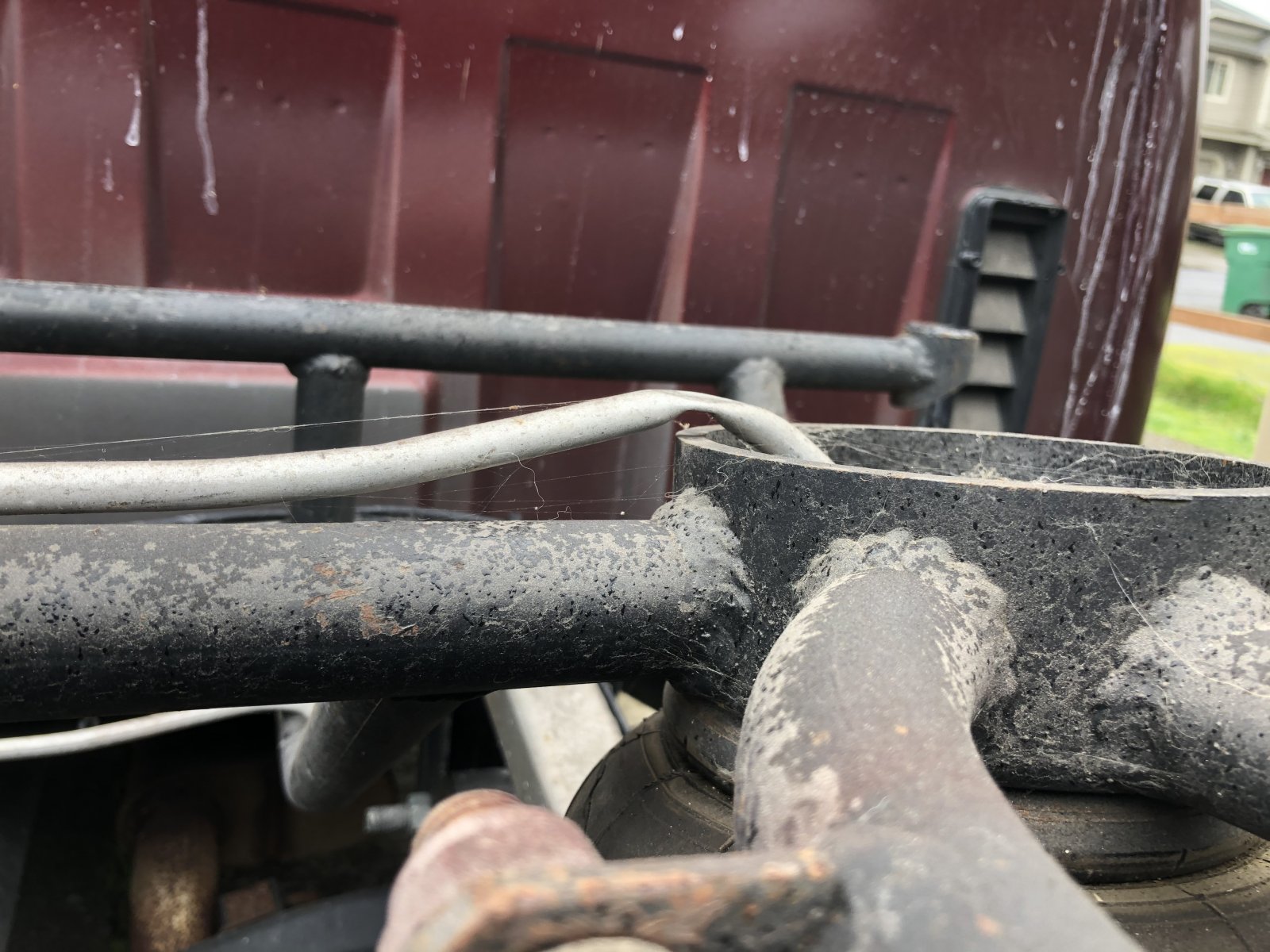

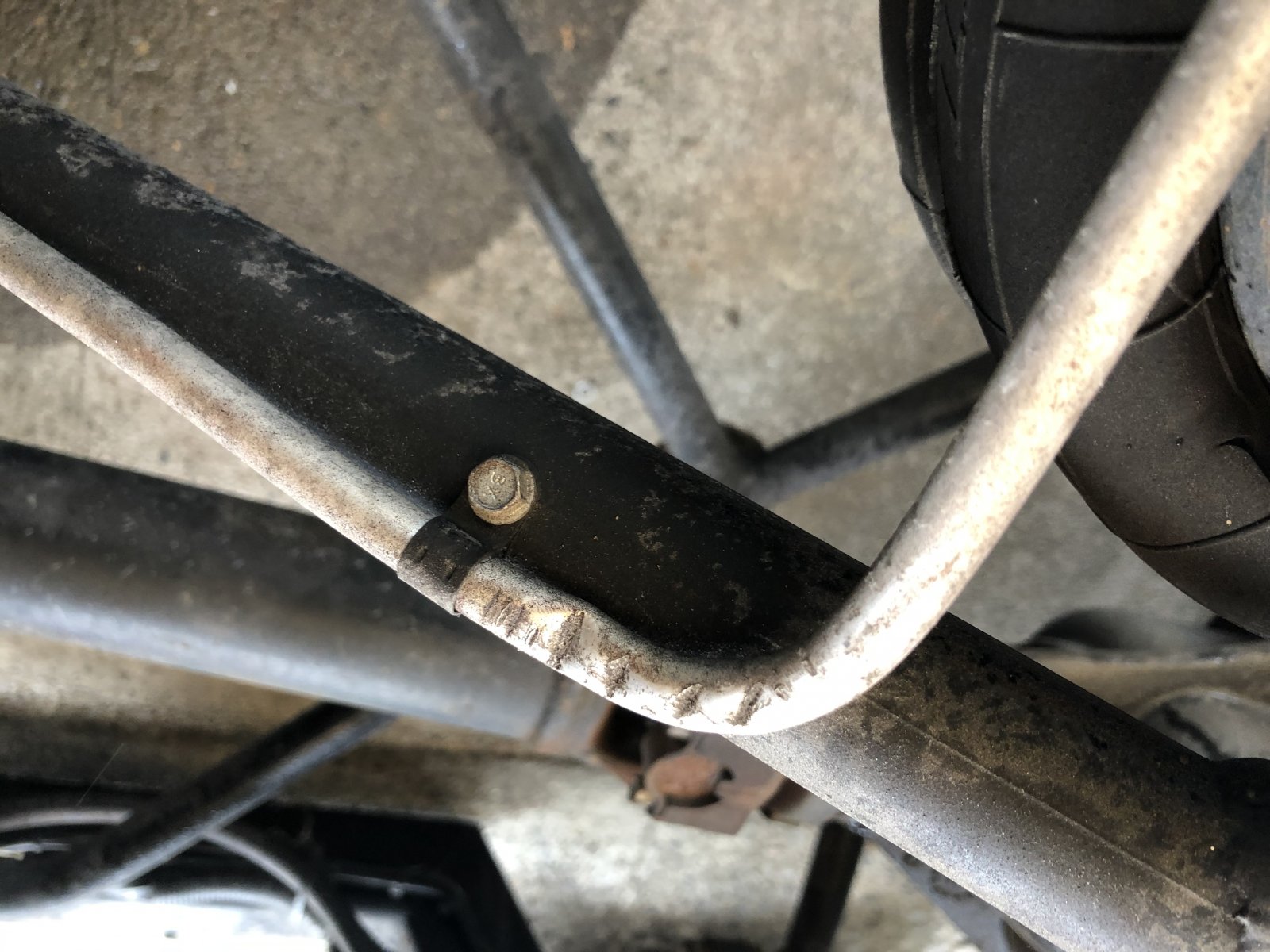

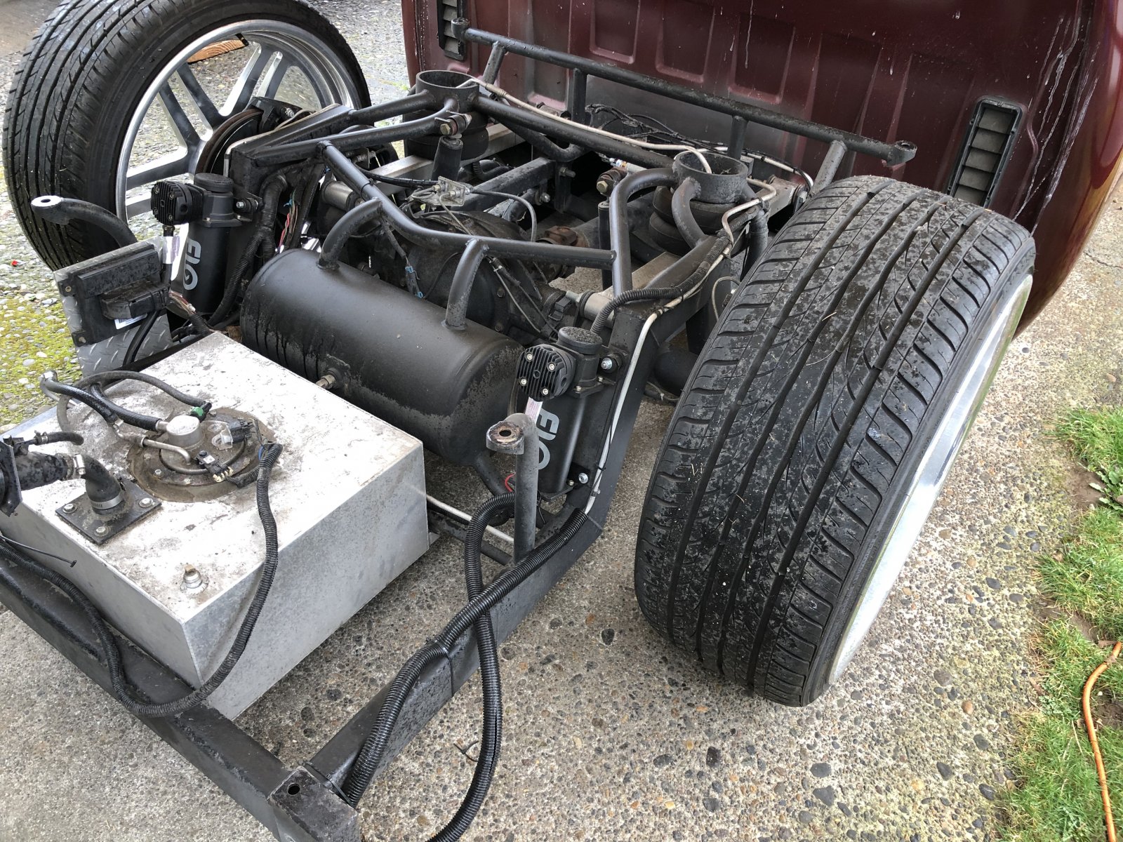

And just as I figured, soon as the bed was out of the way the ****** work and problems raised their ugly heads. I’m surprised the rear bags got any air at all, the lines are crushed almost flat. There’s 2 pinch points on each line that will have to be addressed. And the plumbing at the valves just looks bad. I’m super glad I will be going to a nice manifold with 8 valves instead of 4, all electronically controlled and monitored. There won’t be any more lean in the corners or when there’s more weight on one side since the air won’t shift from side to side. It just seems weird they went to so much trouble to build this beautiful frame and then put in such a cheap air management system, the most basic kind. Their wiring harnesses look terrible too. I will be on a mission to clean this all up. I have new aluminum hard lines ordered, they’ll be here Thursday. And I bought a real nice bender awhile back so I will be practicing. I can’t do any worse than what they did. I will strive to make it look nice and be functional and safe too.

Good thing you caught it now rather than after it split and dumped that corner to the pavement at 80MPH.
52,954
The entire rear would have dumped since there’s only one set of valves for the rear. Kind of like when I blew a front bag and the whole front went down. Luckily with a full tank of air I got it onto the shoulder of the freeway. But that’s not good with a bodied truck since it lays on the ground- it’s hard to get it up so you can tow it, and even then it’s tricky since the suspension disappears into the body with no air in it so tow truck drivers are left scratching their heads. It took us 4 hours to move it a few miles. AAA Plus paid him for his time. Now I’ll at least have control of each corner so limping it will be easier if something happens.

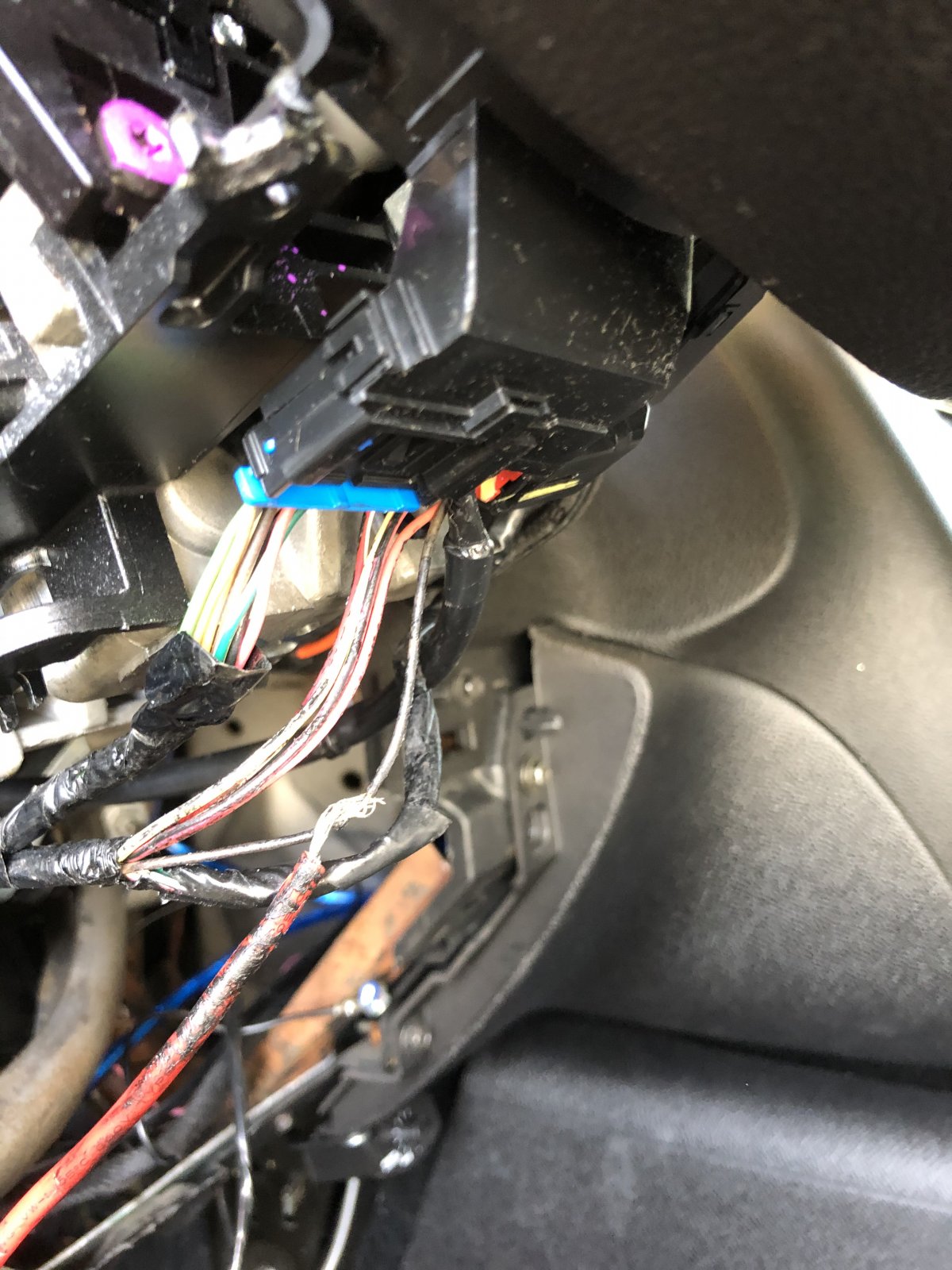

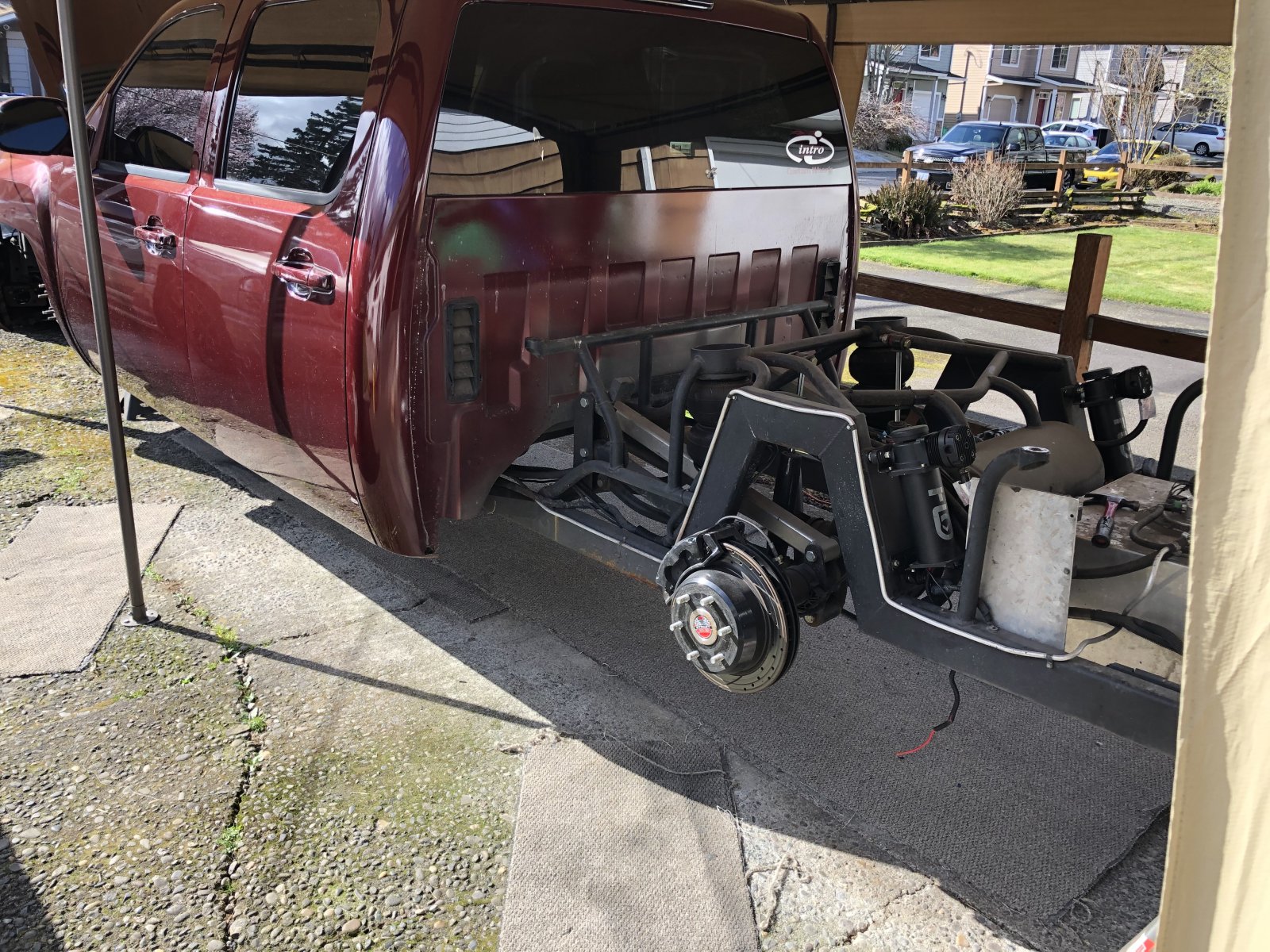

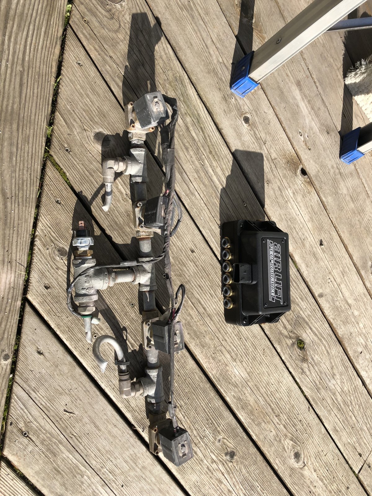

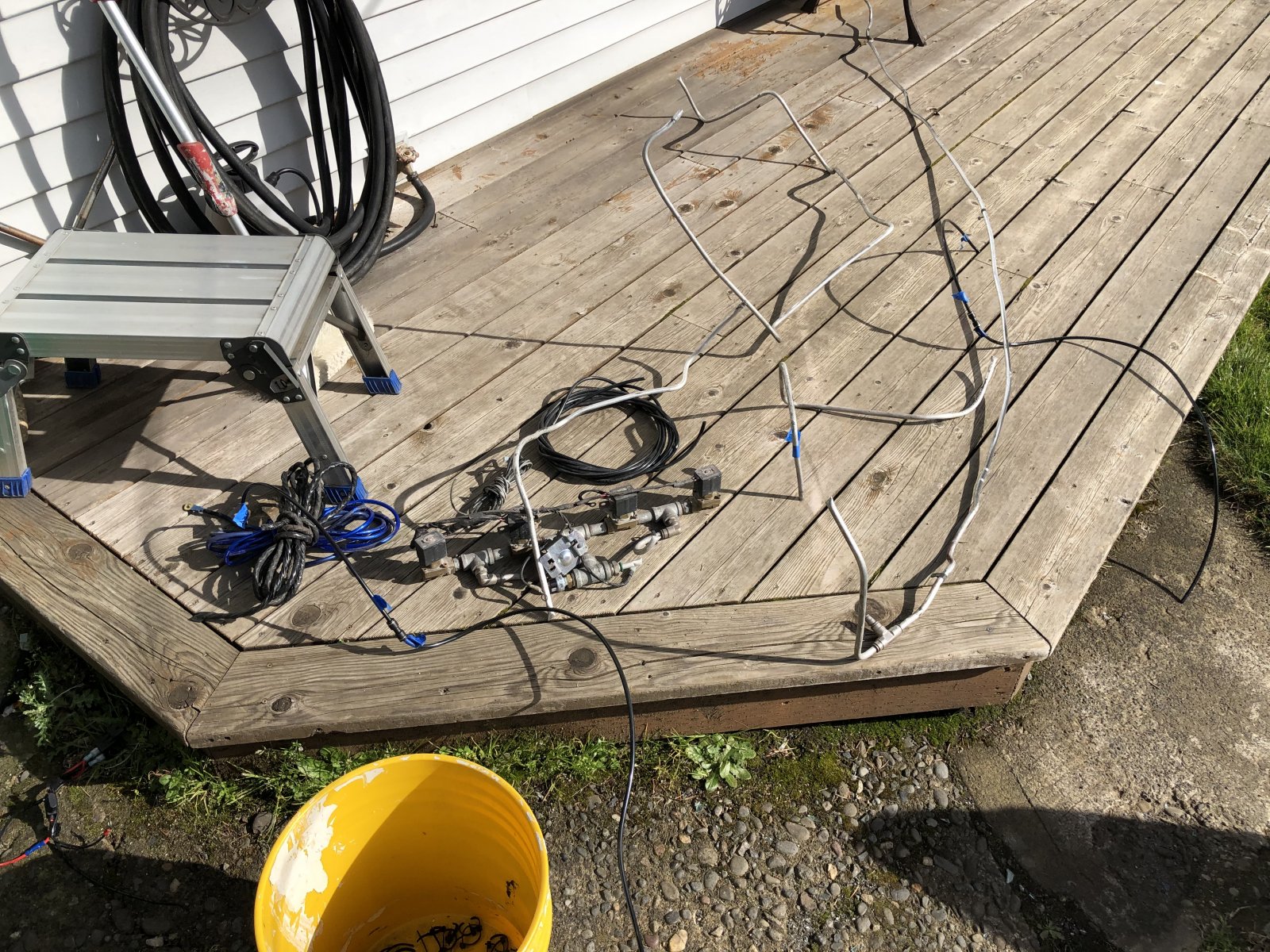

I tore the shit out of it today. The old system is no more, the only thing left of the original install is the bags and tank. Actually just the rear bags since I replaced both fronts as well as both compressors. The truck looks like it’s flying , it’s up so high on the stands. Another great quality job was apparent where they tapped into the power for the switches at the column. Just a bare wire wrapped around with no solder, just electrical tape holding it.

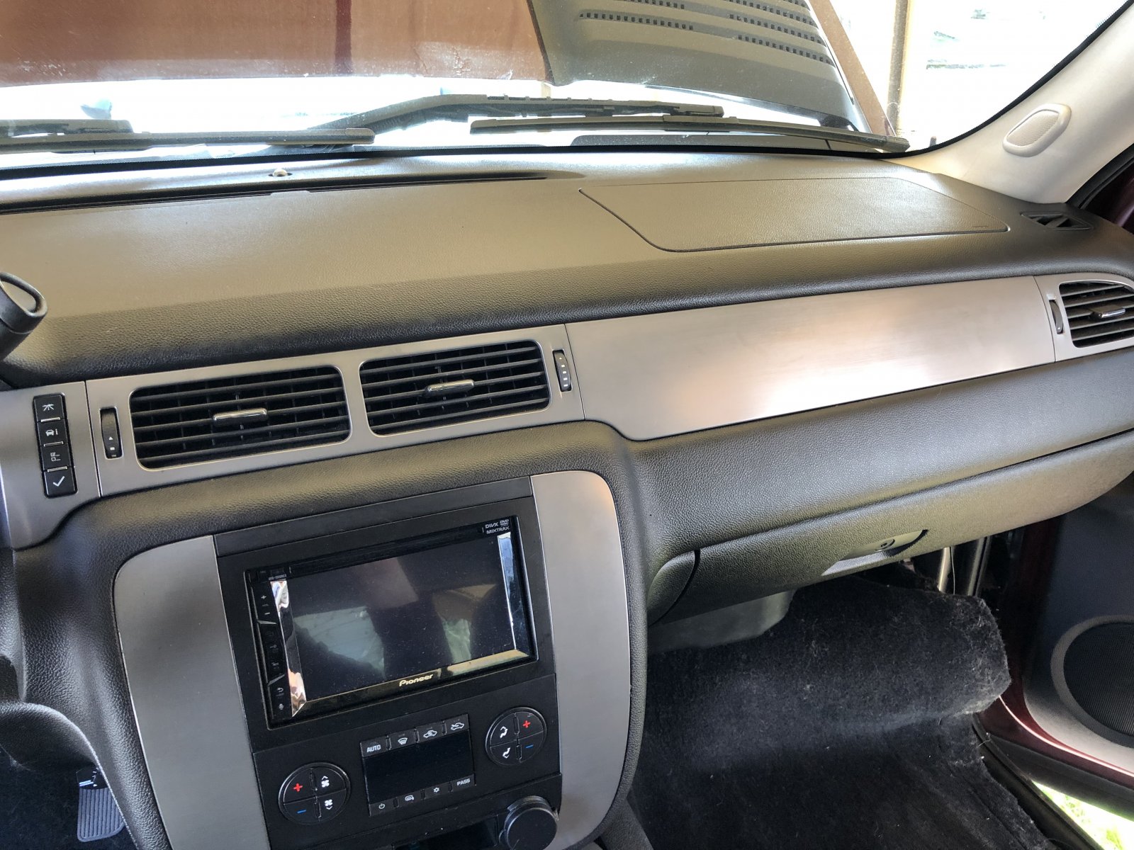

I got the new manifold mounted. That’s about it for today, got a dr appointment in a bit. Oh, I removed the DIC portion of the old dash panel that had the air gauge and installed it in the newer panel. No more out of place air gauge in the middle of the dash!
F0B7ACB3-C3BA-4E27-9ED3-CD2A78B1988F.jpeg A4942D59-1E47-40C4-9E99-6AB24A93FF66.jpeg D569E86D-6929-40D4-832A-A7A48CF07B42.jpeg B5334CBA-FF69-42E0-9BE2-5A4BE009F215.jpeg

Looks like that needs a notch to run the line
