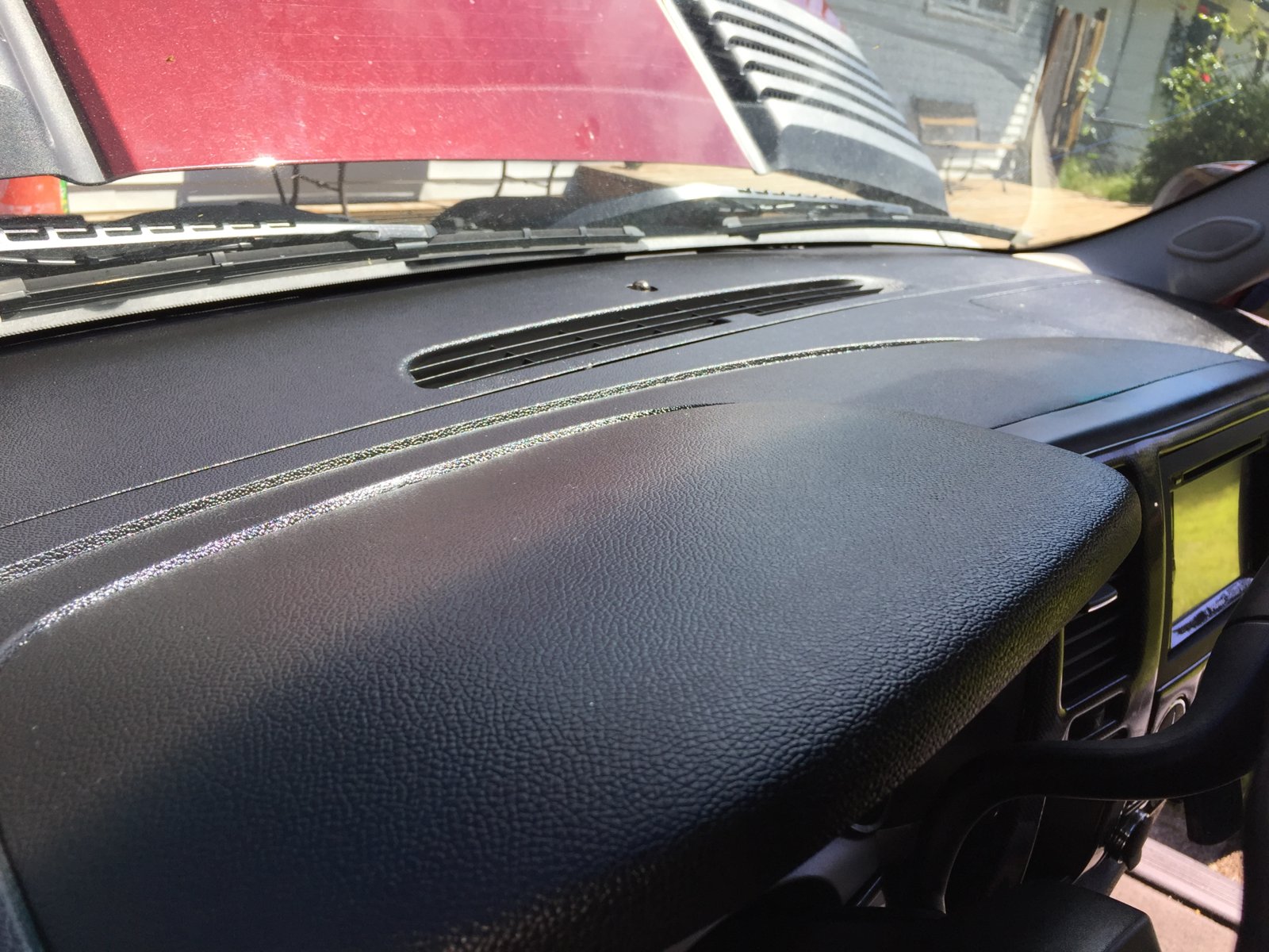

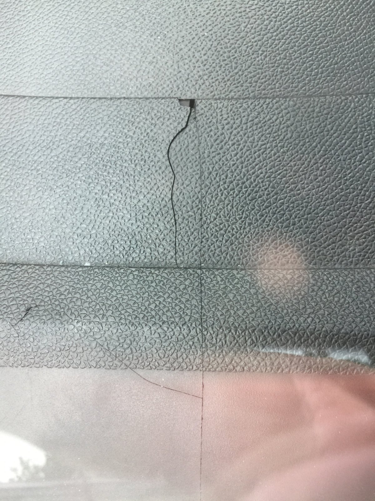

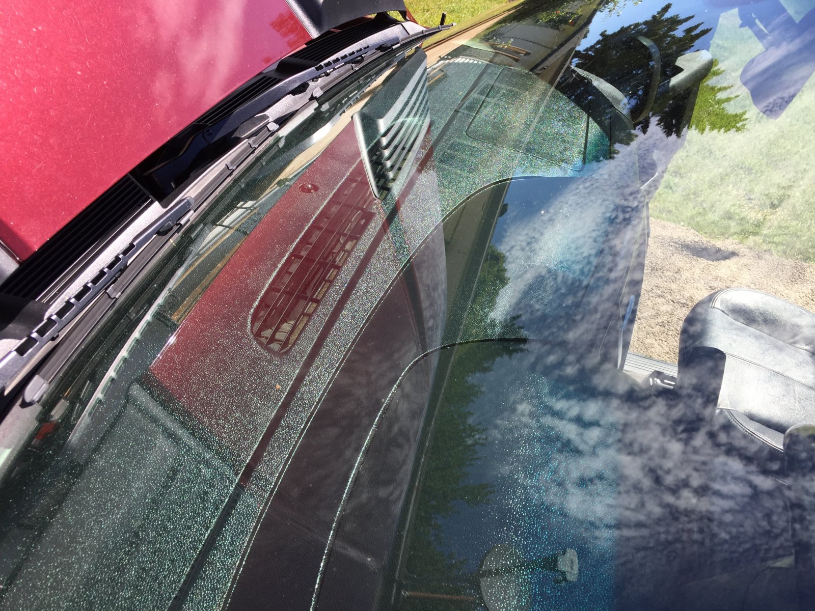

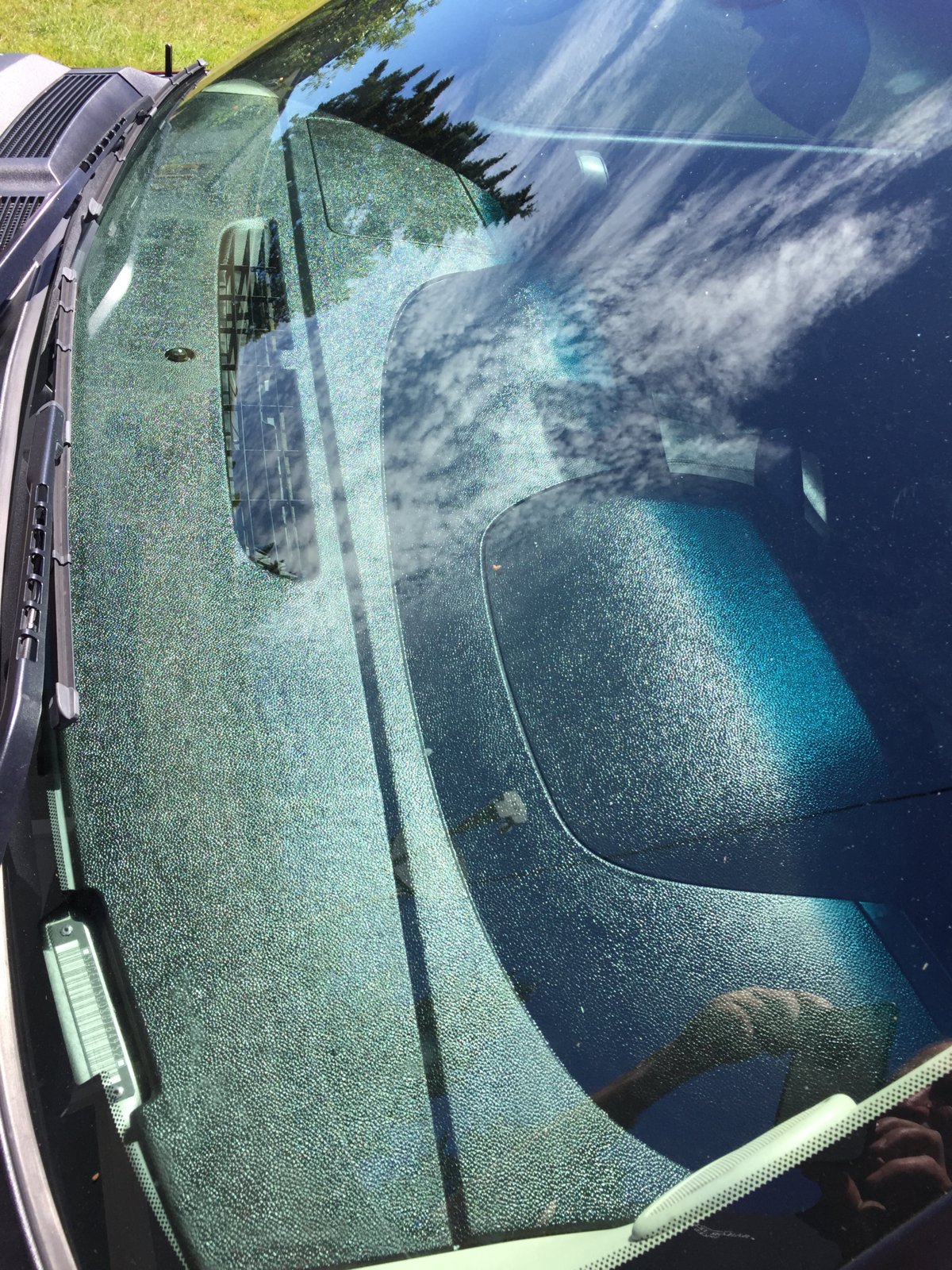

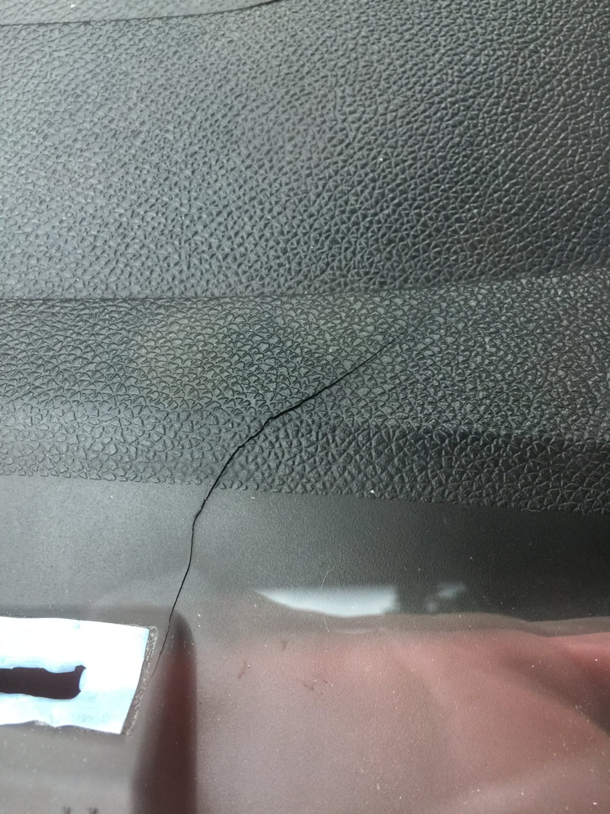

I got the flat piece today and decided to have a look at the truck to see if there were any loose ends before I install it tomorrow. So I'm looking through the windshield and said out loud 'what the hell?". More cracks in the dash by the instrument cluster area. I opened the door and reached in to push on it and see if the two halves were still glued together and a small piece just fell off. The plastic is just shit, it's so brittle it's falling apart. The Cali sun didn't help I'm sure, but it's ridiculous. Anyway my hand is played, there's no getting around a new dash. I'm glad I didn't go to all the trouble of filling, sanding and texturing the whole thing because it would have just started cracking everywhere. Or fiberglassing it. The base material is just crap. I wonder if GM just had a bad formula when they made that plastic on these years. I've never seen something so weak and brittle. I guess it's time to break out some more cash. Dammit.

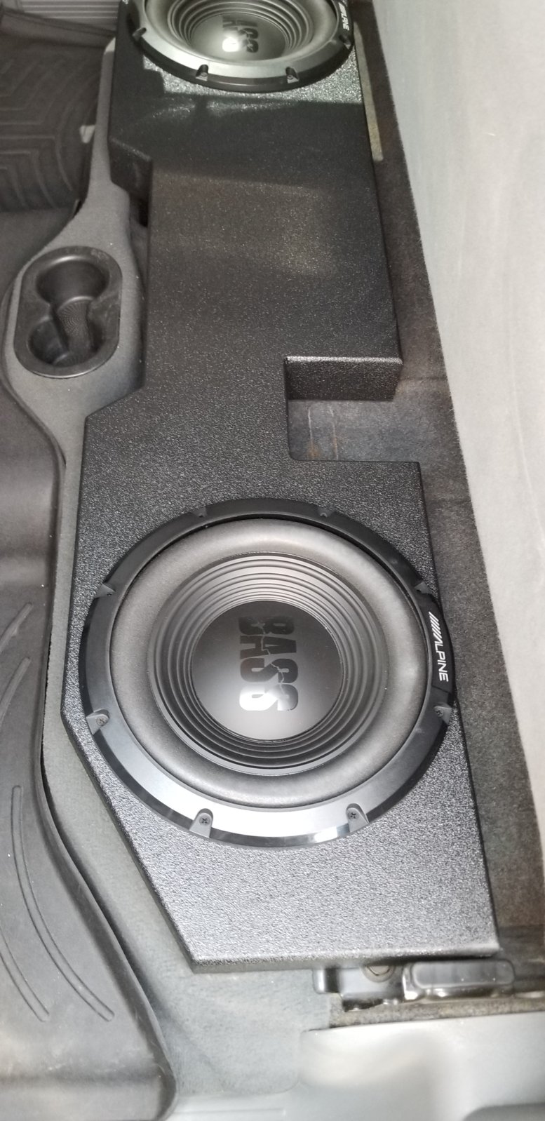

Just wanted to show this to you. Pretty cool how they just utilize the space. It's in a dodge 1500, under the rear seat. It's not a full size seat. Think it was a cc.
52,954
Just wanted to show this to you. Pretty cool how they just utilize the space. It's in a dodge 1500, under the rear seat. It's not a full size seat. Think it was a cc.View attachment 200199
I've checked mine, and as it folds/unfolds the bottom part of the seat swings to within an inch of the floor so it's a no-go under or behind the seat. There's enough width with the seats folded up for a couple 8's side-by-side but like I said, as the seat bottom folds it comes too close to the floor. Once the seat is folded there's probably 6" height but that problem of doing the folding makes it impossible. It needs room to swing down. I'm OK with an under-seat sub in the front.

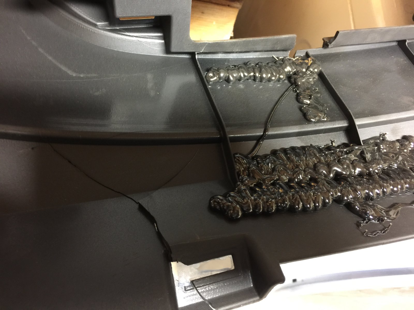

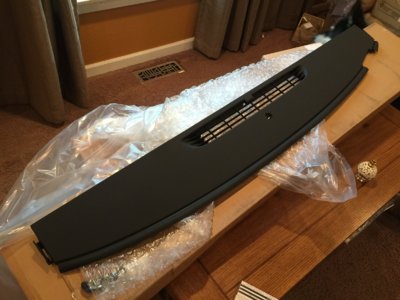

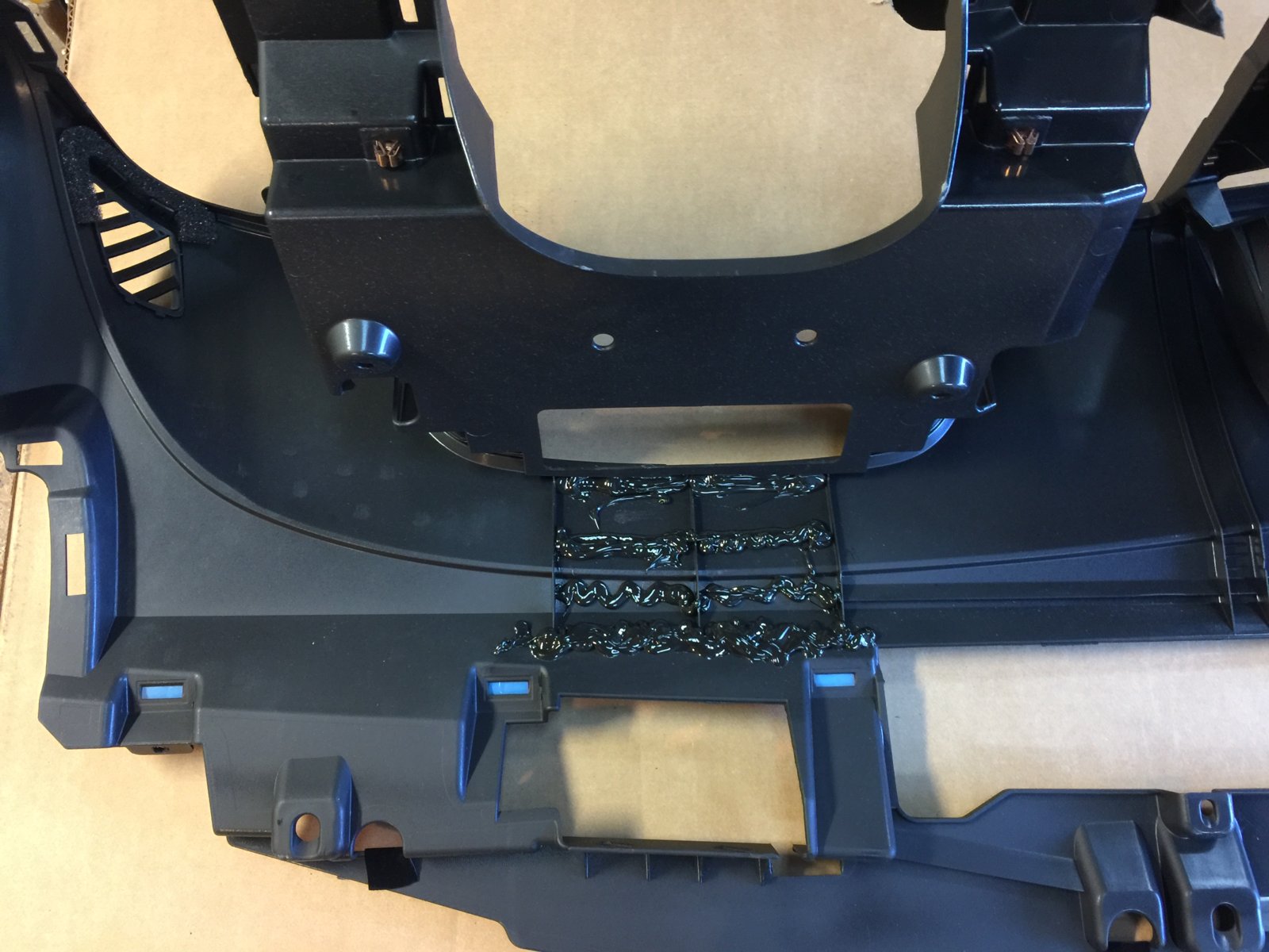

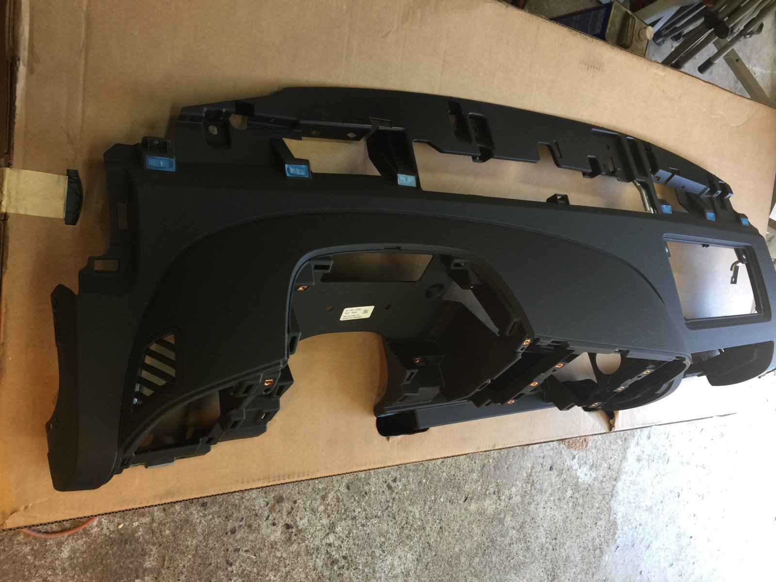

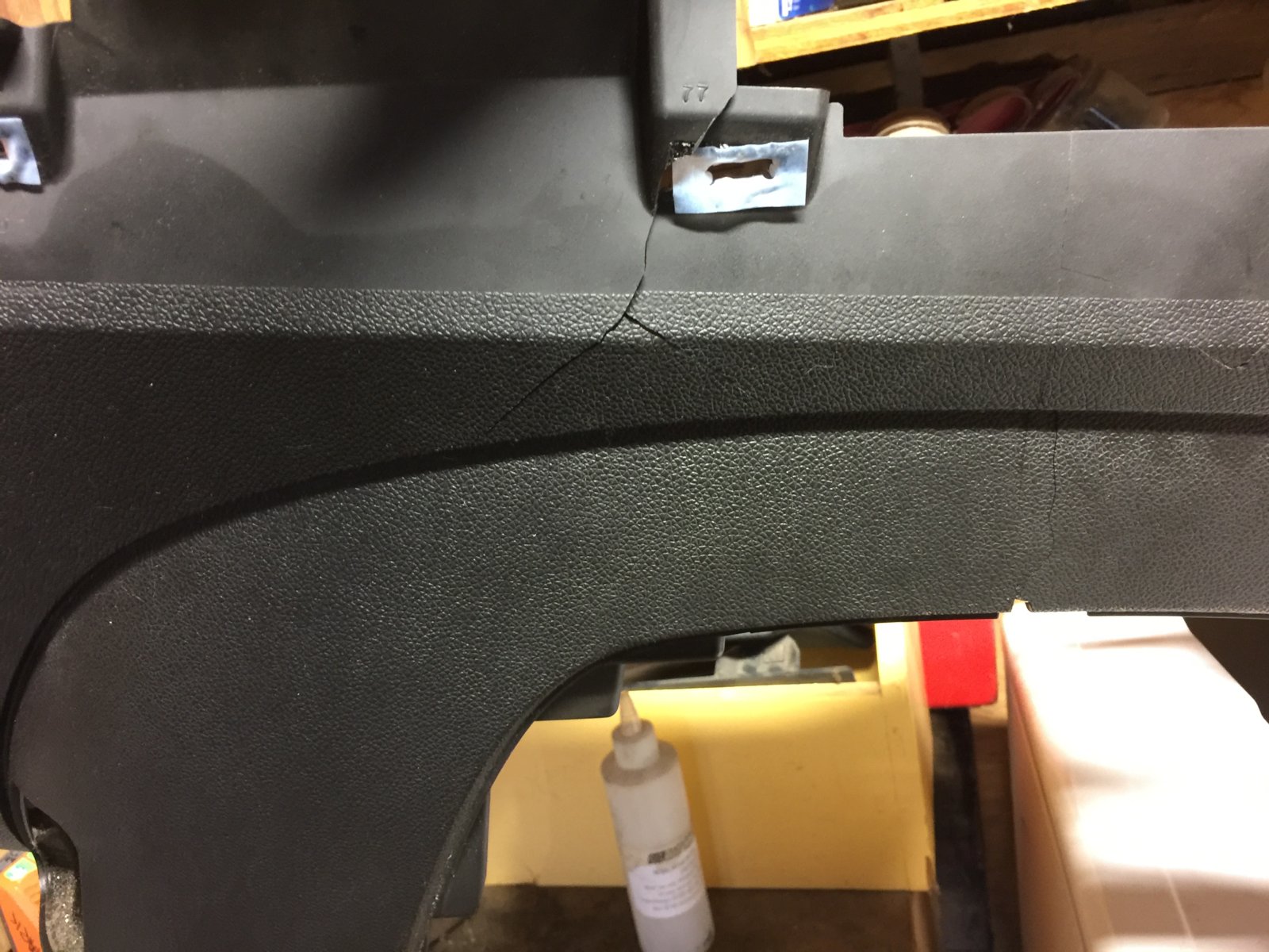

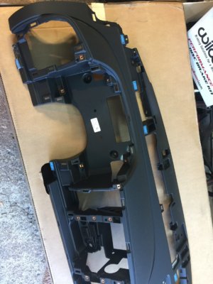

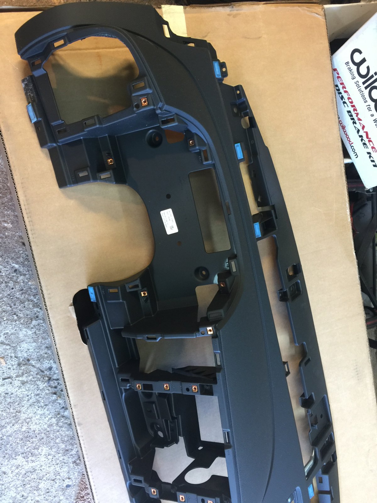

I pulled the old dash out and prepped the new one for install. Tomorrow I'll put it in. The old one cracked where I didn't add steel and epoxy.
52,954

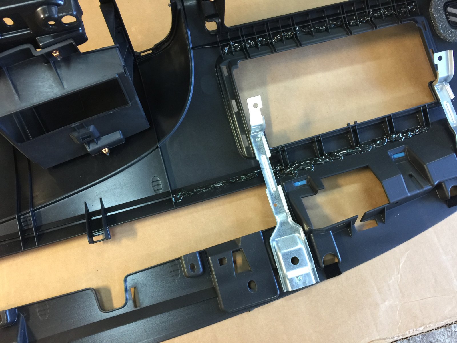

Did you reinforce the new one?
Top 2 pics in post #831. So yes! As I was destroying the old one today I could see that the reinforcing wouldn't have kept it from cracking anyway. It was so brittle from the sun beating down on it plus the fact it's probably half recycled plastic that it just shattered as I was breaking it up, until I got to the part that wasn't exposed to the heat and it wouldn't break without cutting it. That stuff on top was toast.

Now that I took a closer look, I can see the difference in the dashes. Good move.
Also, good info comparing the UV and/or heat-exposed part of the dash to the non-exposed part. This confirms suspicions of people that keep their GMT-900s in a garage have better dashes. Personally, I believe it's more UV-related than high temps. Screw it- I'm gonna cover all bases when I replace my dash: I'll reinforce it, wrap it, tint the windshield and (continue to) park it in the shop and try to park under trees with the front facing away from the sun when away from home.

LMAO. I was in the process yesterday of the install and I got the airbag in and noticed it was quite a bit darker than the new dash. I started thinking noooooo not after all this money and effort, please tell me shit's not going to match. (that's about the same time I was noticing how many pieces all touch each other and how they all need to be the same) I had to stop right there and get my Silk Shine and wipe down the new dash and the airbag to see what it was going to look like and it was fine, I think it was just manufacturing deposits on it. Whew. Then I got back to finishing things.
