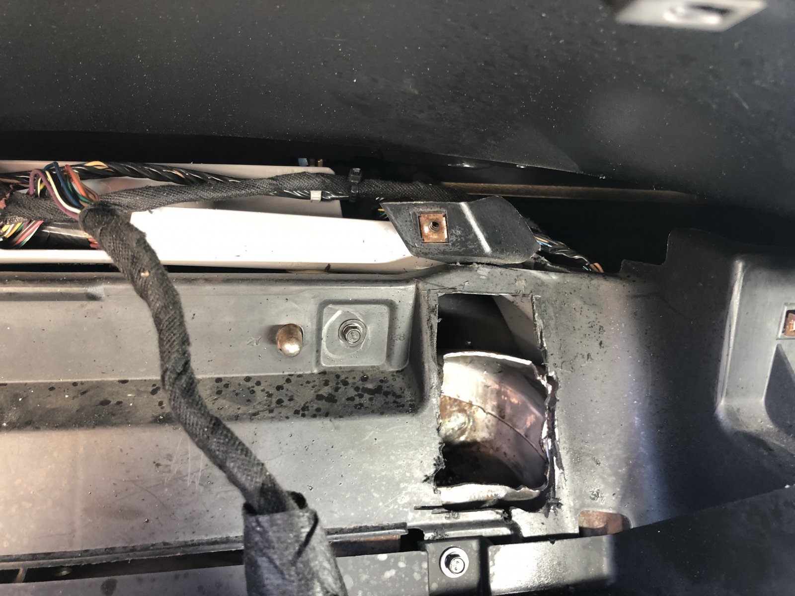

So I was thinking and due to the tight area at the back of that dash hole I think I’ll drill holes all around the perimeter, making each one join with the one next to it and remove the rectangle that way, and then use my die grinder to clean up the edges. I have done that with aluminum a lot at work, cutting door hinges into storefront frames in the field. Those had to be perfect, and it was nice flat soft aluminum, but I’m sure I can do an acceptable job on this slightly rounded steel.

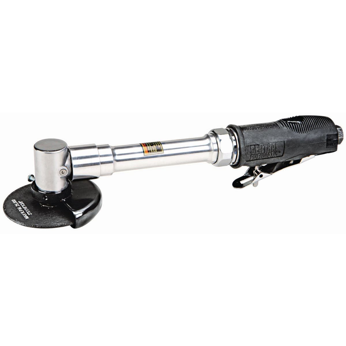

Would this simplify it?

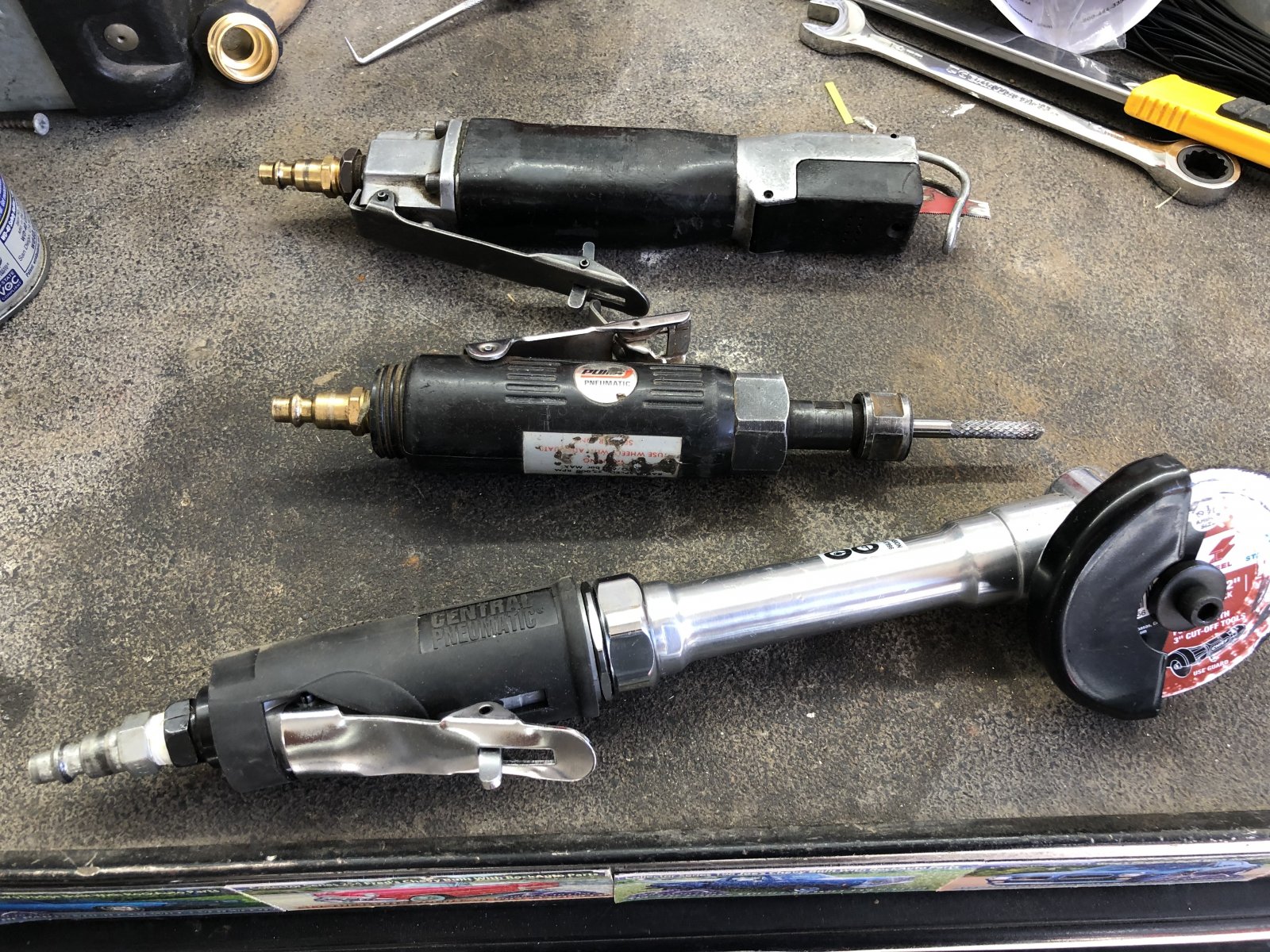

Sure. You gonna buy me one? :happy107: Wait… I just zoomed in…Central Pneumatic… HF…. Search… $38? Pretty cool tool. Hmmm.

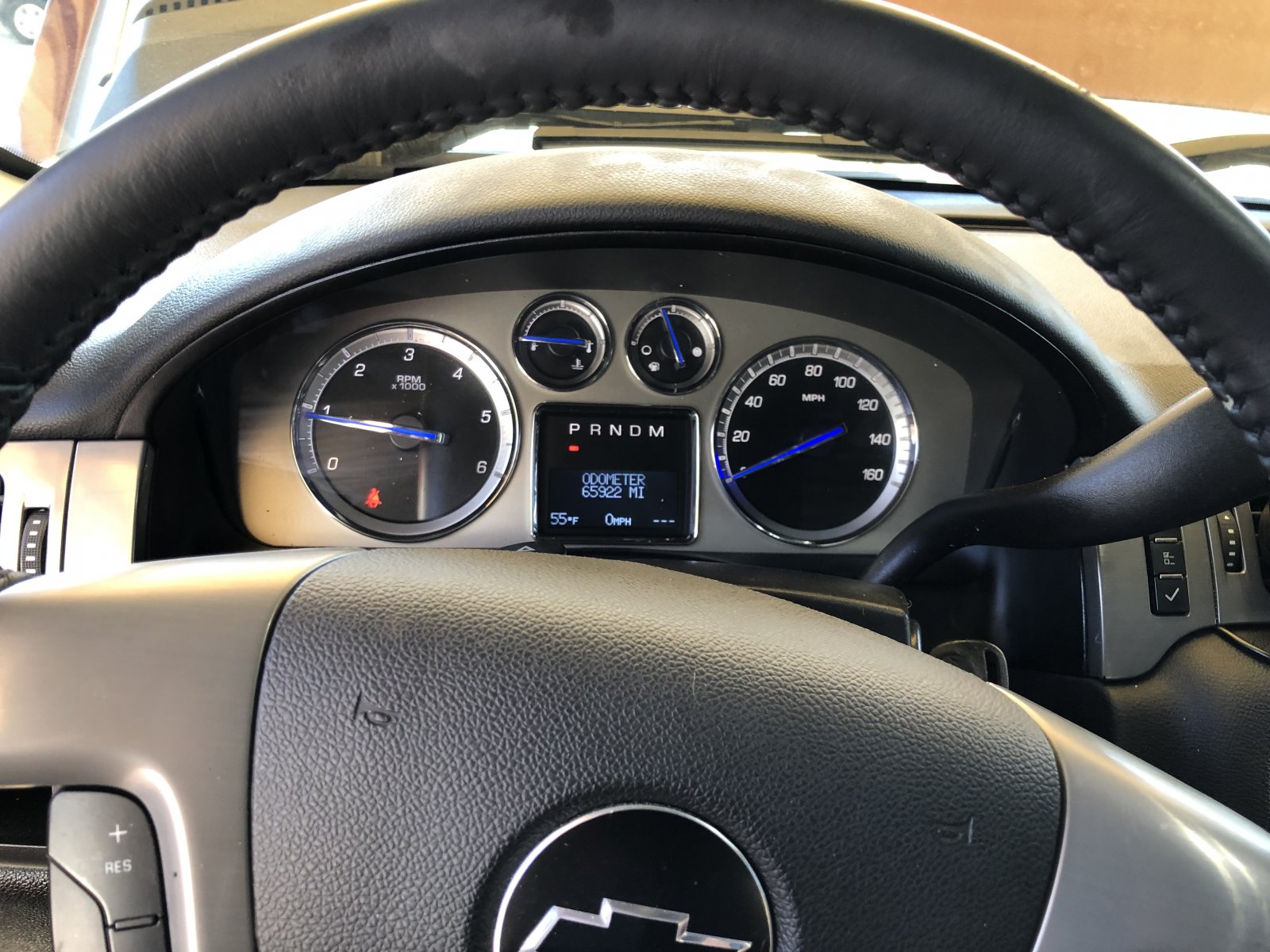

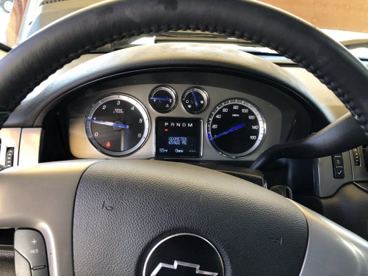

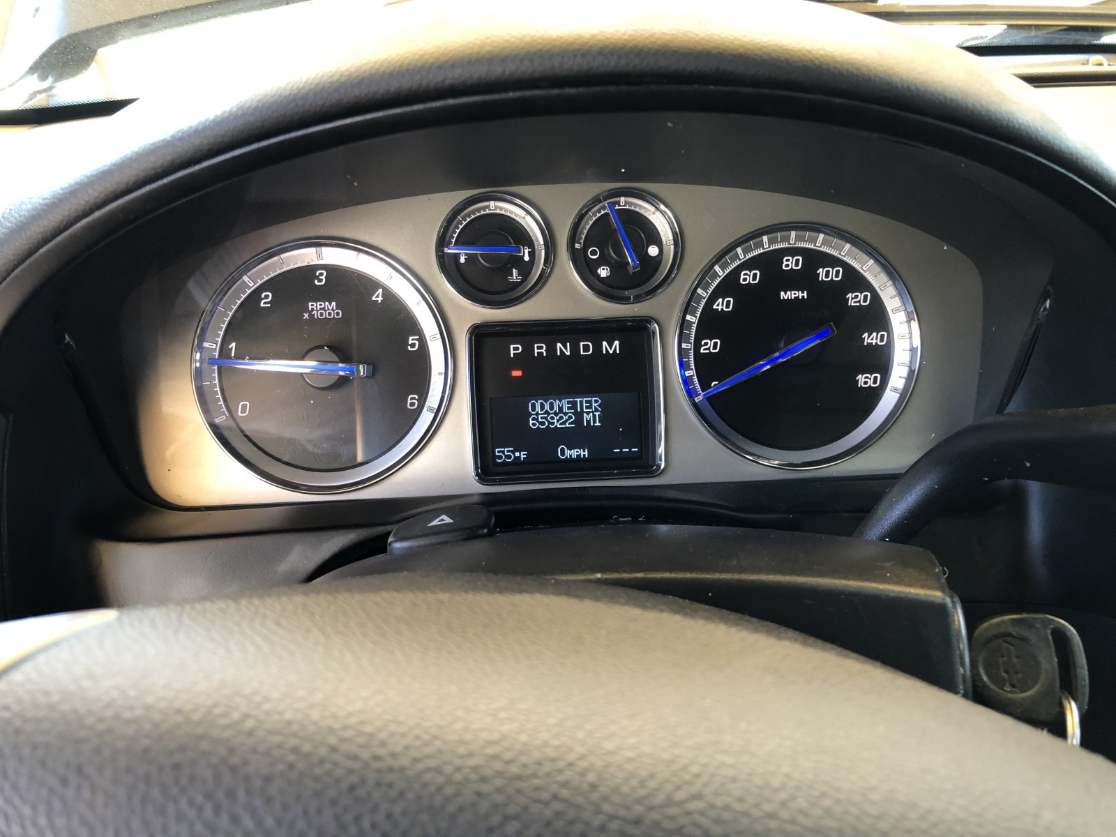

It’s done, cluster is in and working. That air cutoff tool was about worthless, it’s so weak it barely cuts through plastic which is what I used it for. I ended up drilling a bunch of perimeter holes and using my air recip saw to get the majority out but at the top it curved backwards so I ended up using the whatever it takes method which involved clamping it with vice-grips and bending back and forth until it gave up and broke off. I used a did grinder a bit too. I broke the only saw blade I had right as I was finishing with it. I added some closed cell foam behind it because the top mounts aren’t in the right place for the cluster, just the bottom ones. There was always a small gap at the bezel and now the cluster gently pushes against the bezel I made, keeping the gap tight. It actually looks a bit cleaner than before.

You know, now that I think of it, it’s probably not necessary to cut that hole for the plug IF you make your bezel to fit afterwards. The bezel I made ( remember you have to use parts from the Esky bezel and parts of the LTZ Silverado/ Tahoe bezel and epoxy them together. It involves trimming the back part of the Tahoe bezel where it meets the curve of the Esky cluster) was built for how the cluster used to fit with the other plug. So when I went to install my bezel that I had spent 20 or so hours to make, it was about 1” too wide at the top the way the cluster was sitting with the bigger plug. So in theory, you could make your bezel to fit the narrower gap. I just wasn’t going to mess with that one I made, it took forever to build it and make it look perfect plus I went through at least 4 Esky bezels and 4 Tahoe ones.
Glad it's done!
That sucks about the cutoff tool. After using a few different Central Pneumatic cutoff tools (just not extended), I had higher expectations for it. Either that one was defective or it's why there's the ~$40 ones then there's the ~$200+ ones. No in-between. I've been binging on Hot Rod Garage and an extended cutoff tool seems to be a favorite. I'm sure it's one of the expensive ones, though. You have enough compressor?
Yeah, plenty of compressor. The thing starts slowing as soon as you lightly touch anything. It cuts plastic but even that’s slow, I really had to baby it. I might take it back and swap it out for another to see if I just got a lemon. My air saw worked great, and I know it takes a ton of air. You get what you pay for,I’m sure. I’ll still keep it, if you need to cut plastic or super thin metal in a hard to reach area it will be great.

I might just return it, idk. I hate having a great idea of a tool instead of a great tool. I’ll give a replacement a try first I guess.
