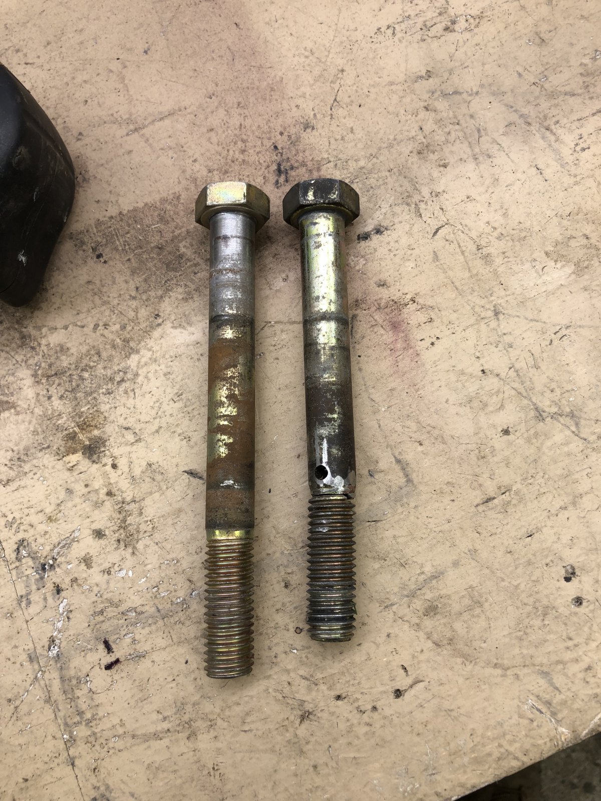

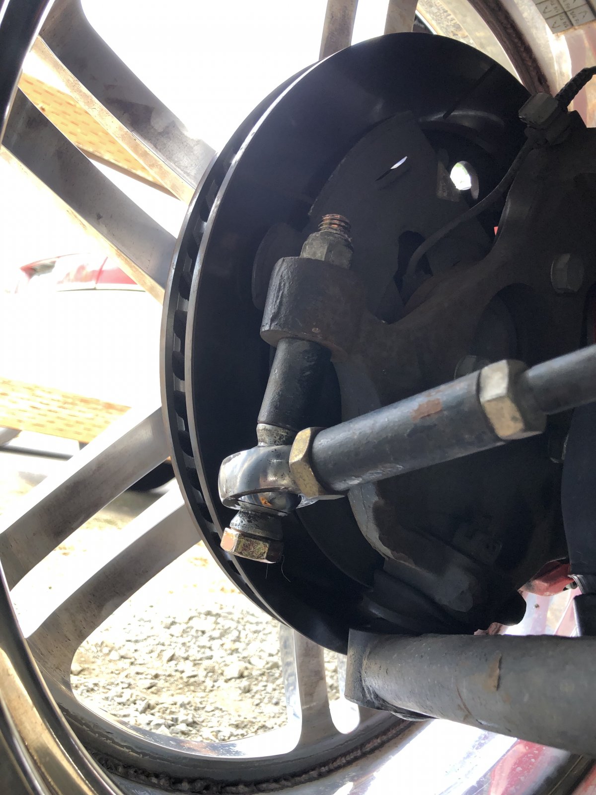

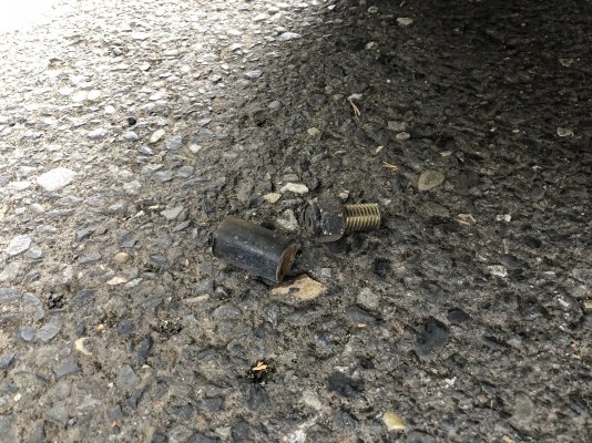

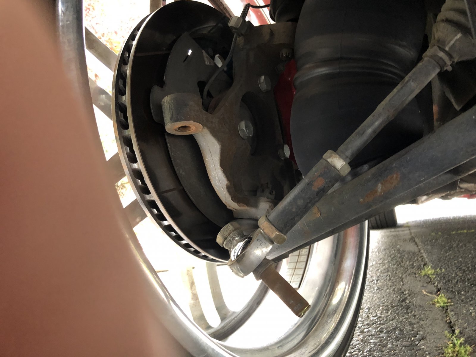

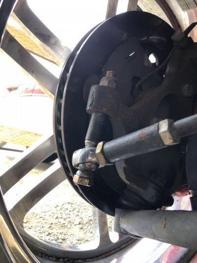

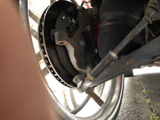

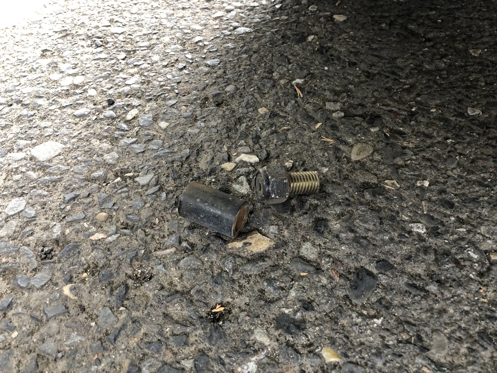

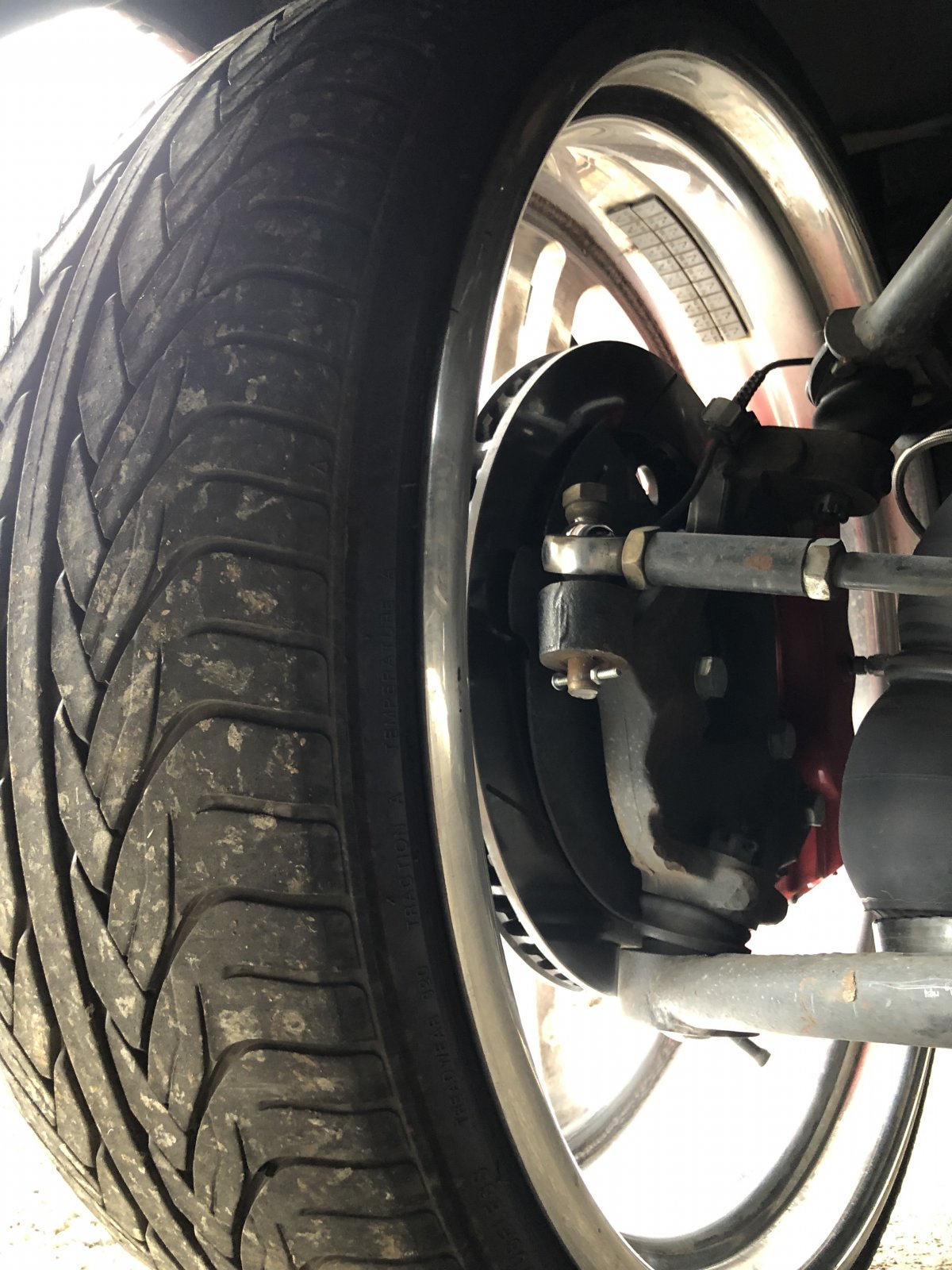

I jacked it up and see it’s a heim joint that broke. Luckily I was pretty much home and not driving down the road.
I left the spacer off and drilled a hole through the stud. Then stuck a small bolt and nut through so it can’t pop off and backed it into the driveway. I’m not familiar with these joints and not sure if I can buy that bolt alone or what. Whatever I do it will have to be stronger because this is bullsh*t.

I jacked it up and see it’s a grim joint that broke. Luckily I was pretty much home and not driving down the road.
Damn! I can't even imagine if it would've broke while you were driving on the highway!

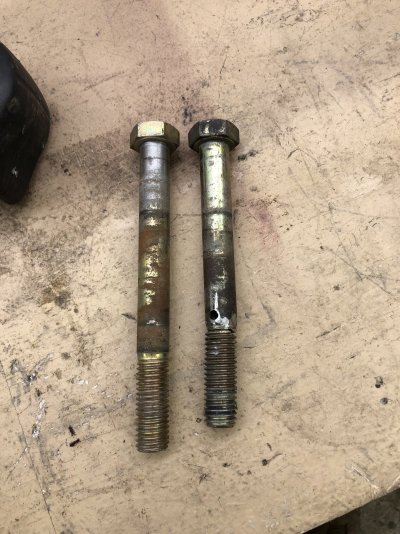

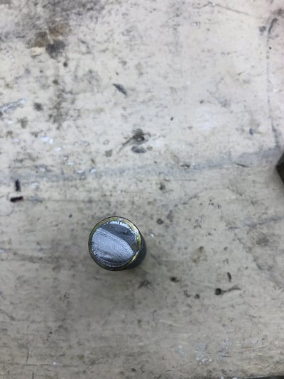

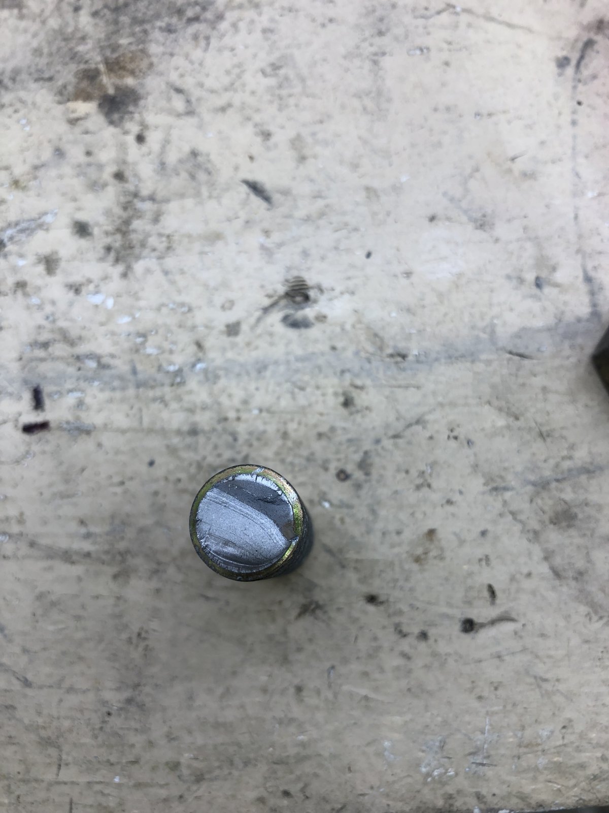

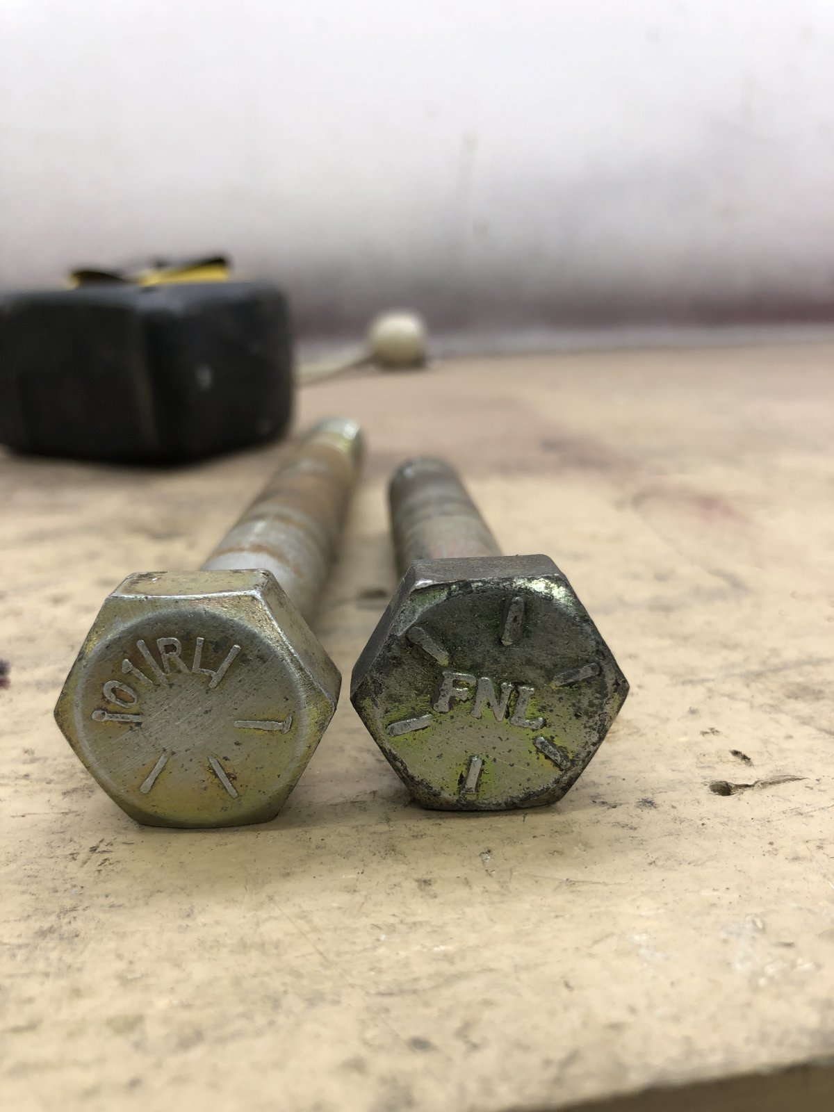

Well that was an easy fix. It was just a bolt that broke. That side had a 5/8 x 5 1/2” and the other side was a 6” with different markings so I’m not sure if the one that broke wasn’t a grade 8. I’m thinking it was one they had laying around or a Chinese knockoff. I bought grade 8’s and did both sides. I’ll probably look into getting some stronger ones. I’m not a metallurgist so I’m not sure what can be gleaned from the break, if any.

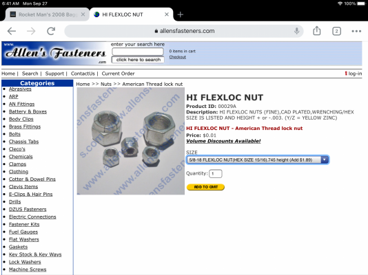

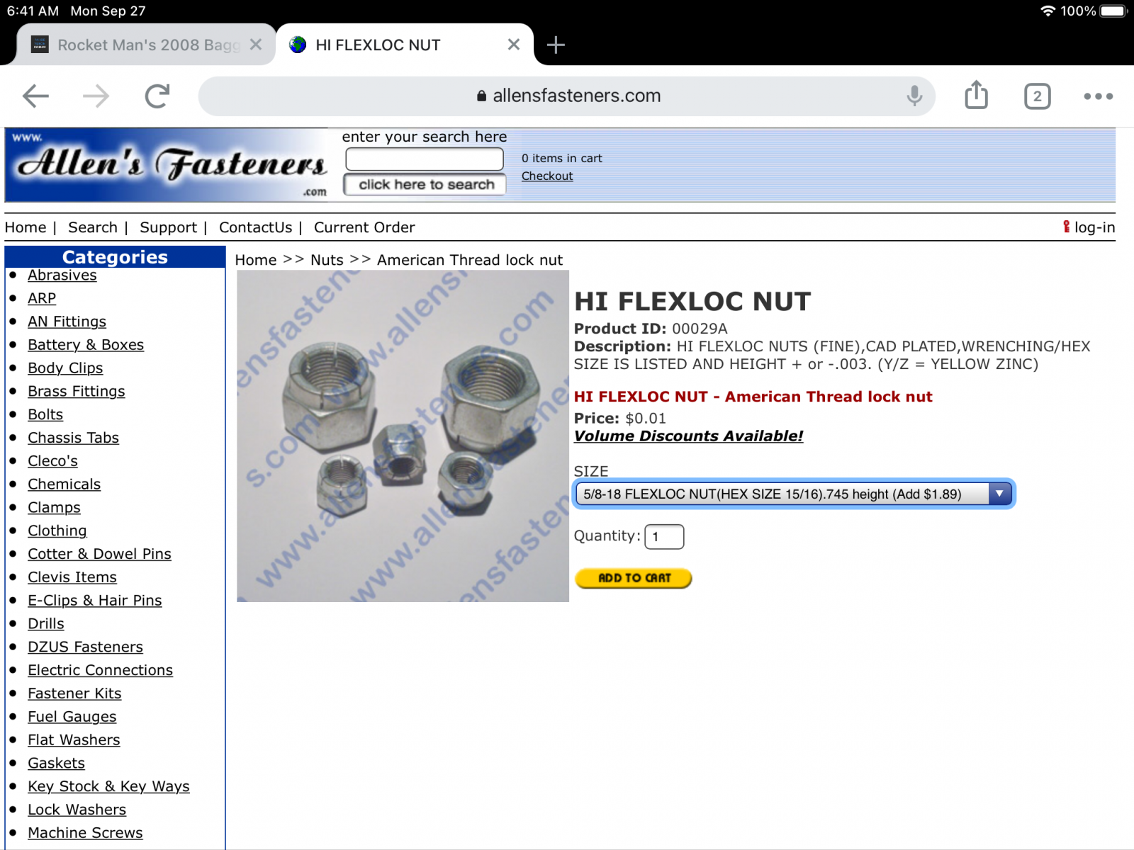

McMaster only had 5/8-11 coarse thread. I found an online seller, Allensfasteners.com, that had 5/8- 18 fine thread grade 9’s. I could only find grade 8 nylock nuts though so I’m guessing those will have to do.
id look into the crushed head locking nuts instead of nyloks for something that critical or double nut it
i say that but ive def done some sketchy **** lol
52,954
Would that be these @randeez ? They’re called Flexloc on this site.

yea something like that or
