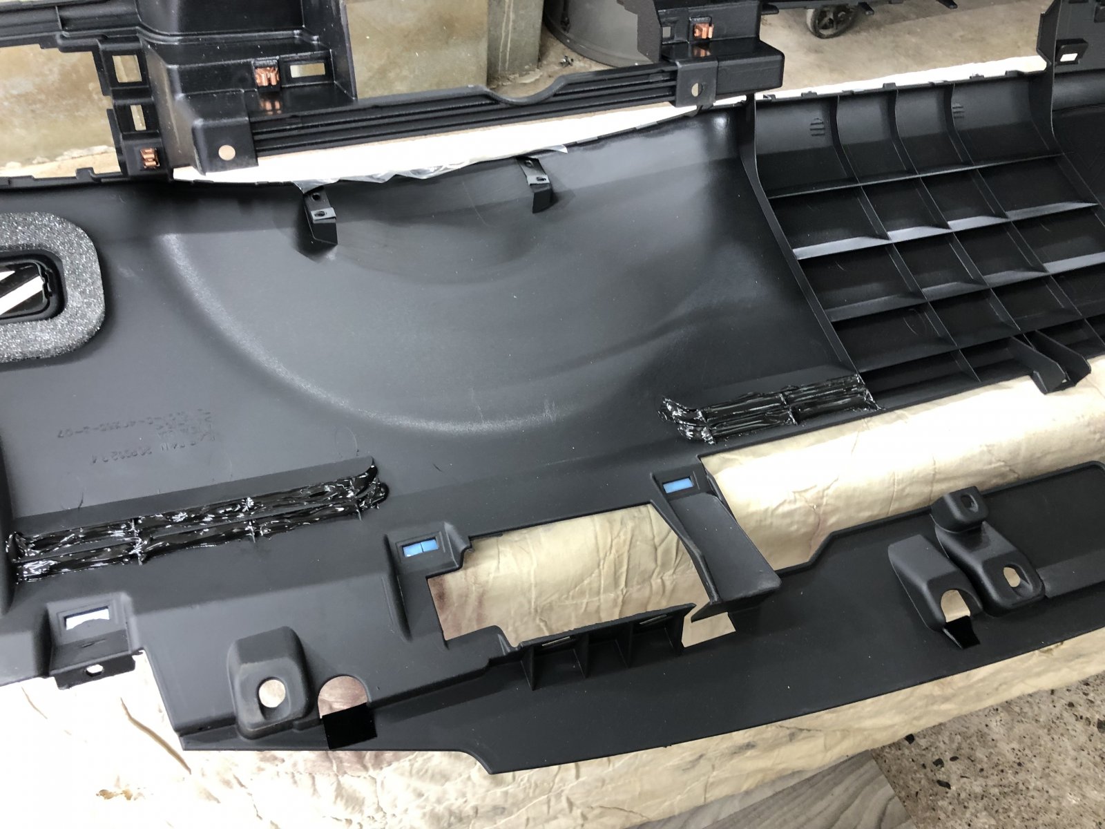

The dash came today. No speaker hole. You can see the areas where they added ribs for reinforcement at the problem areas. I’m pretty sure that’s not there on the original parts. I’m gonna add plastic epoxy panel bond in there too. I’ll take pics of the old one when I pull it, for comparison.
Yea, I don't think mine had that reinforcing, but I can't remember. 99% sure it looked exactly like the one I pulled out.:(

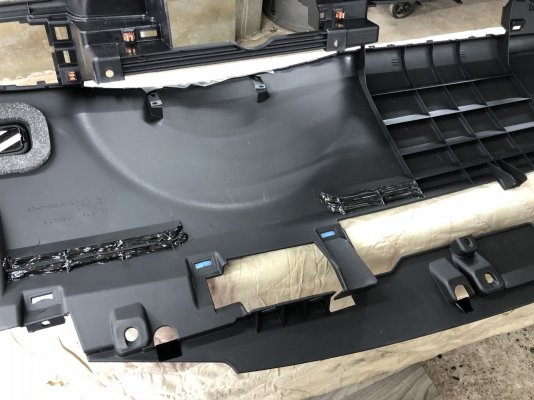

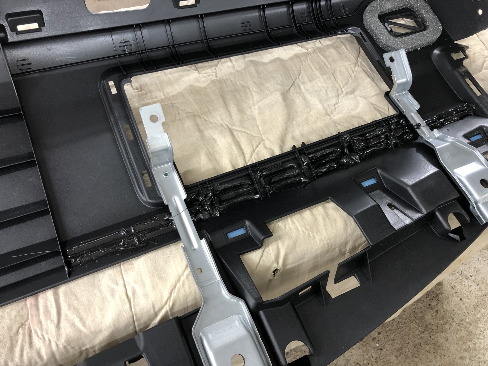

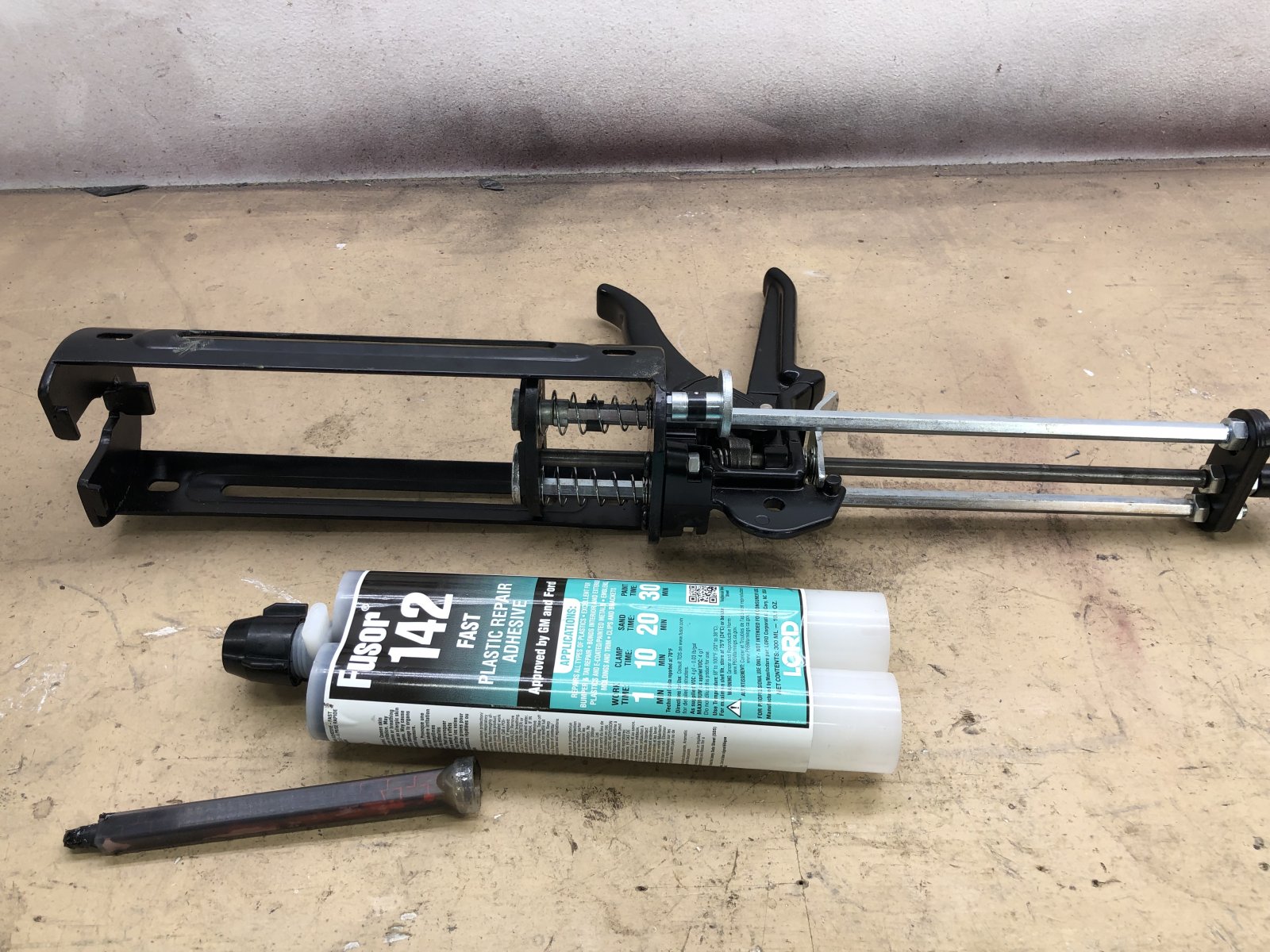

I reinforced the reinforcements on the new dash. Fusor 142 inside the ribs that GM added. The stuff is so fast that I didn’t have time to tool all of it. The swirl tip helped for mixing but it’s a one-time-use item and my last one. I can still mix it by hand. The stuff is $60 a pop.

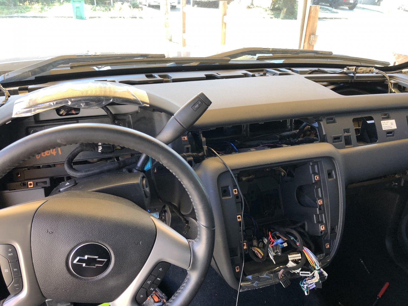

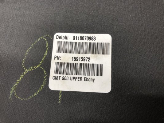

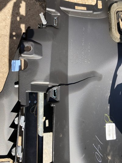

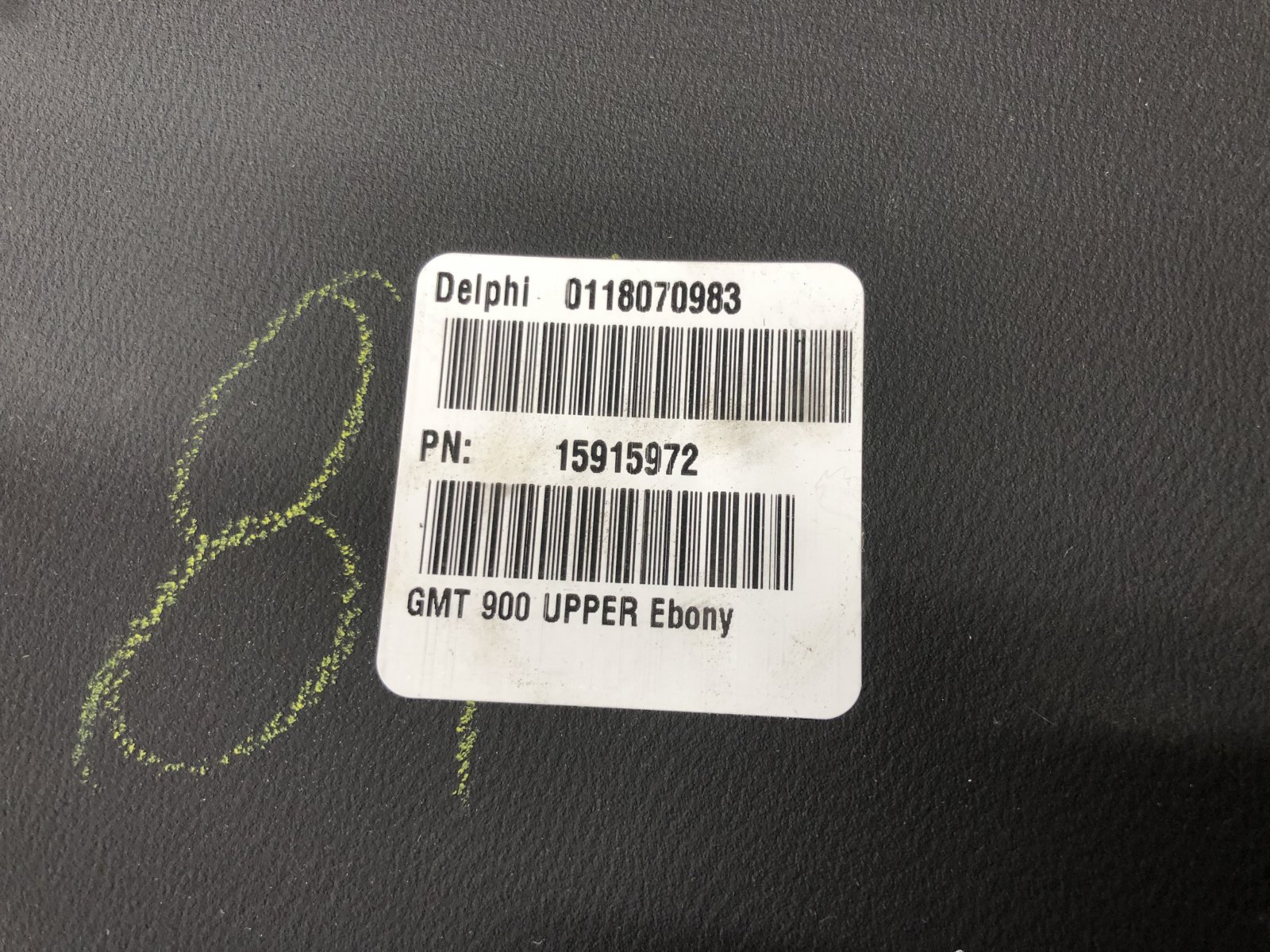

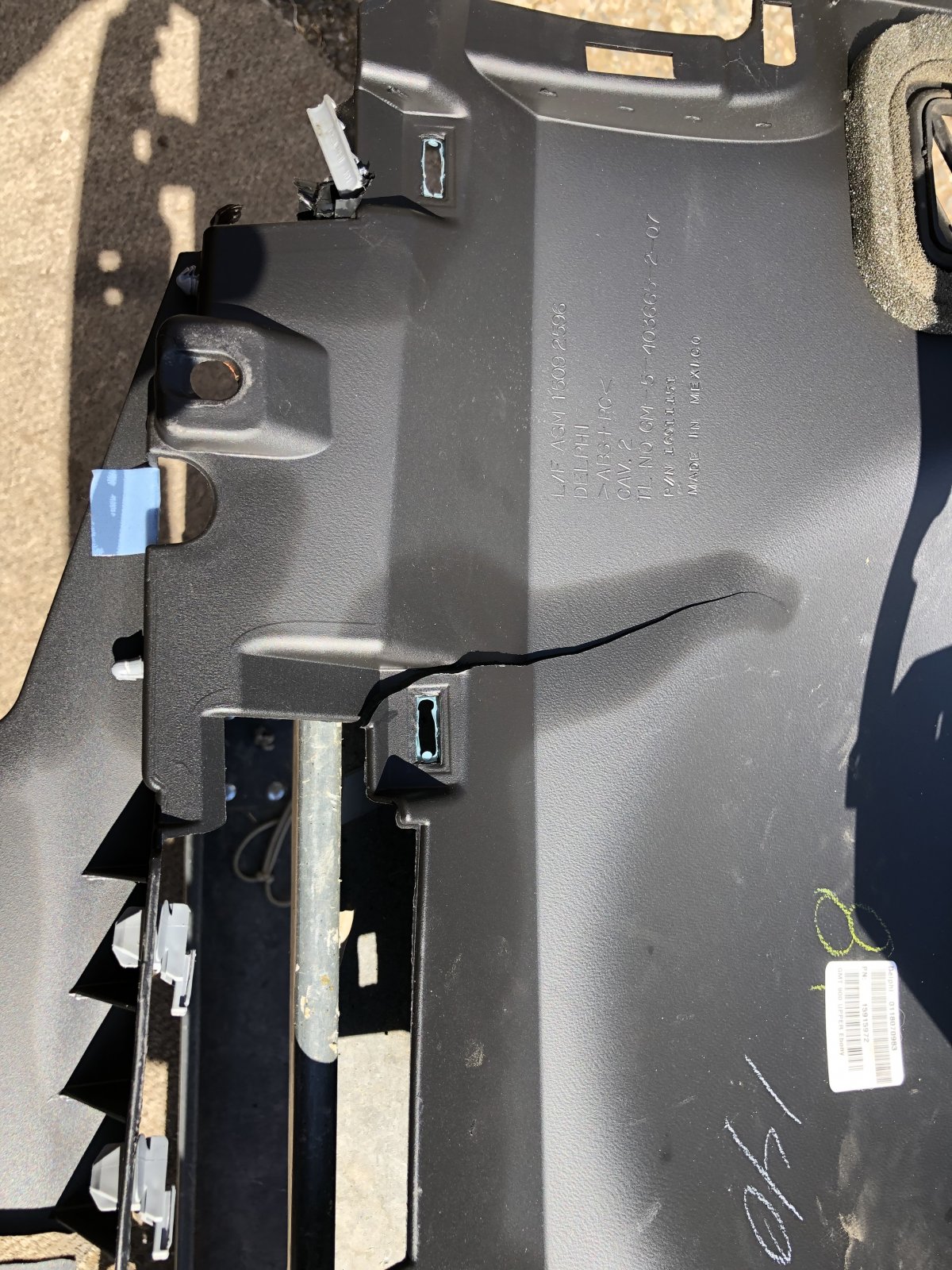

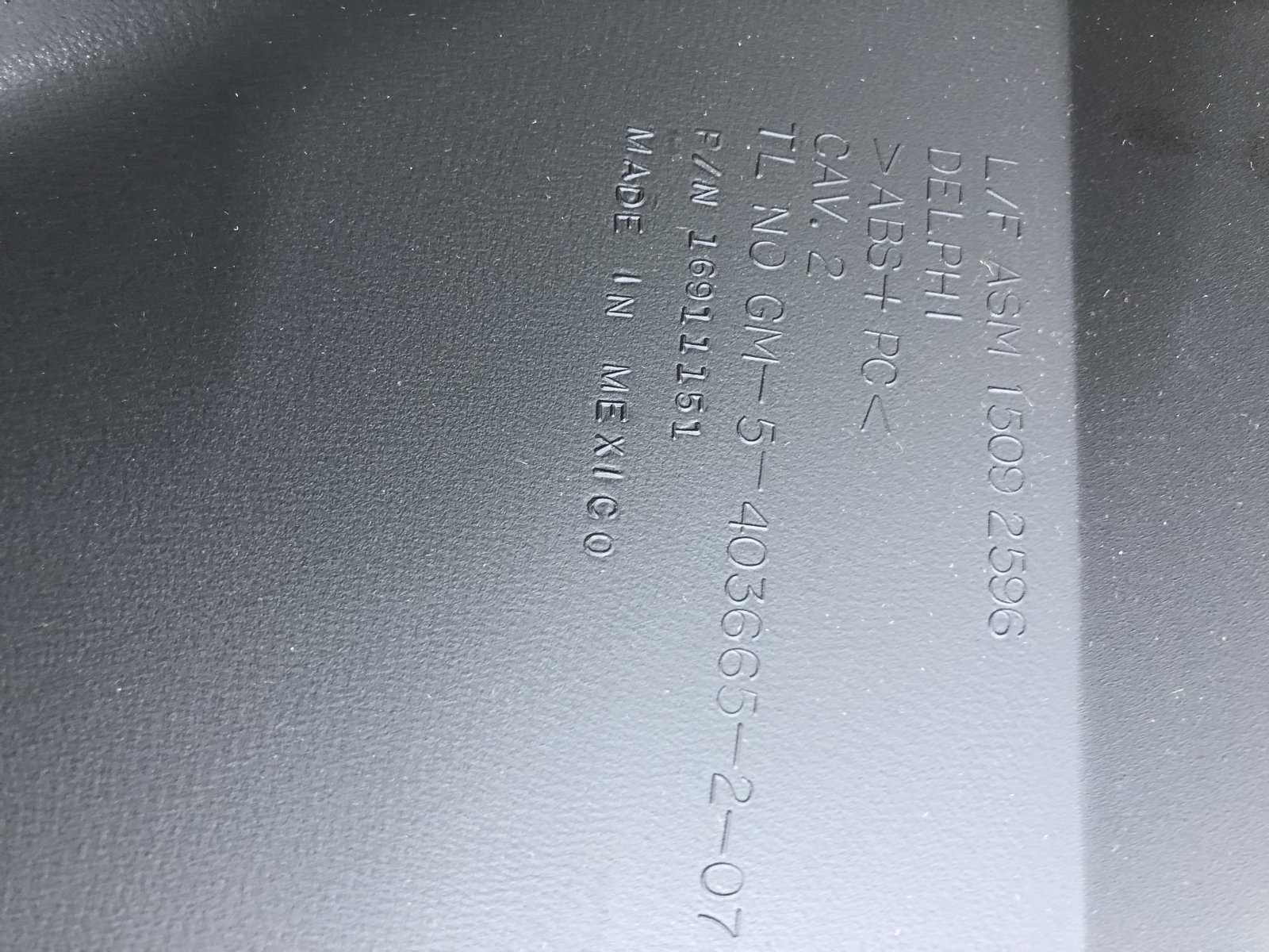

I started on swapping the dash today. I see a p/n of 15915972 on the old one which has been replaced by 19331336 if I look up that number. And the 23224747 I’m installing fits perfect so I would say for sure the 23224747 in interchangeable with the 19331336, it’s just an updated part.
I notice on the backside of the crack by the cluster hump it’s very discolored around the crack. Not sure if it’s the cause or result of the crack but the plastic right there seems brittle. If I try to make the crack continue, I can’t. I pulled at both sides and can’t get it to crack more, it’s pliable at the end of that discoloration. Weird. Nothing was spilled on it and this crack has only been there about 3 weeks.
Anyway it’s hot outside so I’ll finish this tomorrow morning.
