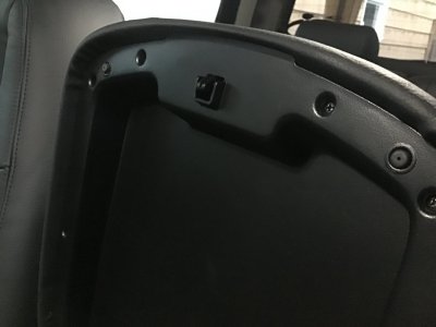

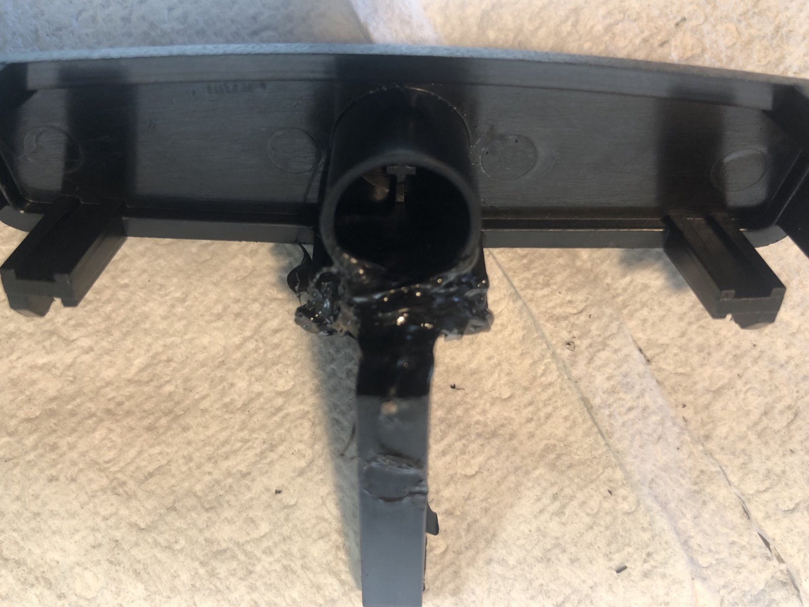

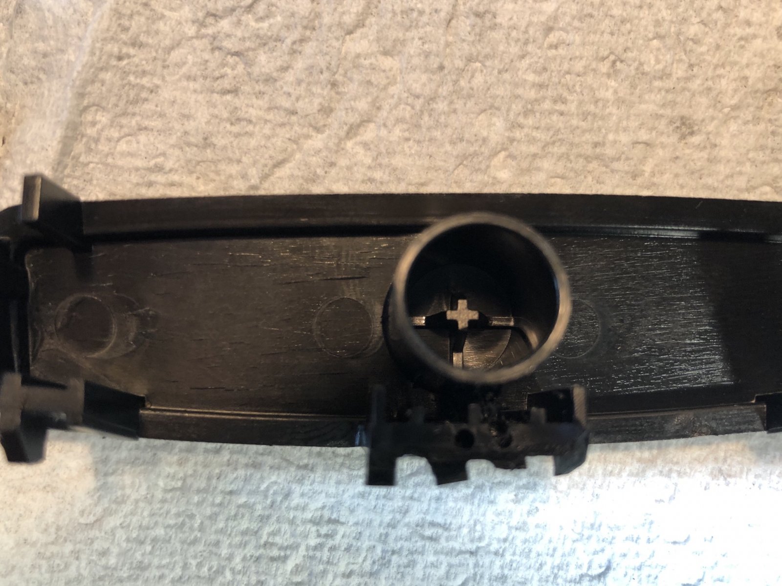

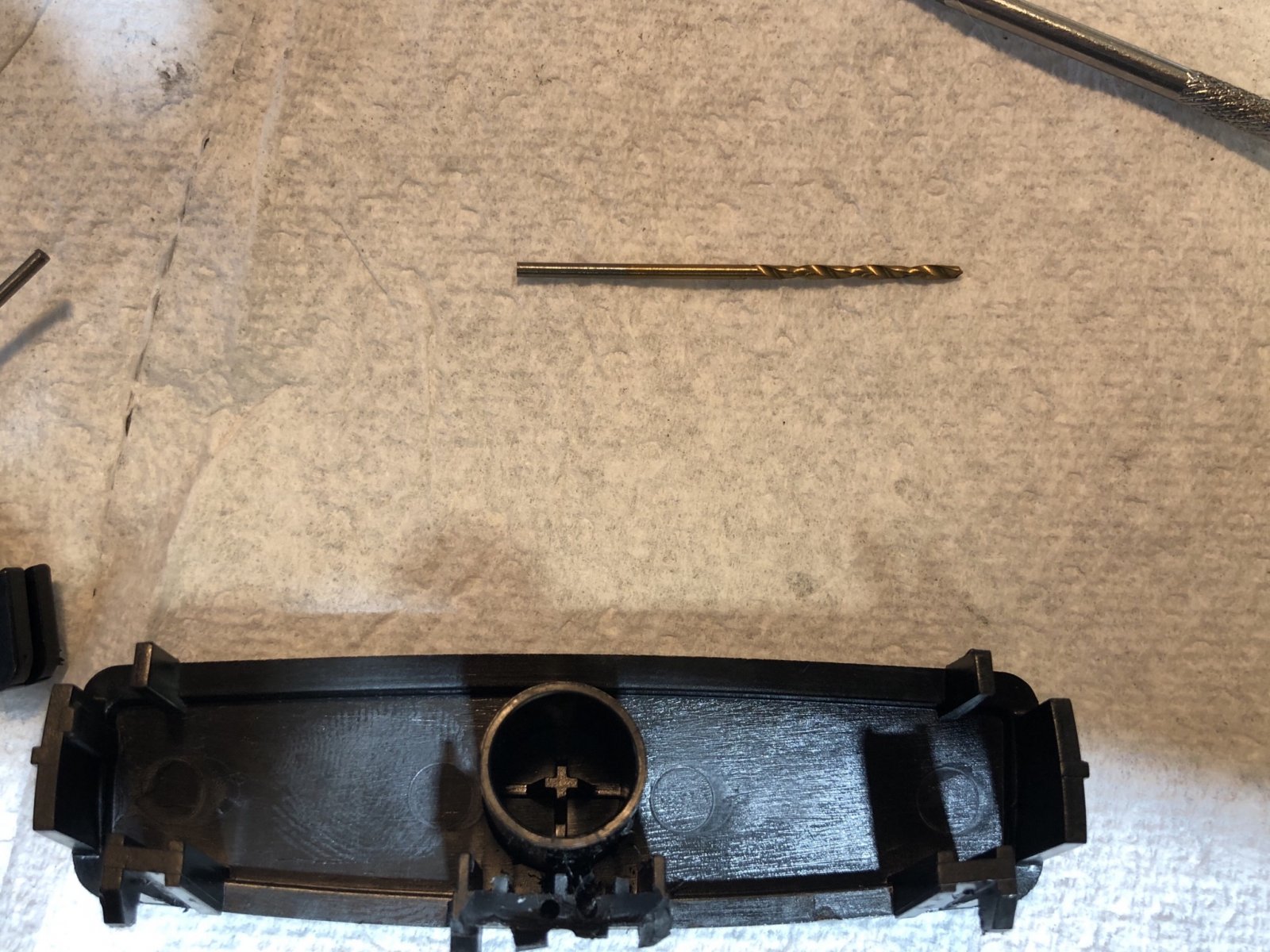

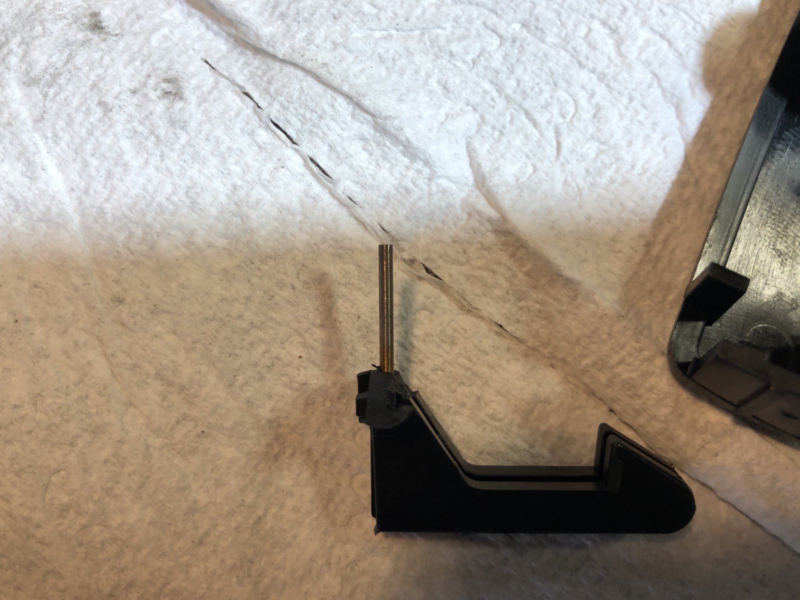

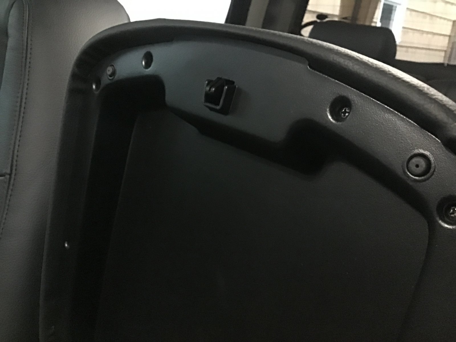

The EBay idiots I bought the console lid from never shipped it, just provided a tracking # so I got a refund and ordered one off Amazon. But I’m thinking that latch will probably break too and I want a strong one so I drilled a hole through the thing with a 1/16” drill bit, cut the bit to length, and used it as a metal rod to strengthen it and then bought another tube of Fusor 142 Plastic Repair Adhesive ( I wanted some on hand anyway) to use as a repair. I think my design is strong. It turned out a bit messy because it’s about 95 in my garage and the Fusor has a 5 minute working time in normal conditions, today I think I had about 2-3.

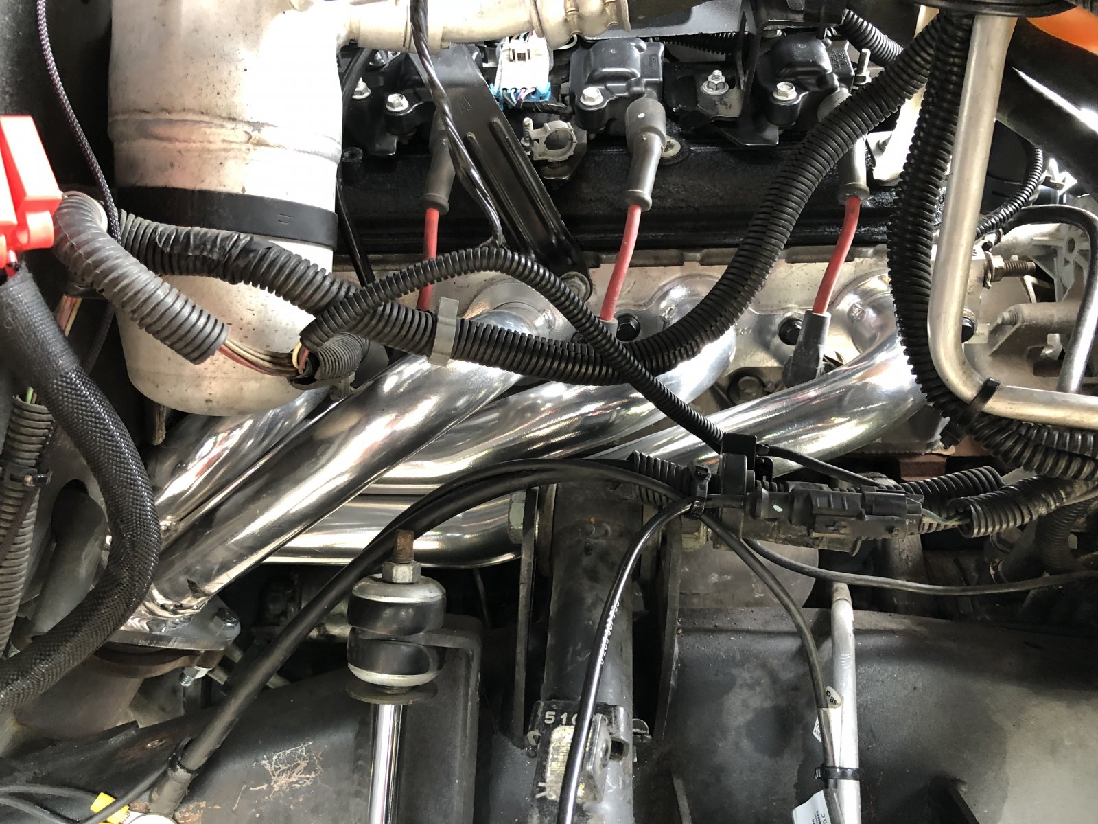

Thanks guys. I got the shorties installed today and I’m running with no muffler ATM. I ordered a SLP Loud Mouth bullet muffler, it’s about all I have room for. I wanted to get an Aero Turbine but at 6” tall there was no way, a 4” tall muffler is all I can fit. Then I’ll see what i can do for a turn down. I have almost no room left over as far as length. Right now it’s terrible in the cab so I’ll see what the SLP does, plus I need to get the exit farther back. It’s under the rear seats now. Anyway they look good in the engine bay. I did have to modify the firewall on the passenger side and the heat shield on the driver side, and I took my 5lb mini sledge to the floorboard right where it angled up, where the cat was hitting and vibrating so that’s fixed. That drove me crazy, every time I hit the gas hard it vibrated and rattled bad. Got a new sticker for my toolbox. Oh, and Justin is working on my tune to help with more chop by pulling timing at idle and lowering the idle. It’s still idling at 800 for some reason.
View attachment 250995 View attachment 250996
