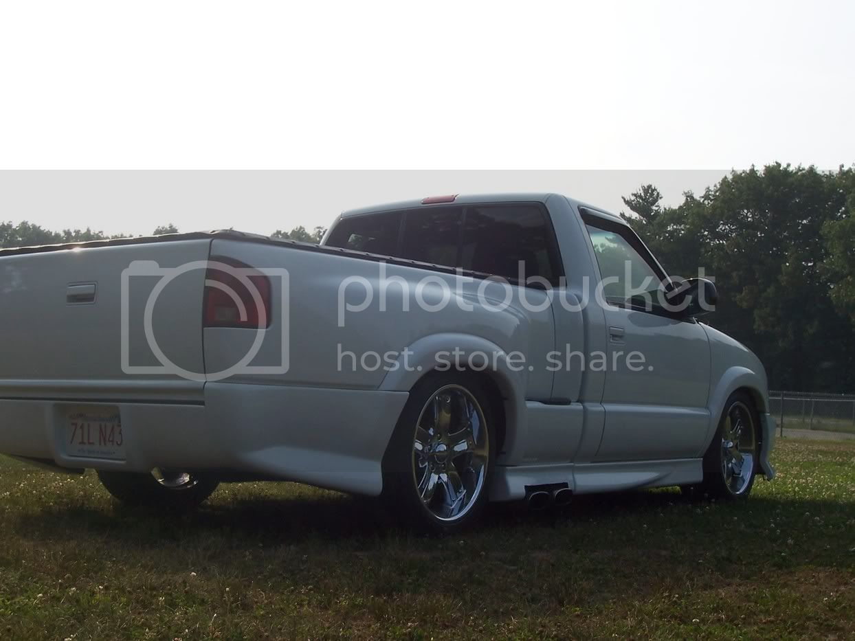

Pretty sure I already know the answer, but how do you feel about the exhaust exiting through the panel? I mean having professional body work done. Not those cheap trim pieces that you cut a hole, screw 'em down and route the pipe through that. I'm thinking more of an arch(es) formed into the very bottom in the area in front of the right rear wheel. Have the tip(s) come out there. It'd technically be under the panel rather than through it.
NOT this:
Something like this, but way cleaner. Have the notch(es) match the tip(s):

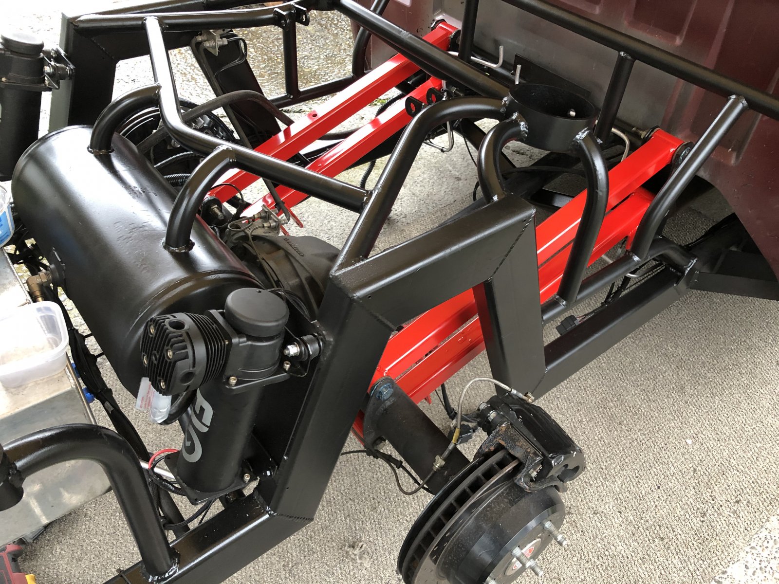

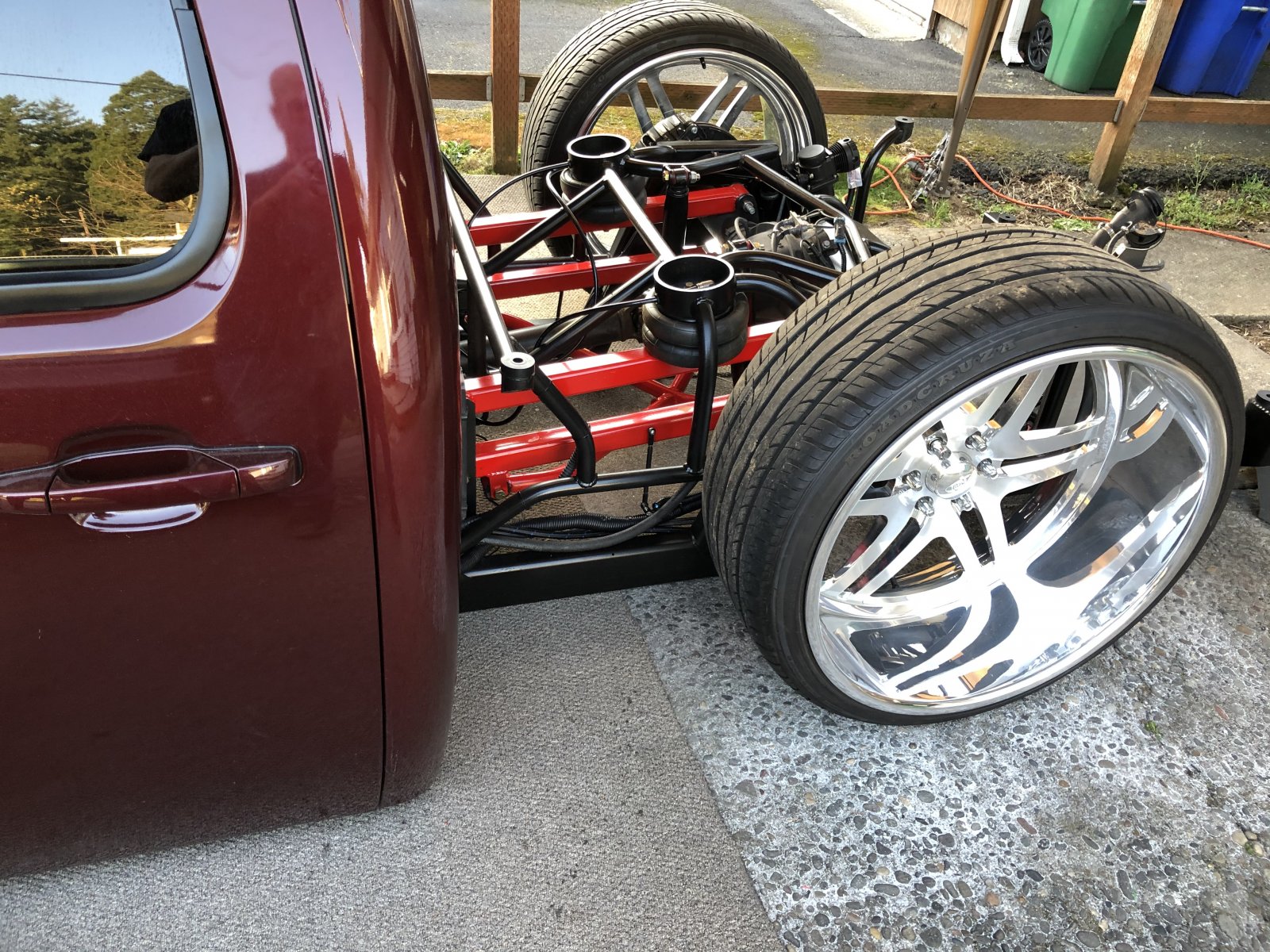

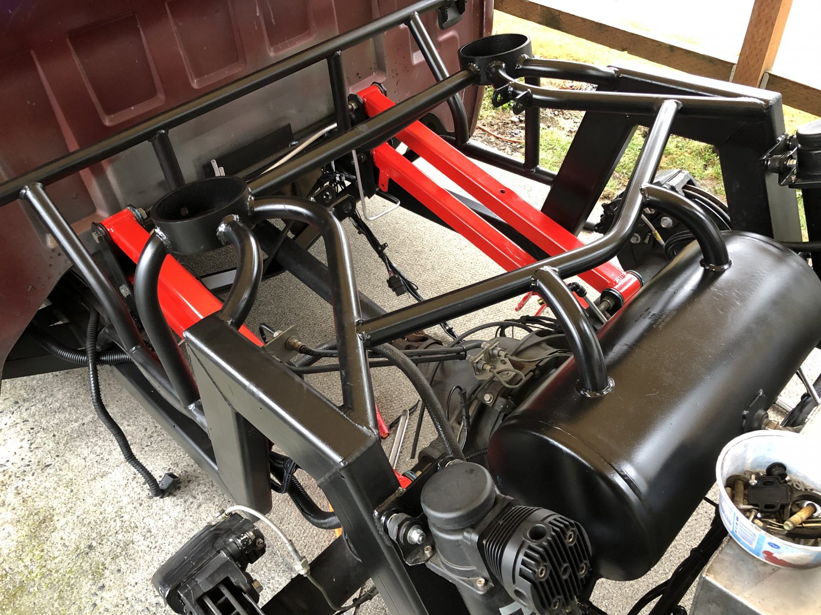

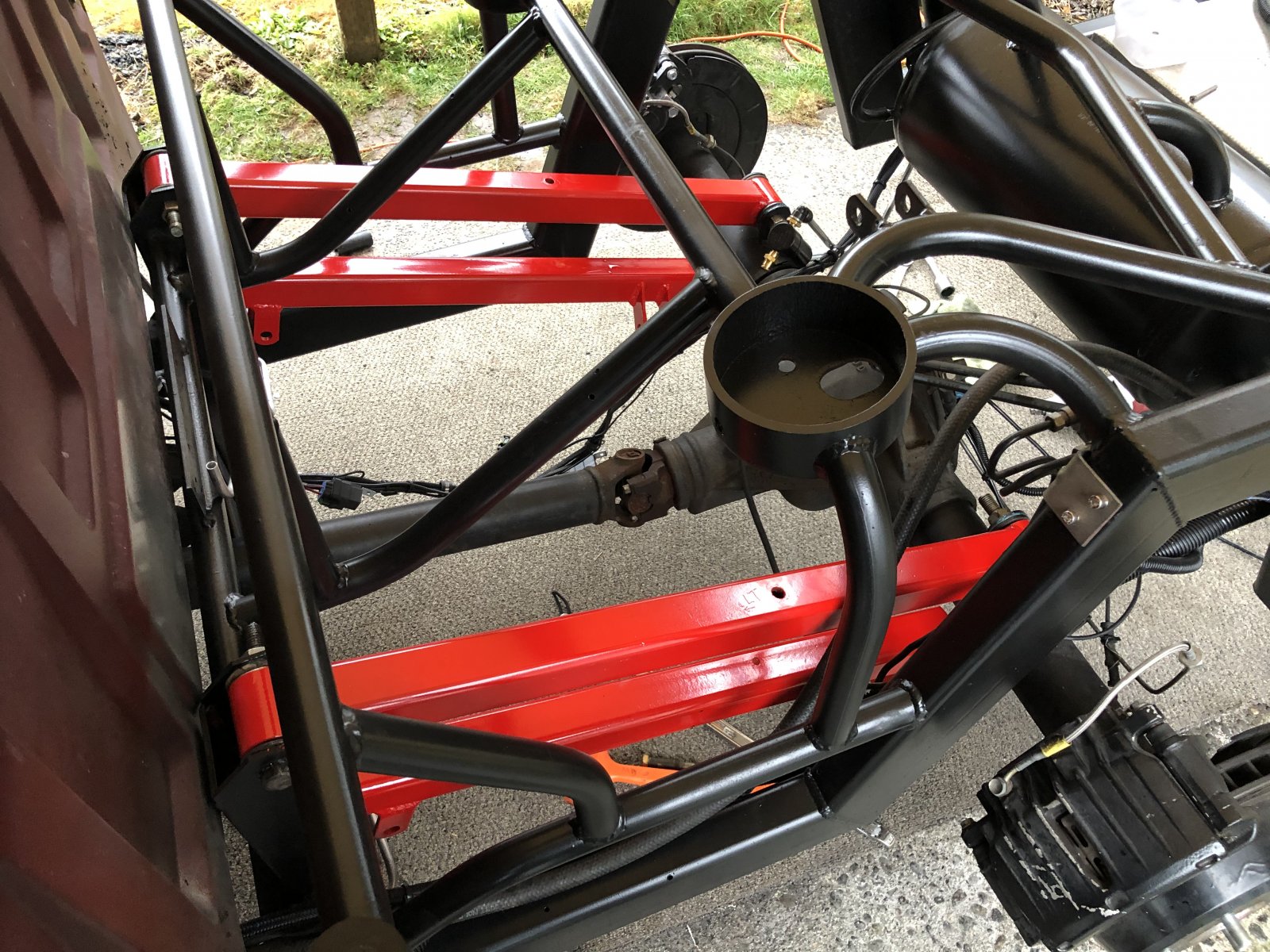

Even if I was ok with that, there’s no route for it due to my 4-links being right there as well as the crossmember that’s right behind the cab. I’ll see if I can find a pic. I would need dual exits anyway, I couldn’t do a single exit. That would drive me crazy to not have one on the other side. I thought about all this long ago as well as a way to get it out the rear, maybe through the bumper. I just have limited room due to the frame height, rear suspension components, air lines etc. You have to remember the links travel a long ways up and down- I barely had room between the limits of them to run a single hard air line through on either side at a point fairly close to their pivot point in the front. There’s no way an exhaust pipe would work.

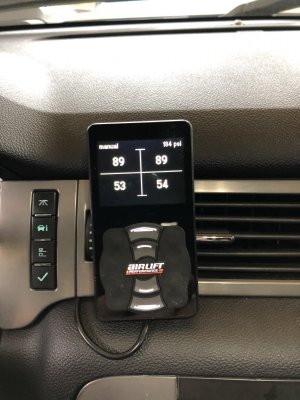

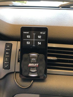

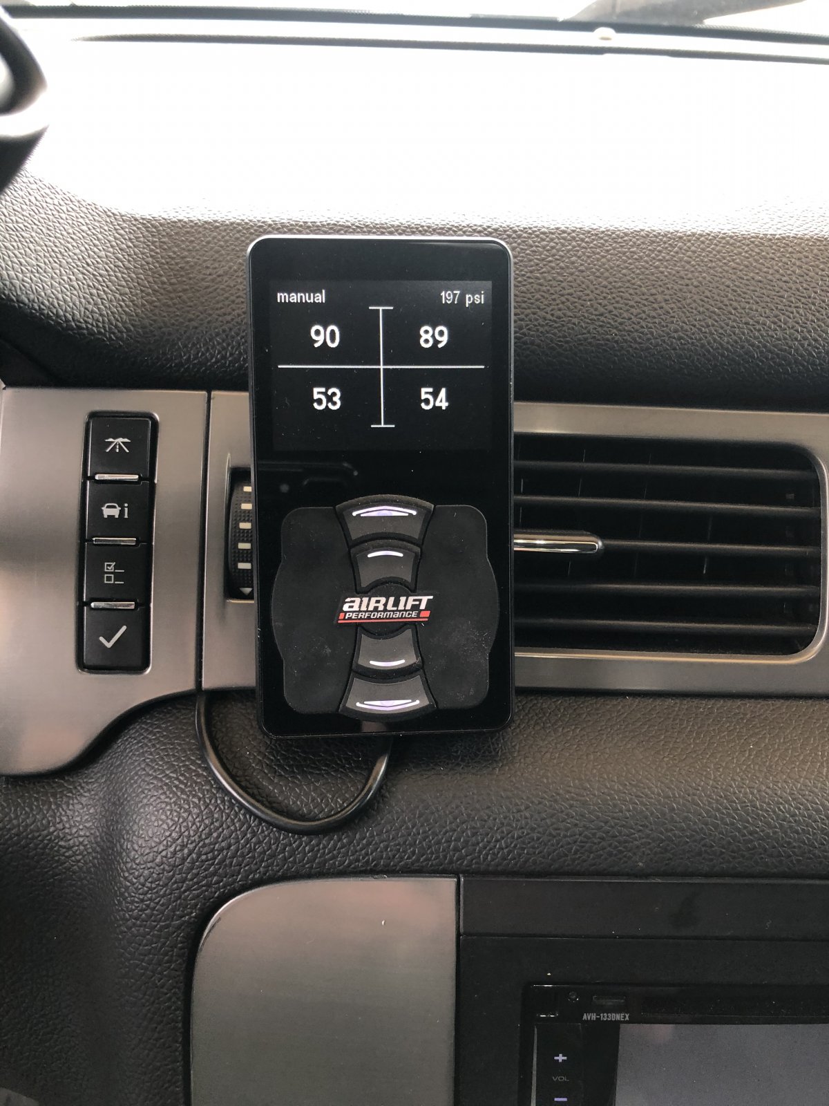

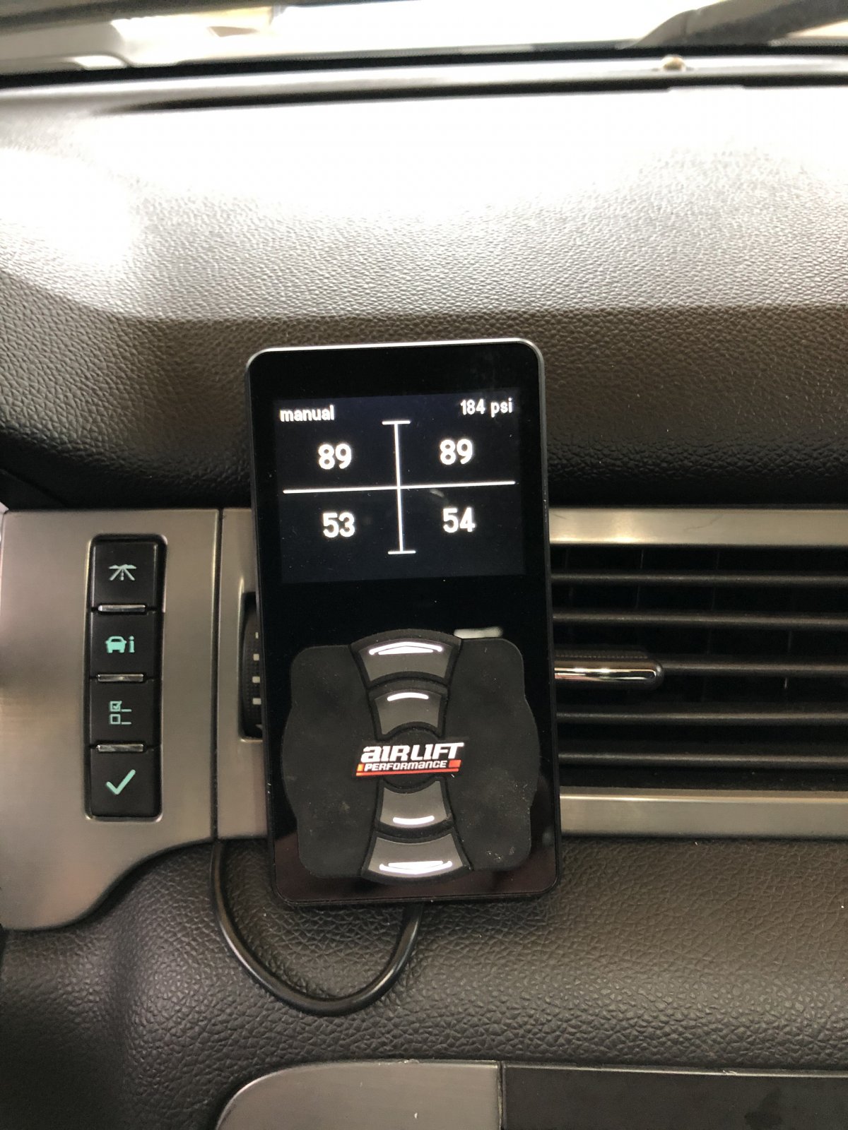

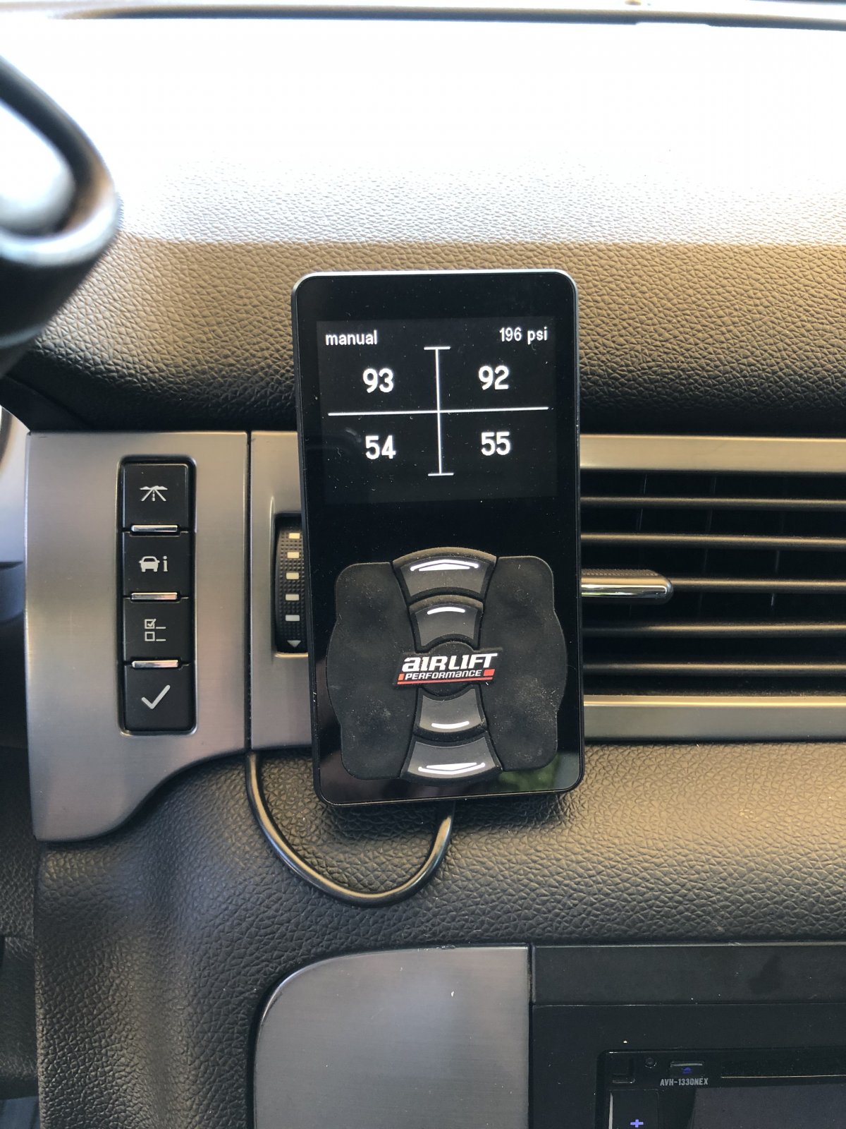

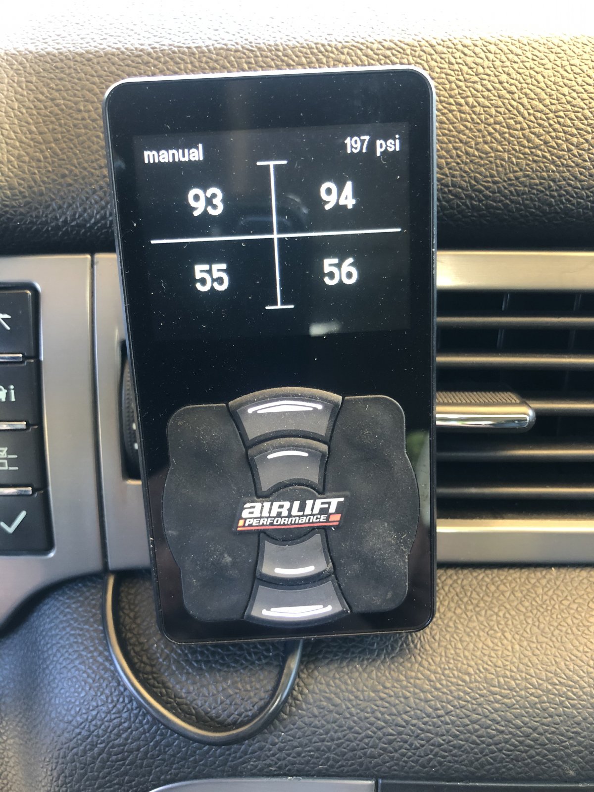

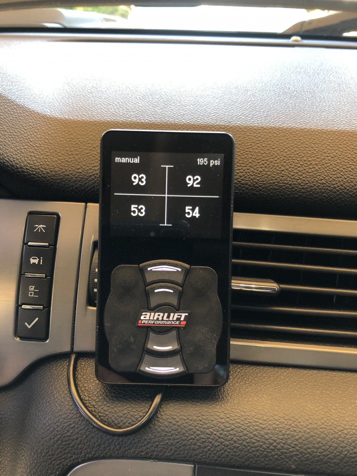

I officially declare the air leak issue resolved. I replaced both front bags so now all 4 are brand new. Here’s the pressures over the last 24 hours. I attribute any differences to the temperature change between yesterday’s 92 when I originally aired it up to today’s 73. For the first time since I’ve owned this truck I can leave it aired up and it will stay. That was a hard leak to find. I would have found it sooner I think if it originally had 2 lines going to the front instead of one because it would have occurred to me that it was a bad bag I bought right after buying the truck instead of thinking it was a line. The entire front would go down with the original air management and then it was just the one side. And only if the weight of the truck was sitting on it. Shit.
