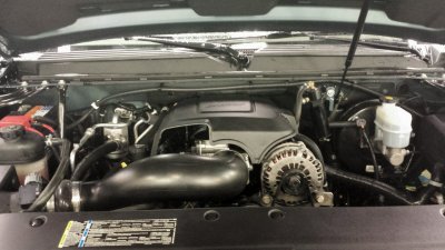

Dont have anything to say that hasnt been said so heres a pic of my setup haha
@iamdub what can do you have ? It kinda looks like mine but I completely forgot what one mine is :confused: I lve had it for way too long and its been swapped from my 05 tahoe to this one a few years back
45,012
Yours and mine are the catchcans.com one. I put a 1/4-turn valve ($5ish at Harbor Freight) in the bottom of mine to make draining easier and mess-free. I also added a stainless steel scrub pad to it to improve the can's efficiency. I saw recently that some of the cans on Amazon are coming with a scrub pad.

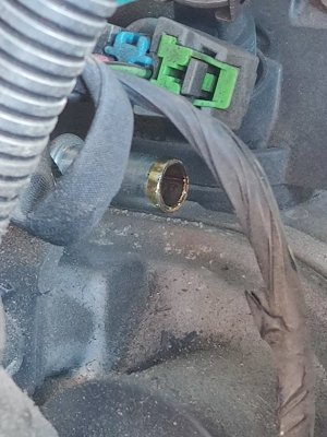

I cleaned out the TB when I removed it and bought a new breather hose. I'll also try to take pictures of the intake tube where I see the oil residue just so everyone and see what I'm seeing.
the pics are mixed up but u can see the breather hose nipple with oil on it. I tried to take a couple of pictures of inside the breather tube, and I took a picture of inside the intake tube with some residue
