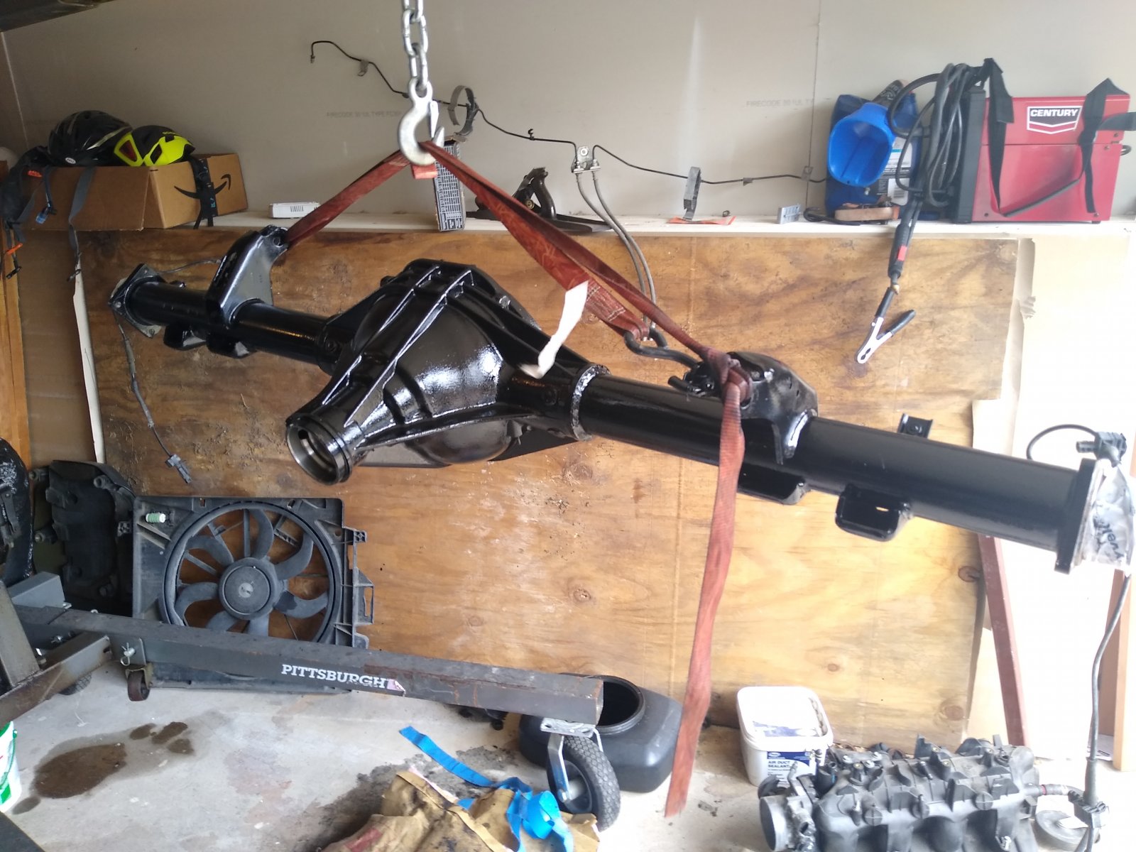

My next mod (besides the rear diff) is going to be a forged stroker bottom
end. I'll do a 3.90 stroke crank with forged internals and keep the compression
below 10.5 so I can add the supercharger back on if I want to later.
