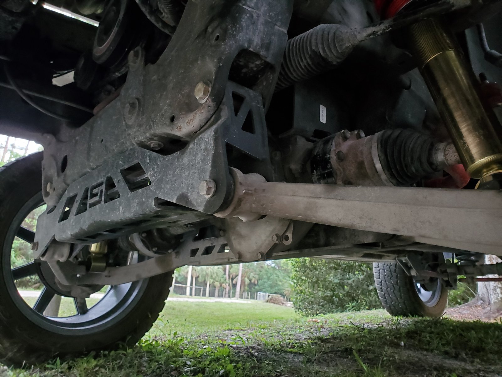

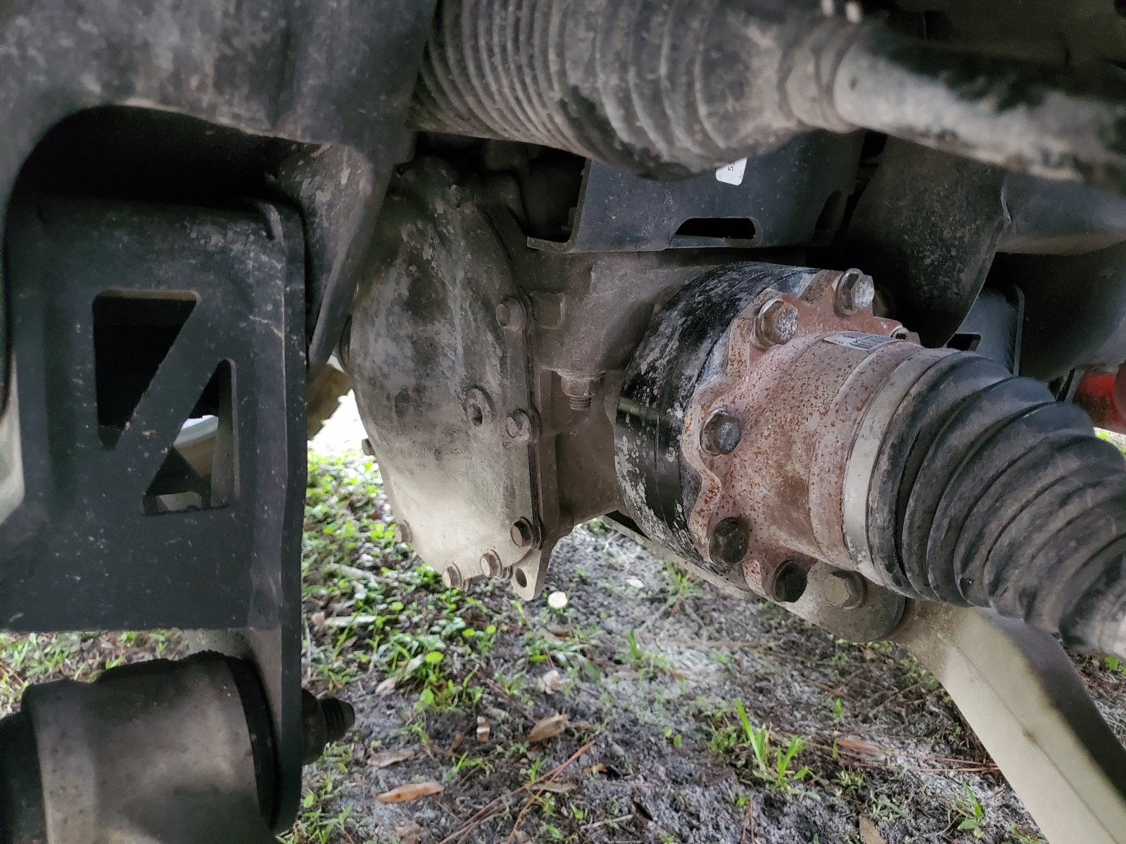

This the front diff you got the Cognito spacers for? I went back and Re-read that thread this morning. When I read it the other day I didn't catch that it was 2010+ 2500. Was it a Silverado/Sierra? Is it a 30 or 33 spline?
edit- and is it AWD or 4x4 hi/lo
randeez
Sep 29, 2017
7,931
25,084
south florida
yea silverado/sierra 2500/3500,
spline - inside the diff i think are 33? but doesnt really matter youre connecting to the 8 bolt axle stubs.
the 8bolt complete cv axles are 36 spline iirc. cant use them on 1500s or pre-2010 2500s, however gmt900 and pre2010s are same size and both 33 spline at the wheel hubs
and i dont mean 8bolt wheel hubs...connecting to the stub shafts are 6 hole for 1500, 6 bolt for pre2010 2500+ (larger than 1500) and 2010 HD+ are 8 bolts
so you need the 8 bolt inner cup to the 33spline outer.
oem axles you can pull the cv joint off the outer side of both pre/post HDs and swap them making a longer axle with oem parts.
aftermarket axles you cannot swap the cv joint, but you can swap the inner "tripod" cups between the two, but axle shaft between the two is shorter
spacers may not be needed if you use the longer 2010+ shafts and swap the outer joints onto them, but at the time i was only buying aftermarket axles and couldnt so they were short. wasnt looking to spend $300+ on each axle (x4) for oems just to see if it would even work
or call RCV and confuse the fck out of them and they will send you a set after a few tries for $2800 bux

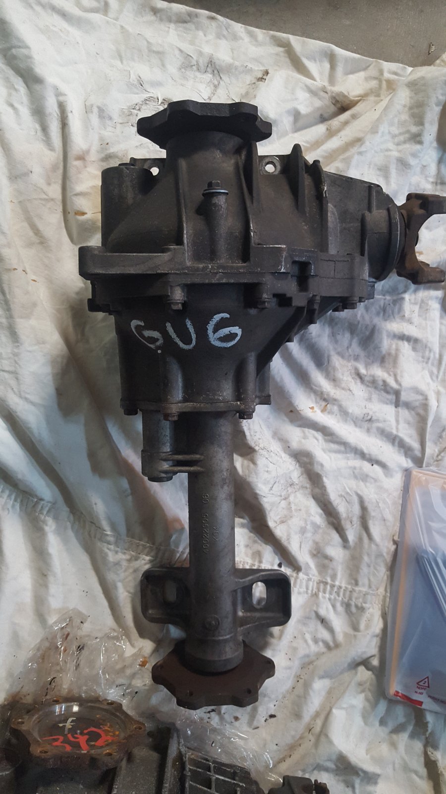

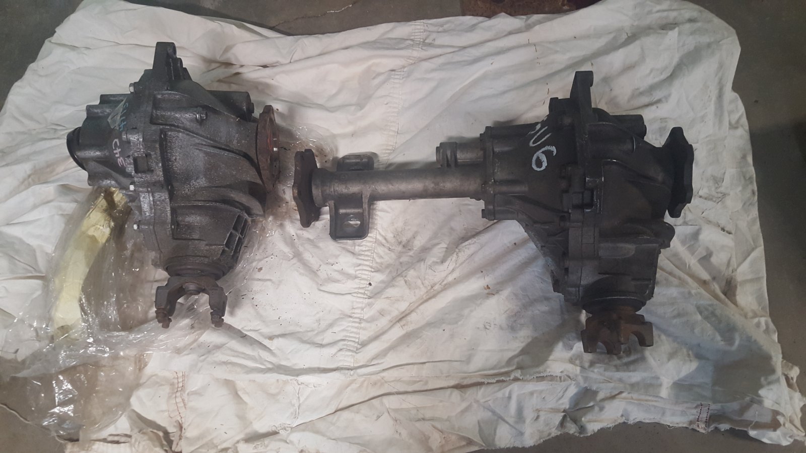

90 minute drive to salvage yard and THERE WASNT ONE 9.25" FRONT NOR ONE 9.5" REAR axle at this place... Despite the fact that I talked to dude 5 times this week, including twice this morning, each time making it crystal clear what I was looking for.....smh
The only thing that kept me from going ballistic was the 77k mi 8.25" w/3.42's in it... Only had 77k miles and was 1/3 the cost of the unit I bought yesterday. It was a good deal but not good enough to make me forget what stupid is..

90 minute drive to salvage yard and THERE WASNT ONE 9.25" FRONT NOR ONE 9.5" REAR axle anything at this place... Despite the fact that I talked to dude 5 times this week, including twice this morning each time making it crystal clear what I was looking for.....smh
The only thing that kept me from going ballistic was the 77k mi 8.25" w/3.42's in it... Only had 77k miles and was 1/3 the cost of the one I bought yesterday. It was a good deal but not good enough to make me forget stupid

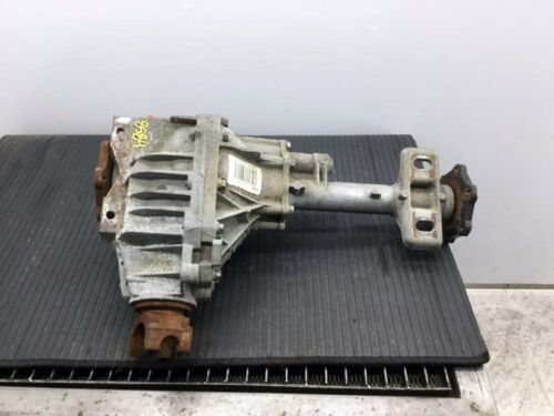

What year are you working on? Cause I don't think those front axles are for an 07+, the tab on the top is how they mounted up to 06 (07 classic trucks) gmt800s. Gmt900s have two mounting holes right next to the stub shaft on diversside
Mine 2011.... Both those are 8.25's.
Not sure what year the one missing it's long tube flange came off of? Didn't see donor. Part was on shelf. Only bought because it was the closest 3.42 to me and literally had to go right past that yard Tue. Also, assured I could go ahead with rear swap and not worry bout having to roll 4x2(in Feb) until I found a 3.42 front. It was the $300 one, gonna return it.
The fully intact(better pic here) one came out of '08 Burban. Was still in truck yesterday. It was only $100.00, and we had just driven 90min to get a 14-9.5" w/a 9.25" IFS that ol dude told me was there, on his Chevy only yard.... only to find out he didn't even know they existed.
I think it just upside down compared to your pic??

Got it, think you're right
