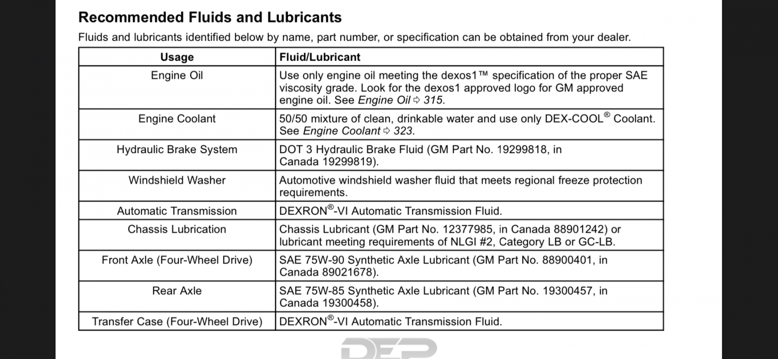

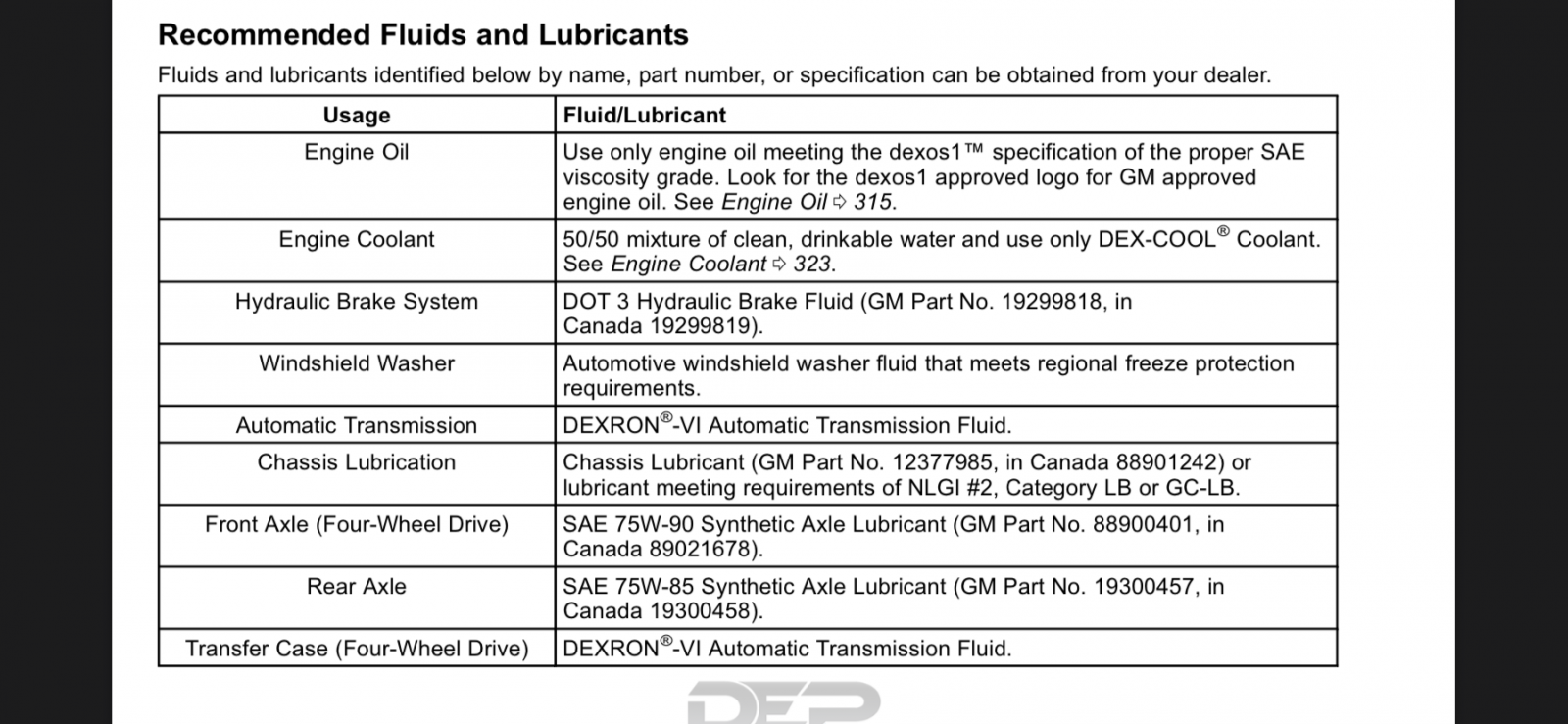

I am about to be doing a rear diff fluid. Rather than GM fluid what other fluids does anyone recommend? I do have the G80 option. Last change was done at the dealer before my free services ended and I rather use something better if available since ill be paying now.
wjburken
Dec 26, 2017
10,315
29,545
Eastern Iowa
I would go with what your owners manual recommends.

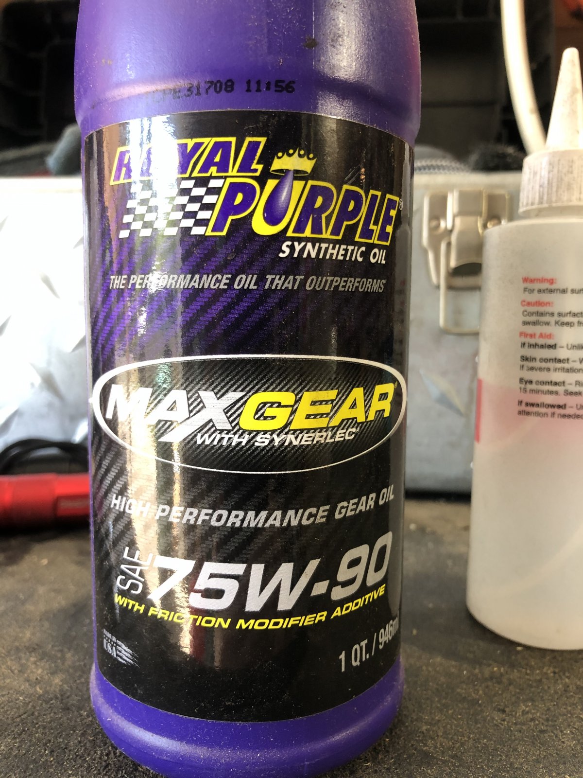

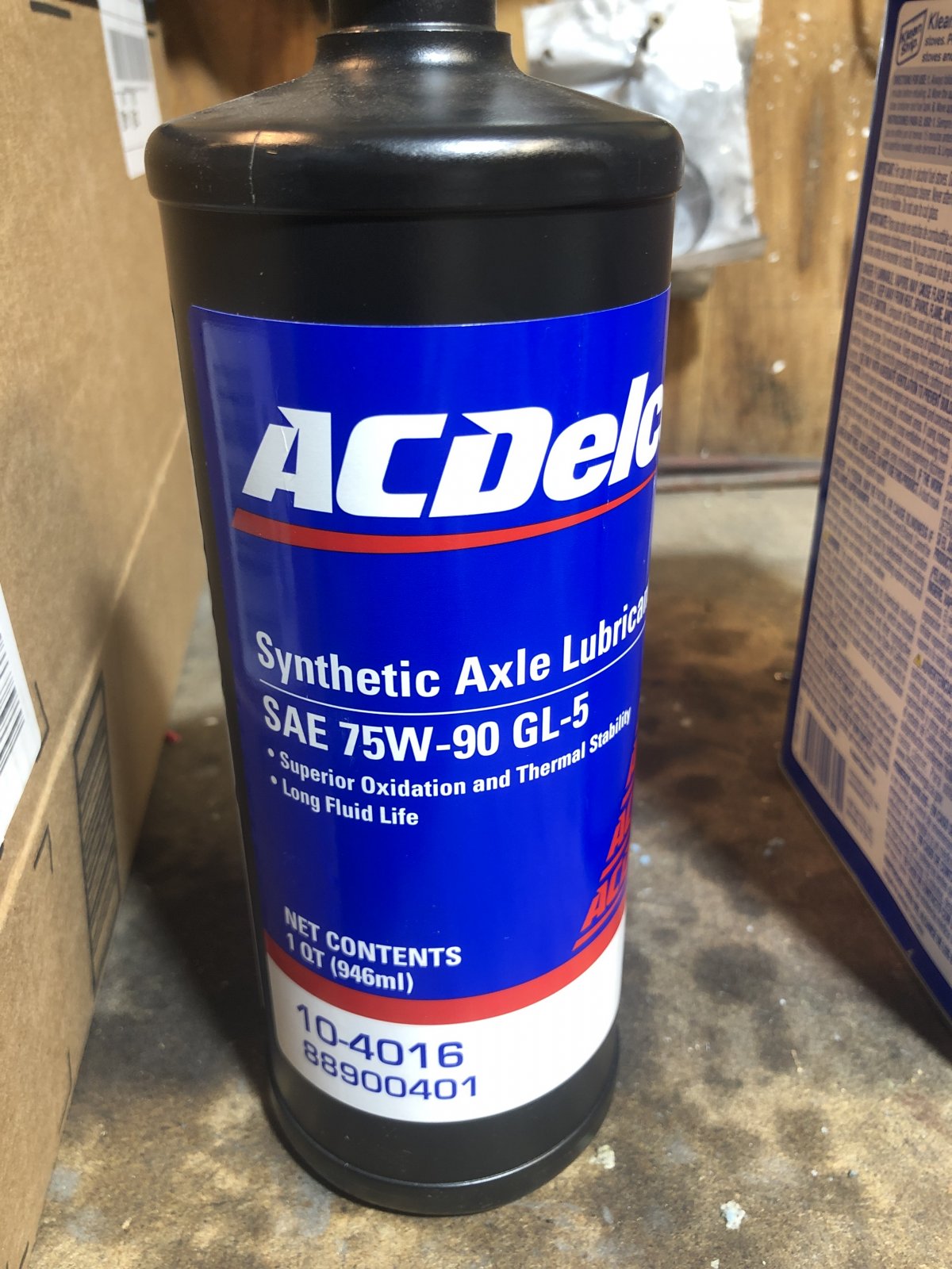

52,954
FYI to all involved, most if not all of the synthetic 75-90 gear oil from makers like Amsoil, Royal Purple, etc already have FM added. If you look at them closely you will find this. I did a lot of reading and found that RP was highly recommended by plenty of people on several forums and they’ve been running it for years with zero issues. I didn’t even think about it because I wasn’t adding FM. But last week I was looking at the jug and right there in small letters it said “with friction modifier additive”. SMH. I since have read that some believe the GM fluid also has some added, but just don’t add any additional FM separately. I was going to leave the RP in and not worry about it since I have had zero issues with it and I drive HARD and am under boost a lot but I am about to pull my axles you replace the axle bearings do I bought the ACDelco fluid to put in. It’s about the same price and it’s the recommended stuff so WTH.
