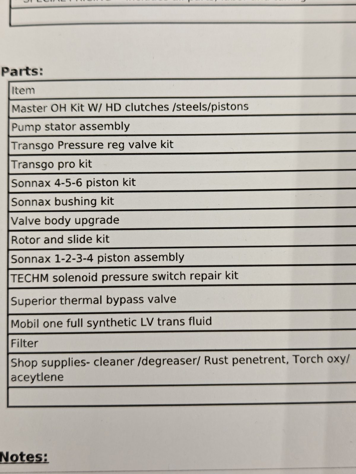

I personally would recommend the rebuild route. Warranty work is nice but a reman or replacement from OEM is going to reset your clock at 0 and start over again. I prefer the "over build it to last forever" route. My trans build part list is attached. Probably overkill for you cause this is mostly "stage 2" build out for 800HP so you can save some money but also include a billet torque converter from a reputable brand and a trans cooler like a TrueCool 40k.
The build cost me $5400 including the tune, plus the TC ($1300) which I installed years ago. As long as you are using Sonnex or Raybestos parts, you should be good.
