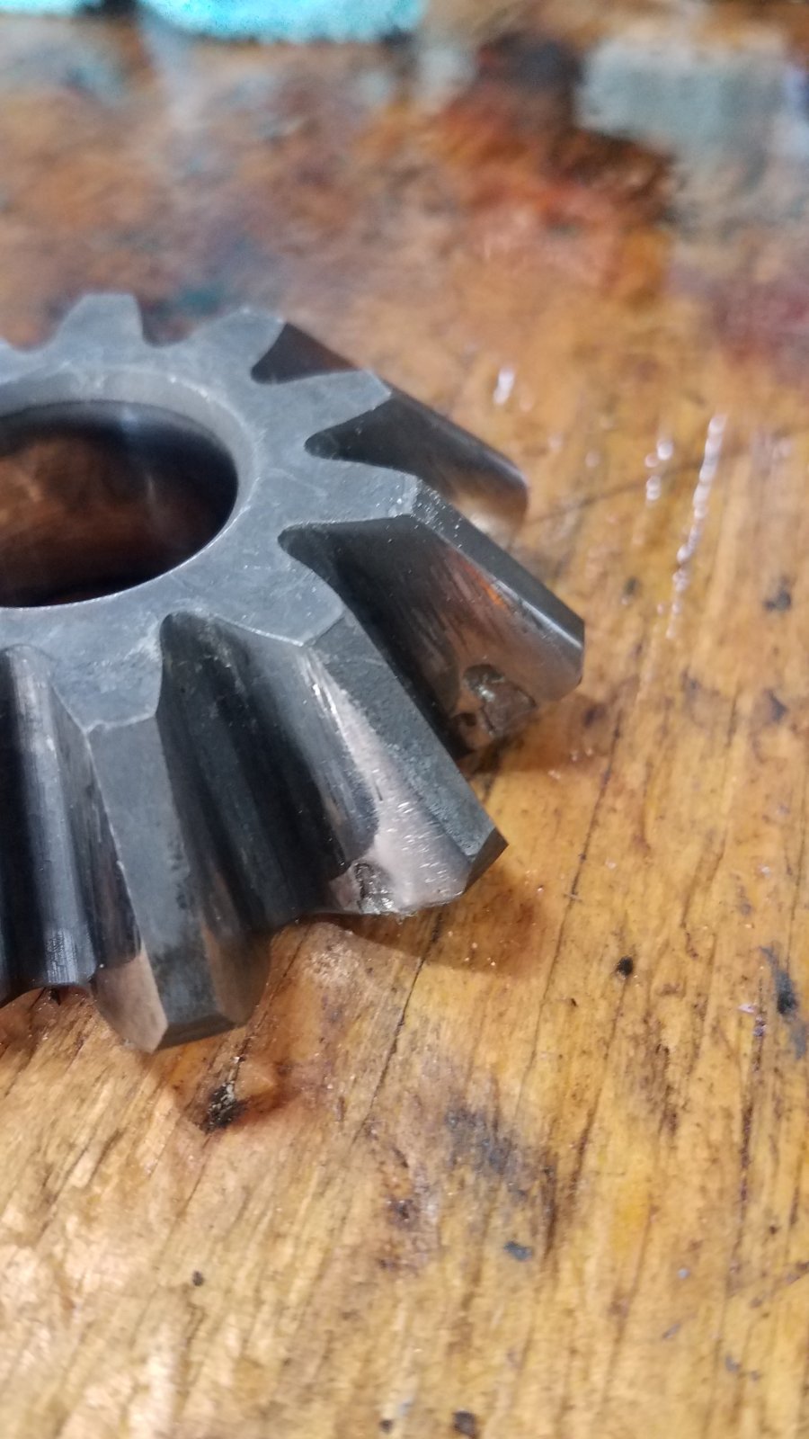

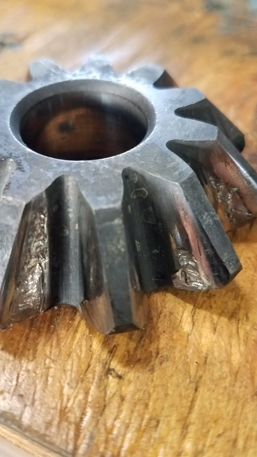

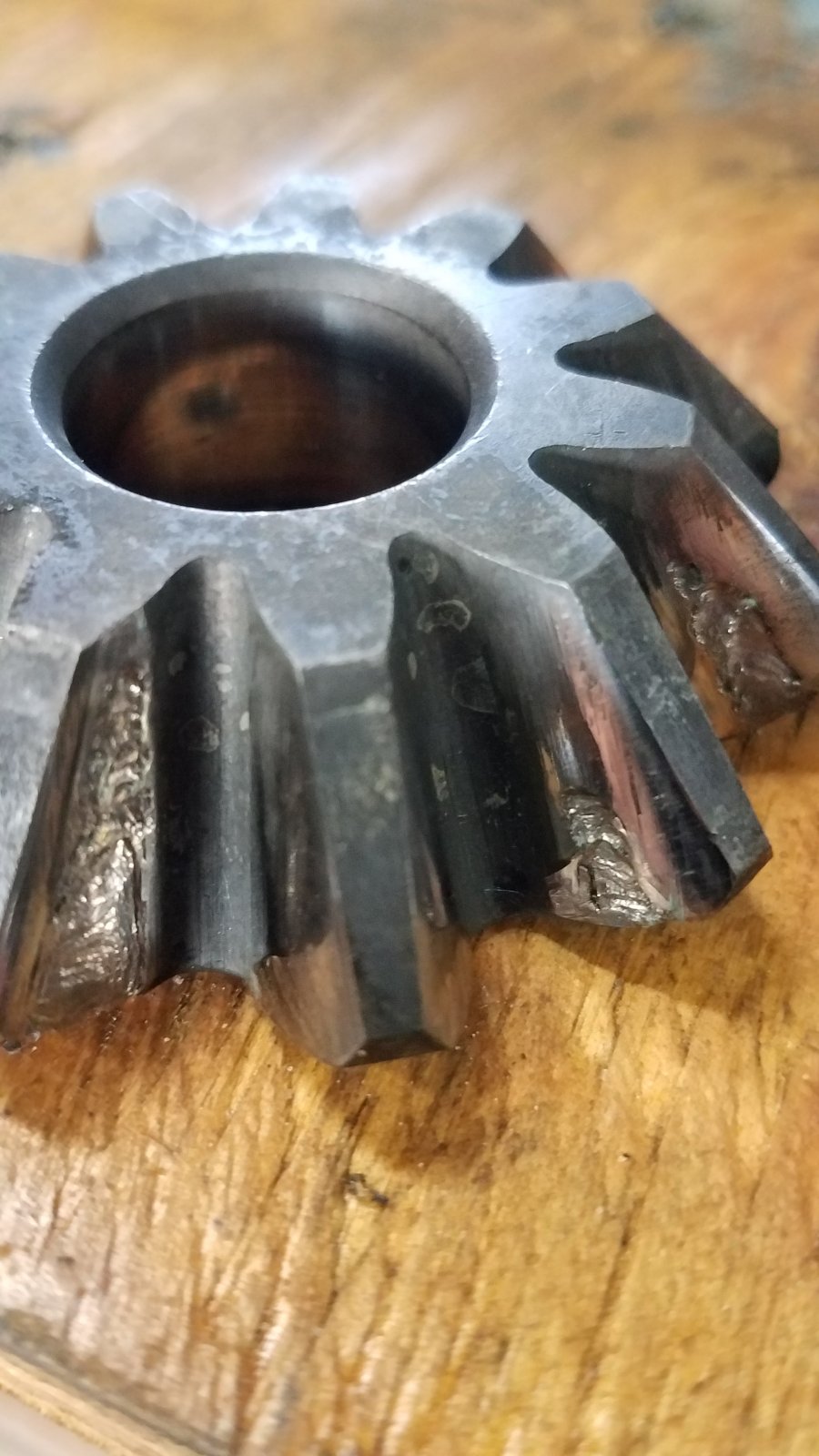

I pulled apart the carrier from my new 14b that had the markings on the spider gears. Heres some pics, they look like it could be shock load stress like @Rocket Man suggested.
Also glad I didn't plan on running these

I wonder if that could be from using the wrong fluid like that article suggested. Seems possible I guess.
I'd say very possible. Truck was a WT model and judging by the etching on the pinion someone had tampered with it. When I cracked the cover the fluid was really gross, lots of sludge and the magnet was extremely fuzzy. Nothing big enough to feel just fuzzy mush.
I wouldn't be surprised if some jack wagon grabbed whatever was on the shelf.

I think he is referring to the munched up spider gears. Saying they are shot and either scrap or could be welded up to make a Lincoln Locker.
I see that now lol. That was my fault I missed a few post.
