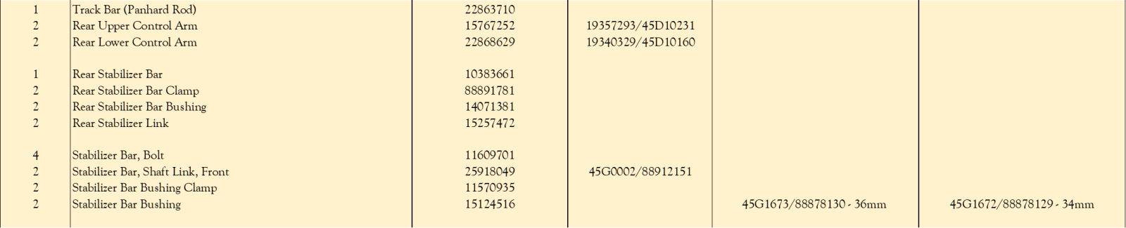

The sway bar bushings are probably due for replacement, they shrink as they age. New axle will probably have old ones still attached. Watch out for those 10mm bolts, they are same diameter as the head and break easily if rusted. PB Blaster!
Inspect the upper and lower control arm bushings and the track bar's (panhard rod) bushings as well.

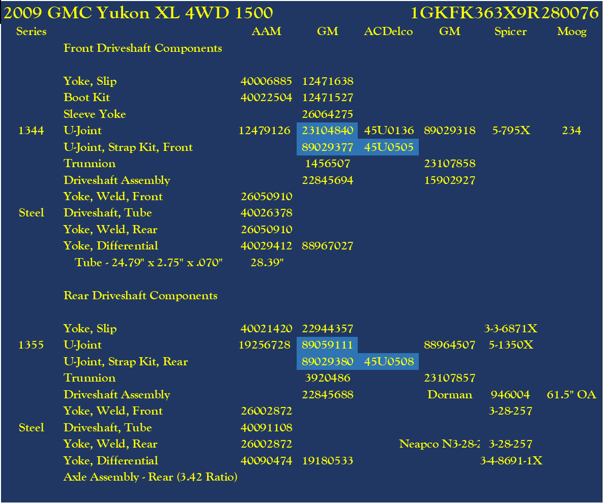

Universal joints are AAM 1355s. You can use Spicer 1350s if they come with different colored clips (snap rings) to get the fit correct.
11mm socket or wrench for the universal joint bolts.

Before ordering any parts from my list, verify the part numbers against your application. I know the short Yukons use different control arms than the longer ones for example.
