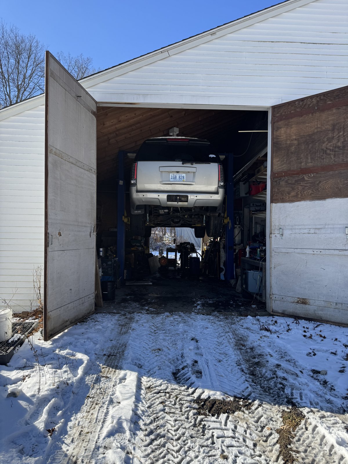

I jacked it up and put it on jack stands. I started it and put it in drive and slowly took my foot off the brake. both rear wheels spun, no locking up of any kind. I stuffed the brakes, applied them slowly, no lock up. put it back on the ground and went around the block and the left rear wheel was locking up, still.
So, my plan is simple, I already pulled the sight plug, it was about a 1/4" thick no chunks, just metal mush. The fluid is pretty close to black. I had it changed about 35000 miles ago.
But now I'm even wondering if it got done. I'm going to drain the fluid, remove the cover and inspect. (I'll take pics of the innards) I picked up A Felpro diff gasket and some blue rtv to hold it in place , 3 quarts of Valvoline 75w90 synthetic (with no modifiers added) . I found it takes 2.25 Qts. I was going to fill it till it starts oozing out. And then take it around the block and pray it's fixed. I'll report back. thanks guys!

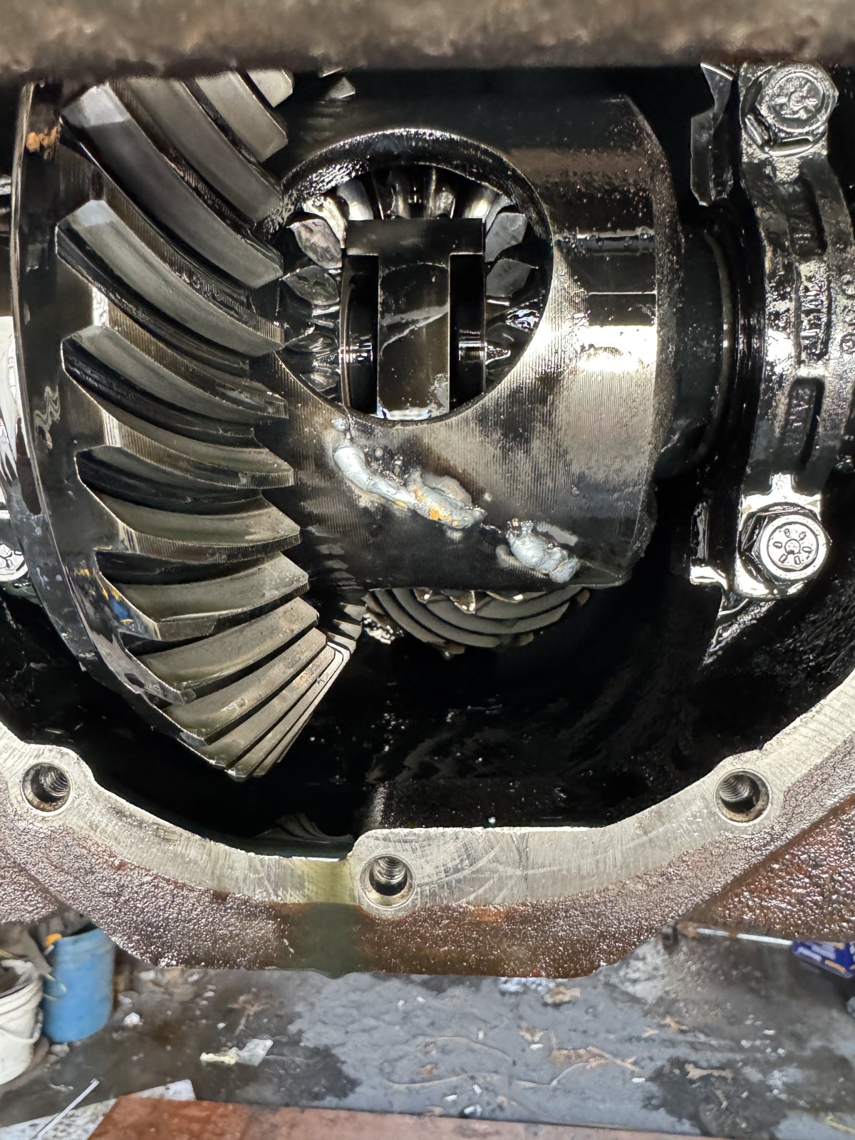

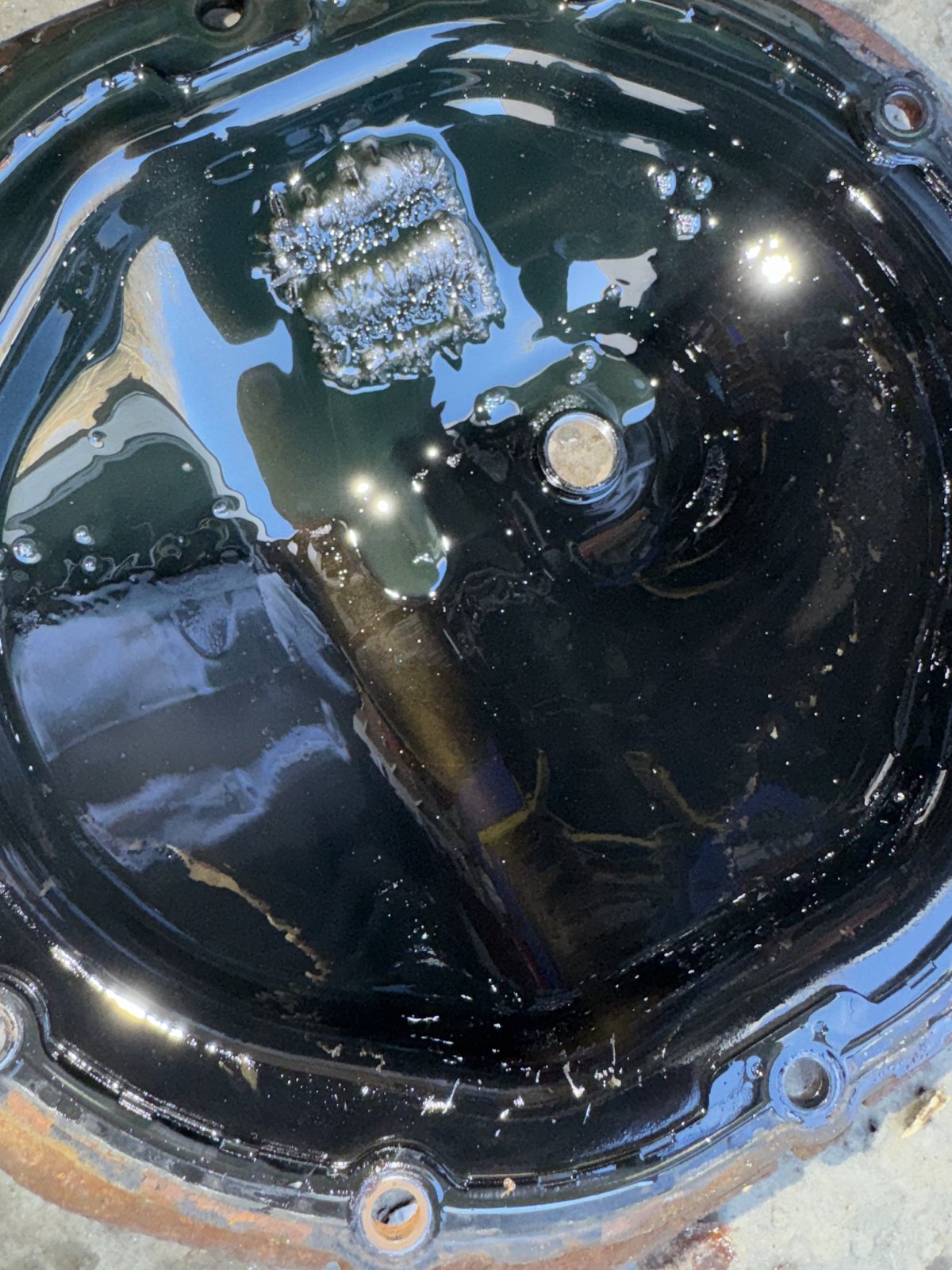

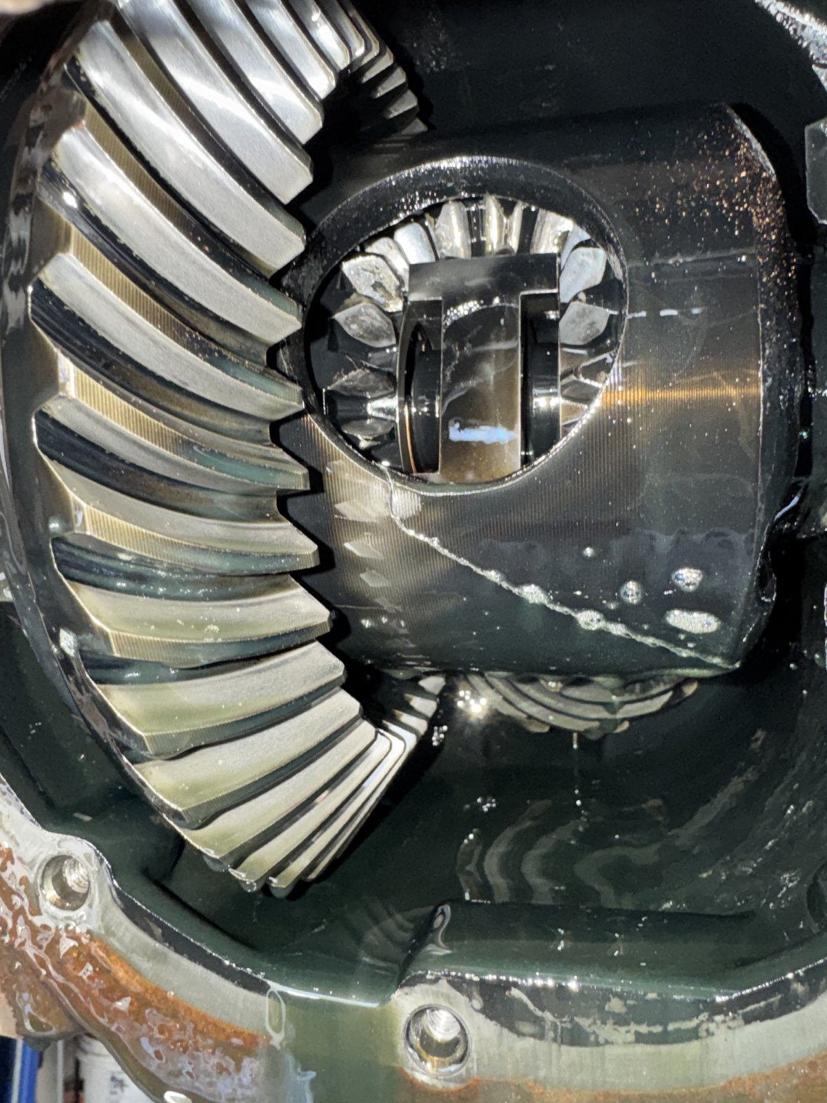

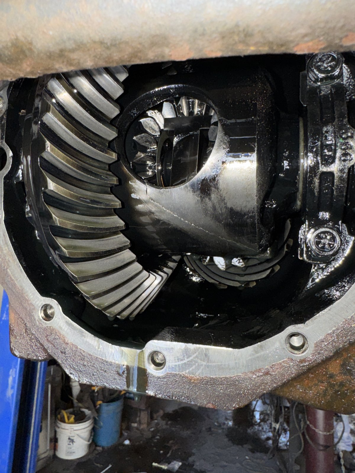

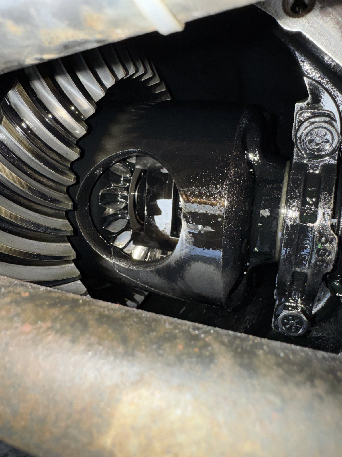

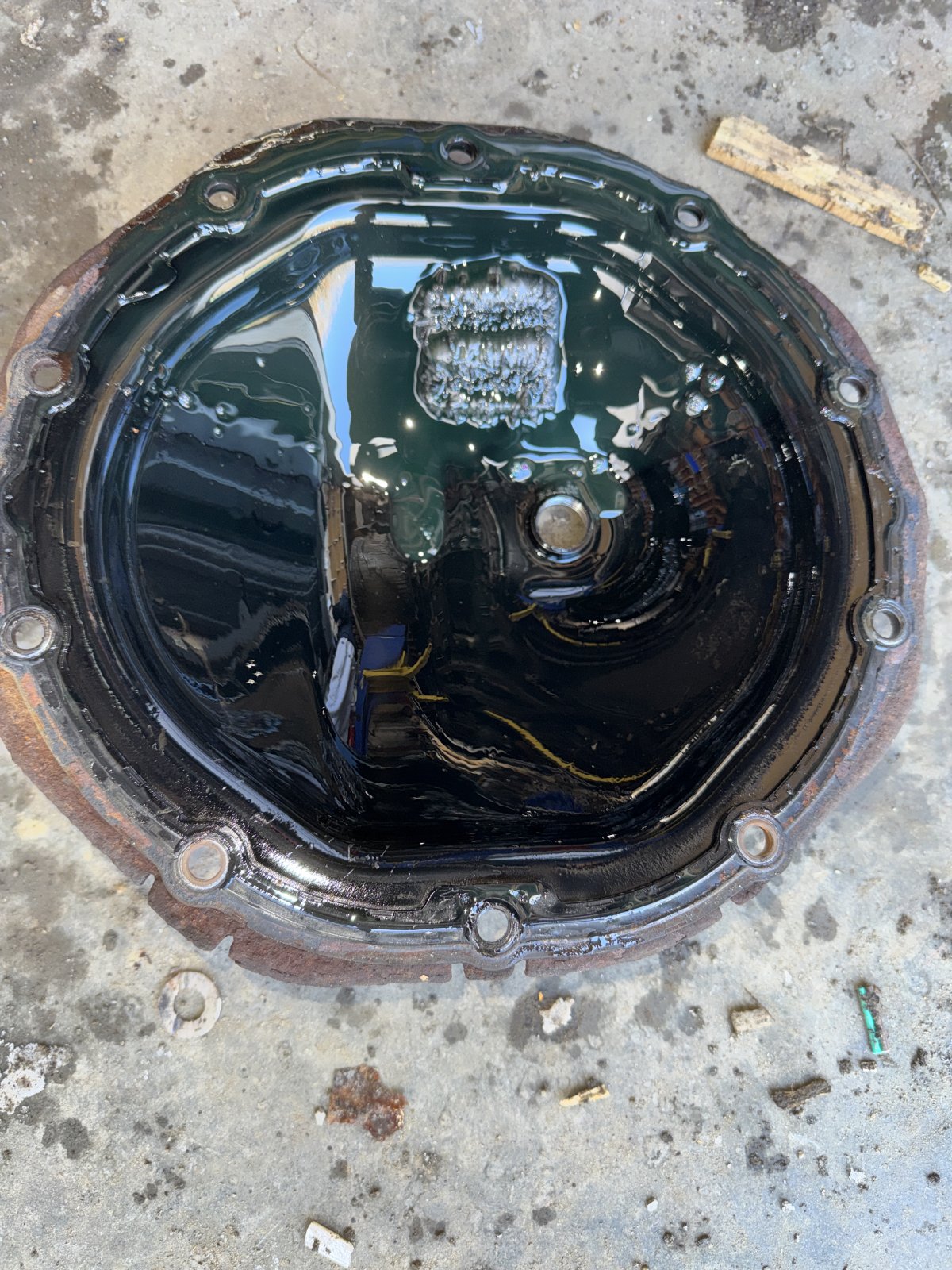

Hey fellas. Day off today, so I ventured up to my in laws. He's got a lift, and I was able to use some power tools to remove the cover and take a peek. 1st, the fluid was black, the magnet inside the cover was coated in nastiness. Worse news, appears the spider gear housing has a nice crack in it. I cleaned the inside of the cover and wiped out the diff as good as possible. once I saw the crack my heart sank. But, my father in law asked me if I wanted him to weld it. I figured it couldn't get any worse, so I let him. he tacked it in a few spots, and then on the longer flat section he put a bead. I'm not a welder, but it looks like it should hold. I only need another 6 months with this truck and then I'll be in a better position to get another vehicle. (I have 5 payments left). not sure if the weld will hold, but I drove it back home and it still seems like the left rear is locking up (kinda reminds me of a posi that kinda hops when turning left. let me know what you guys think. I had the rubber gasket on there, so I just cleaned it and put a light bead of RTV, and encircled the bolt holes. no leaks.

Hey fellas. Day off today, so I ventured up to my in laws. He's got a lift, and I was able to use some power tools to remove the cover and take a peek. 1st, the fluid was black, the magnet inside the cover was coated in nastiness. Worse news, appears the spider gear housing has a nice crack in it. I cleaned the inside of the cover and wiped out the diff as good as possible. once I saw the crack my heart sank. But, my father in law asked me if I wanted him to weld it. I figured it couldn't get any worse, so I let him. he tacked it in a few spots, and then on the longer flat section he put a bead. I'm not a welder, but it looks like it should hold. I only need another 6 months with this truck and then I'll be in a better position to get another vehicle. (I have 5 payments left). not sure if the weld will hold, but I drove it back home and it still seems like the left rear is locking up (kinda reminds me of a posi that kinda hops when turning left. let me know what you guys think. I had the rubber gasket on there, so I just cleaned it and put a light bead of RTV, and encircled the bolt holes. no leaks. View attachment 474061
DAYUMMM!!!!!

Yikes! Never seen that before. The differential carrier itself cracked...
But based on your symptoms after the welding, I'm going out on a limb, and say the cracked carrier is probably the "effect" of something wrong. Possibly spider gears seized? Not the cause. IDK?
I'm guessing you didn't try turning the wheels while it was on the lift? I bet something is seized...
oh, I turned the wheels my friend... that's when I could see some of the teeth on the spider gears were chipped a bit. but it didn't get hung up. moved smoothly. now, I'm hearing a humming noise. pitch changes with speed. so, wheel bearing most likely, or the spider gear assembly is making the noise. I've never heard of this before. I do not "beat" on the truck. My wife is trying to say that the 1 time I pulled out and the wheels spun from going over the double yellow line and then it caught traction is the reason. that's not the first time that's happened. she's trying to blame my driving, like she always does. separate issue. But I digress, it's time to start looking for another vehicle. Hard to do when you don't have any money. Hopefully I'll get that 6 months....
