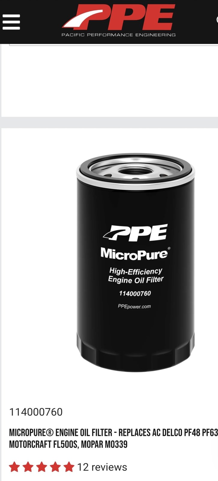

I feel like this might the best out of every filter I've tried
5w30 is what I use ow20 is nooo bueno
