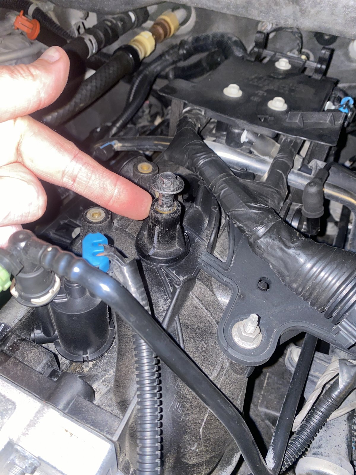

Had an issue removing the plastic cover on the top of the engine that says Vortec. The 8mm bolt that holds it down just spins and won’t come out. I did manage to get the cover off but had to tear apart the rubber bushing under the bolt. I’ve tried a couple different methods, but the bolt will not come out of the plastic pillar. I’ve seen a couple different threads on this, but can’t really seem to find an answer.
Is the plastic pillar it screws into replaceable?
Is the plastic pillar it screws into replaceable?View attachment 431922
I believe the tower is glued in place and not considered replaceable and not available. the metal insert can be removed with a puller, but finding a replacement may be another problem. The bore of the tower is already damaged by the insert rotating, as the cap screw is turned to remove and will be damaged more when the insert is pulled out. You may consider living with the condition until you have to service the engine and then replace the entire unit. In the mean time, rotate the hex and see if the insert is rotating the the tower or the if the screw is rotating in the insert. Adding a trickle of crazy glue to the joint may be enough to remove the screw. Be aware the hole in the tower will be damaged and may require a glue in or oversize replacement.

You can get a helicoil and rethread it. Take one of the other bolts (they are same size) go to hardware store and use the bolt size tool by loose fasteners in store and figure out thread size. Then go to eBay and order helicoil kit.
Or maybe some here knows the size of that bolt and its thread pitch?

If the insert is spinning in the manifold, you could carefully try squeezing the plastic with vicegrips and then try turning the bolt. But at this point there is chance (albeit a small chance) that you could break the manifold plastic. Even could crack it down to a runner. Then you would have to replace the intake anyway. Your call.
if it is stipped out then you need to apply upward pressure from under the bolt while using a high speed electric tool like a drill with a socket attached. then it should come right out
so maybe some large curved pliers with a socket under them so you can apply pressure while spinning it out.
unless that thing is totaly fubar I could have it out seconds
and if the metal insert is spinning as already mentioned then you need to apply both upward & downward pressure which could be done with the curved pliers and some kind of metal clip on the bottom of the pliers that fits around the bolt so when pressure is applied it holds the insert a little bit and gives you upward pressure at the same time.
