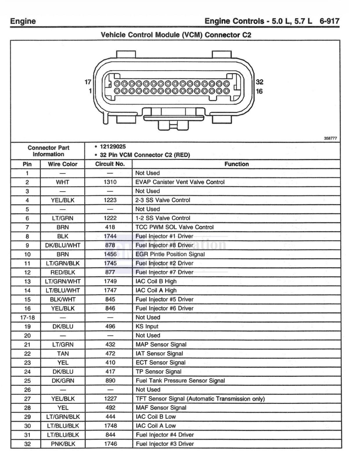

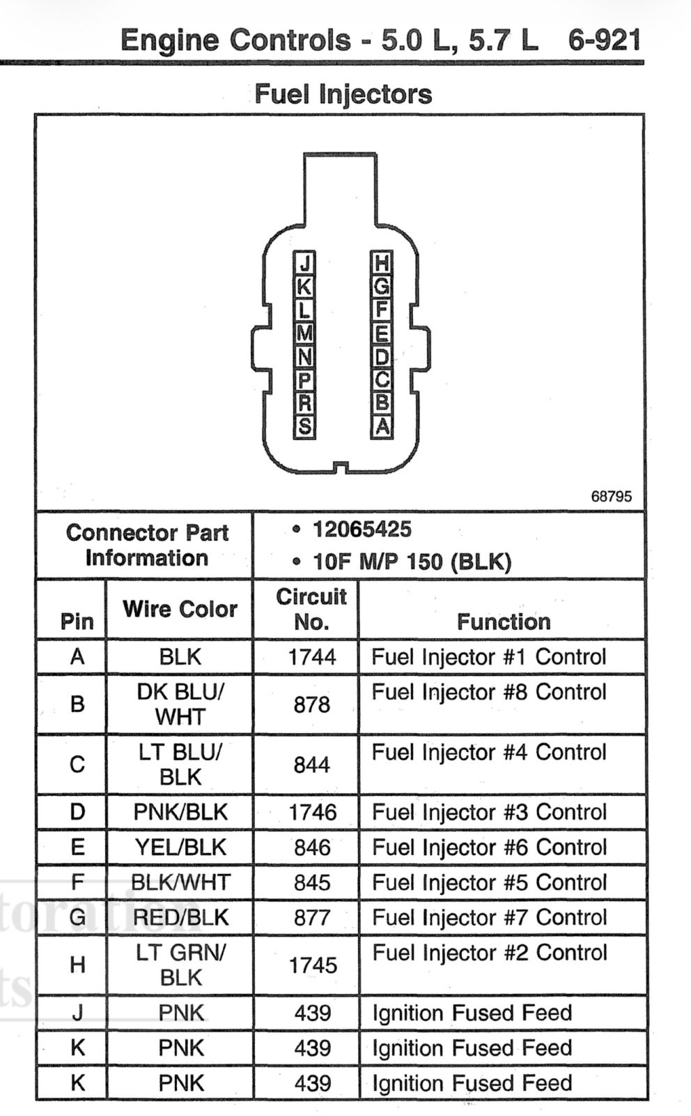

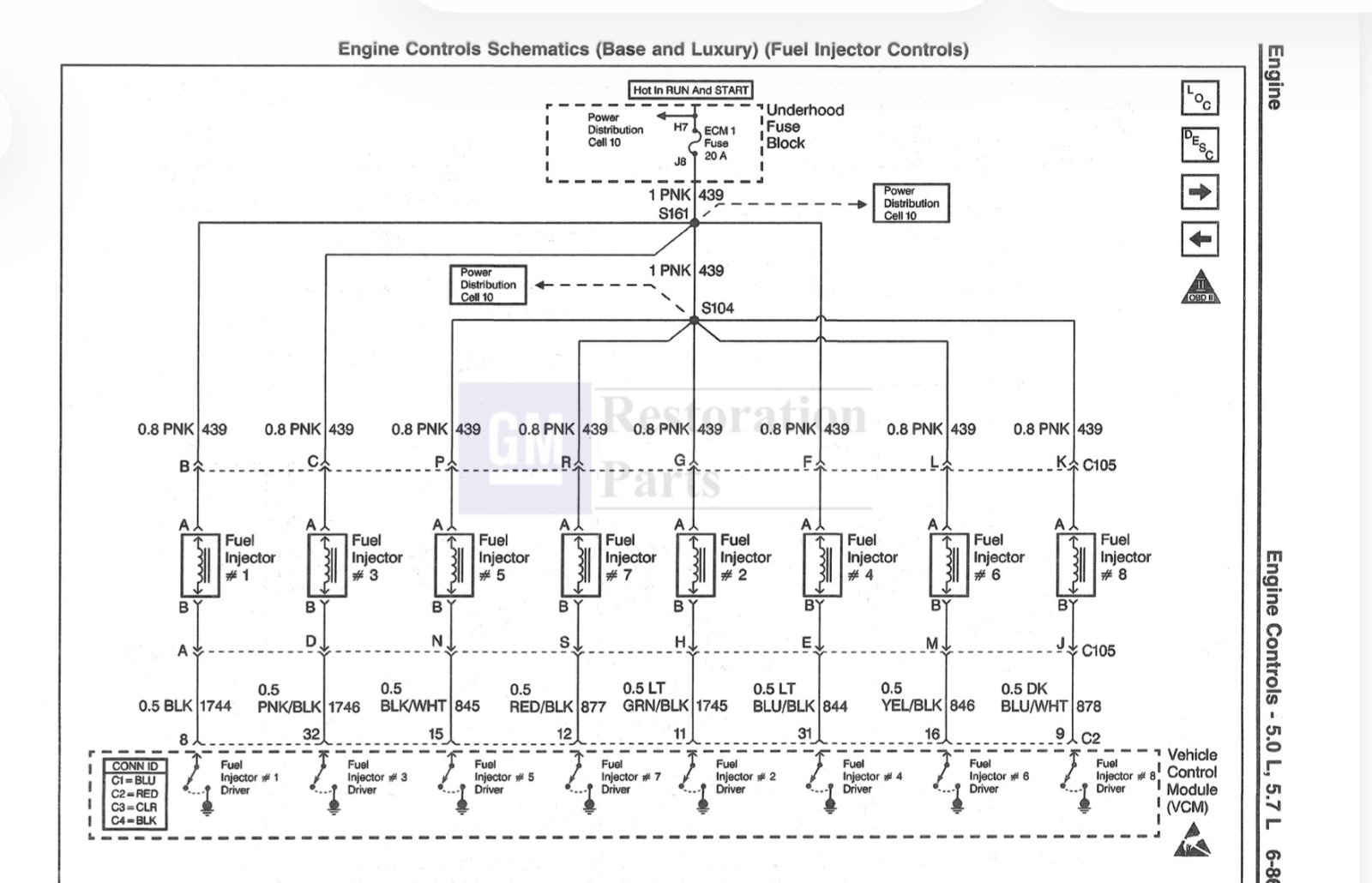

Here’s the diagram for a 99 350, the yellow/black should be for the #6 injector. To me, it sounds like it may be grounding out between the injector harness and VCM. Maybe disconnect both ends and check for continuity (one probe to a ground, the other probe to one end of the wire). Jiggle it around, if you have continuity it’s shorting to ground.
