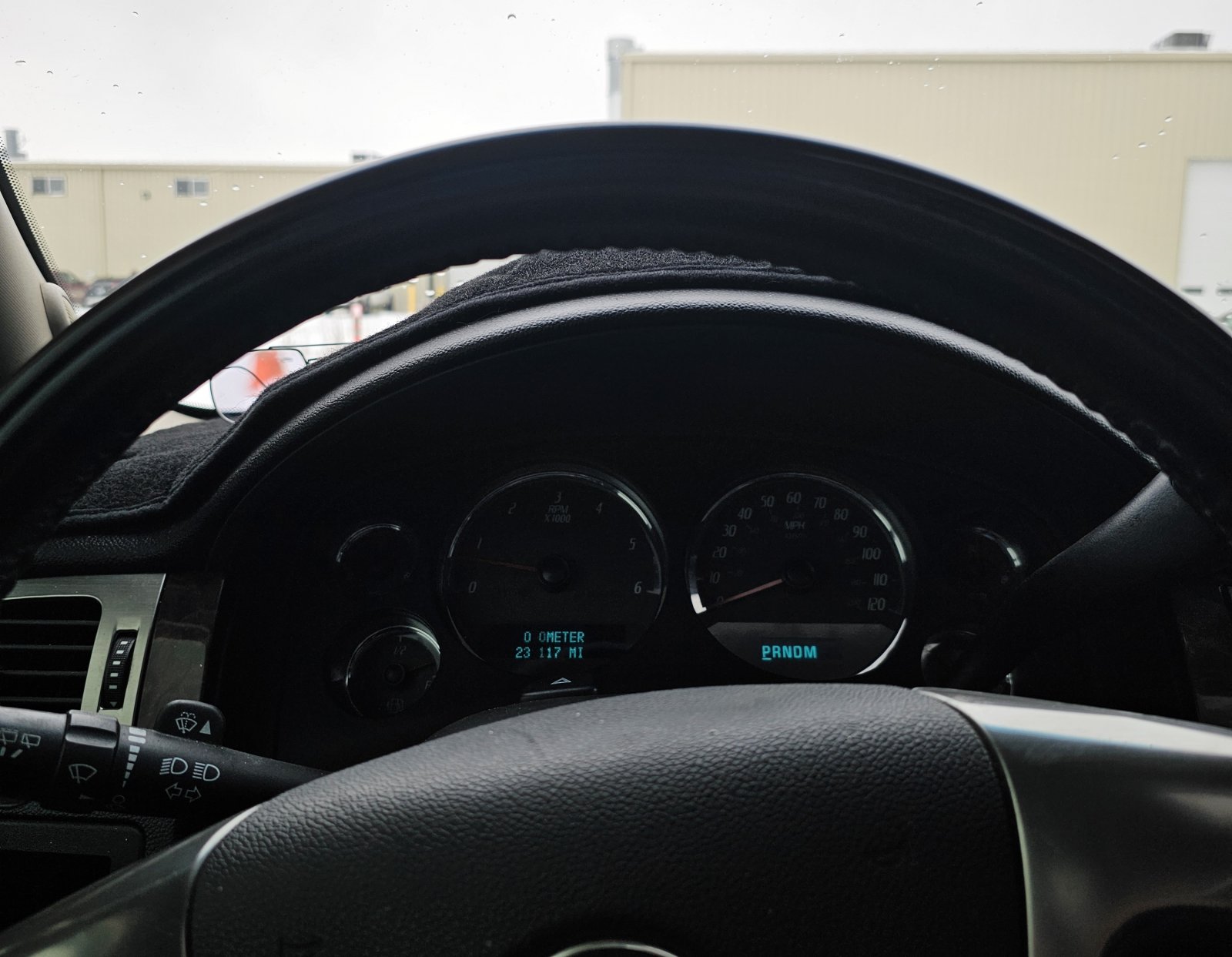

Driving my wife's 2014 Avalanche I notice the IP lights are always on during the day when lights set to auto even on bright sunny days.
The IP lights on my 2007 Yukon never are on during the day when set to auto. Normally i turn on park lights so i can see the IP during the day.
On a sunny day It's very hard to see the gauges and speedo. Here is a pic i took today around noon with truck running i took of the IP.
Is this normal for an 07 IP and later changed to always on in later years?
View attachment 449396View attachment 449397
That’s caused by a failed light sensor on top of the dash. There are some videos out there about it.

Been wondering about that sensor.
The only reason I have not replaced it is that the headlights do work automatically, leading me to think the sensor works as it should.
I was wrong… It’s a mod
