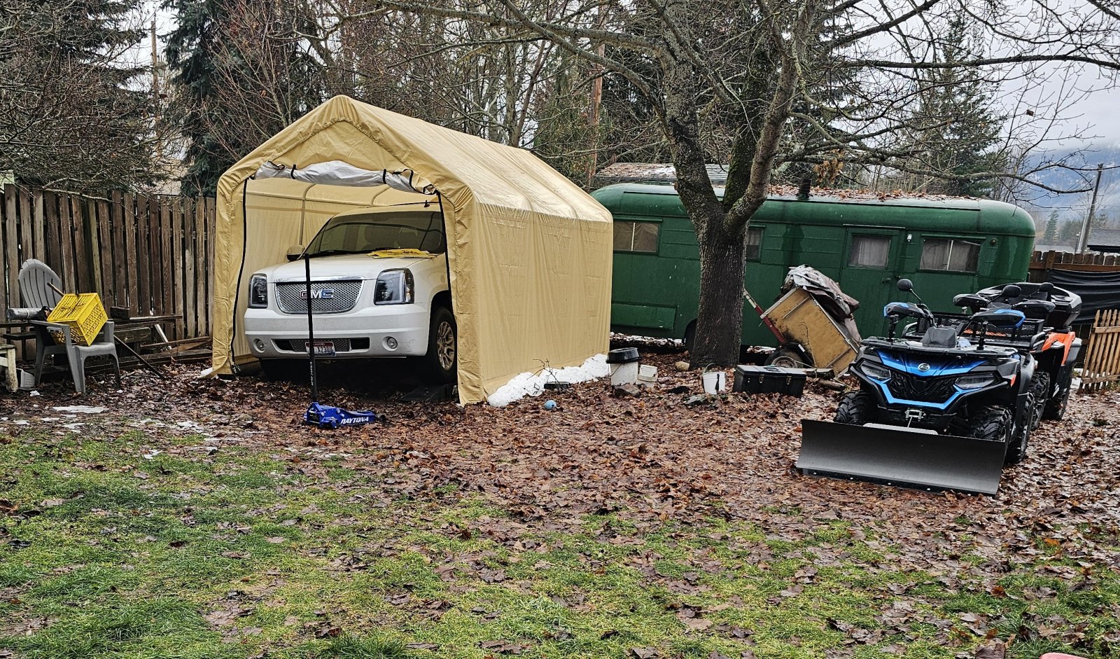

This time of year doing this work really 5uck5 though. Cold, Damp and breezy.
Had to put it in the quad shed to get mostly out of the weather

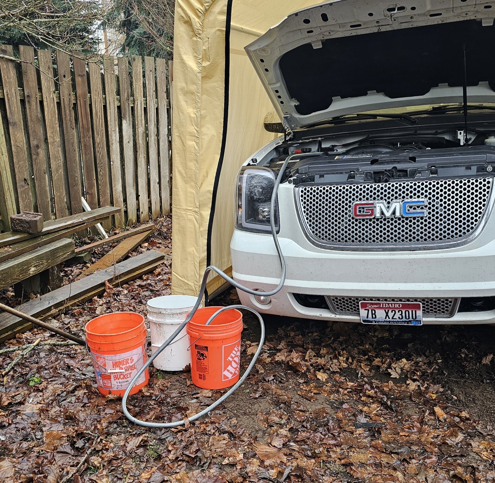

Used a Schrader valve hookup and buckets to get that tank empty using the fuel pump jumped at the relay.
Have no idea why i used 5 gallon buckets. I have 4 empty 5 gallon gas jugs in the garden shed.
