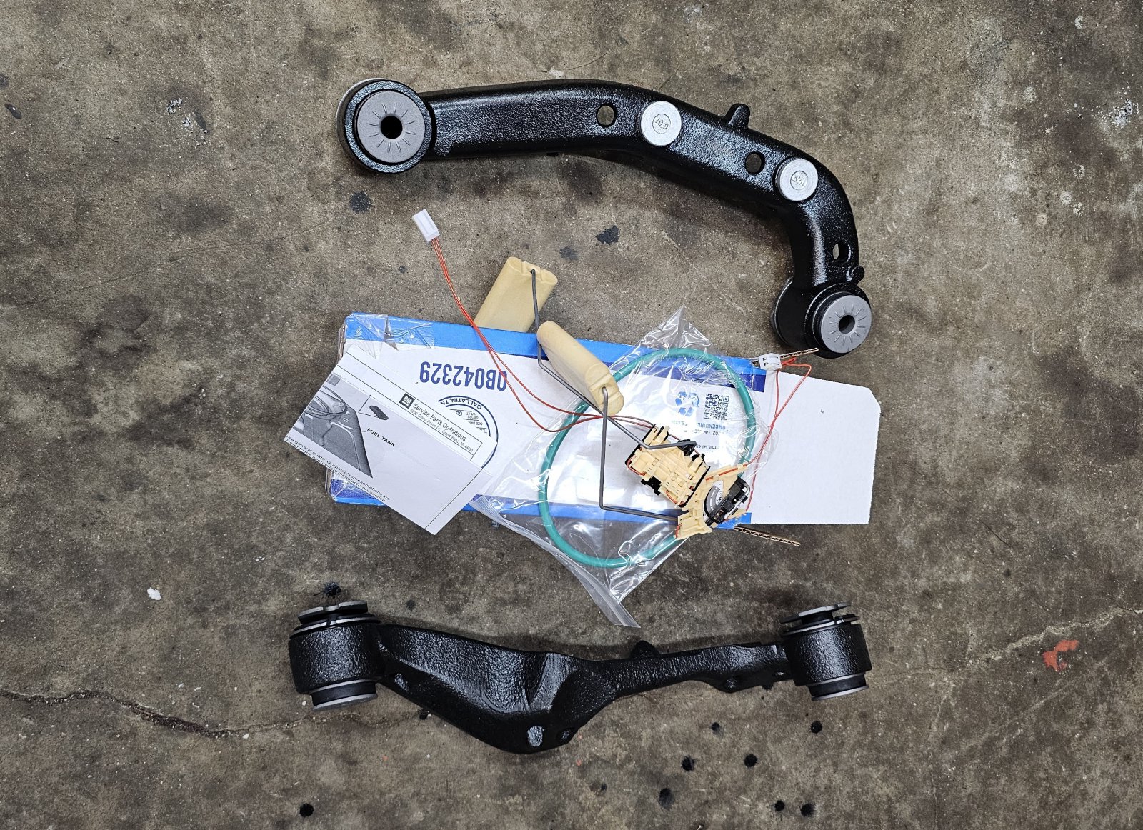

I think what happened is. I was driving down the trail and hit a hole in the road that was hidden by weeds and naturally the strut pushed the wheel down to full extension before hitting the ground again.
Because the RC upper control arm did not hit the bump stop i think the spring pressure slamming down damaged the threads.
It took about 5 minutes before i could tell anything was wrong but by then it was too late anyway.
I don't know if it's normal or not but with the RC upper control arm it lets the suspension hang down about an inch below the strut then comes in contact with the bump stop when the lower strut is unbolted.
I think i need to get new upper control arms. I think the suspension should hit the bump stop before the strut bottoms out.

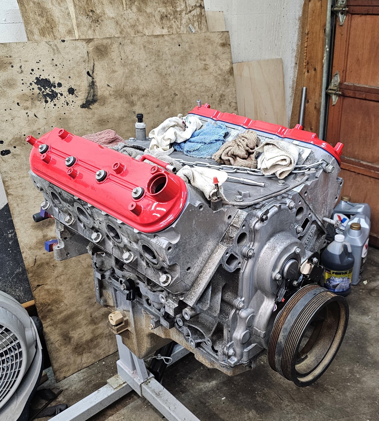

Continuing with my replacement engine i finally have the cam back in it and a new Melling timing chain, cam phaser, GM actuator bolt and Dorman tensioner.
I thought about doing a VVT delete but decided against it. For one, I'm not out for all out performance and the VVT is not a bad thing for my situation. 99% of the time just normal everyday driving.
My stock cam is fine and with new cam bearings i should not have any problems for a long time + saving the cost of a new cam and a tune saves around 1K.
I will be getting a BB tune after i install this engine. BB is only about 40 miles from me.

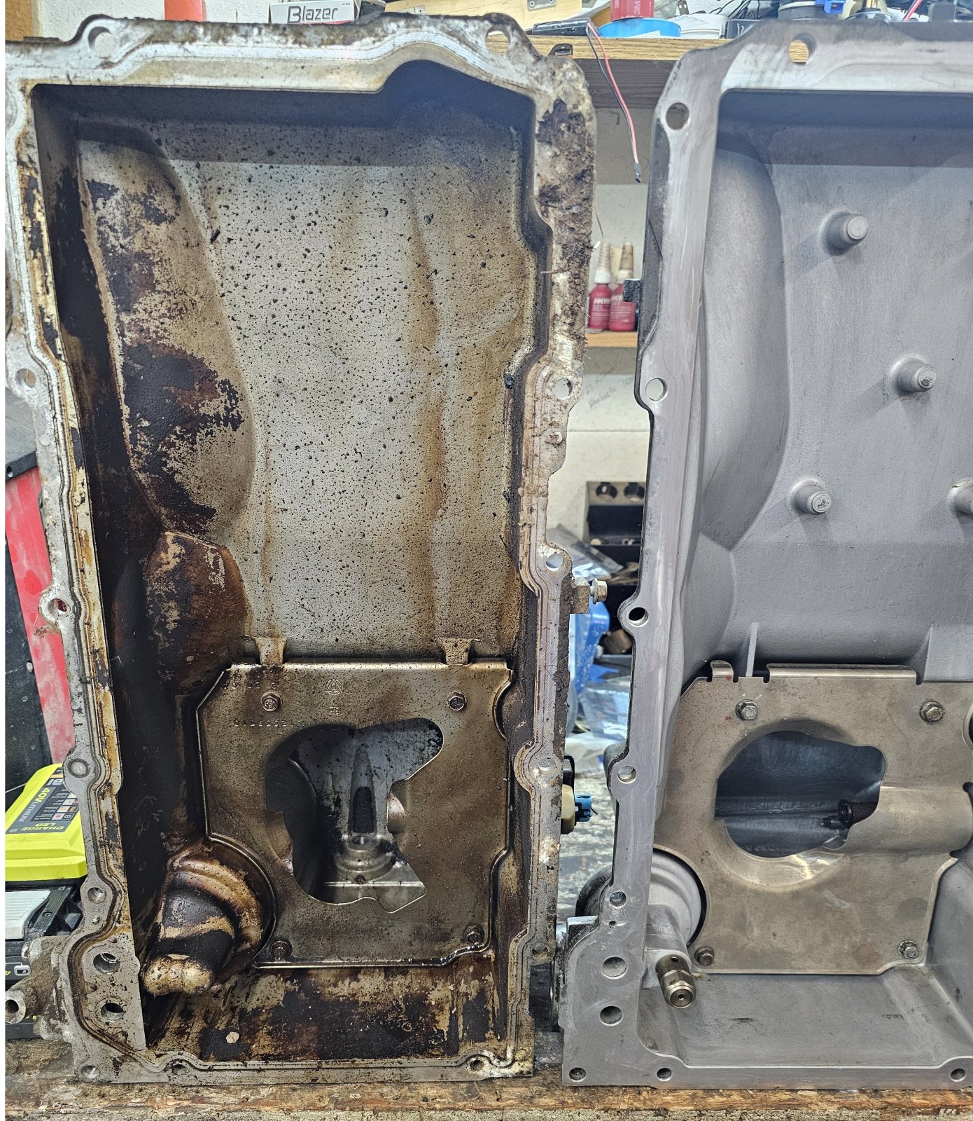

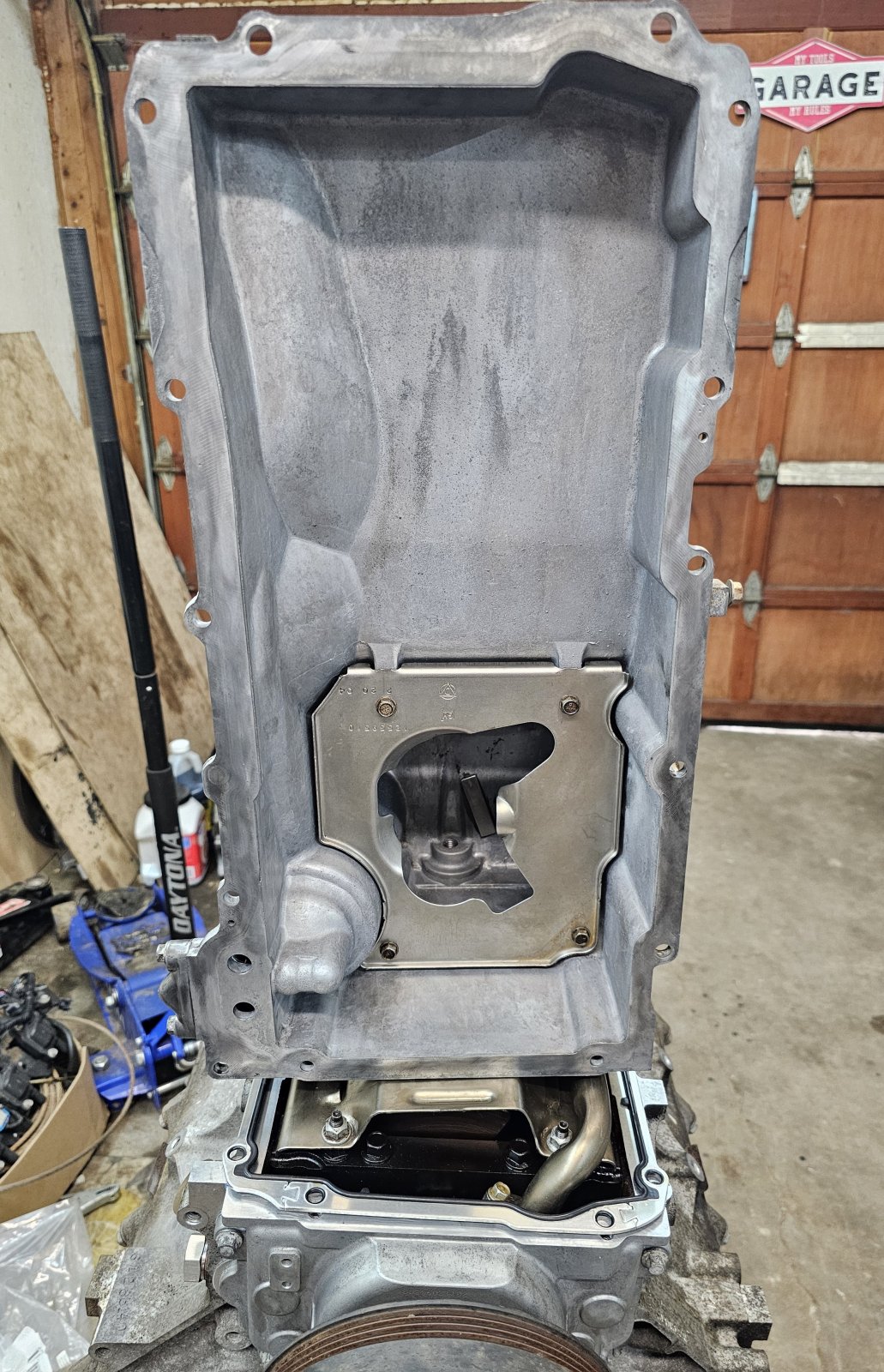

Debating on what oil pan to use. I have read a lot about that valve.
Most people say it's there for AFM and really has nothing to do with VVT as some engines with VVT did not have the valve.
Seems there is not a definitive answer when keeping VVT.

Keep in mind the VVT requires oil pressure and volume, so GM had to create a sort of balancing act to serve both functions. Your VVT will be happier with all the oil pressure and volume you can give it.

I did read that it is to protect the AFM stuff. When the solenoids close there is a pressure surge and the valve fixes that.
I think im putting it back together with the stock oil pump and no valve.

Looks good!
Grab yourself one of the oil pick up tube girdles that uses both holes in the oil pump. Under $20.

Got the spare engine pretty much ready to be installed. I want to get the engine swapped before October.
I'll probably have to do it all my self, so im not looking forward to doing it but sure will if i have to!

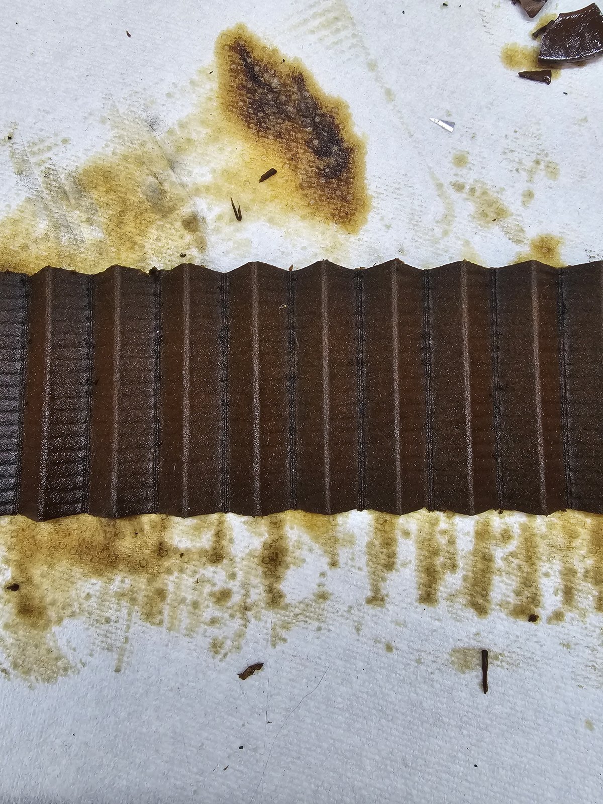

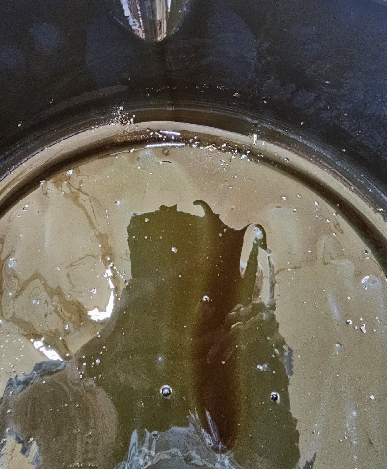

Changed the oil today after running R&P for about 3k.
The oil filter had 7 small specks of metal in it. The oil pan had a bunch and the filter also had some flushed out sledge in it. Noting like the first oil change shows post#31.
I had a strong magnet on this filter the entire time i had the R&P in it and it had nothing on the inside where the magnet was.
From the lack of junk in the filter, I suspect the metal is still flushing out from the original oil change and sludge at the bottom of the pan when i first got it. You can see in the bottom of the pleats the sludge im talking about.
My oil pressure has remained constant since i changed the oil pump and O ring, 23psi hot and 70psi cold.
