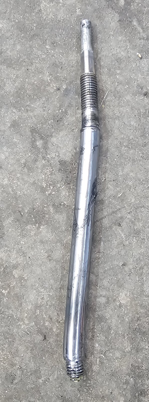

It's about time to get back to the used replacement engine i bought.

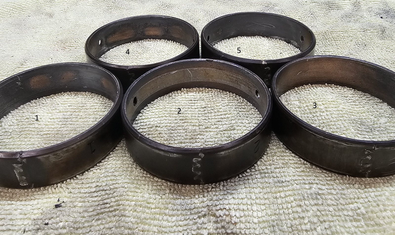

I have been collecting parts to freshen up a few things over the winter, one of them is new cam bearings.
Got the old bearings out and #2 is shot with the rest not great either but at 170K i would not expect them to be.

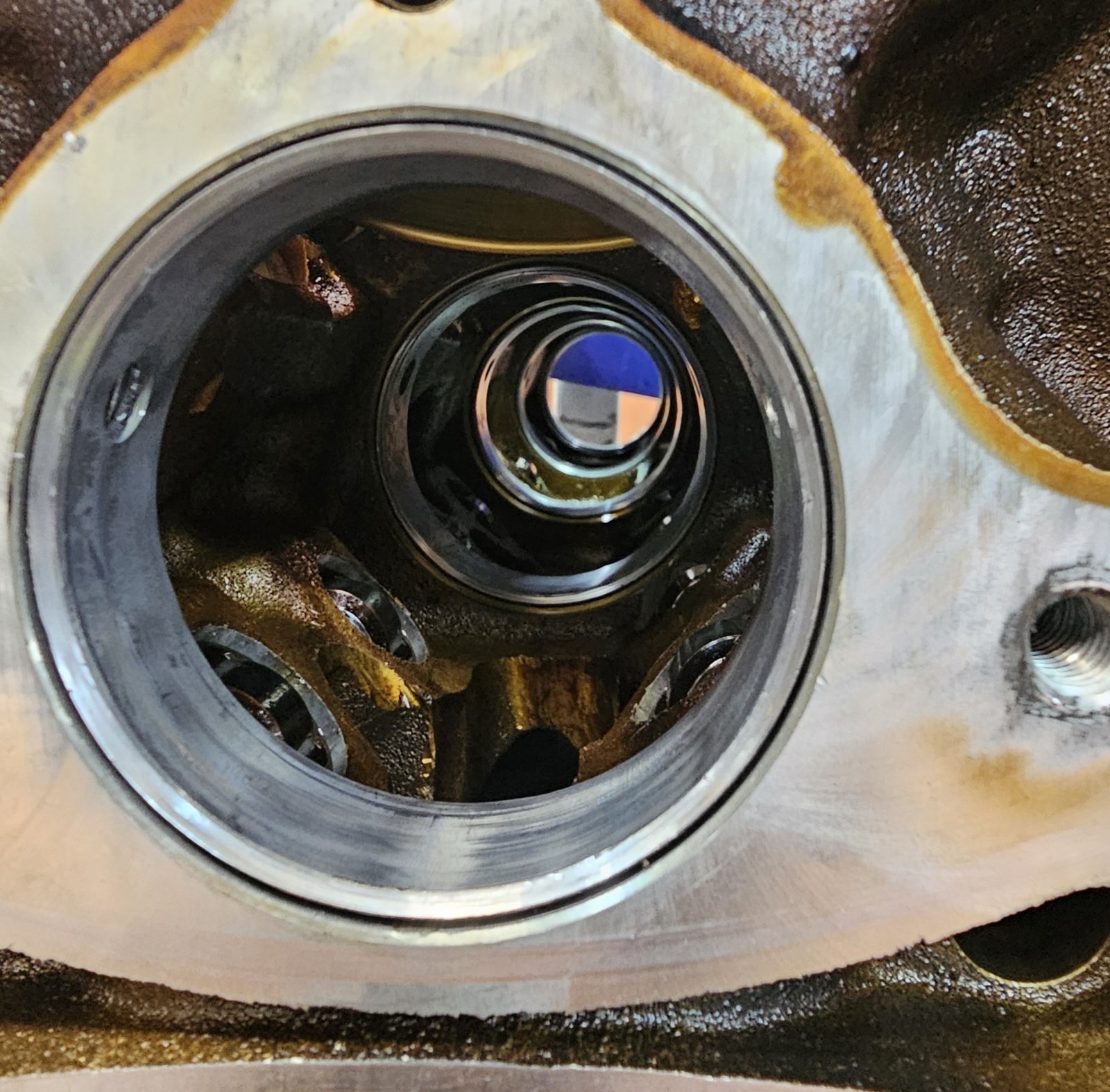

1 thing i notice i don't really like is the spot where the original bearing is joined together leaves a gouge in the block. There is no way to avoid it and all 5 now have this gouge.
After seeing why that gouge is made removing the bearings i would think all engines with replaced bearings have this gouge.
I sure it will not matter, but dang GM could have done a better design i think.

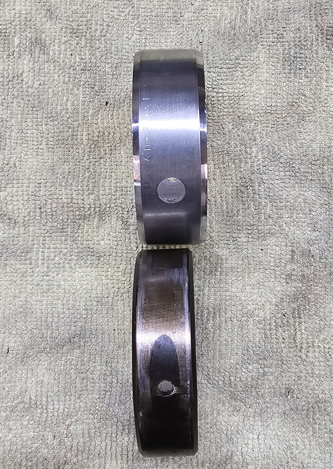

The new CH25 bearings are better 1 piece solid design. They are wider by about .20, The oil holes are bigger which is better allowing more oil to get to the cam but how it affects oil pressure who knows.
