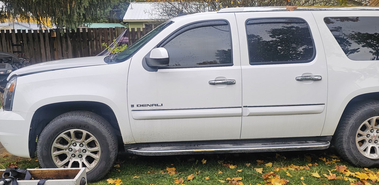

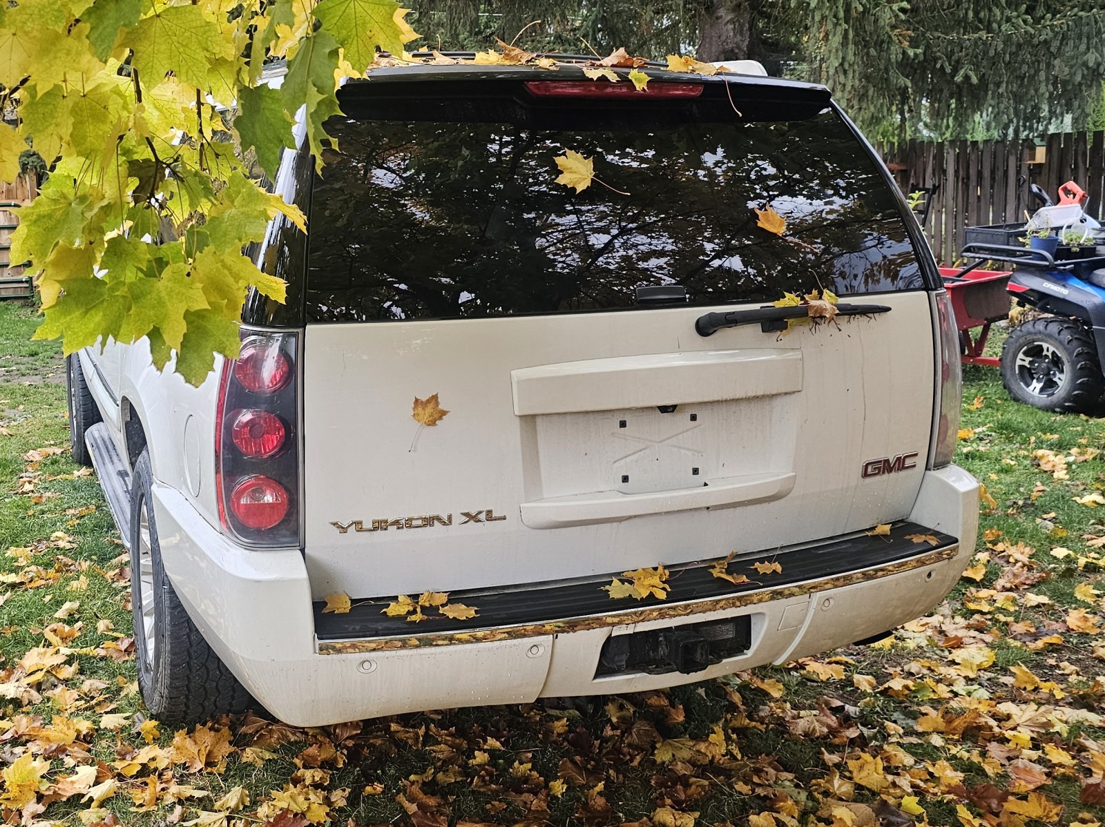

Welcome to the forum!! Hopefully you can get it all sorted out! Sounds like you got a nice rig! The rear air assist shocks are crazy simple to change out and the replacement air assist Z55 shocks are fairly inexpensive these days compared to what they used to go for. They ride really nice on the correct suspension parts. Post some pics of the truck when you get a chance…. We love pics around here lol.

Also i did not notice it but there is a small little ding above the passenger front time and the driver seat has a small tear where most do.
