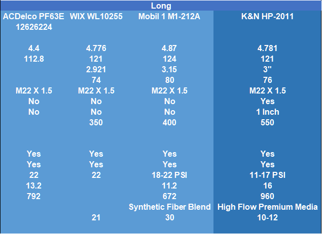

I'm at the point that I need to change the oil and filter. What is the difference from a AC PF63 and a PF63E ? And is that the right oil filter, or is there a better choice ? Thank you !
The former are out of production. The Wix WL10255 is better than ACDelco's latest offering but better yet IMO is the K&N, which is what I run in mine. Love the 1" nut for removal.

Prior research I had done showed me that Purolator Pure 1, Wix, M1, and K&N were all basically equal.
The guys on "BITOG" tell me that the Ultra does a better job of filtering smaller microns than the M1 extended performance filters I currently run.
The ultra uses a synthetic media vs the paper in the M1.
The K&N is extremely hard to argue with, due to the nut on the bottom, when the filter is in the factory location. On my remote mount it really isn't an issue to get your hands on the filters though.

My baby gets the K&Ns! Statistics wise, it is tops, lower micron rating, higher burst pressure, higher flow rate, etc. And that nut, love the nut!
