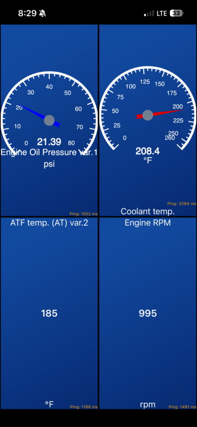

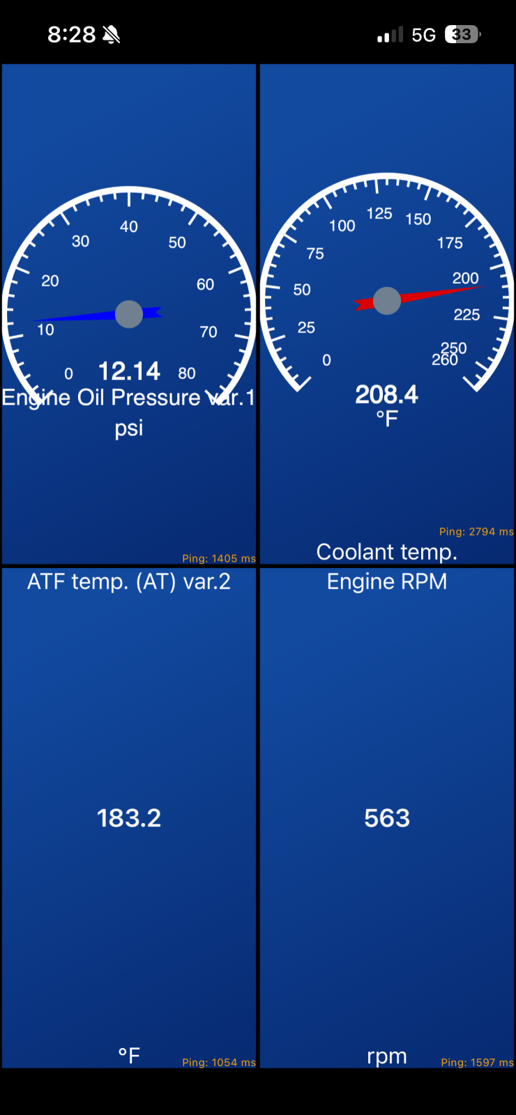

IMO, anything below 20 psi at hot idle is too low. I concur with the folks above to file a claim with Jasper now and follow their instructions.

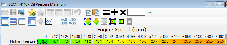

10 psi is the trigger for low oil pressure, technically 12 I would say is questionable, normally 14 is what you might see at hot idle.

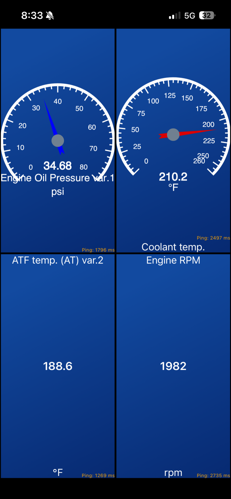

cold idle mines goes a little bit over 40...hot idle I would say in the 30s..
I have noticed the longer I go without changing the oil the lower the oil pressure gets as I drive. But soon as I change the oil and filter the oil pressure gets better... I usually go by the oil percentage to change my oil but others change every 3k
Cold idle was nearly 55psi today. Historically I change my oil every 5k on all my cars and run a blackstone every 20-25k or so.
Thats a really big difference to 10 psi hot...
