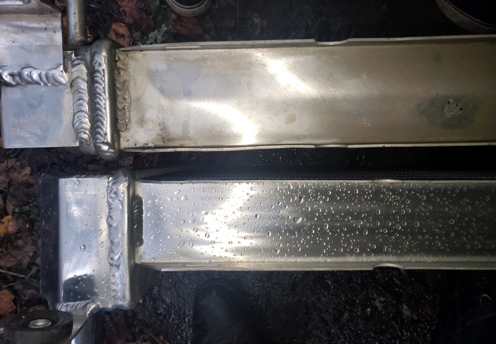

I ended up getting a warranty replacement for the original and it indeed has been updated and the new one bolted right in without any modifications.
I did notice that the core on the newer version is not quite as thick as the original version as seen in this pic...
Original design on top, newer version on the bottom... still thicker than stock though.
The tanks appear to be larger though.

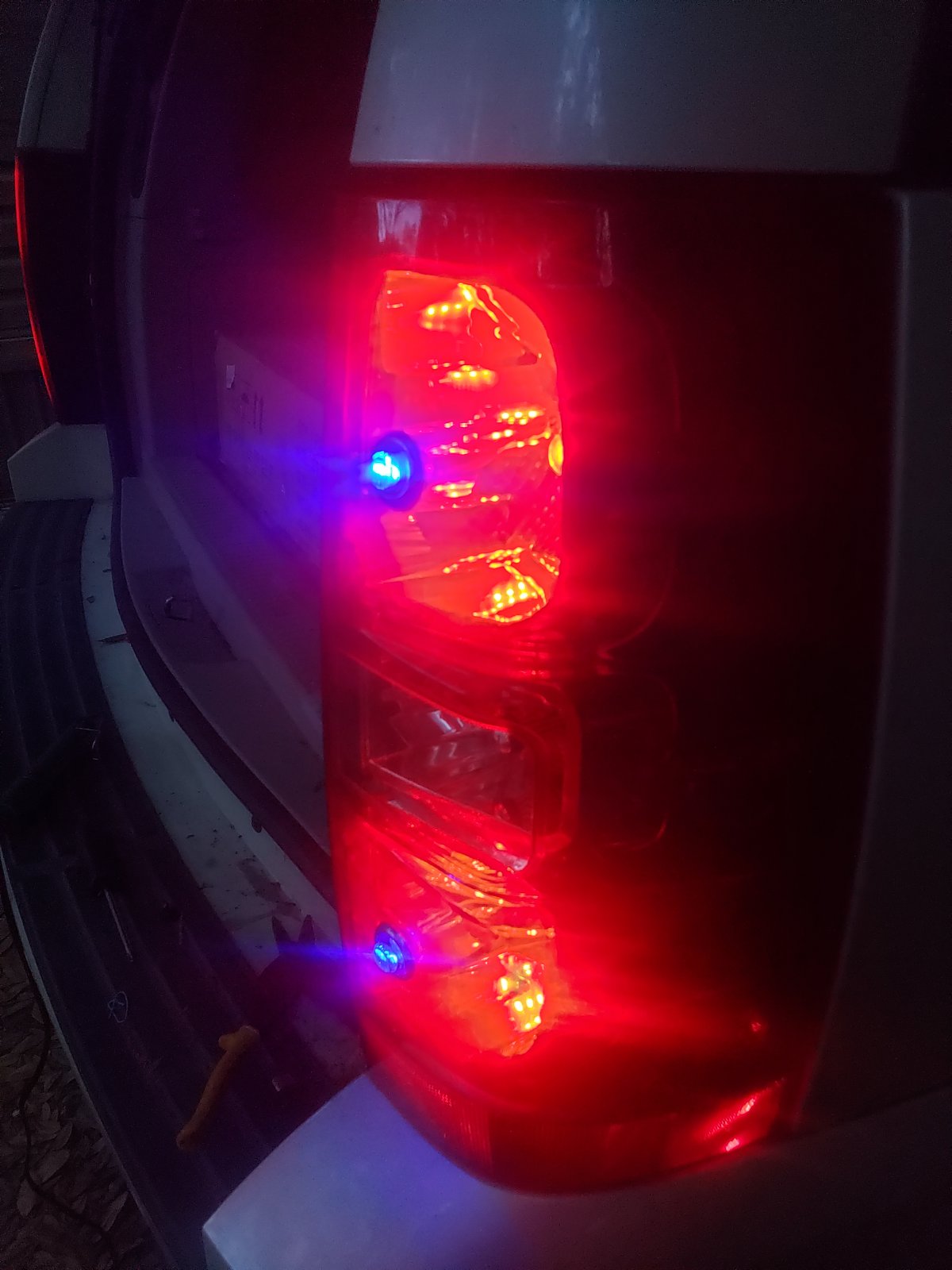

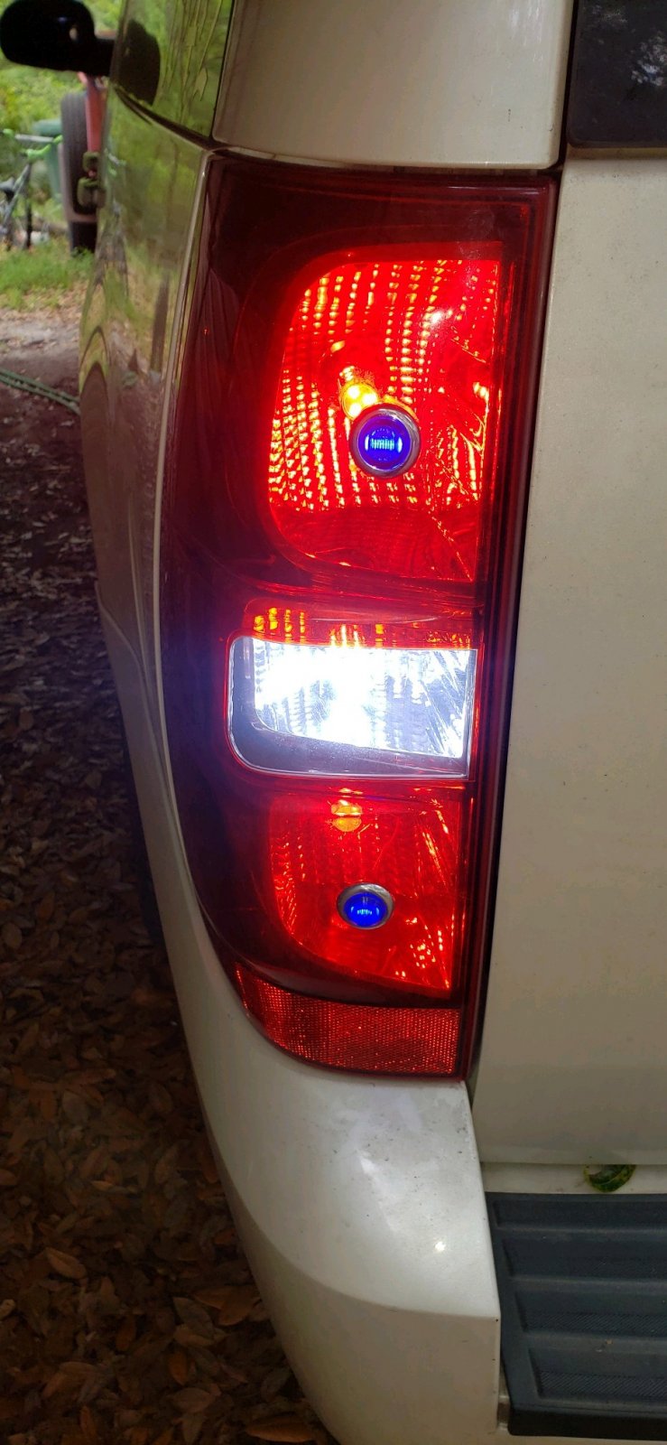

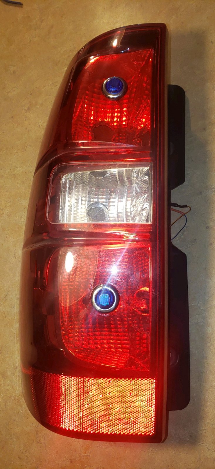

It has been quite a while since I have updated this thread.
I tried to get some decent pics of this mod but it is extremely difficult due to LEDs being so bright.
How many of you old timers remember Blue Dot tail lights???
I have always been a sucker for old school stuff, born in the wrong era I guess... lol
Anyway, you can't run a traditional Blue Dot with an LED behind it because it won't give you that purple haze look that a traditional filament style incandescent bulb gives you. I wasn't willing to give up my LED bulbs so I decided to make my version of 21st century Blue Dots and put them in the Burb.
Since I can't leave well enough alone I made them half bright on the parking/running lights and made them full brightness on the brake light mode so it gives it the full effect.

Damn that 3rd light bar is trick!

When we go to Jax in July, I'll be looking for purple tails now! LOL

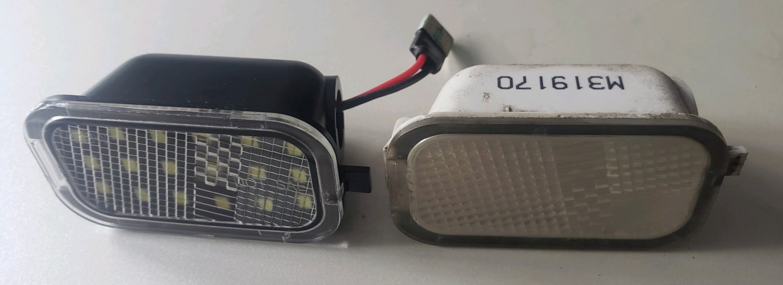

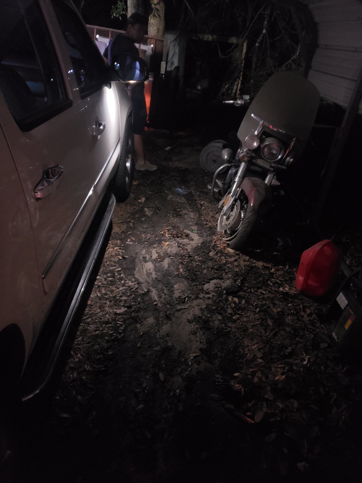

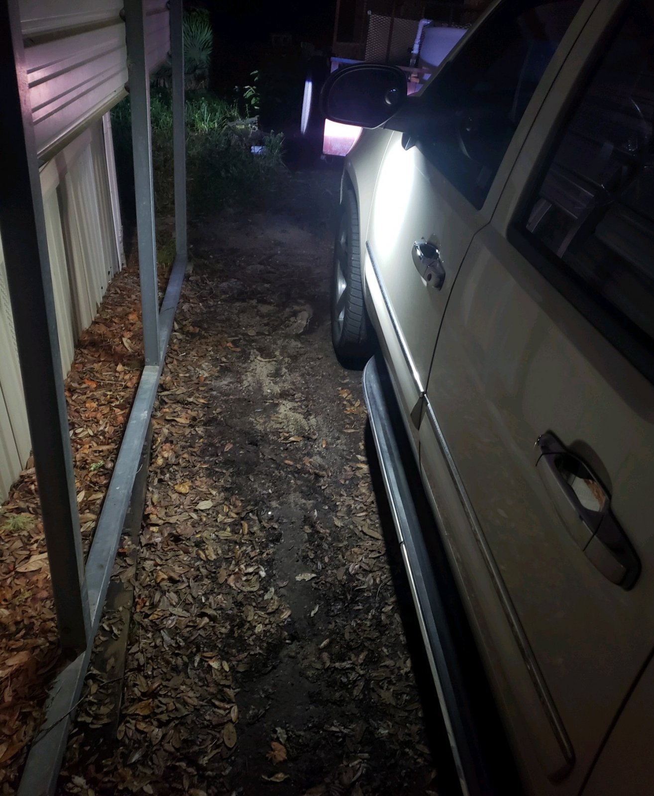

Finally broke down and bought the upgraded LED puddle lights I have had my eyes on for a while. I found these after upgrading the tag lights to a similar style replacement.
The camera seems to pick up a lot more light than what is visible to the naked eye so the old LED bulbs I had in the original housings seem way brighter on camera than in real life.
While the upgraded LED 194 bulbs I had in the original puddle lights were an improvement over the factory incandescent bulbs they are no where near as bright as the new ones.
New on left, original on right
Original with single LED 194 bulb
New LED "pod" style
