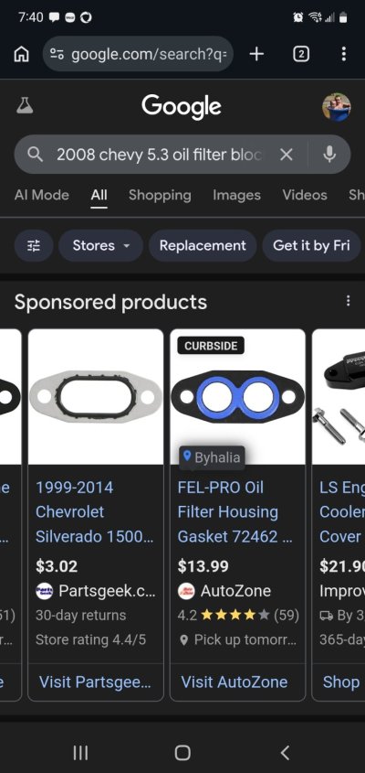

As said above. Oil filter cooler adapter relocation plate.

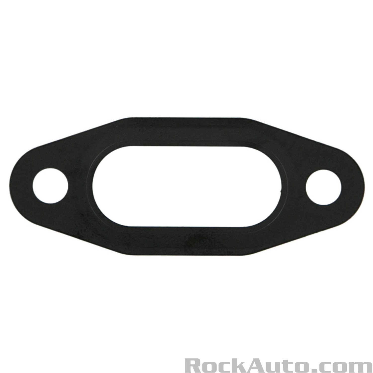

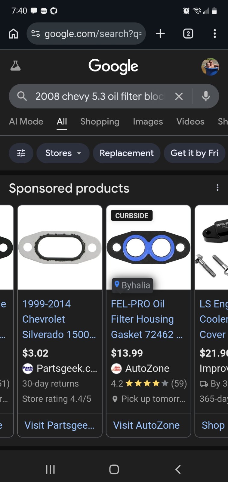

It does matter. You need to match the gasket to the part that bolts on.
So all I have connected is a flat block off plate that bolts on, so the large oblong circumference gasket might do it?
The gaskets shown appear to have a raised seal which I assume would not need sealant.
The one with two holes in the middle looks like what RA calls GM Genuine that also has rubber seals arounf the bolt holes.
There is a FelPro paper or fiber gasket (attached picture) that I would assume would benefit from sealant.

I just googled 08 5.3 oil cooler block off plate gasket. Then took a pic of what came up.

The gasket shown in Post 9 is the right one for you and yes they have a bump pressed into the gasket around the sealing ports. When you tighten your bolts that crushes and gives you a seal. I have a couple that are hard to seal and kept leaking. Now when I do one I take 2 of the gaskets and use them, have the bumps opposing each other so it doubles the amount of crush. Then as Spare Parts already said coat them very lightly with The Right Stuff and install. It will never leak again.
Some guys buy the new thicker block off plate to cure this leak. You don't have to if you if you try the fix above. DO NOT USE EXCESS The Right Stuff, all you need is a thin film, any extra might form clumps that end up in your oiling system where they can cause trouble.
