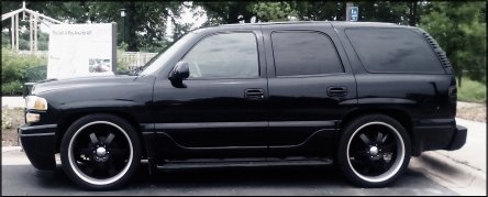

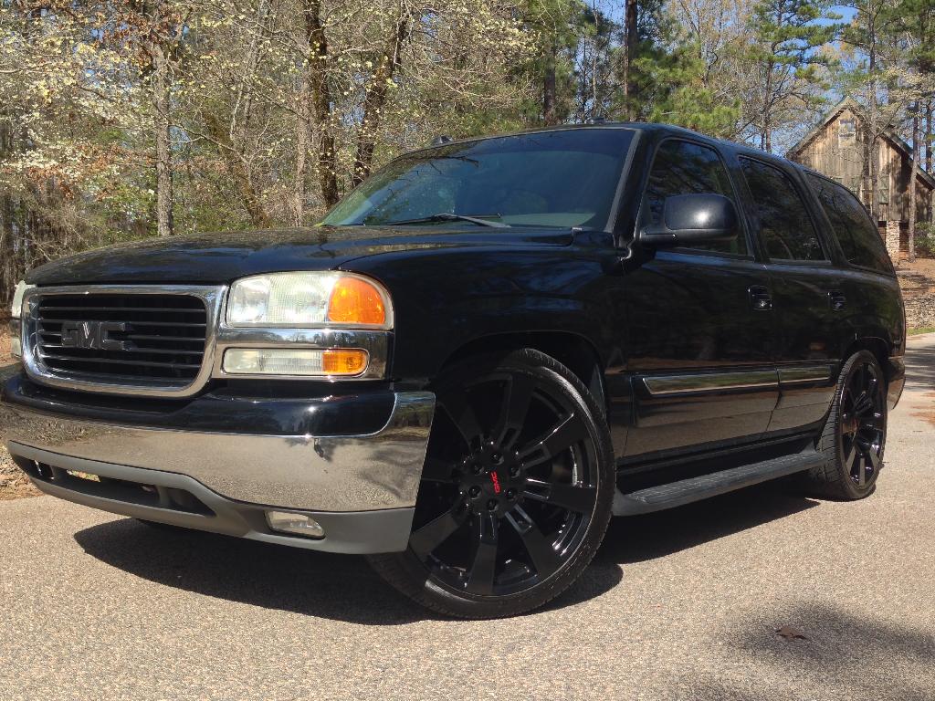

Vehicle: 2004 Yukon SLT2 2WD
Advertised drop
- 4.5" front
- 5.5" rear
Fender height front/rear:
- Front: 31.25"
- Rear: 32"
Front:
- LCA's : stock
- UCA's : stock
- Spindles : McGaughy's 2" Drop Spindles
- Sway Bar : stock
- Tie Rods : stock
- T-bars : stock
- T-bar keys : stock
- Shocks : stock
- Steering : stock
Rear:
- UTA : stock
- LTA : stock
- Springs : McGaughy's 5" springs
- Panhard : Stock
- Sway Bar : McGaughy's rear end kit
- Shocks : Belltech 2410FF
Wheels & Tires:
- Wheels: 24" GMC CK375 with +31mm offset
- Tires : Nexen 305/35/24
Considered upgrades:
- AccuAir front and rear
- DJM 3" drop LCAs
- Spohn Upper and Lower links
- Spohn Panhard Bar
Brief impressions of setup:
It drives and handles so much better than stock. The Yukon is more predictable at highway speeds and in traffic (sudden stops and swerves). The front can get a little rough over uneven roads.

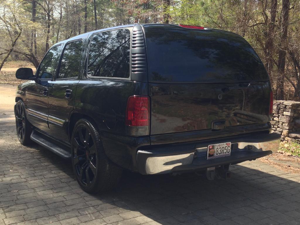

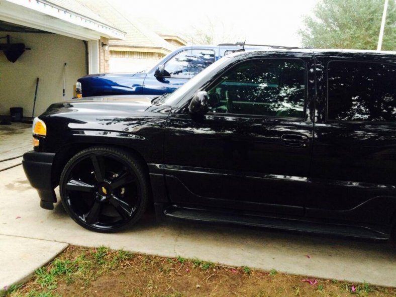

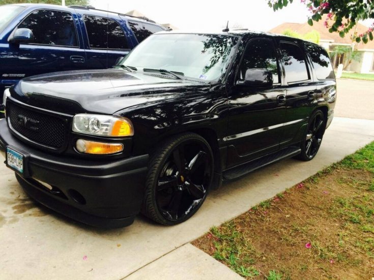

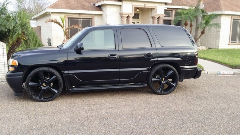

Vehicle: 2006 Tahoe LS 2WD
Shop that installed the lowering kit in Fort Lauderdale:
California Custom Sport Trucks
http://www.calcustoms.com/
Kit purchased:
NORCAL SS CUSTOM 3/5-6 Tahoe Yukon lowering kit.
http://tbssowners.com/store/index.php?act=viewProd&productId=88
This kit fits all 2wd/4x4 00-06 Tahoes, Yukons, etc... without Autoride. Here is the complement of parts contained within the kit.
- Front DJM 3 Inch A Arms
- Front Belltech Street Performance Shocks
- Rear NORCAL SS Custom 6" Springs.
- Rear Belltech 1 inch spacers (makes it adjustable to 5")
- Rear DJM hardware kit with trailing arms, end links and shock extenders
- Rear Belltech Street Performance Shocks
- Spohn Adjustable Pan Hard Bar (purchased separately from kit)
- Helper Bags Part Number 60742 (purchased separately from kit)
Advertised drop
- 3" front
- 5-6" rear
Fender lip to ground measurements before the drop:
The tape shows over 36"
Fender lip to ground measurements after the first 500 miles (Sept 2014):
Right front 33 3/4"
Left front 33 1/2"
Right rear 34"
Left rear 33 7/8" (with full tank of gas)
Fender lip to ground measurements after 8 months (April 2015):
- Right Front:33"
- Left Front: 33"
- Left Rear: 33 7/8"
- Right Rear, 33 9/16"
Wheels & Tires:
- Wheels: 20" matte black LTZ reps with +31mm offset.
- Tires : Bridgestone Dueler Alenza HL 275/55/20.
The truck rides pretty sweet. I do have the spacers still in there and the helper bags with less than 5 psi. The shop did not do the free travel mod and only cut the OEM bump stops down a bit. I was a little pissed initially as I had asked them to do this (perhaps there was a miscommunication about the bump stop bracket and the bump stops themselves) and the red bump stops that Tony includes with the kit went missing.
I spoke to Tony about the free travel mod, sent him pictures and he suggested to me that if I was happy with the ride to just leave it. Let the air out of the bags and bring the rear down a touch and call it a day. Another inch would be great for looks, but honestly the ride is really nice. And the fenderwell gap is gone from stock. I really do not have any complaints about this set up, the kit or the ride. The shop sorted me out with a second alignment one week later for free after something got knocked out of whack. That was really nice.
It drives and handles so much better than stock. The Tahoe holds the road, corners better, doesn't dip and dive or bounce around so much over bumps.
Happy that I decided to go with the 3/5-6 kit rather than the 2/3 kit. I scoured the TYF before I chose the kit, emailed back and forth with Tony for ideas, found this thread and then wanted to contribute for the next guys wanting to make the same decisions that I made. I was nervous about changing the OEM setup, but it might be my favorite modification as the entire look of the truck is changed. From there, everything else just complements the stance.
Here are some progression pictures. There are more pictures in my build thread. Thanks for reading and if you are on the fence, just do it. Ask another TYF member or email Tony. You will love it!!

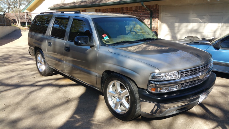

Aaron_L
Oct 2, 2013
157
63
Arlington, TX

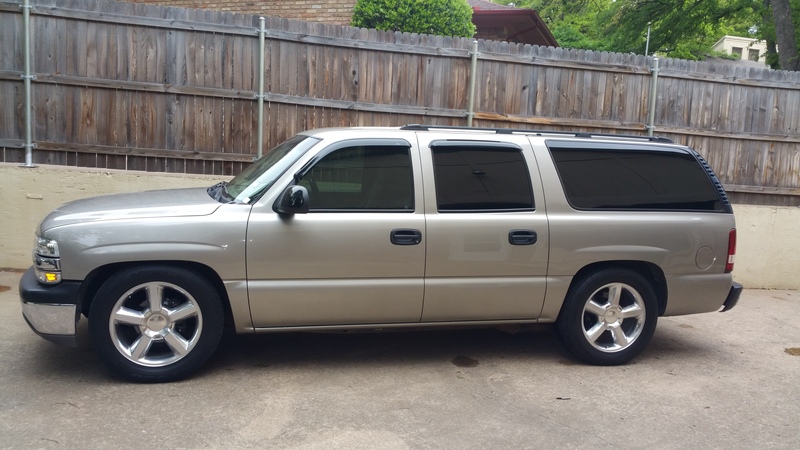

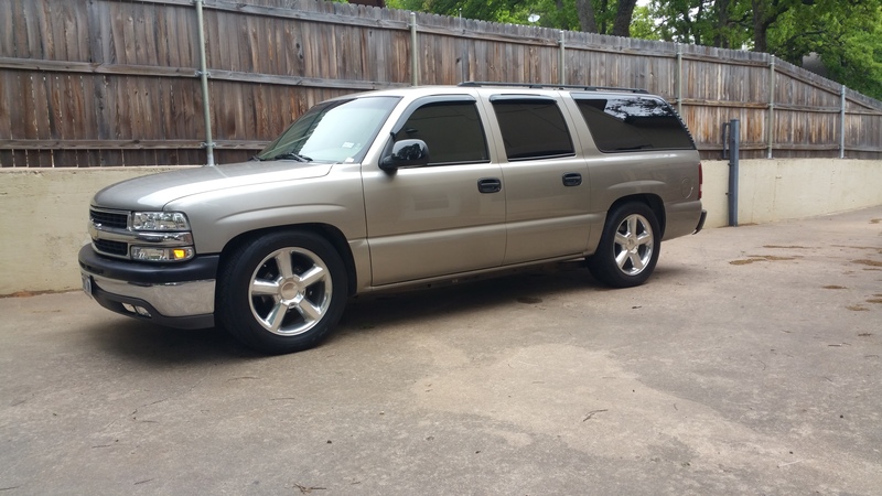

2002 Chevy Suburban
Just a bunch of parts I accumulated, not really a "kit" but it came out to be about a 4/5 drop.
Front:
2" Belltech spindles
dropped keys
DJM shocks
Rear:
4" Maxtrac coils
DJM trailing arm & sway bar brackets
Spohn panhard bar
DJM shocks
free travel mod
275/55-20 Nitto 420's on Tahoe reps.
31 1/2" Front, 32 3/4 Rear. Overall I'm very happy with it. Ride is good, a little firmer than stock, but not bad. Passed the wife test, lol. Installed everything in a day as well as rebuilt the whole front end. When I took it in for alignment they said they had to max the camber eccentrics and couldn't get it to factory specs, but as long as I rotate the tires regularly I'd be ok. I haven't noticed any wear on the insides of the front tires. My only issue is that the front tires contact the tops of the inner fenders on big bumps/dips, but then again it's been a few years since I've had a dropped truck and haven't gotten back into that mentality yet, lol.

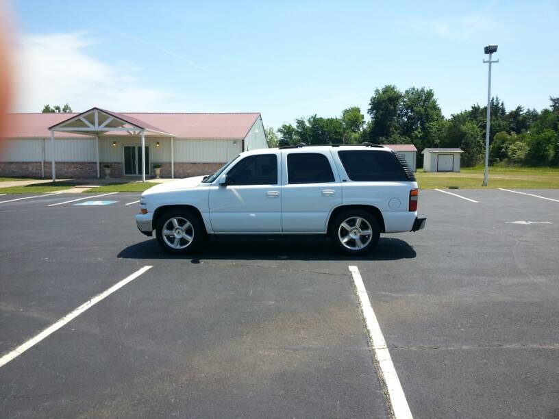

Mister H12
Undercover Racecar
May 12, 2012
217
West Tennessee

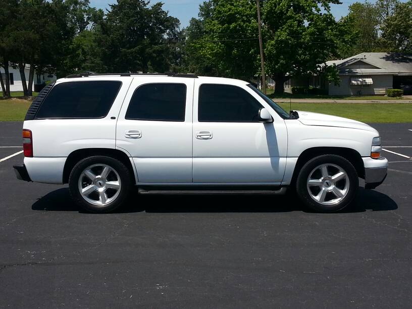

Mister H12

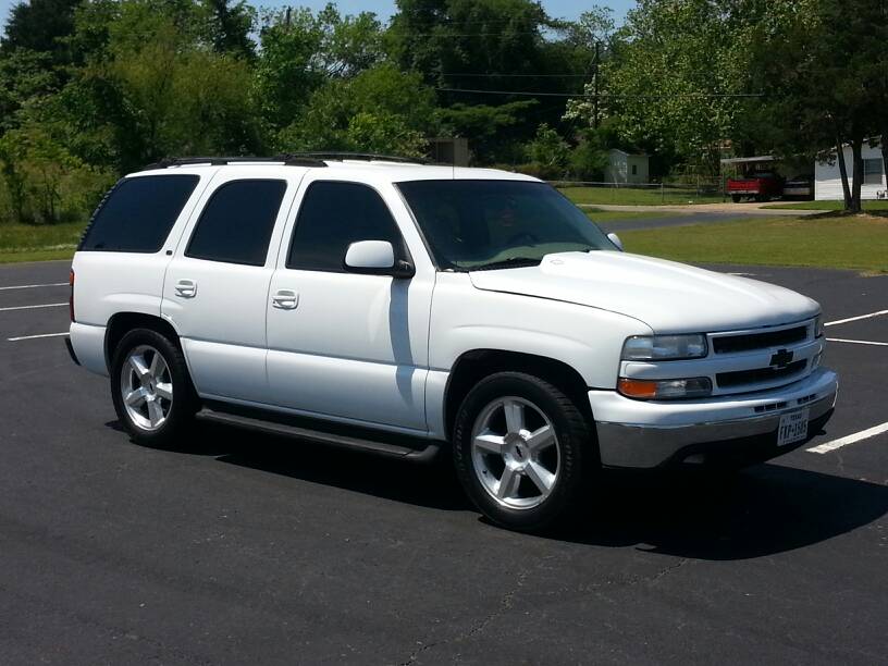

Model/Year/2x/4x/AWD:
- 2005 Tahoe LS 2WD
Advertised drop:
- 3"/6"
- 32.00/32.00
Front:
- LCA's : DJM 3" Drop
- UCA's : Stock
- Spindles : Stock
- Sway Bar : Stock
- T-bar keys : Stock
- Shocks : Belltech Street Performance
Rear:
- UCA: Stock
- LCA: Stock
- Springs : Norcal SS Custom 6" Drop Spring
- Panhard : Stock
- Sway Bar : Stock
- Shock Extenders : Yes
- Free Travel Mod : No
Wheels & Tires:
- Wheels : 18" Titan wheels, Powder Coated Black
- Tires : 265/60R18 Michelin Latitude Tour
Brief impression of setup:
NEED Free travel Mod (Ouch)!! Very noticeable change in handling characteristics. More of a "sporty" feel than a rocking boat. Takes curves like a dream, potholes.. not so much.
Future Modding:
Free travel mod.
Larger Sway Bars
Spohn adjustables.
22s
Etc..
Far from done but just had to jump on this post as soon as I dropped it! Too eager lol

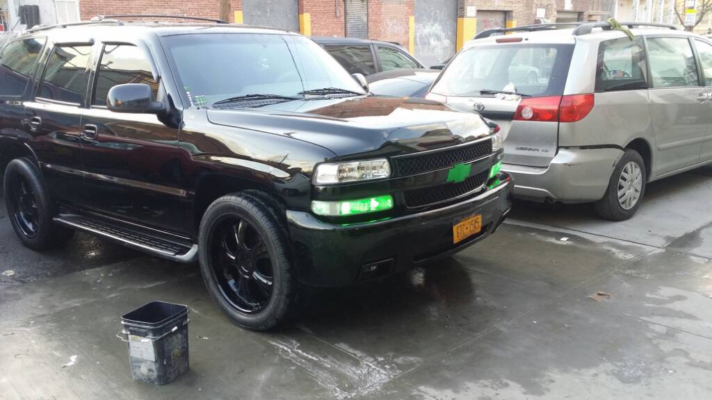

gettygatz4life
Apr 21, 2014
220
30
Bronx ny

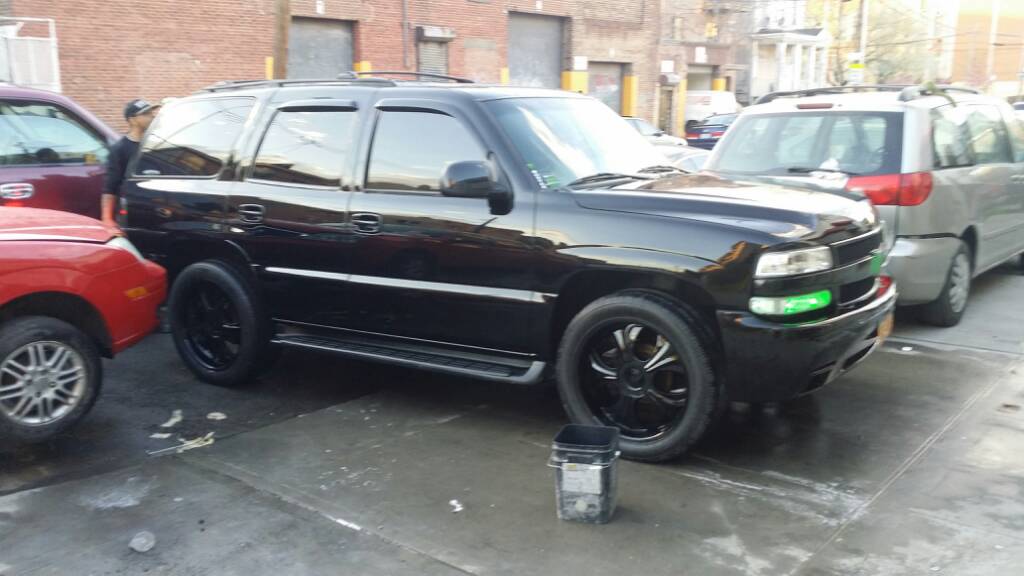

Hey to everyone on here I need some help from ya I got 305/45/22 on my truck I need to know how much can i drop it and what the best kit I can use and hope much it cost to do a job like this and when you drop a truck do it have the same driving like stock or is a bouncing feeling now please help love the set up on here
Sent from my SM-N900V using Tapatalk
NORCAL SS
SUV SUSPENSION GURU
Jun 9, 2009
8,744
610
here you go my 3/5-6 kit
http://www.tahoeyukonforum.com/forum/showthread.php?p=627600
any qustions just ask

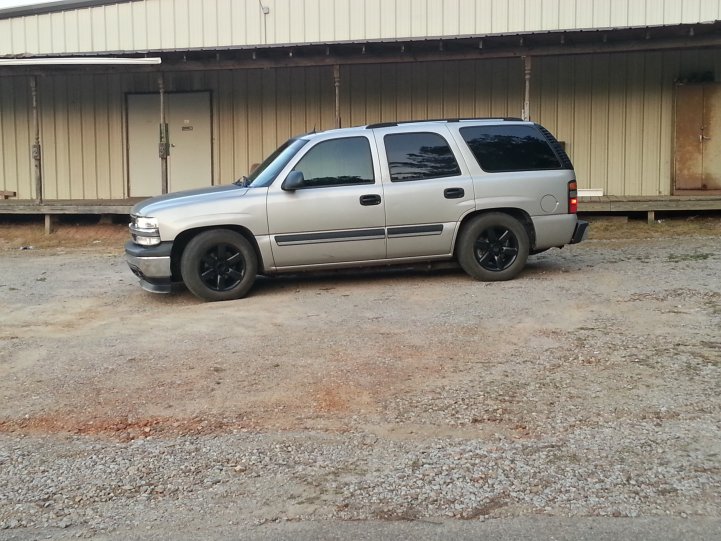

2/3 or 3/4 on 275/55/20
Ill be doing the wheels in anthracite this week also
---------- Post added at 02:21 PM ---------- Previous post was at 01:35 PM ----------
When you do 3" rear do I need shock ext and drop shocks? Or. Can I just do replacement shocks and shock ext or just drop shocks. I don't want to buy ext if I can just by shocks or vice versa
NORCAL SS
SUV SUSPENSION GURU
Jun 9, 2009
8,744
610
with 3 inch or more i always do drop shocks/extenders. Look at the shock angle at a 3 inch drop you will see why I recommened extenders
Nortex
Mar 21, 2011
974
36
Price me 2 rear shocks bt sp and ext please
