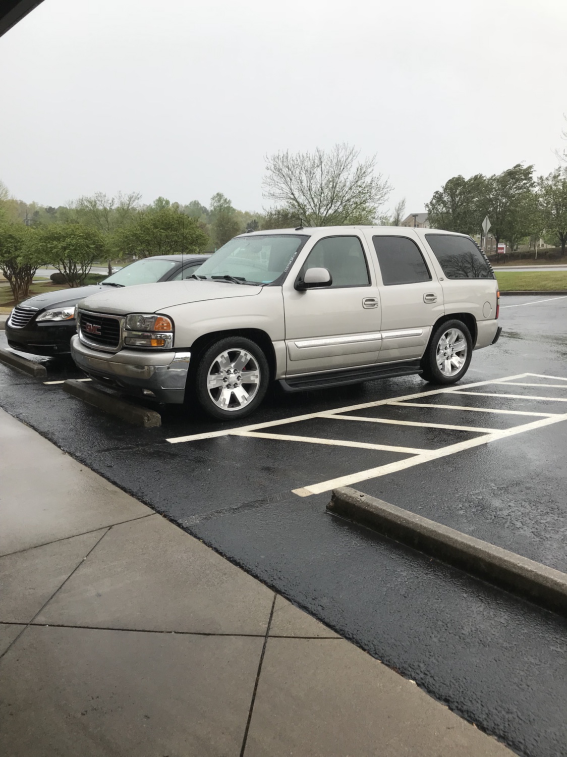

What size tires are those ? Looks good

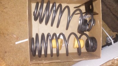

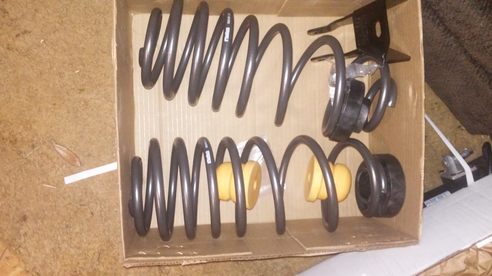

Their 295/30r26. Got this in the mail yesterday. Belltech 5305 rear kit brand new for $185 shipped to my door.

500 takes it all man. The black coils are Tony’s 6” coils . The other coils are some eBay shit I cut. Lol. 500 isn’t bad considering the control arms are about 350 or so
Man, been thinking about it and just can’t justify it since I’ve got 75% of my drop already. I appreciate it tho, that’s an awesome deal. I really am just lacking the panhard bar, LCA relocating brackets and would like to have Tonys springs
