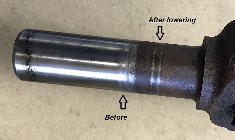

One thing I don't remember seeing mentioned in this thread. When I lowered my Tahoe last summer (see post #162), my truck developed a transmission fluid leak at slip yoke. The lowering process forces the slip yoke deeper onto the tailshaft (driveshaft moves forward).
If you live in the rust belt, you may need to clean the crust off the slip yoke. The picture shows the differences in where the seal rides before and after. Fortunately, I was able to clean mine and stop the leak with a new seal.

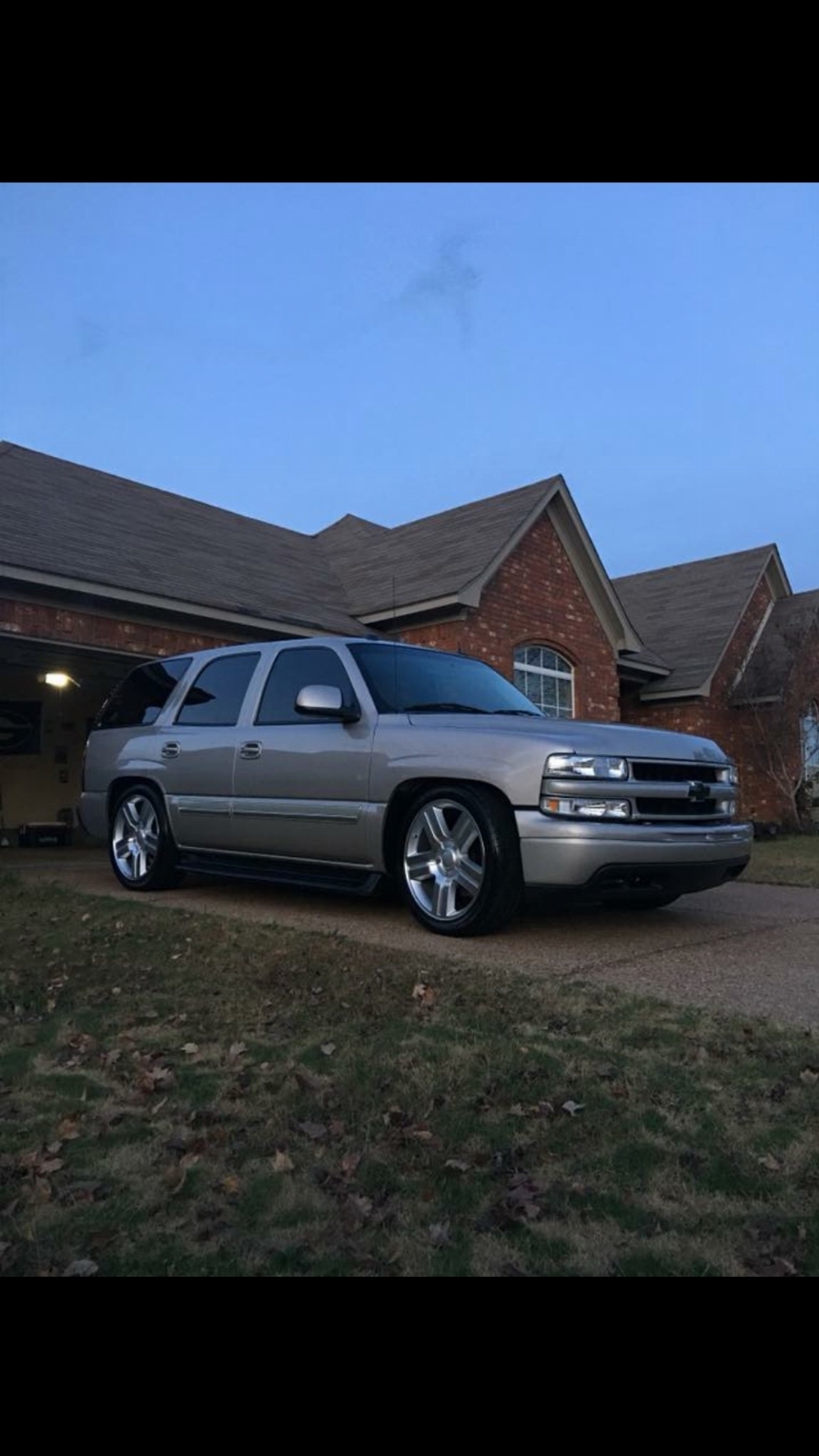

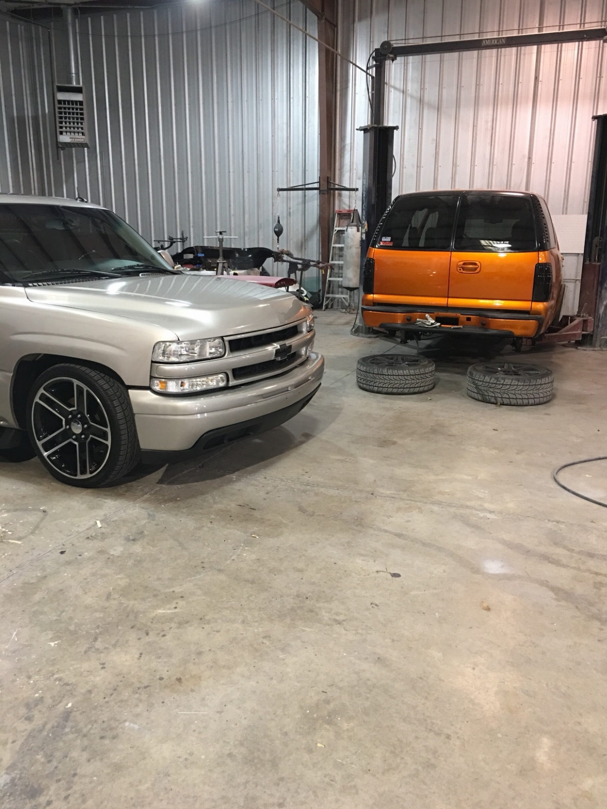

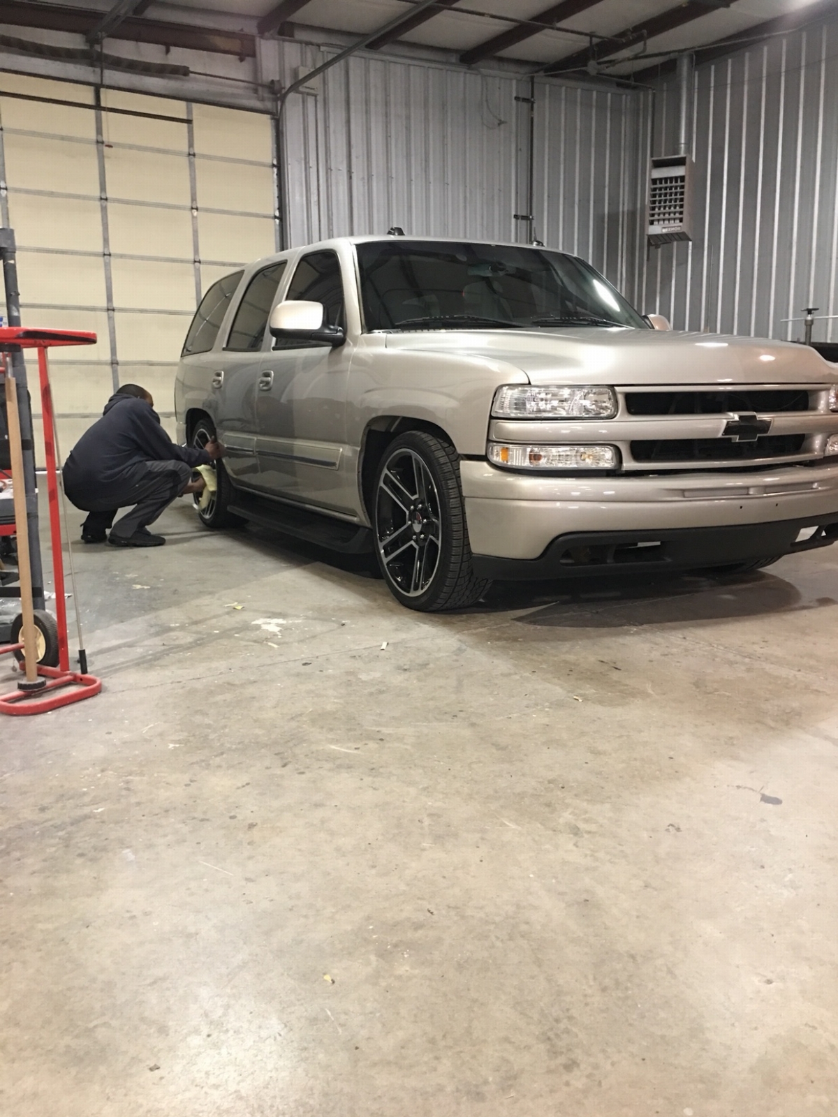

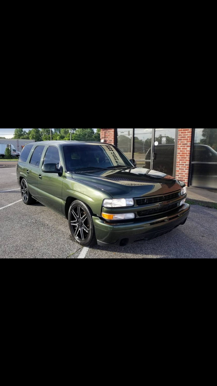

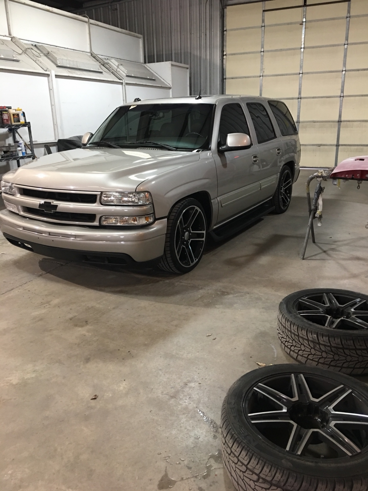

Front :
2” spindles
3” DJM lower control arms
3” keys
Monroe OEspectrum shocks for a 97 Nissan hardbody ( tried many shocks including belltech, cal max etc and these rode the best for me )
Rear :
Tony’s 6” ( half coil cut )
DJM Trailing arm kit with shock extenders
DJM sway bar links
Spohn panhard bar
Belltech Street performance shocks
Free travel Mod
Cross member notched ( above driver side mounting point of panhard bar )
Tires - 265/35/22
Front 30.5
Rear 31
