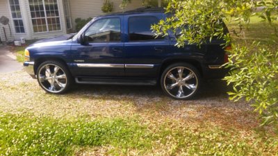

04 Yukon 2wd
-Stock keys, passeneger taken completely out. Drivers only cranked 4 turns to even out measurements.
-Belltech 3-4" rear spring kit with bumpstops, shock relocators and cups. Need to trim the bumpstops or do the free travel mod cuz I only have ~1/2" of travel right now.
-Belltech SP shocks all around
-Belltech sway bars front and rear
-GMC Denali 22s with 285/45/22 Toyos
Sent from my VS990 using Tapatalk

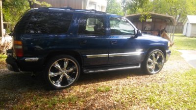

Looks great and I love that color. You don't see many that color. Thanks for the info brother. Just got my rims put on and now need to install my rear kit. Think ima have to leave spacers I got some 6a on it.

Nice. They don't look that big.
Yea they look just right. I shopped long and hard before I bought them. Wanted to get some that looked right and not contrast with the truck. I think I nailed it. They both have curves that kill. Wait till it's almost kissing the tires. They will certainly look bigger then. Thanks for the like brother.
