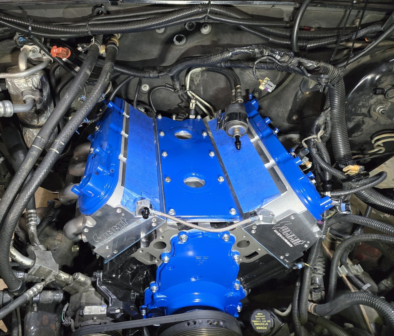

Between family time, My son in-law and I got a little further with the install:
  • Installed 8 Bell Housing to Engine Bolts
  • Tightened transmission support nut
  • Installed fuel line support bracket
  • Installed transmission dipstick bracket
  • Installed engine mount bolts
  • Measured the flex plate and torque converter clearance and determined a spacer is required with this new torque converter
  • Installed and torqued three flywheel to torque converter bolts along with required spacer washers
  • Installed flex plate locking tool
  • Installed harmonic balancer
  • Torqued harmonic balancer bolt
  • Installed grounding wire to engine driver side (behind engine – 13 mm bolt, 2 wires – see picture)
  • Installed grounding wire to engine passenger side (top aft – 13 mm bolt – see picture)
  • Installed camshaft position sensor and connected harness
  • Connected crankshaft position harness
  • Connected oil level sensor harness
  • Installed driver side transmission inspection cover
  • Installed starter along with passenger side inspection cover
  • Connected starter wires
  • Installed both drivers side and passenger exhaust manifolds11 ft/lbs then 15-18 ft/lbs and connected exhaust system
  • Connected exhaust system to manifolds
I will tell you that installing the spacer washers (one for each bolt) for the torque converter was a PITA due to the lack of hand space and a decent view, but we got it done. The rest of the install can be completed easily without the need for an assistant. Getting closer.

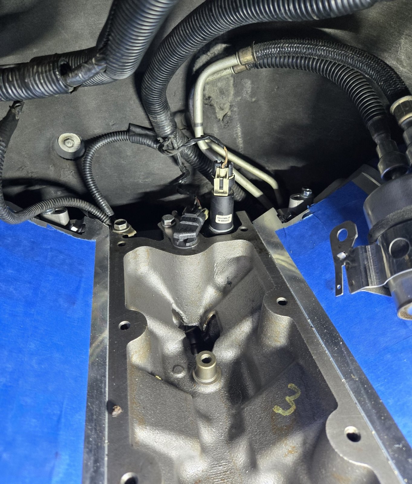

I got home a little earlier this evening and was able to install the intake manifold, changed the throttle body gasket and prepped the fuel rail. Two issues as I was installing. 1. The tape i used to protect the intake opening did not come off easily. 2. What a PITA torquing the back 4 bolts (two waves 44 inch/pounds and the 89 inch/pounds.
