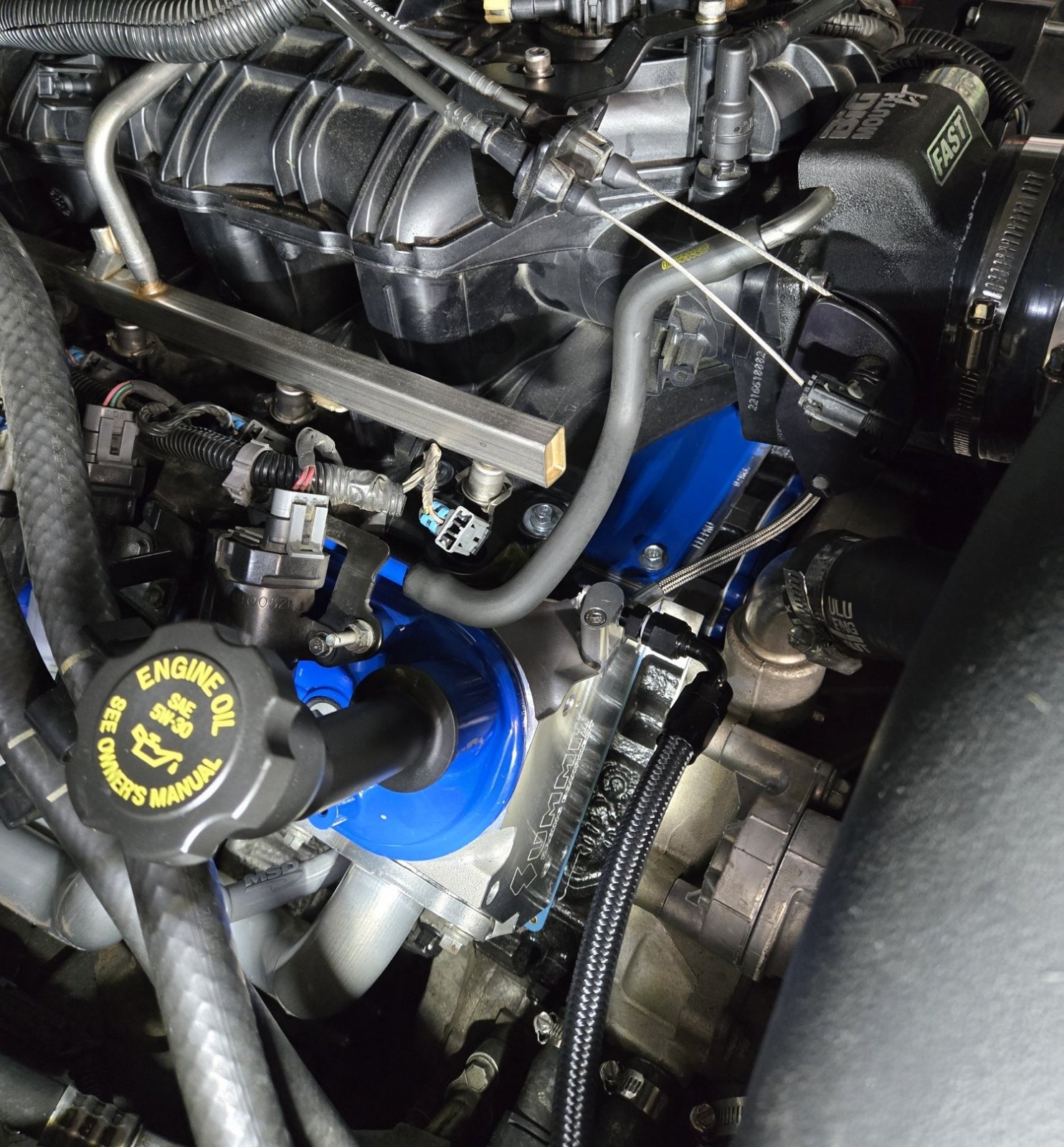

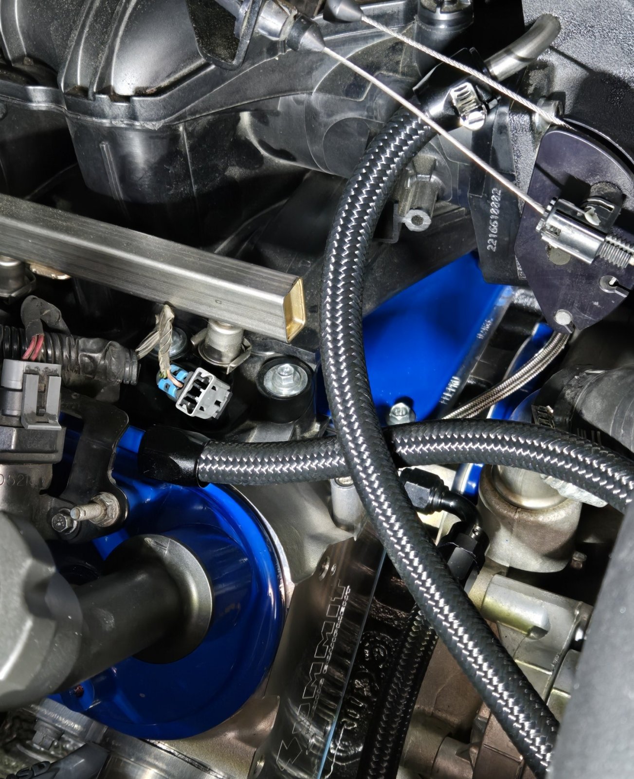

I thought the PS was the clean side and no need for a catch can there? :confused:
Two reasonons: 1. I read somewhere that you should. 2. When pulling that hose on the passenger side when I was dismantling the old engine and removing the intake manifold - there was a little oil in that tube.
So as a precaution, this is what I'm going to do. I will see if that was a wise decision or not. I can always remove it. We will see after my next oil change.

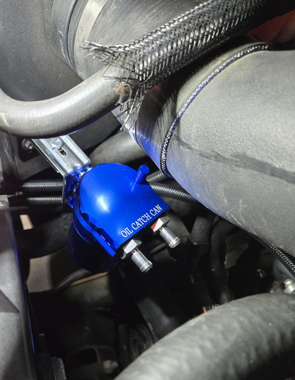

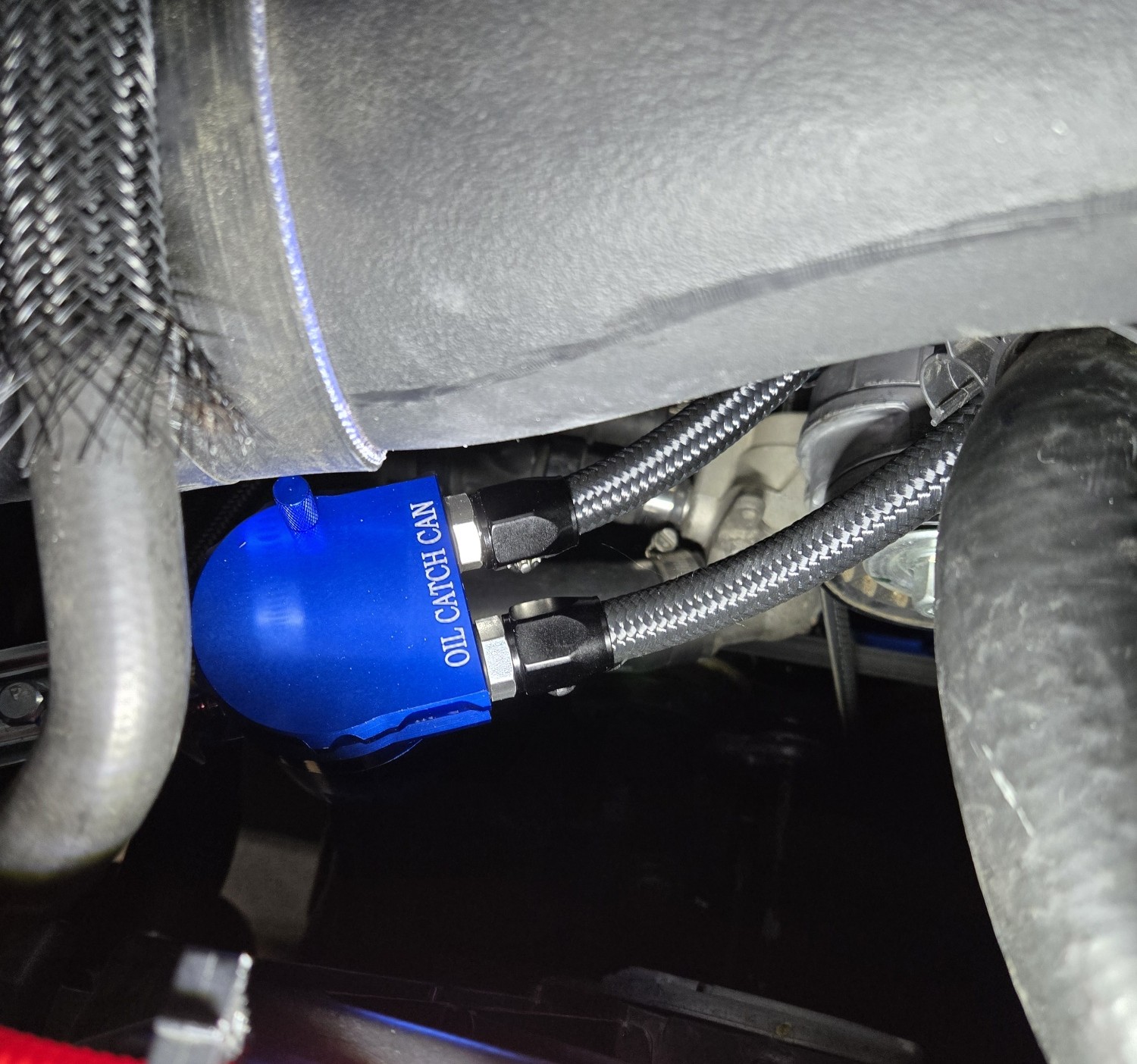

Finally installed the catch can this afternoon.
That frayed (protective sleeve) coolant line is next.

Thank you for the response. Yes, I have a tuner that can accomplish the relearn. It's running great so not sure if I want to go through the steps - although pretty straight forward based on the video Flees provided. Probably going to replace the hose with some braided hose I have - I'll provide pictures when I get around to changing it.
