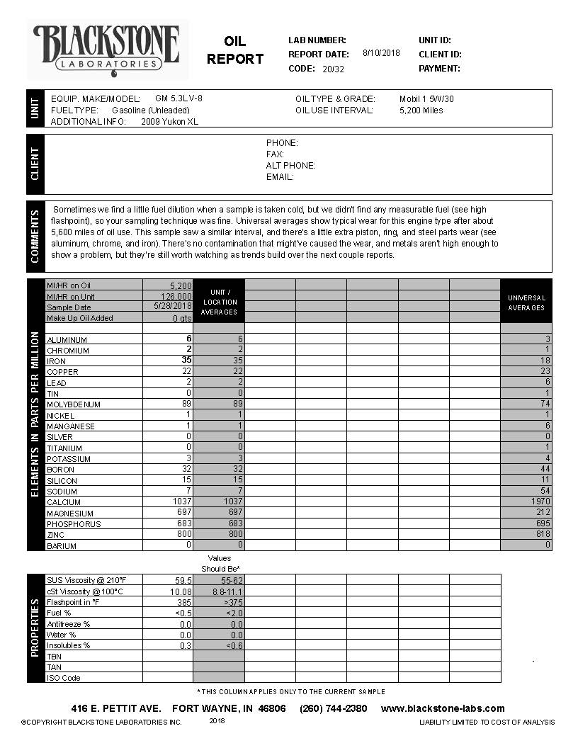

My Blackstone-Labs Oil Analysis
21,296
30,248
So what do y'all think of this?
I neglected to mention to the lab that the K&N oiled filter was replaced by an AC Delco high capacity paper filter about halfway through the oil change interval. About a week before the oil was changed, the engine was put on E85. I also failed to mention to them that at 111K the AFM system was overhauled with a new VLOM and all new lifters and such.
Could any of the above items explain the higher than normal readings?

Numbers look good. Nothing to worry about. No fuel issues which is one thing I am concerned about with my Direct Injection.
At first my plan was to get a 2012-2014 without Direct Injection. So far have not heard from anyone with a 2015 plus complain about fuel dilution in their oil if the oil was changed out by 6K miles tops. I did come across someone who changed their oil at 10K miles [2015 5.3] and he said the oil smelled like gasoline as it came out. He now changes out at 5K miles and no more gasoline smell.

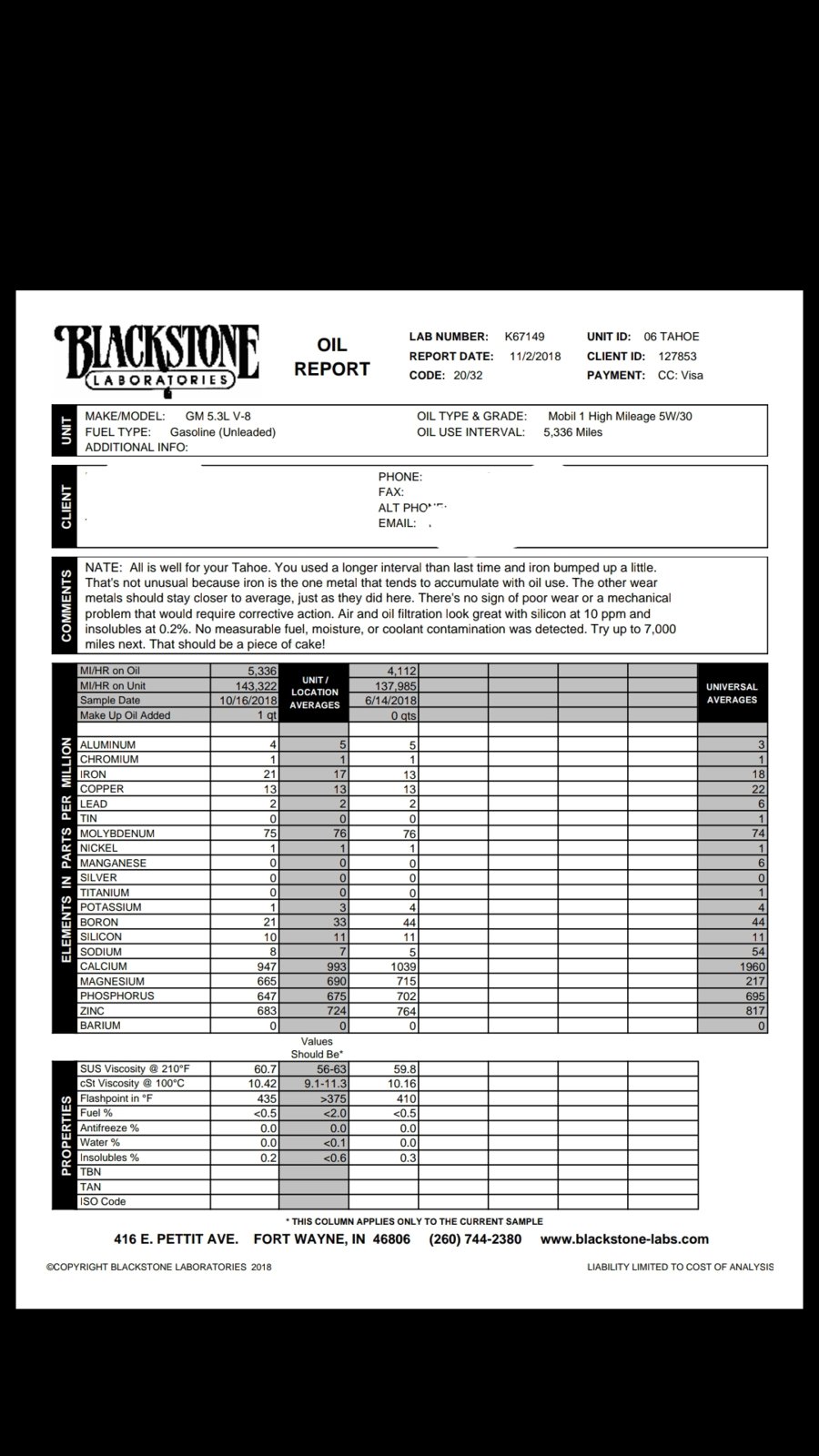

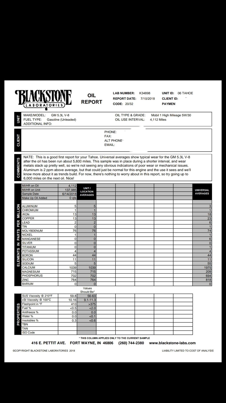

Just did my first one last change :

Based on my numbers and Blackstone advice, I went the other way. From 4100 to 5300. He said go higher. I'm not.

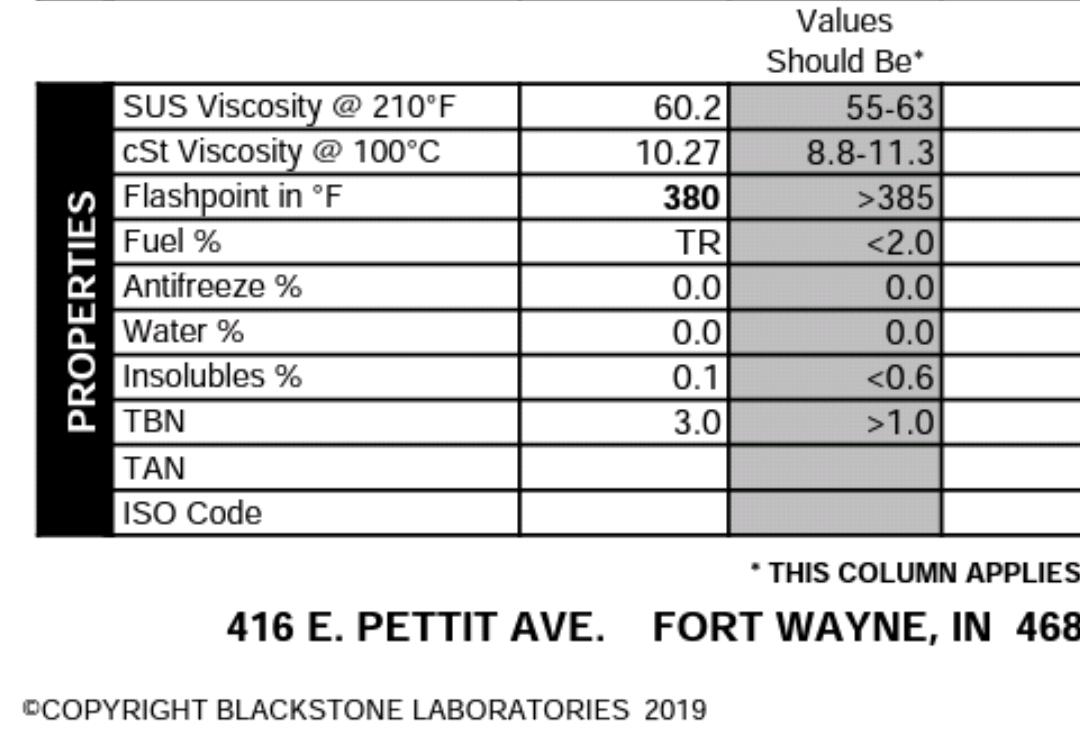

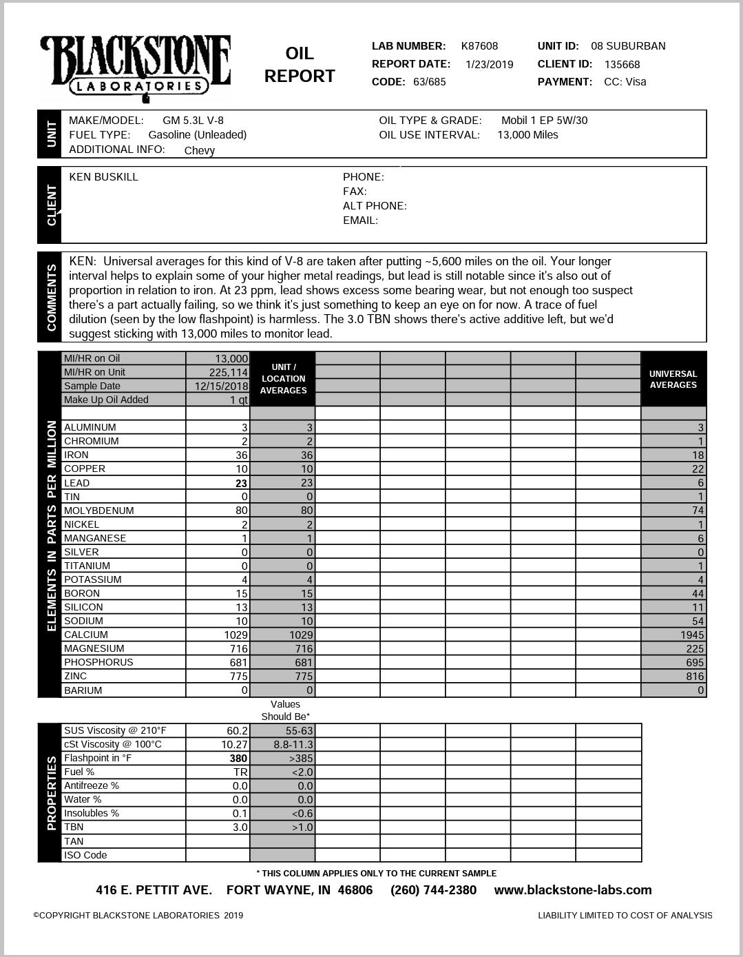

Just thought I would post my Blackstone report in here as well...
Also a close up of the TBN report...
The thing I noticed is the Insolubles % is very low which if I am interpreting it correctly means that my upgraded filter system seems to be working well.
Keep in mind that this is on a 13,000 mile oil change so that is more the twice the miles of their "average" test vehicles base numbers.
Here is some good reading on the results of these reports...
https://www.bobistheoilguy.com/engine-oil-analysis/
It gives a breakdown of each line and what the potential reasoning is for the numbers.
The only one I'm not sure about is my Fuel %...
It shows "TR" anybody know what that means?

It means trace amounts. He refers to it in the comments, too. Mine was <0.5, and my insoluble was 0.2.
