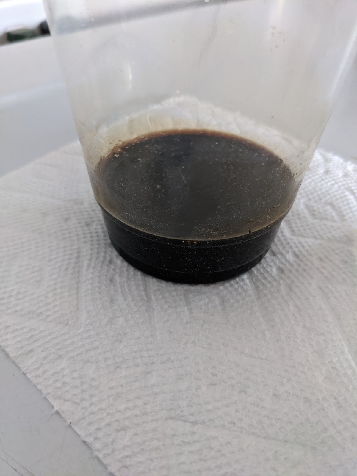

Well today I did my second oil change. The first one was done at the dealership at 800 miles due to possible fuel contamination in the oil. When draining the oil today with 6000 on the odometer it was black and looked like oil would in a diesel or a 20k oil change interval. I pulled a sample and will send it to Blackstone Labs for a oil report. The first report was fine so if this one comes back ok I'll pull a sample every 10k instead of every 5k. I am shocked how dirty this oil was. I change my oil on all my vehicles every 5000 miles. My Honda Pilot and Corvette oil could almost go an additional 5000 miles at each oil change because the oil looks very good. Just wondering what you folks are seeing with your oil when you change it. I know the Chevy dealer installed a Delco filter at 800 but dang that oil was dark. I installed a Purolator PureOne oil filter PL22500 along with 8 quarts of 0w-20 full synthetic dexos2 oil. If the oil looks like poop in the next 2500 miles I will replace just the oil filter before the next 5000 mile oil change. I'll post back up when I get the lab results on the oil from this change.

I do 5k intervals on just about all my vehicles and I’ve noticed the late models do end up with darker oil than I used to see in older ones. I don’t know if that’s due to changes in the engines, or the newer oil formulas.

Also, color has zero to do with its effectiveness. Most modern oils have high TBN well past 10K miles, even though we are sure we have to change them early....

My 2010 the oil looked like crap from the first change on and it is at 247k miles and never any engine issues. My 1970 Vette that I put a $1200 GM crate engine in it back in 1997 the oil always looks clean on the dipstick to this day. My 2004 Gallardo the oil looks like crap almost instantly since all the coolers and stuff you never get all of the oil drained out. 2021 Tahoe already engine issues at 6k miles so I guess my point is it isn't much of a determining factor.

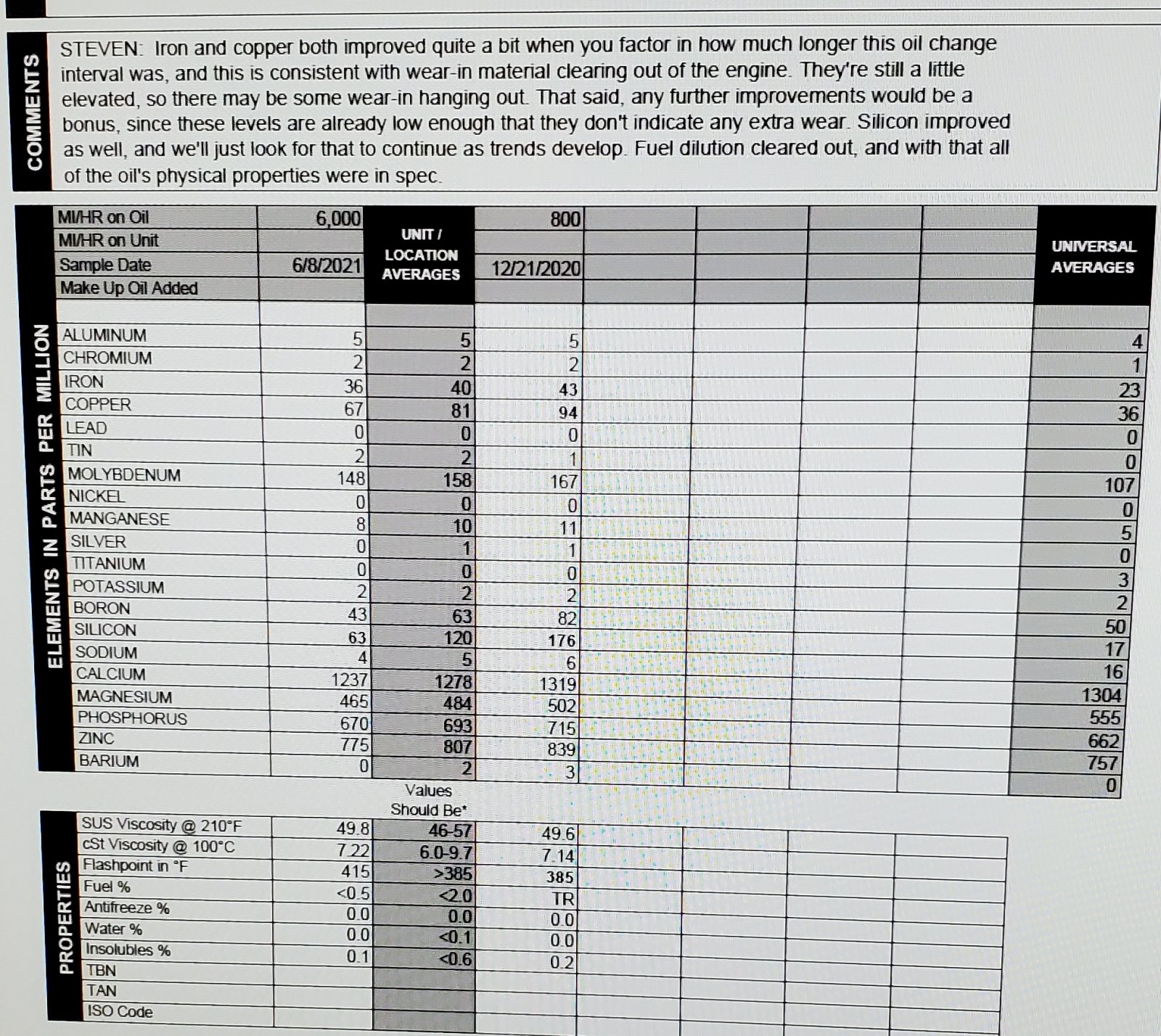

Got the lab results in. Everything is ok and it still shows signs that the engine is still in a break in period. :)

Suggest that you request TBN and TAN to assess the viability of the oil.
If I ran the oil longer than every 5k I would consider it but I want to see what the oil looks like at 11000 with a filter change at 8500. If it is super dirty like the 6000 oil change I might start changing the oil every 4000.

Color or opacity of oil is not a true indicator of oil viability. Total Base Number (TBN) and Total Acid Number (TAN) are. Blackstone offers TBN and TAN to hobbyists. Polaris does it for pros.
