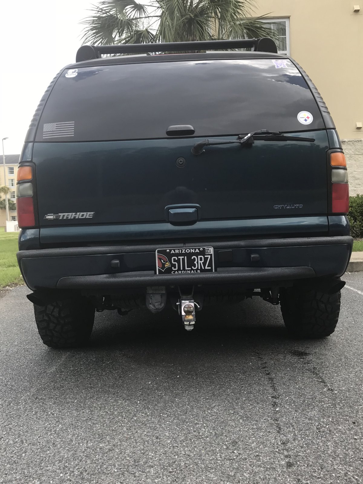

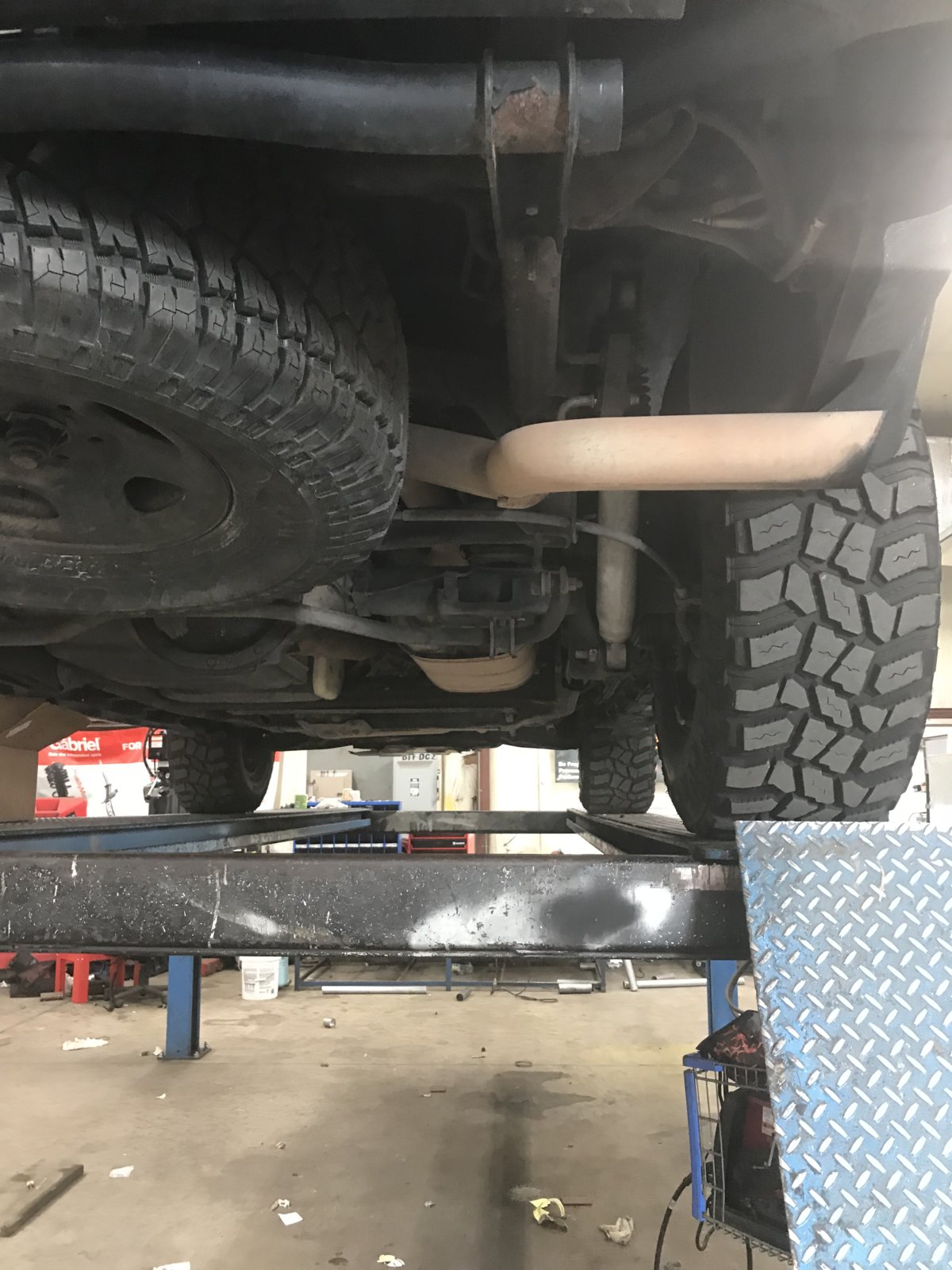

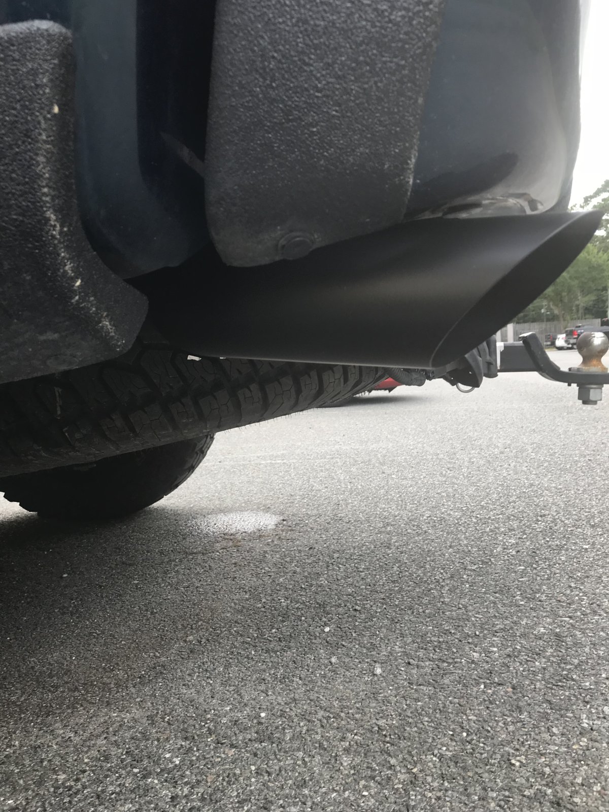

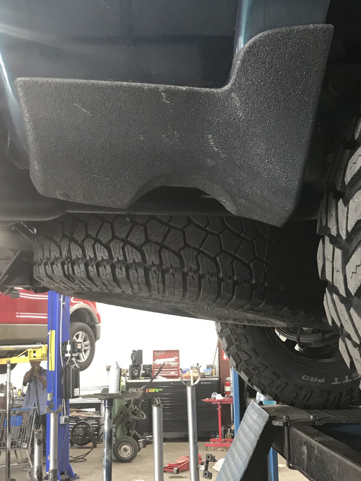

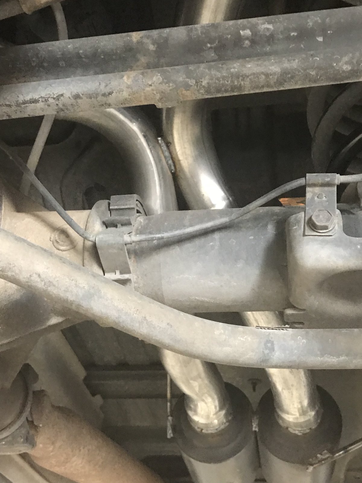

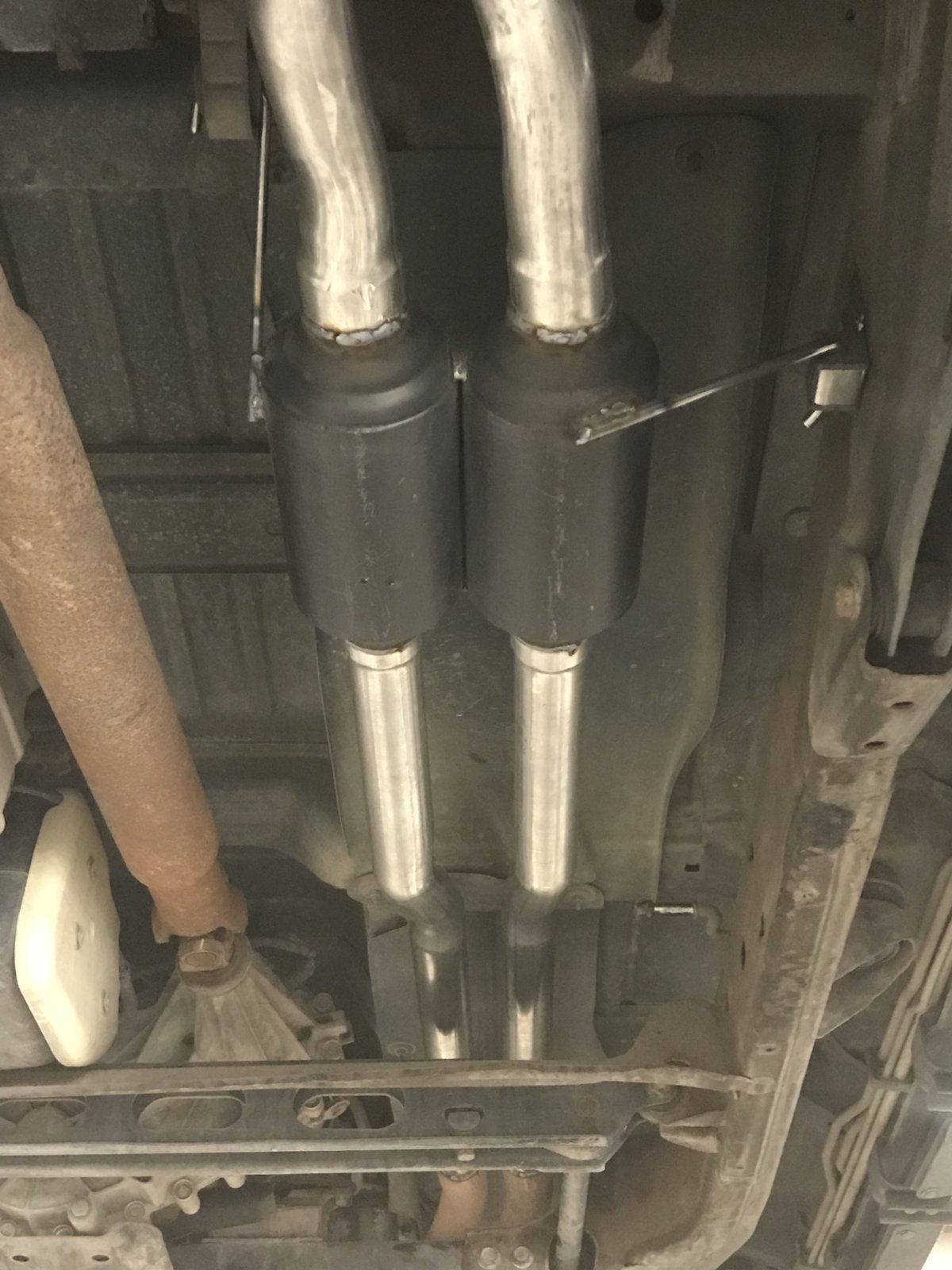

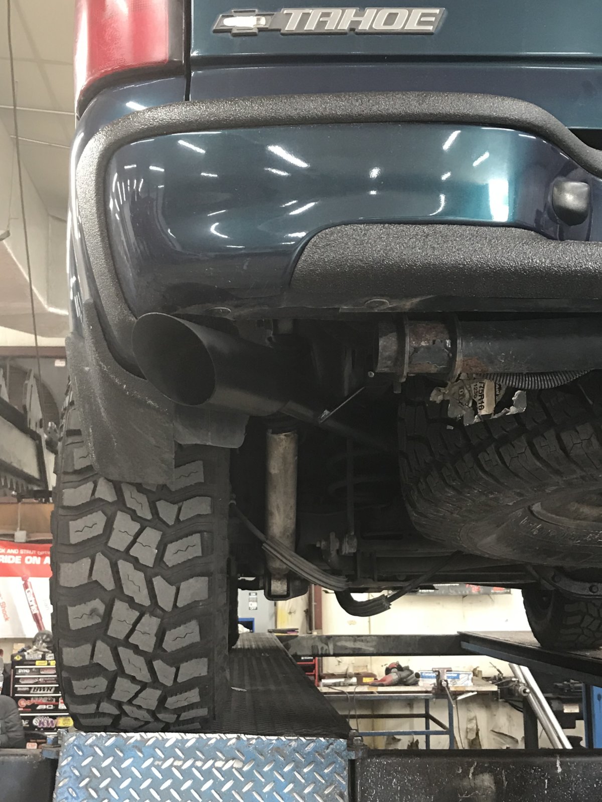

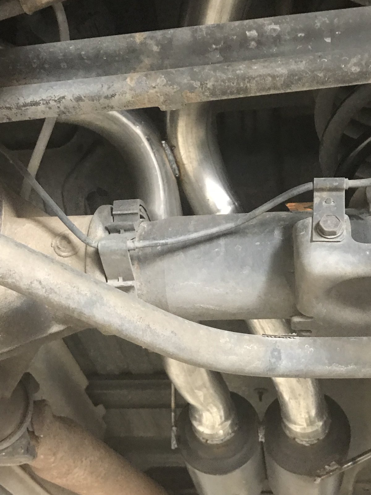

So I didn’t do the traditional 45 degree angle right behind the tire. We decided to go with the exit at the corners of the bumper.
The reasoning was because the plastic rocker where the stick exhaust was has a cutout. Didn’t want the traditional way to have the tips looking uneven.
I actually like this look. It’s still angled but keep the sound more to the rear. It’s a 12” tip instead of an 18” tip
