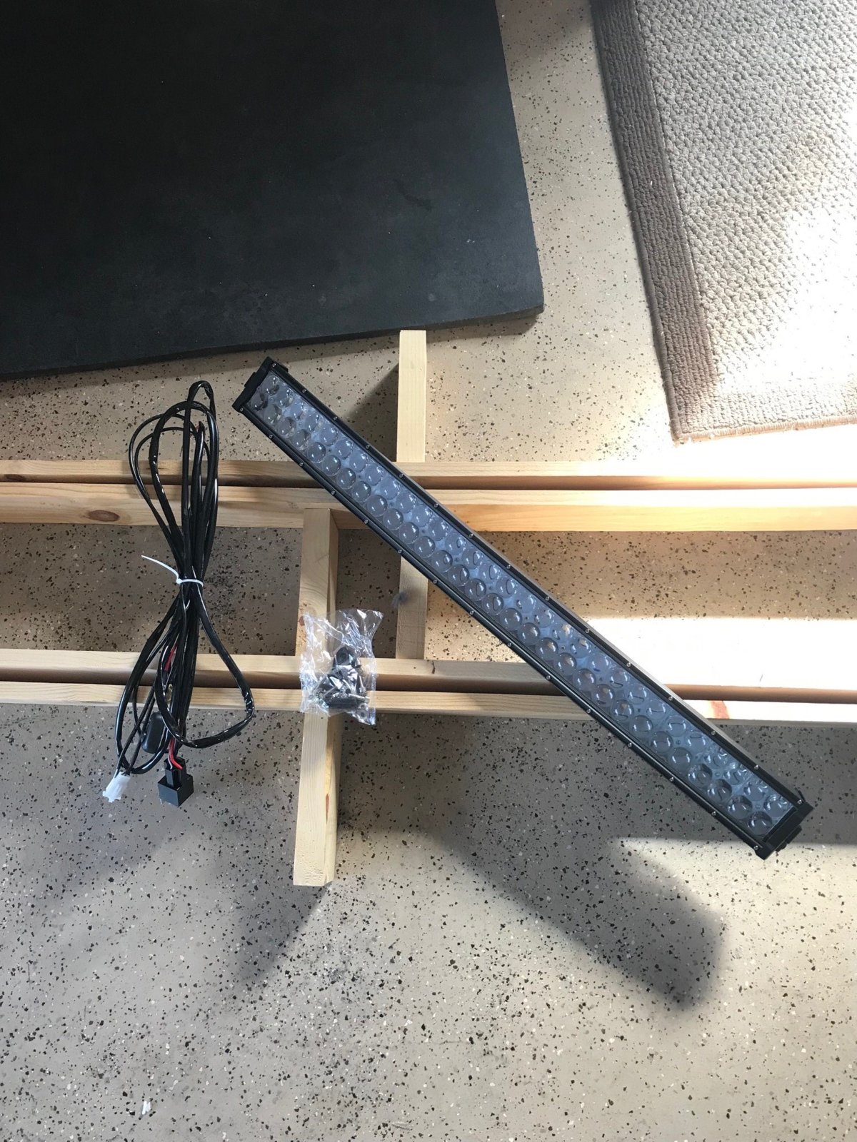

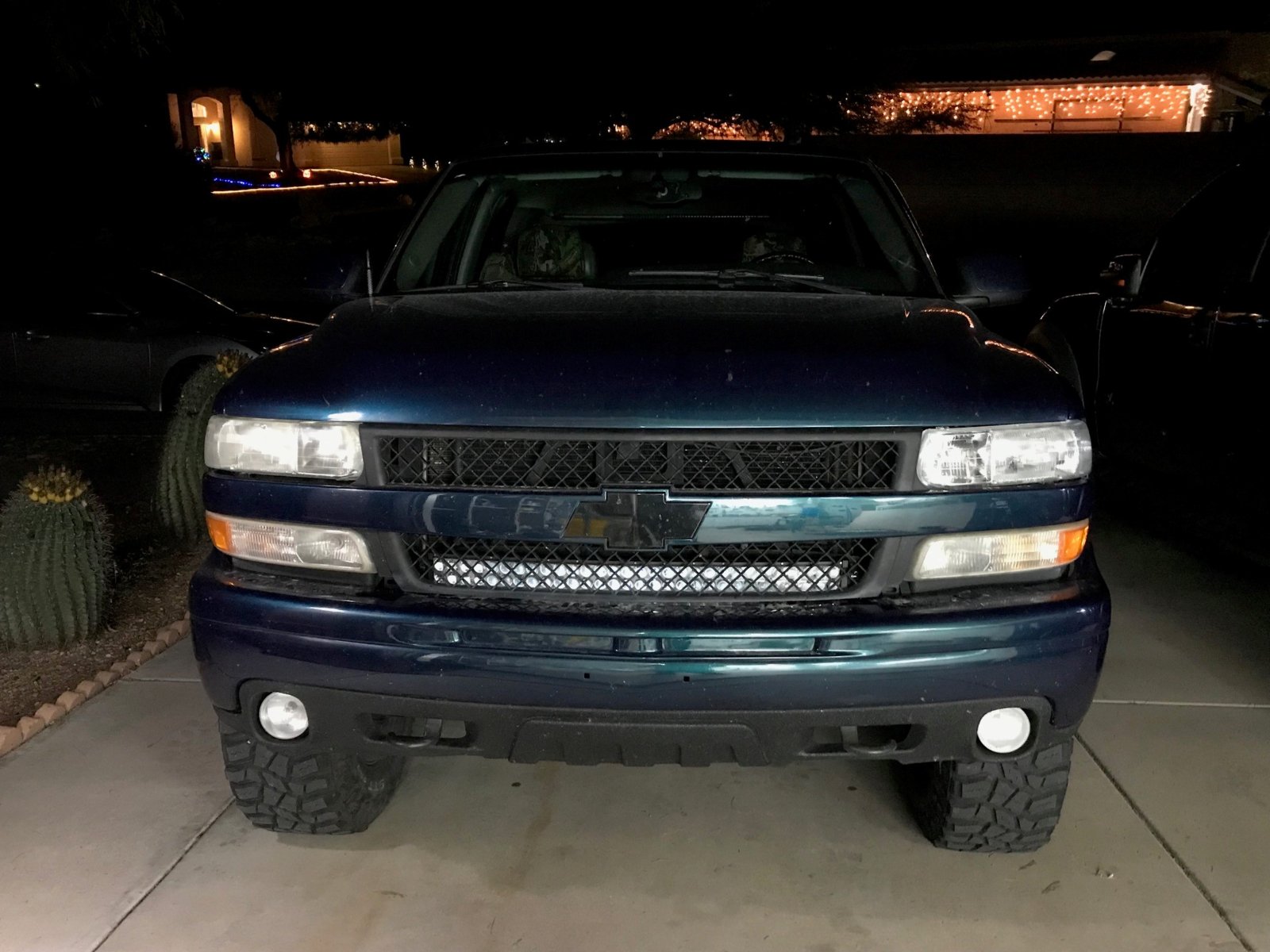

So Saturday was the day to install my new 32" Curved LED Light bar in my grille. I ordered this one off of Amazon. The kit came with the Light bar and all the brackets and screws, a wiring harness with a relay and an inline fuse, and a button switch.
*Note: I decided to use aftermarket switches and the relay it came with did not secure the wires very well and you couldn't re-attach then. I would take a pic of the bottom of the relay to know which wires go where if they fall out and you aren't an electrically savy person.

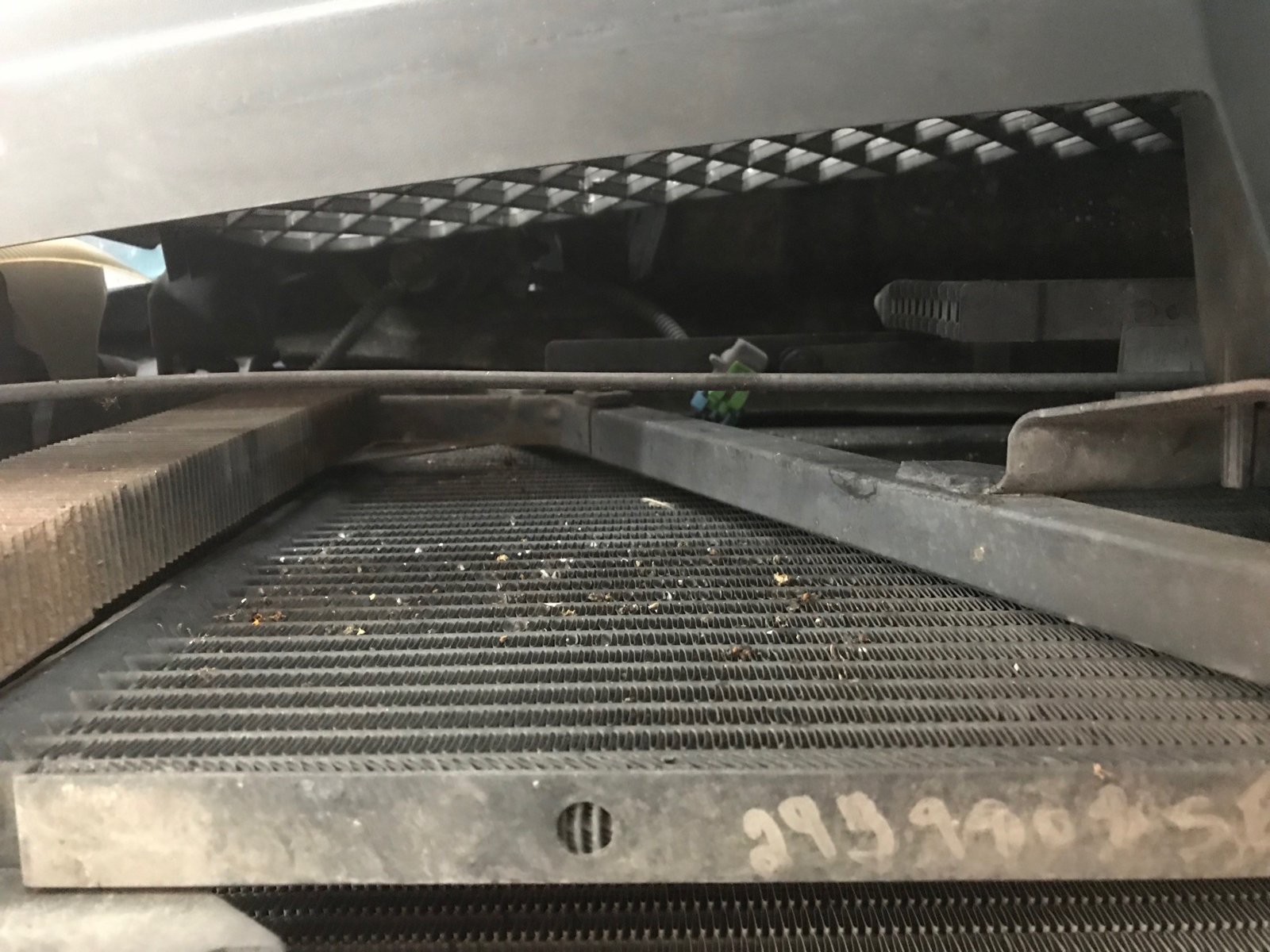

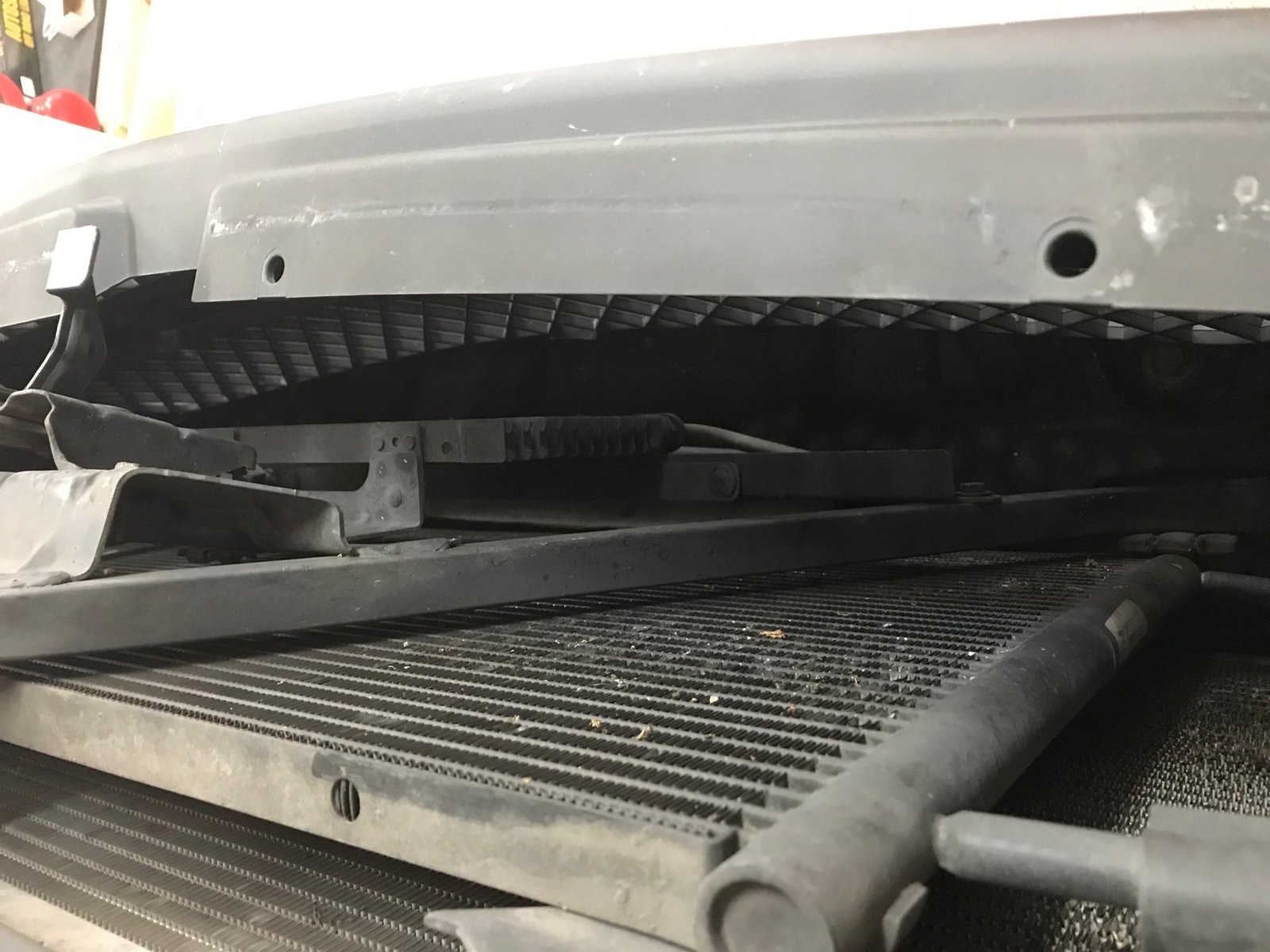

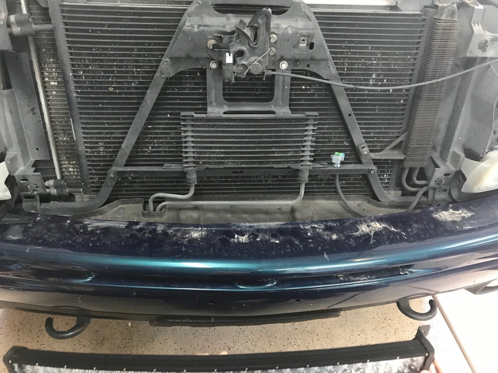

First was looking at the spot where I was going to install the Light Bar. I picked the lower part of the grille. It measured about 33" so I felt good with selecting the 32". I went with the curved because of the tight area inside the grille and I thought it would squeeze in better.
The area is crowded with different coolers

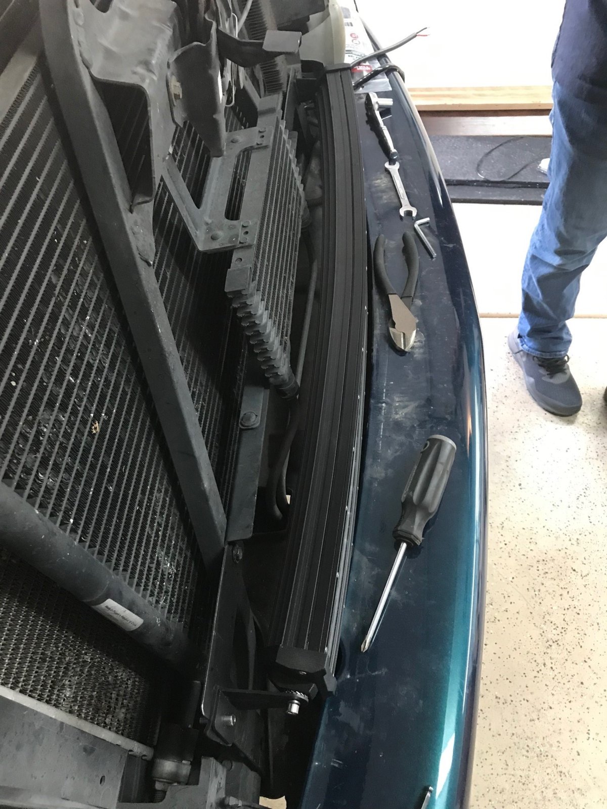

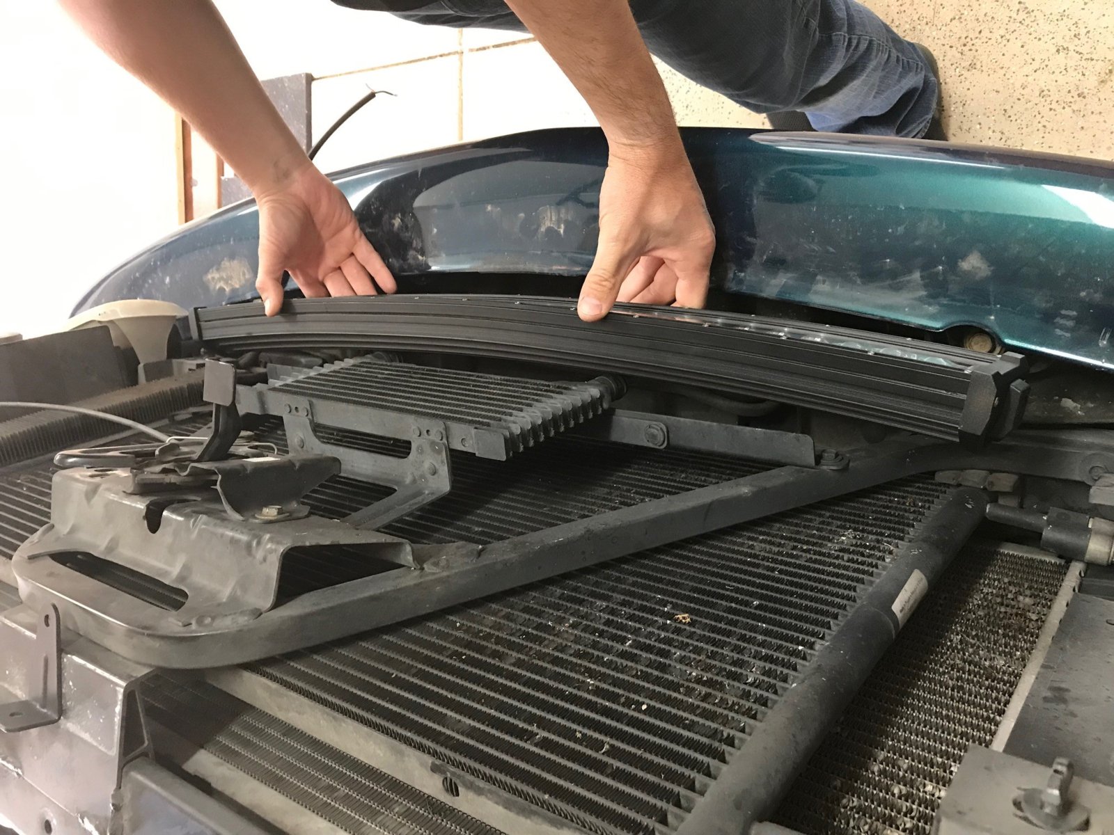

The curved bar is able to slide in front of the coolers

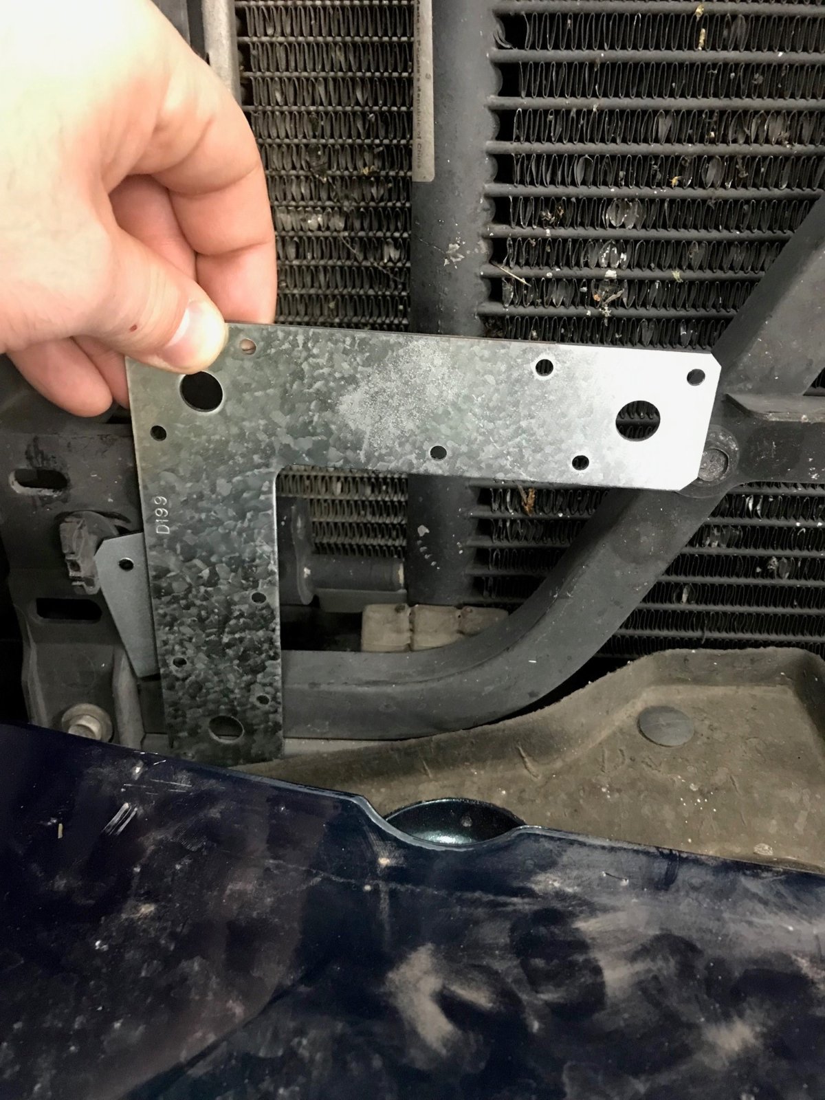

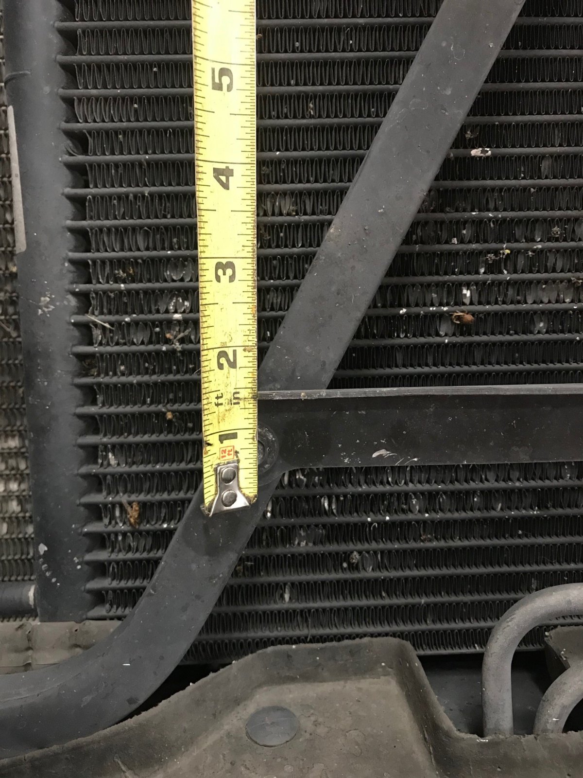

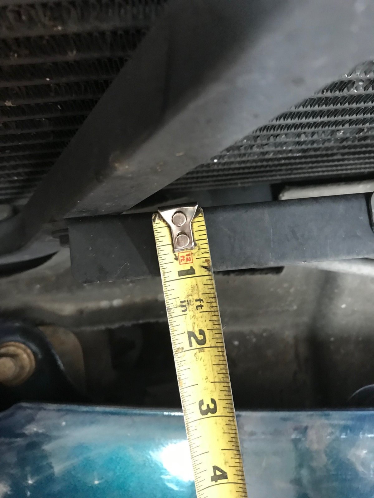

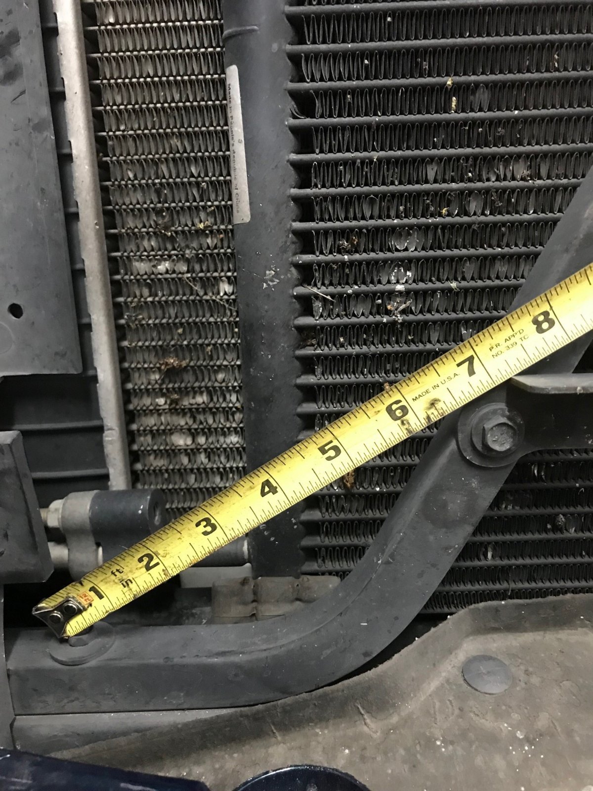

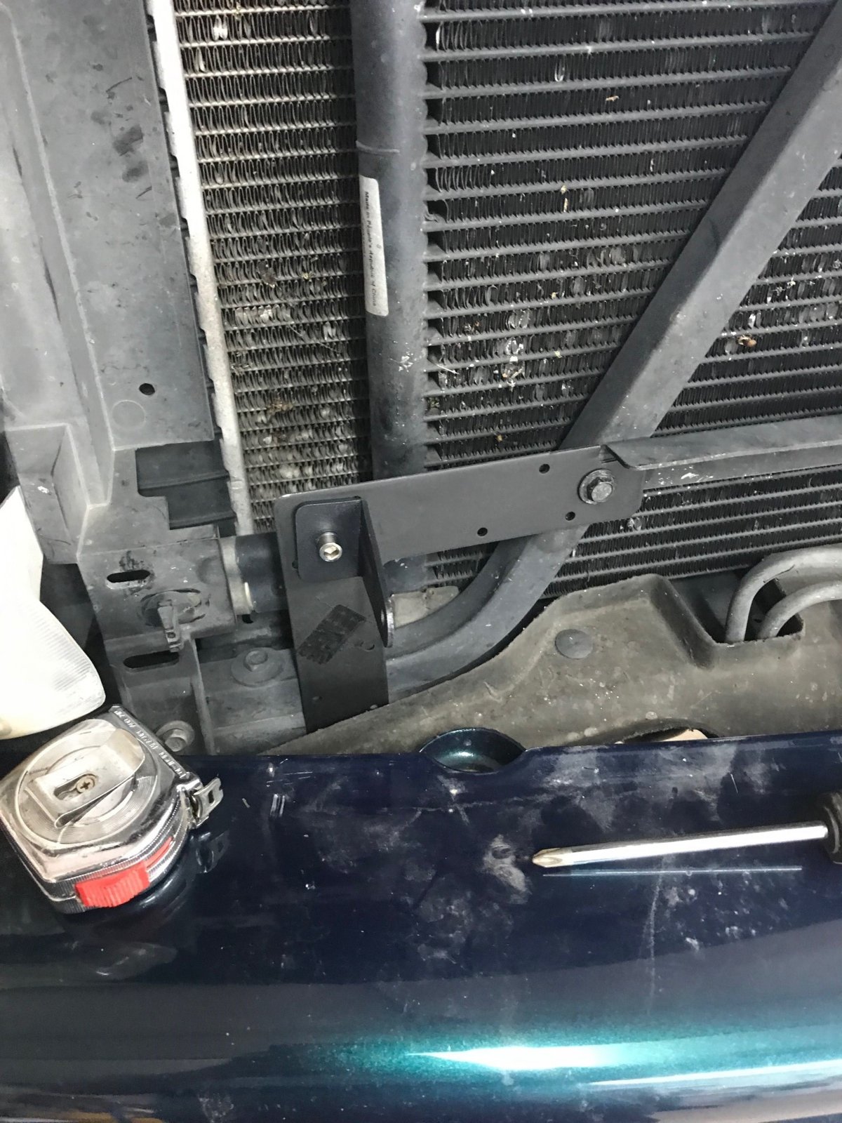

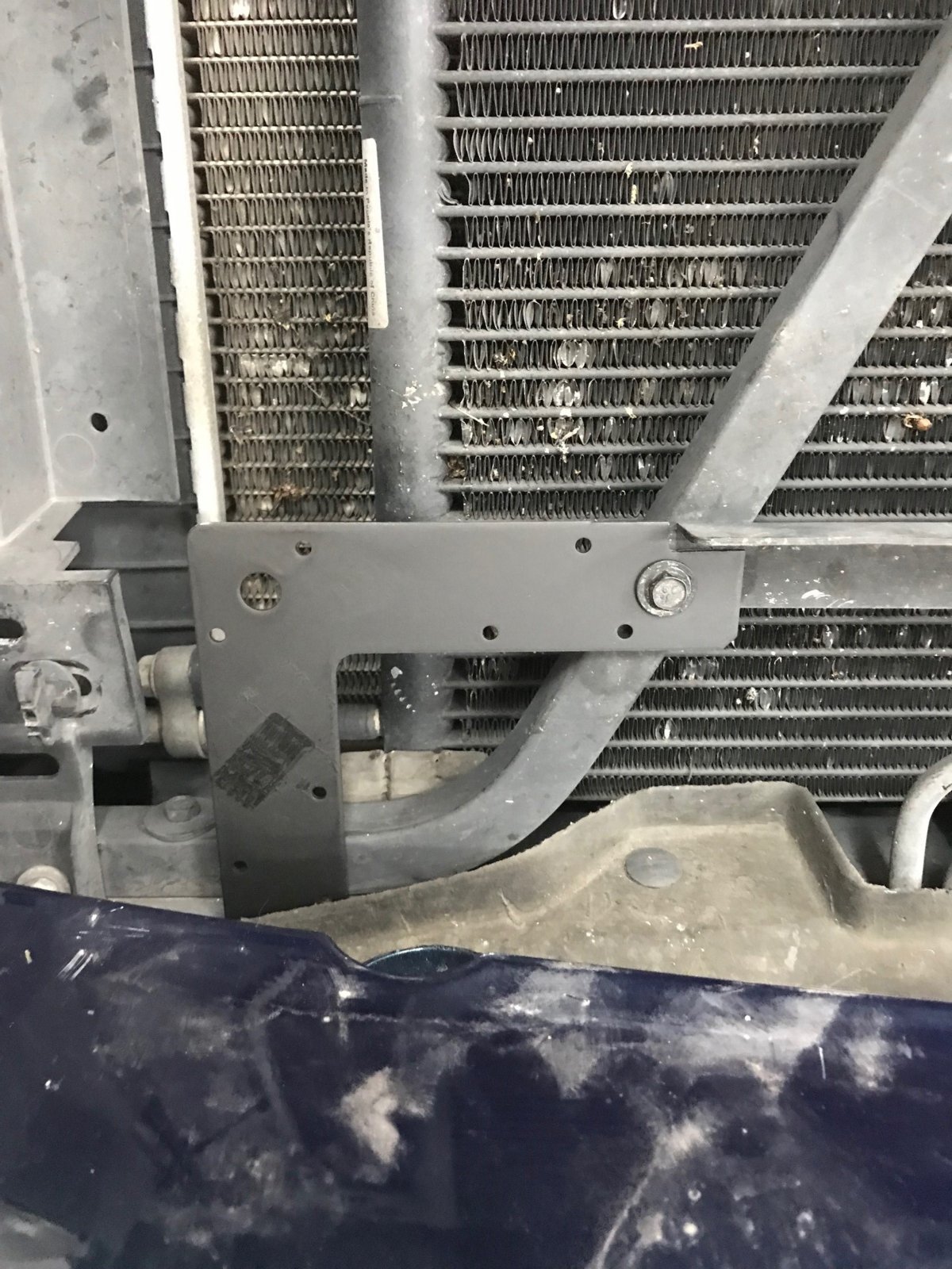

Once I got the grille off, I could not find a decent place to post the brackets for the Light Bar. I began to look around to find a way to mount the light bar bracket. I found a possible spot to mount the bracket on a support mount. It has screws already in the support to use, but I needed some way to attach it to the spot i selected on the support bracket. So i went to Ace and figured I'd get a piece of angle bar and cut it to the specs I needed. When I went to Ace I just happened to walk through the bracket aisle and stumbled upon a bracket i could use! A flat right angle bracket with pre-cut holes.
I think the measurement to get from upper bolt to lower bolt on a right angle is around 5.5" center hole to center hole.
Eventually I will get my buddy in Memphis to Fab me a bracket. Or you could do a few tac welds on the bottom to support the light from slipping down.

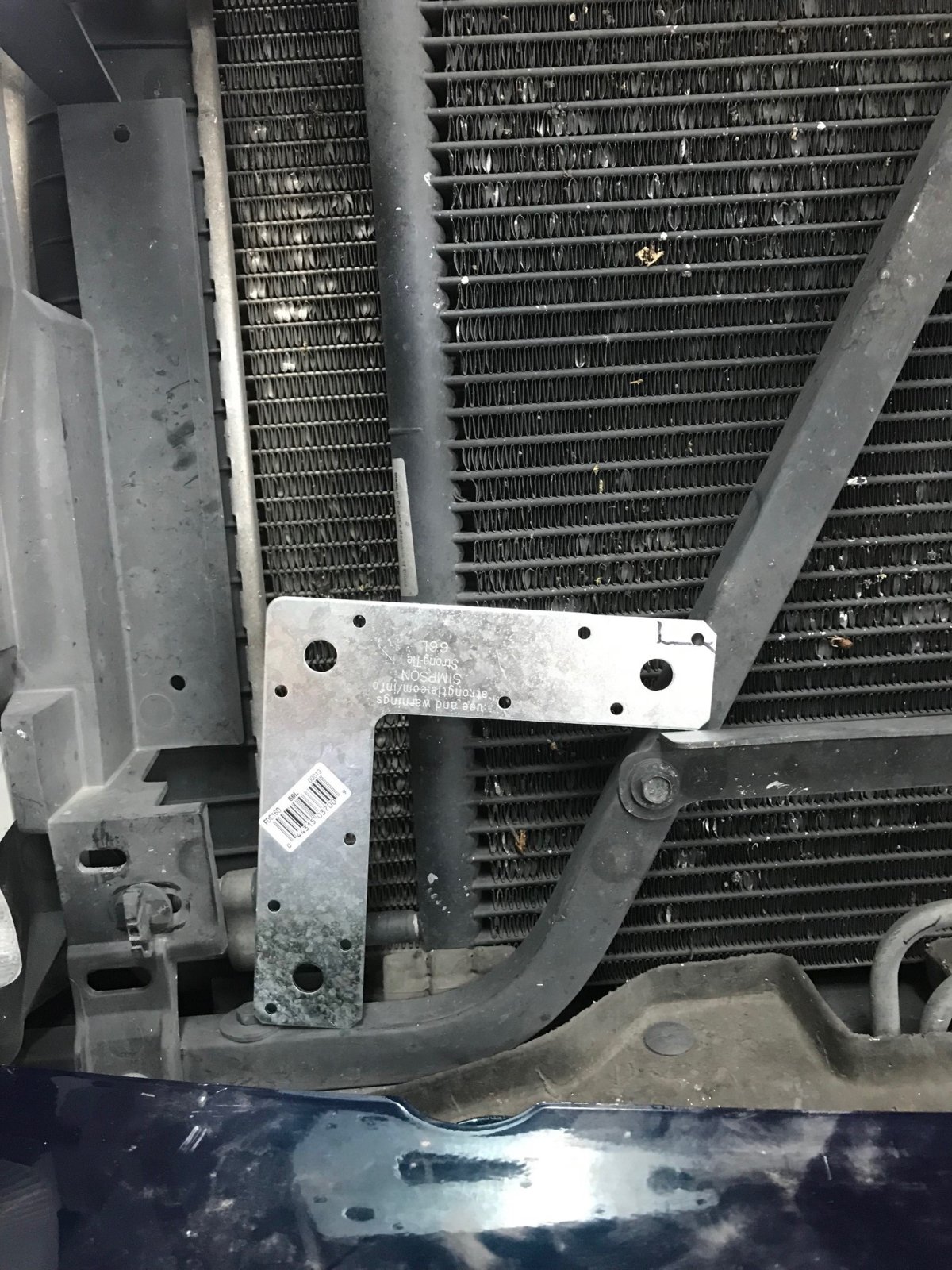

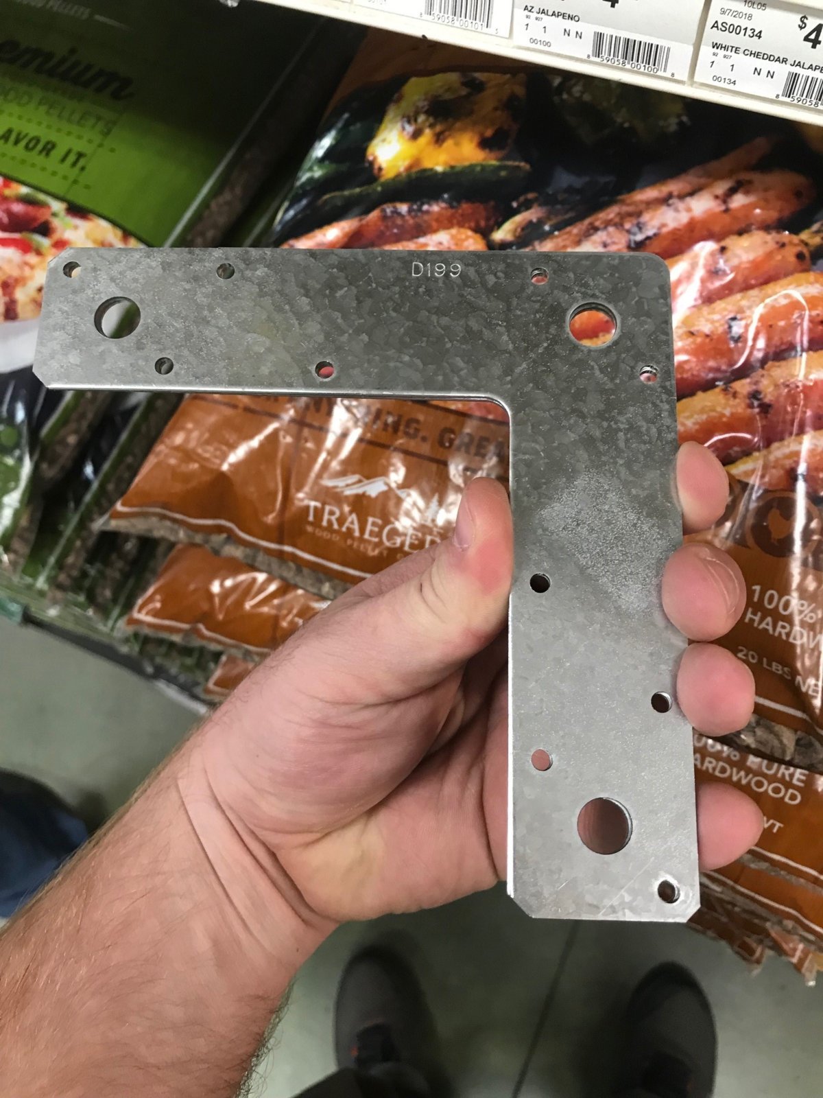

So once I got back to the house, I was able to compare the Ace bracket to the spot on the support bracket. It wasn't a perfect fit that i wanted in order to support it from the upper bolt and lower bolt on the support bracket. So in order to mount it to the upper bolt, I had to grind off a little of the angle bracket to fit. Once I trimmed, painted them black and mounted them up. I was able to slide the lower part in front of the support bracket to make it level.

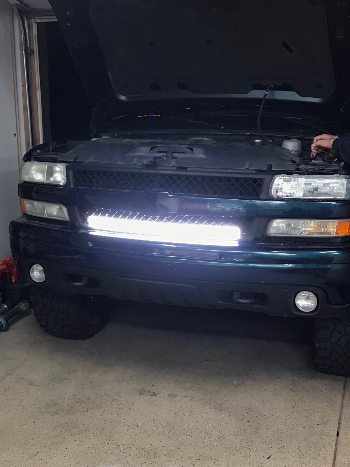

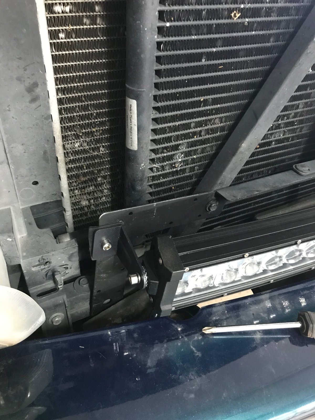

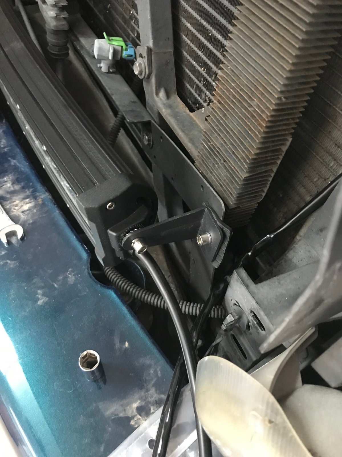

After mounting the custom brackets, I was able to mount the brackets that came with the light bar kit to mount the light bar.

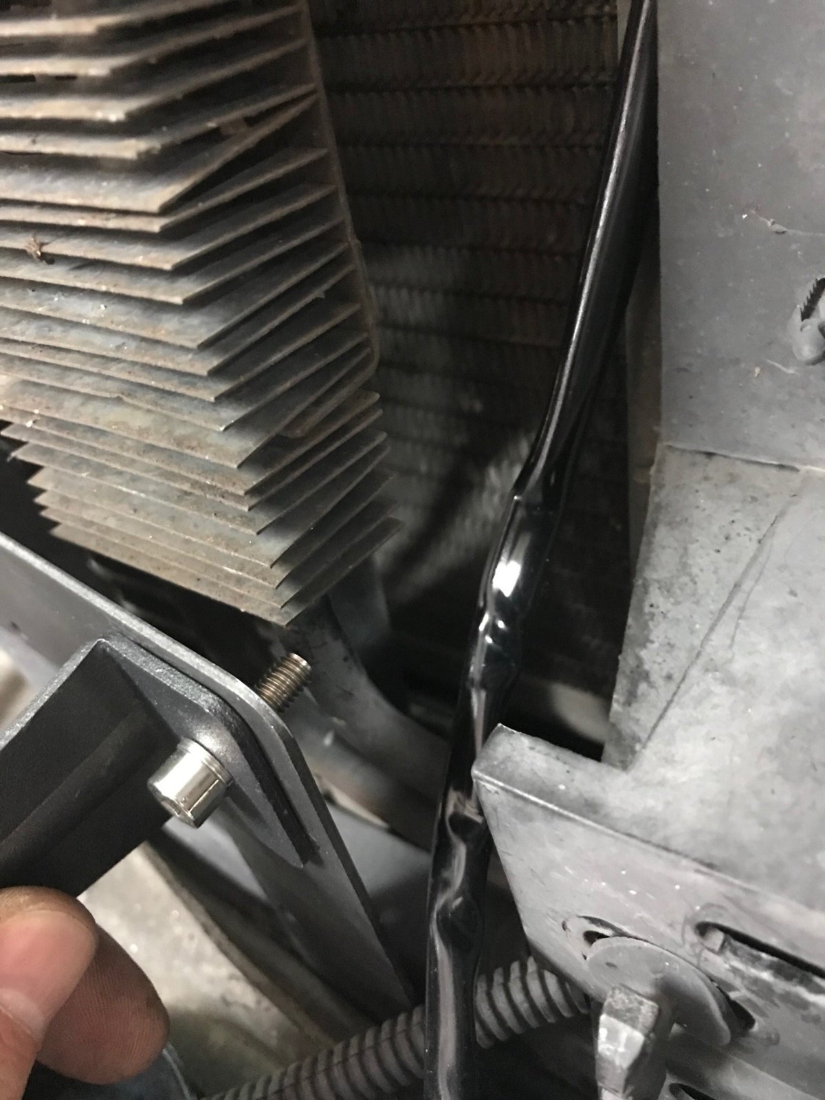

The long bolt that came with the light kit hits the tubing from one of the coolers on the driver's side. You have to maneuver it to fit

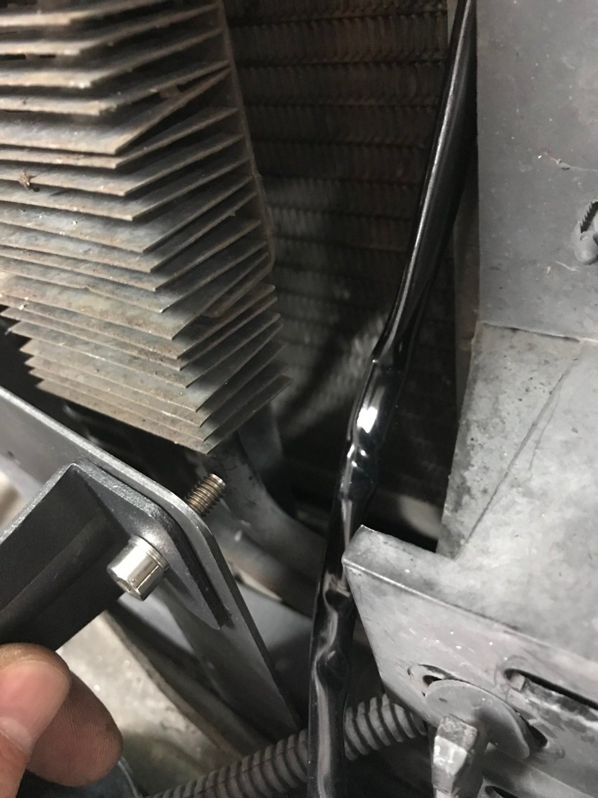

The other issue that i ran into was when I put the grille back on. The light bar didn't give enough space to put it back on. So I had to lower the brackets I made to below horizontal level. That way I could bend it back towards the motor. The driver's side is more tricky because you have to lower it below the fins of the cooler and bend it back to the cooling tubes. This clears room for the grille to be reattached.

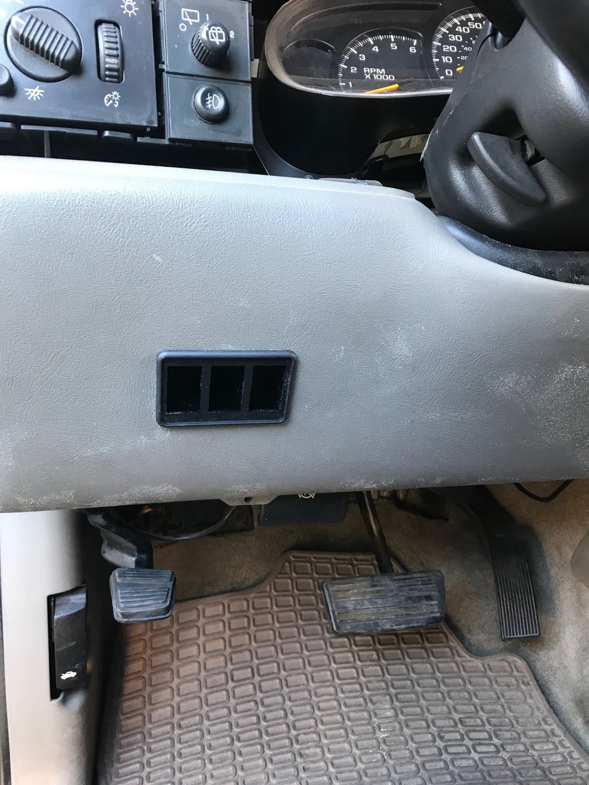

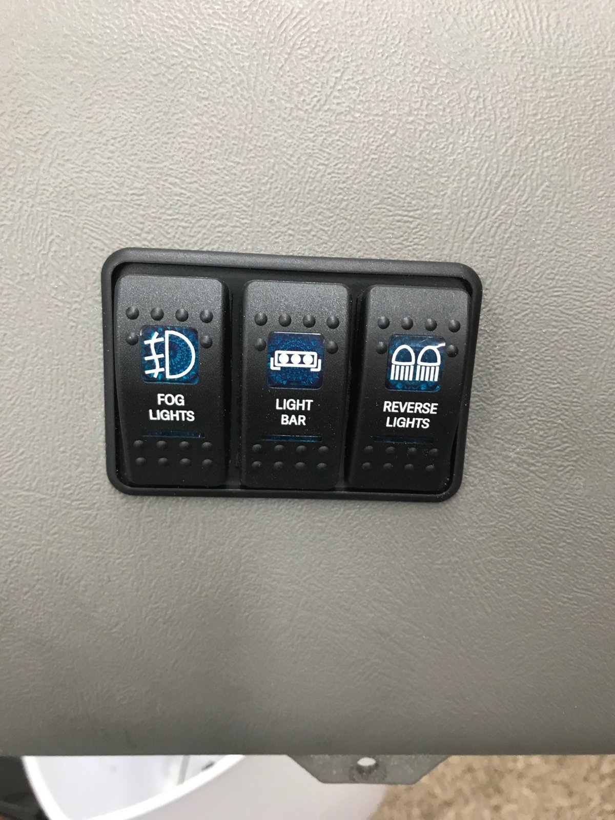

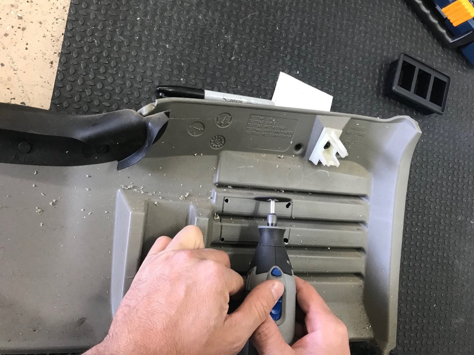

I also mounted the aftermarket switches inside on the dash below the steering wheel. The switch holder I used gave the mounting measurements. I measured slightly smaller to have room for error. Drilled the 4 corners and used a dremel to cut out. I mounted 3 switches for future use. I'm going to move the fog lights from the button on the dash down to the switch. And the aux reverse lights when I finally install them.

So to wrap up my activities. I was able to mount the LED light bar. But i was not able to run the electricity and wiring. The relay that came with the kit had the wires fall out and you cannot reattach them. I had an extra relay for the aux reverse lights so I tried to use that one. It was a bad relay. I was able to test the light by holding the wires on the battery. So although everything looked simple. It took my buddy and I 7 hours and multiple trips to Oreillys and Ace to get everything done. Stay tuned for the wiring. Its very confusing but I will get some help to finish it off.

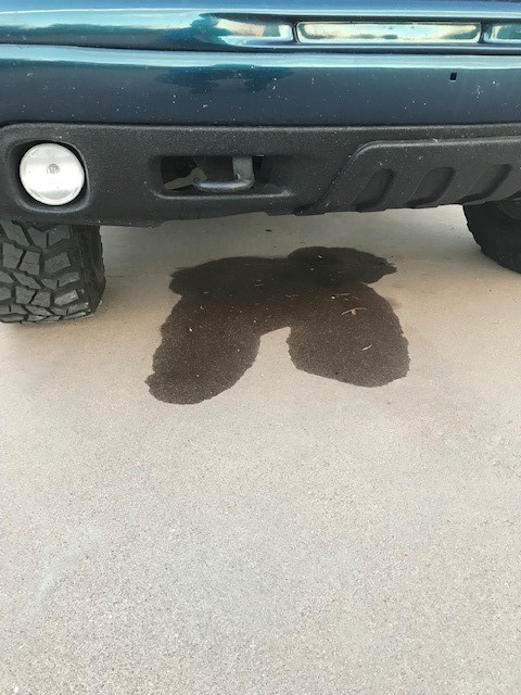

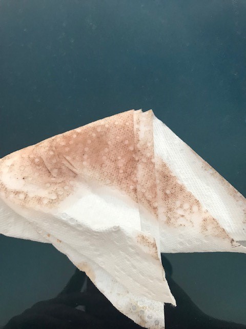

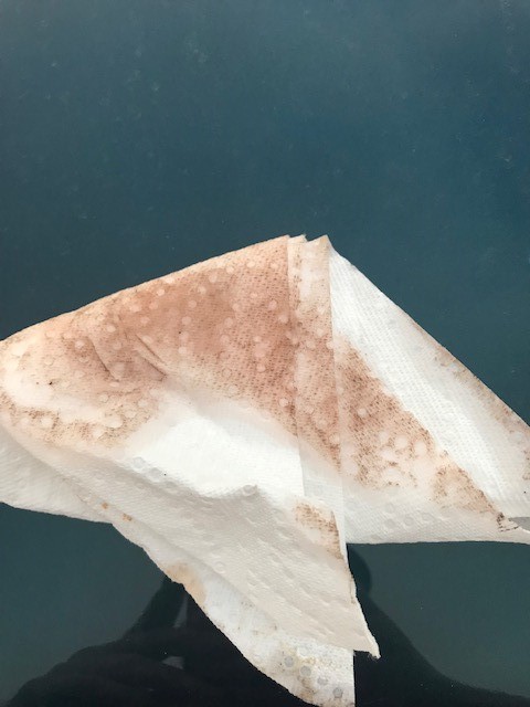

As always when you are trying to do cool shit to your truck, the Hoe inevitably laughs at you with a truck issues that needs to be fixed and pulls you away from the mods.

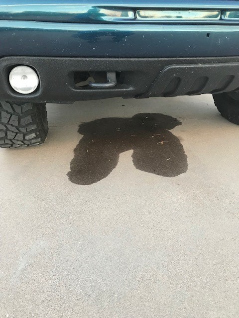

AS of right now I have a leak. I am about 80% sure its antifreeze. Its leaking from the back of the engine compartment onto the skid-plate. There is still fluid in the reservoir, but it is leaking a lot. I haven't been able to locate the source of the leak yet. Luckily I have a work vehicle so the Hoe is parked right now.
Anybody had this issue?

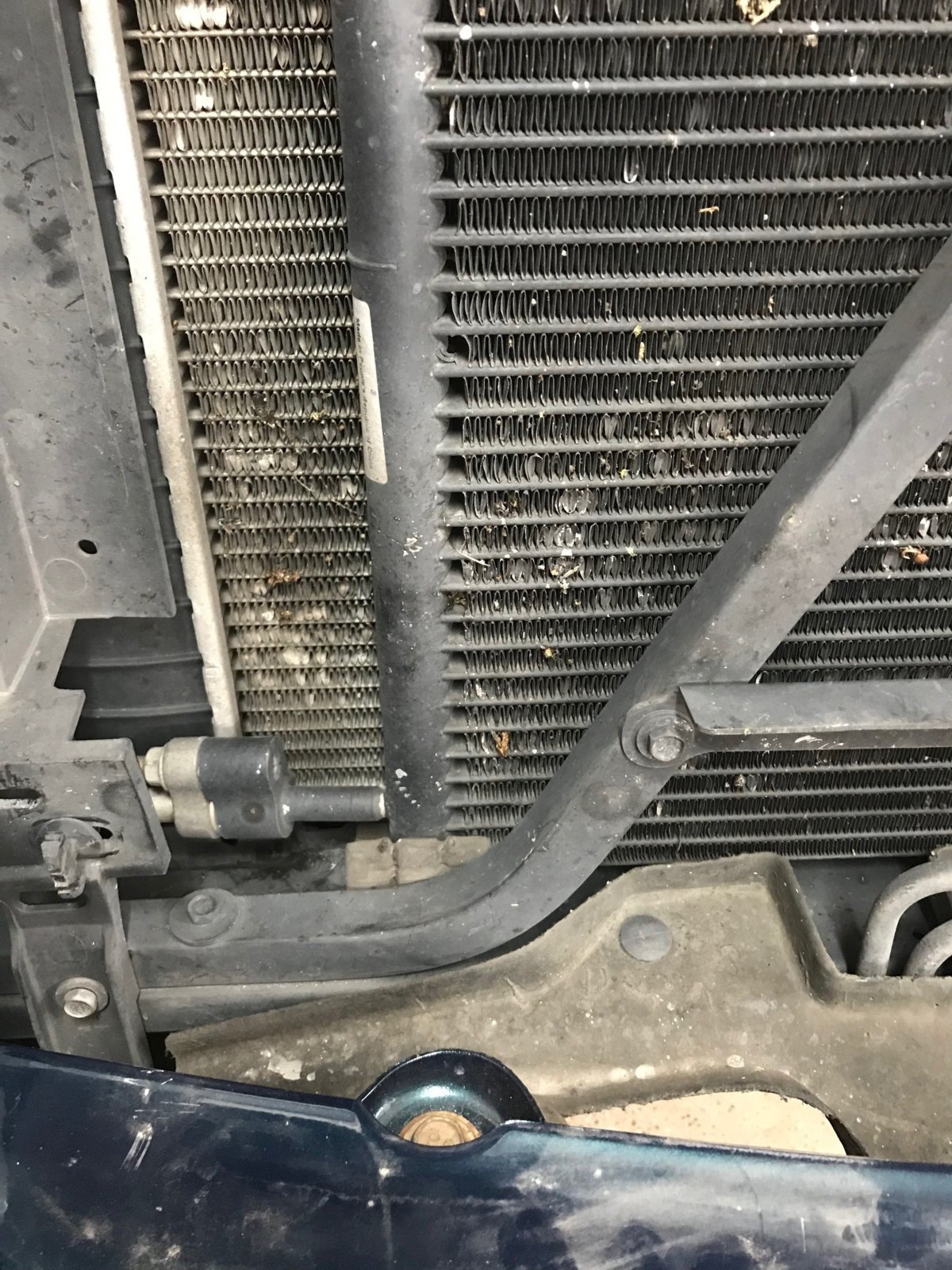

View attachment 212246 View attachment 212247
From your picture it looks to be right under the water pump.
I checked there already. That seams good. I might take the skid plate off tomorrow at lunch to see if I can get a better view. Seems to be coming from closer to the firewall.
I search the forum and seems like people where having the same issue it’s either some quick disconnects or hose connections having to do with the rear ac/heat
Yes... These little buggers right here

So after going to the Transmission shop Saturday morning (of course the leaked wasn't leaking while I was there), we were able to cancel out any tranny leaks. We were able to identify that the leak had a few places to monitor.
I went to my shop today, turns out the water pump was the culprit of the leak!! I'm also getting some other things fixed while its there.

Nice. That's sure what your picture looked like it was.
