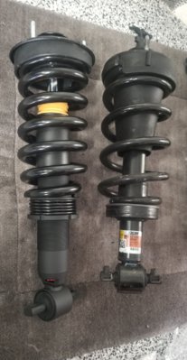

Kw coilover vs the stock magride strut. I adjusted to 11 compression and 7 on rebound. Way better ride. Only thing is that eacalade sits about 1.25 inches higher then before. Ill drive about 200 miles and then adjust the height. Its adjustable up to a 3 inch drop
Currently front is only available with rear kit but working with belltech and front i will offer by itself
