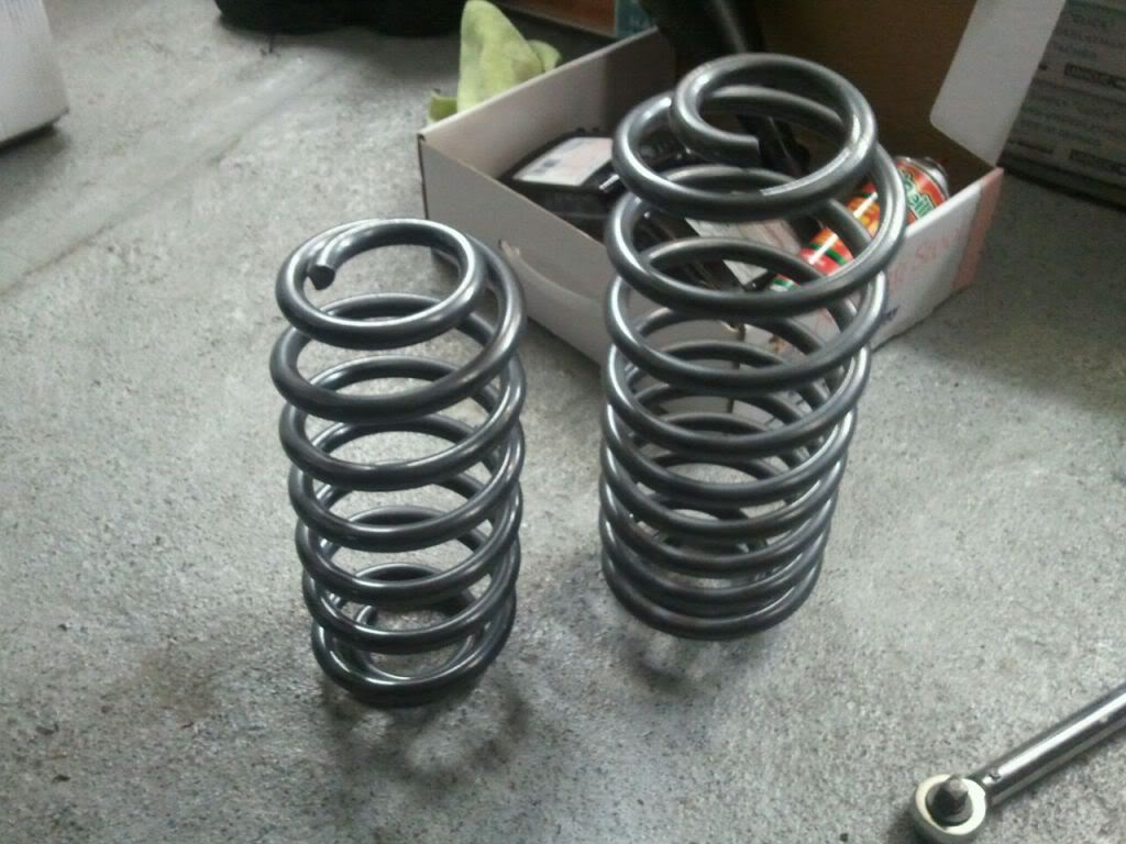

So like the kit I ordered(3/5 drop). I dont have to cut dead coils to get lower,because the 4305's are right where I need to be. The TB springs must of been in the older kits you offered which required you to cut the dead coils if you had a lot of bounce or wanted to g lower?
no the tb springs are in my 5 inch rear kit. If people want to go liek 6 inches then i have them cut the dead coils but on the 5305 springs. Totally different.
Here is a picture of the 5305 tall one vs the tb coils

AHHHHH I see. Oh some I'm good. When I pulled them out the box I was like um, I wont be cutting any coils off of these. Cant wait to see the esky!!
