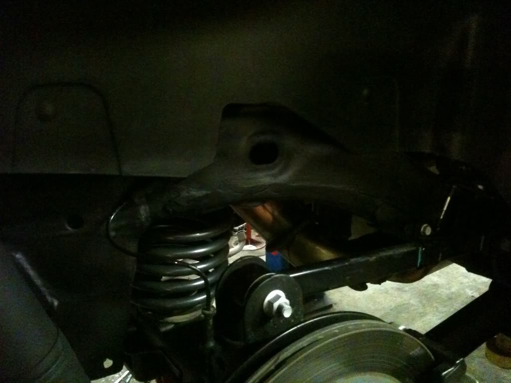

kinda long day did all the rear kit today ie trailing arm relocators/shock extenders/springs/djm bar/new endlinks and spohn panhard bar and bumpstop bracket. Truck feels perfect now around corners.
---------- Post added at 11:56 PM ---------- Previous post was at 11:09 PM ----------
bumpstop bracket cut with new short one installed and belltech 5305 coil
spohn bar vs stock bar
Rear djm swaybar along with shorter endlinks

back of truck is 34.75 and that is with no spacers and set at 2.5 inches. Due to me using the trailing arm relocators I can set the linkage rods to 1.75 inches from center to center to bring it down more. I will let the truck settle and then go from there.

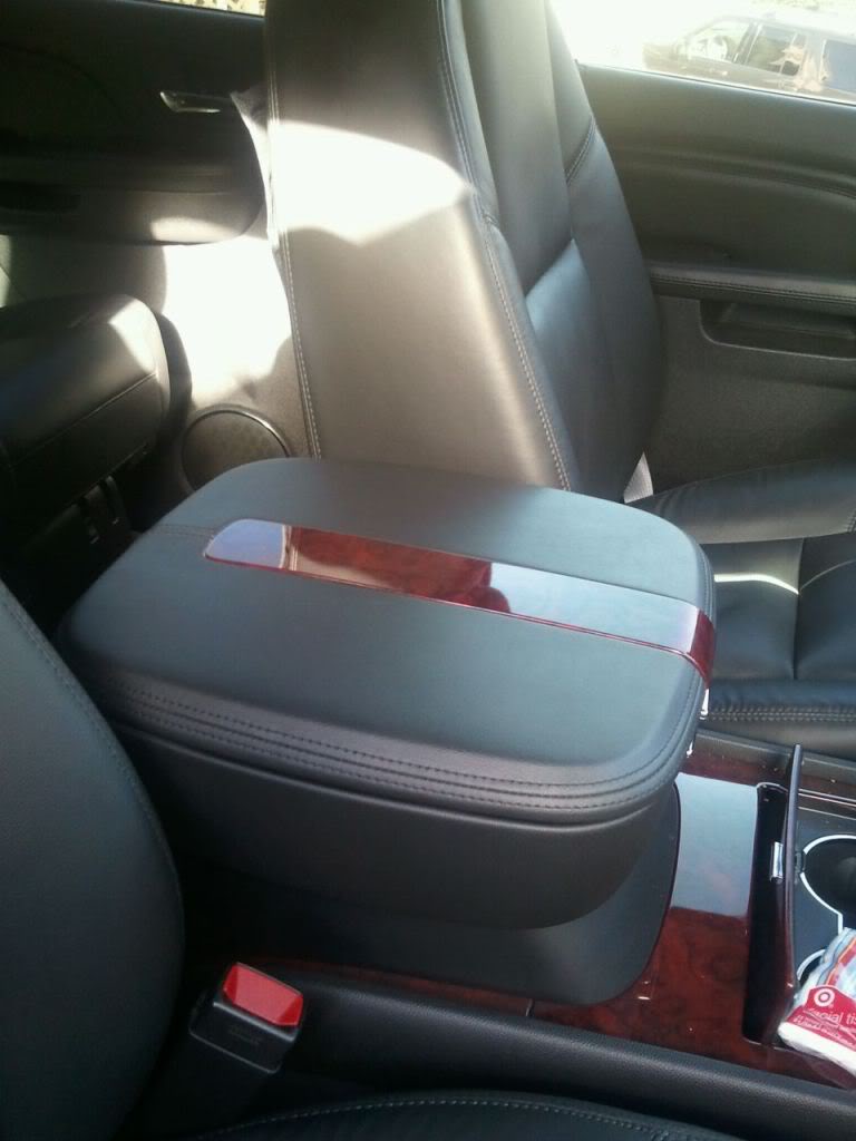

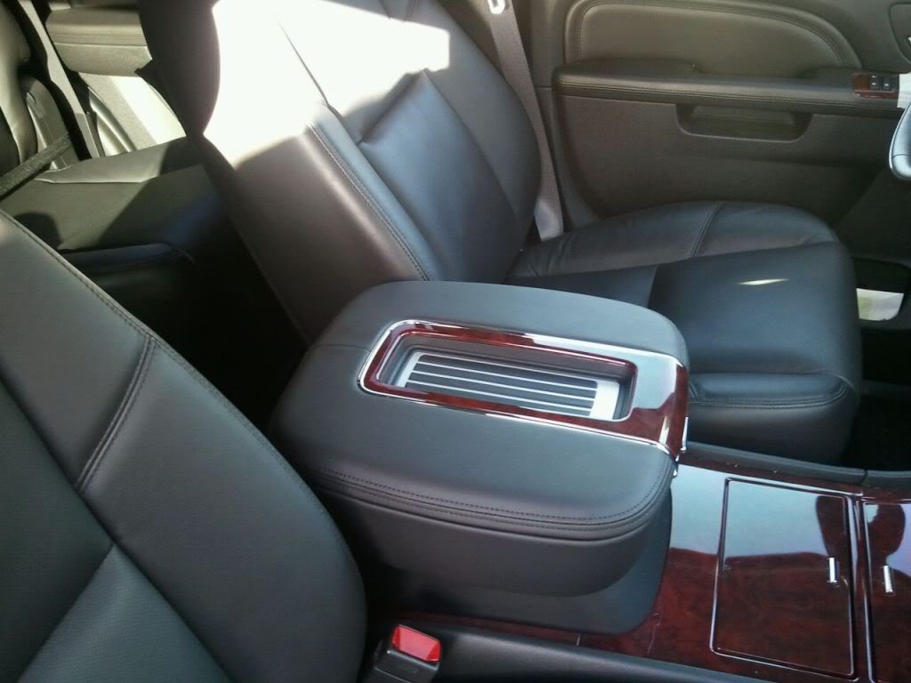

the center consoles of these trucks suck cant put anything up top
so ended up buying the platinum top half much better now you can put your phone in there

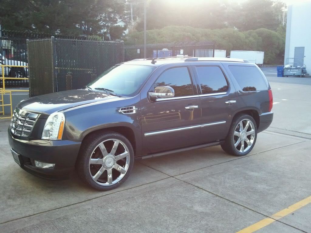

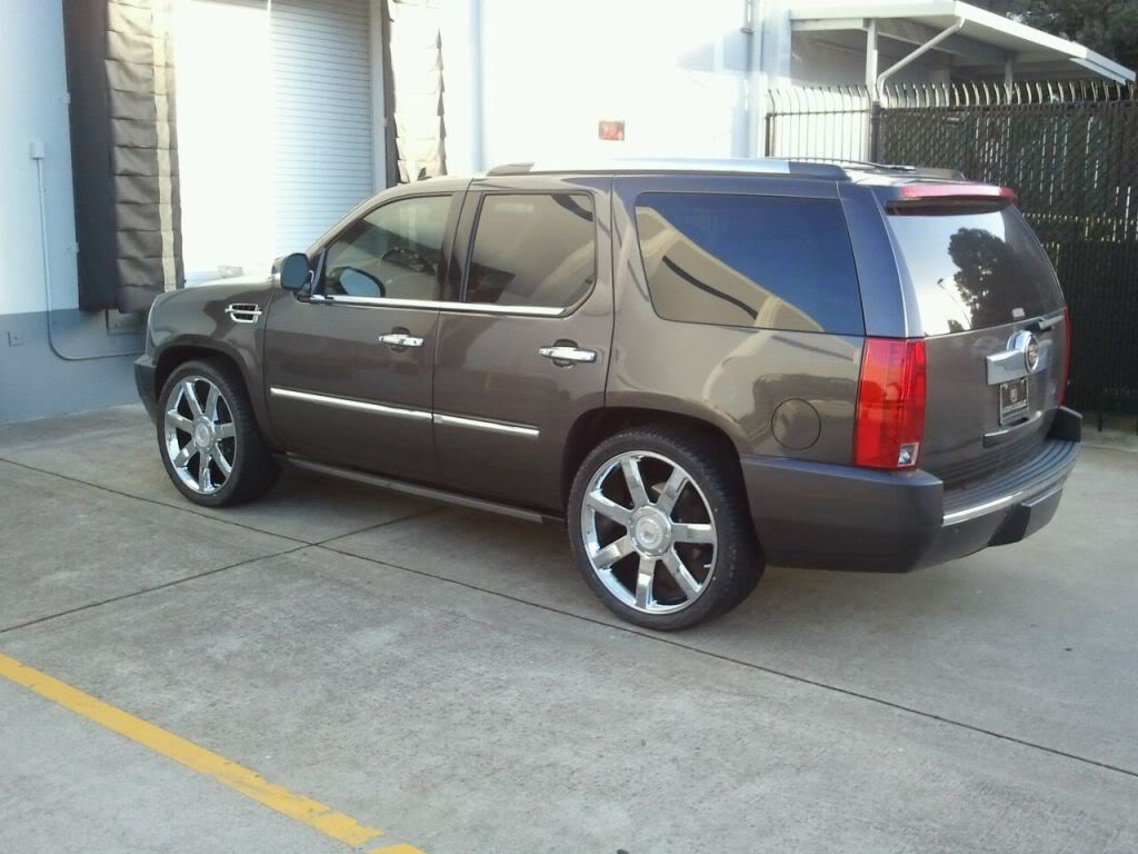

24s are on. GOing to adjust rear autoride links more in the back try to get it down 1 inch and front going to have to machine a new groove to bring it down about 3/4 of a inch
